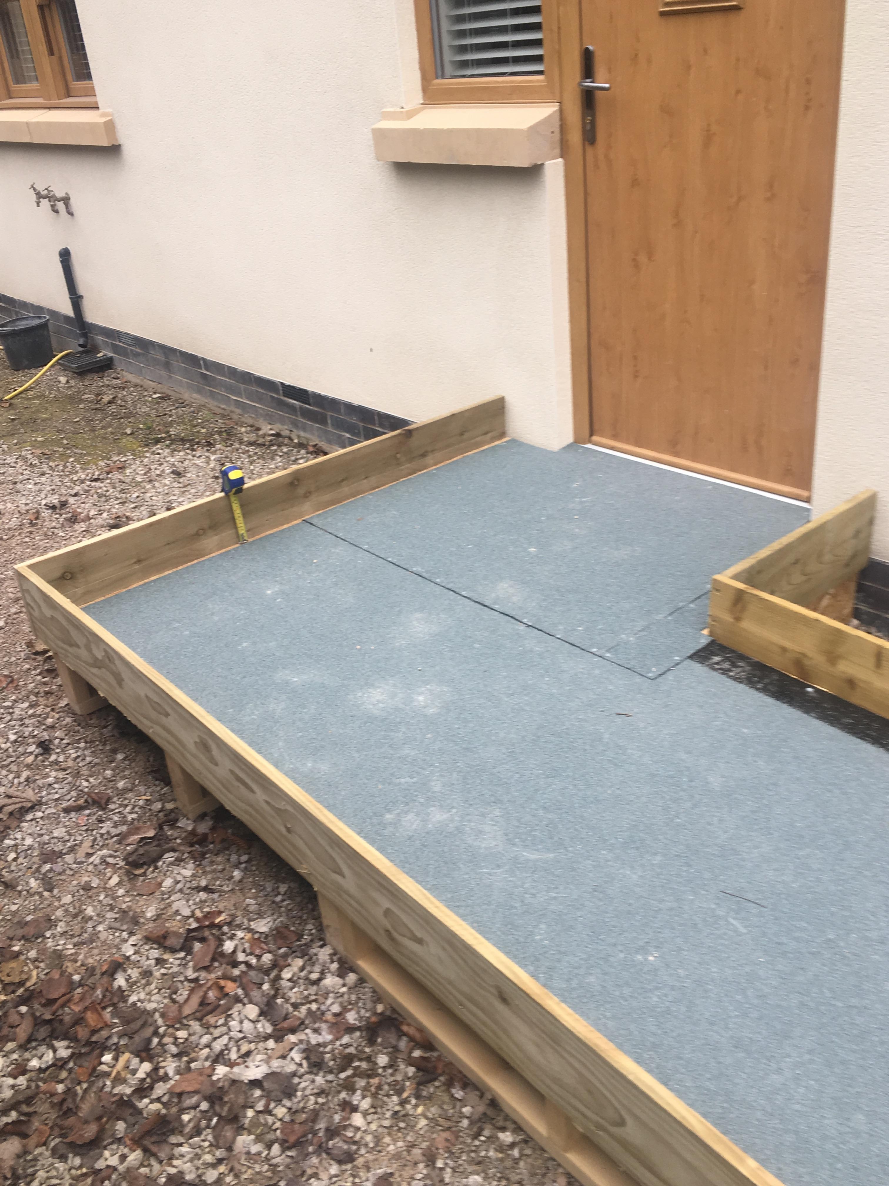

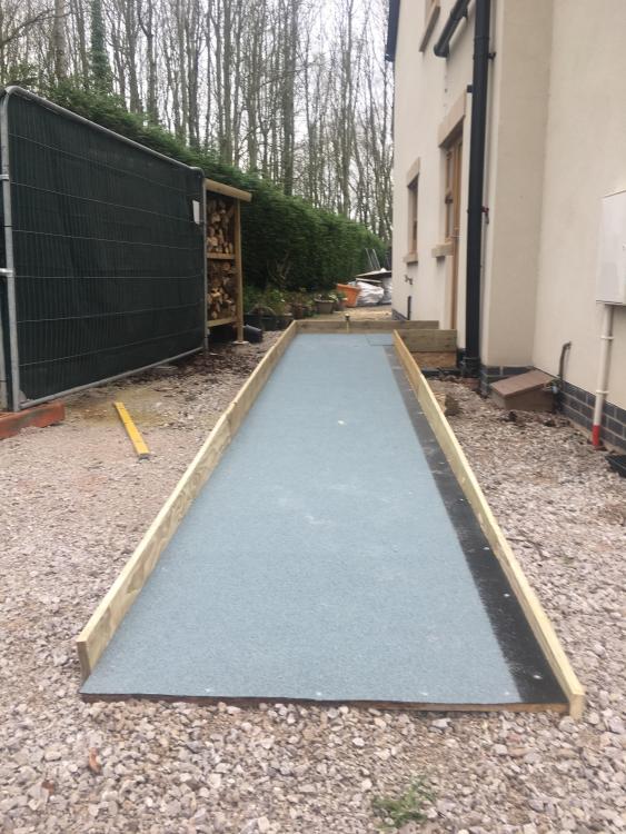

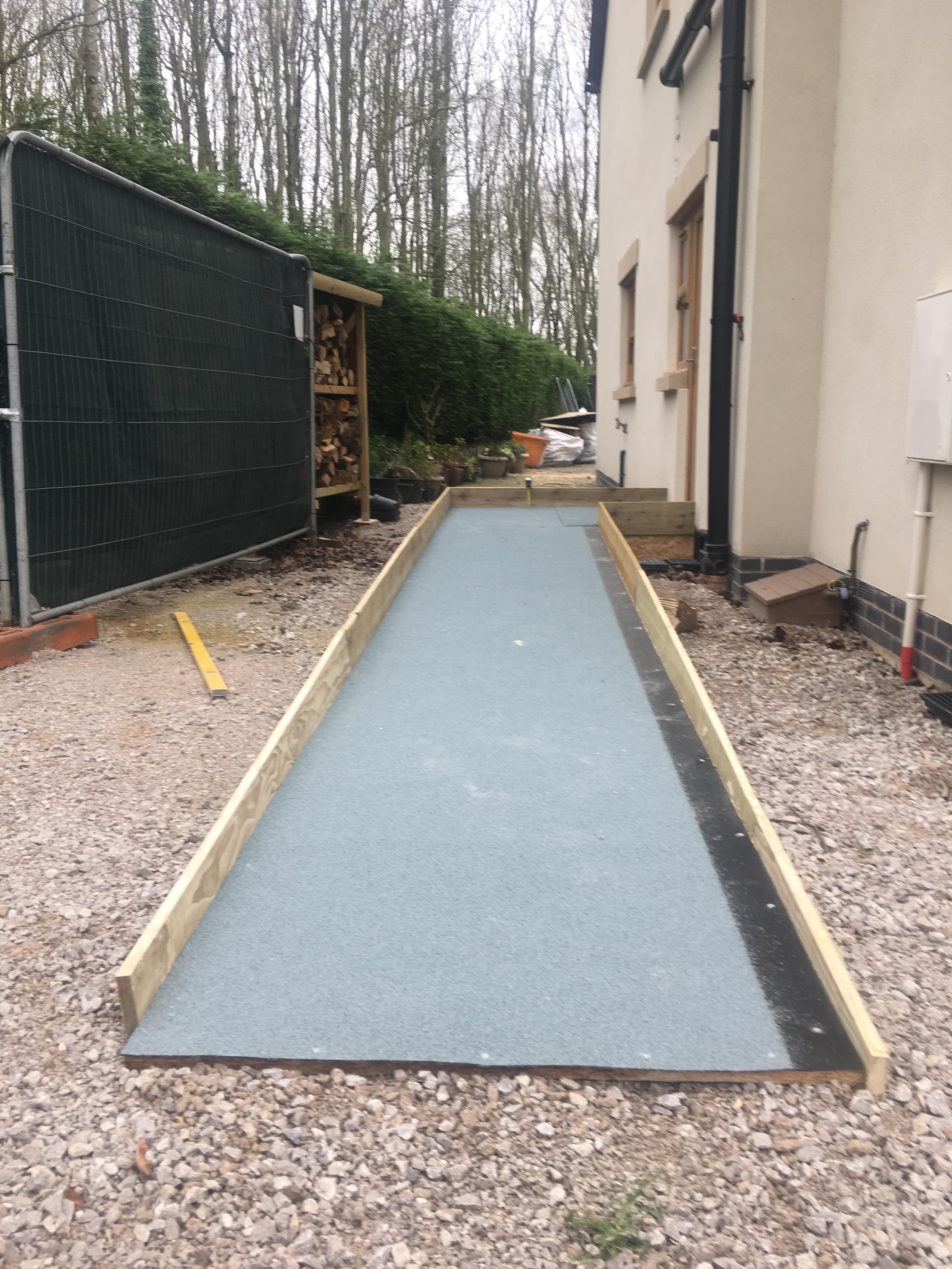

nod Posted May 10, 2019 Posted May 10, 2019 Finally got my Hetas Cert through today So BC can sign us off this afternoon Our infumous disabled ramp can now go No more jokes about skateboarding 2
newhome Posted May 10, 2019 Posted May 10, 2019 Good luck with the sign off. Can you not post a skateboard video before you rip it out? ? 2

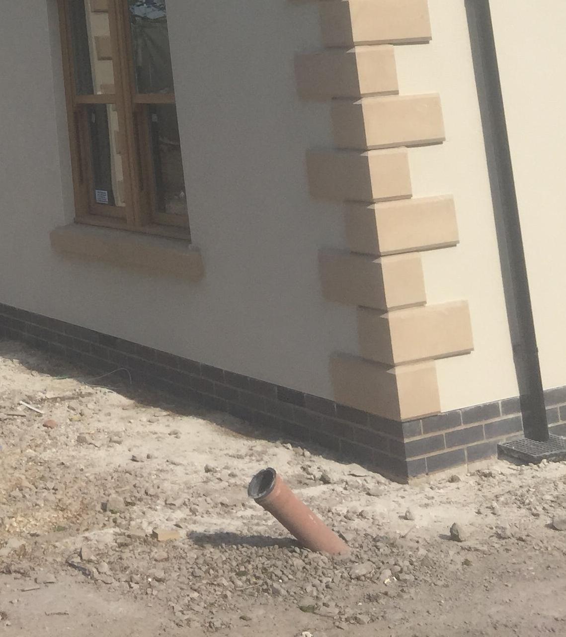

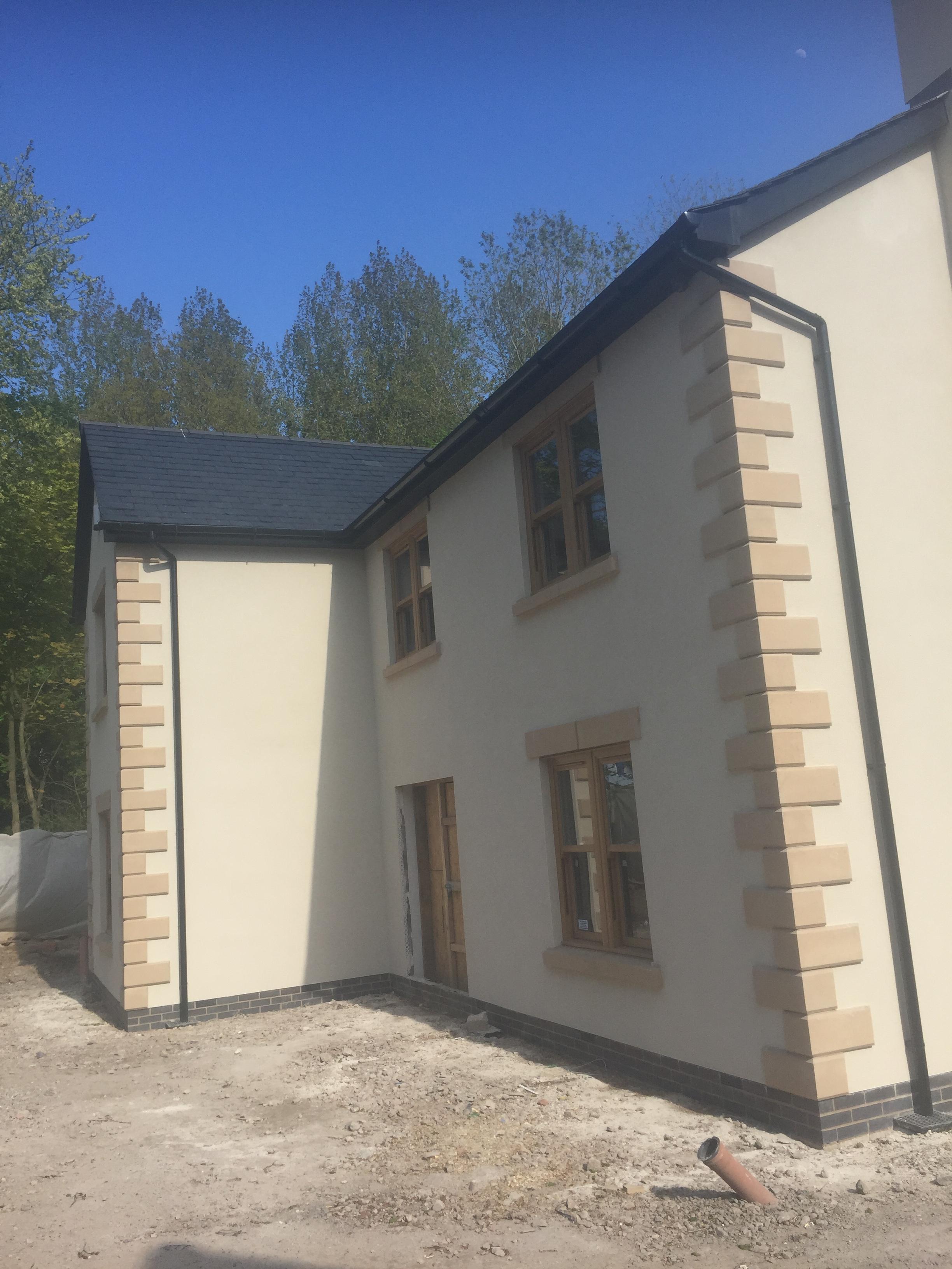

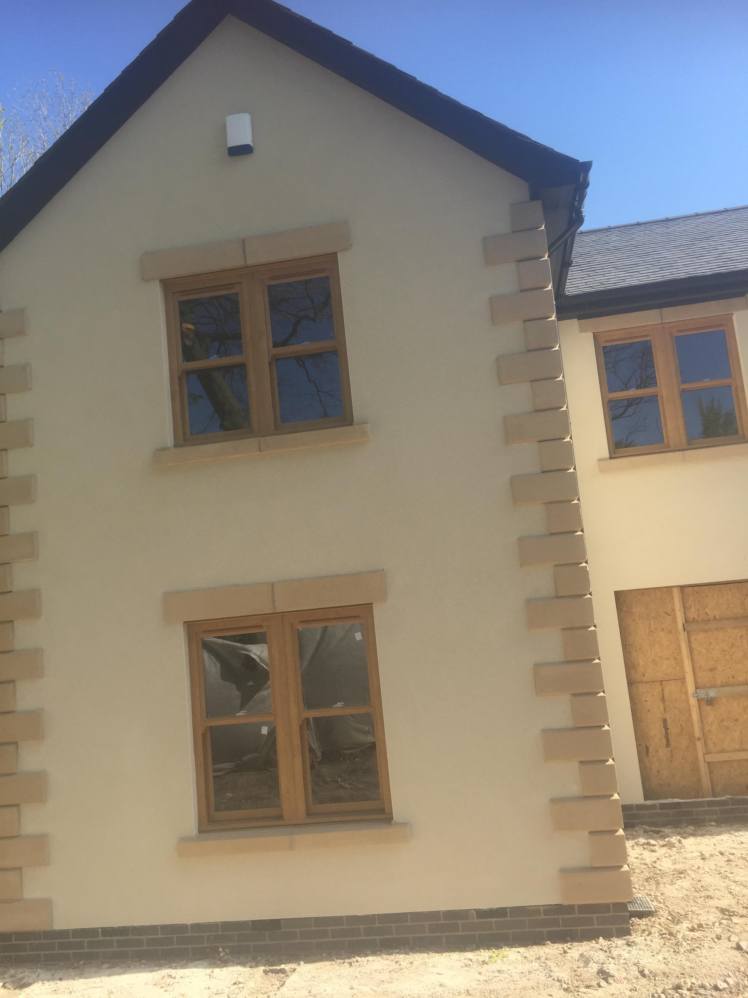

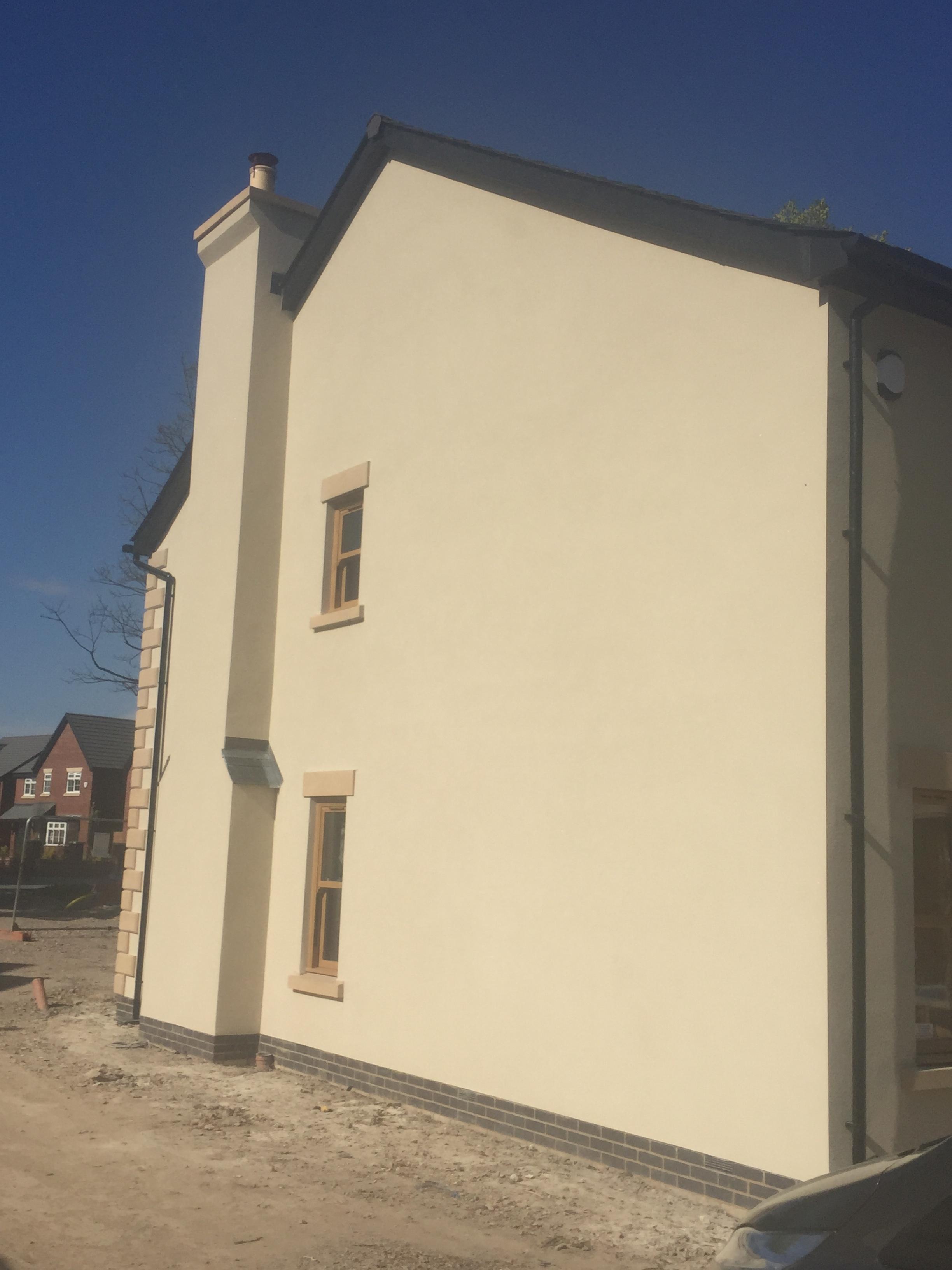

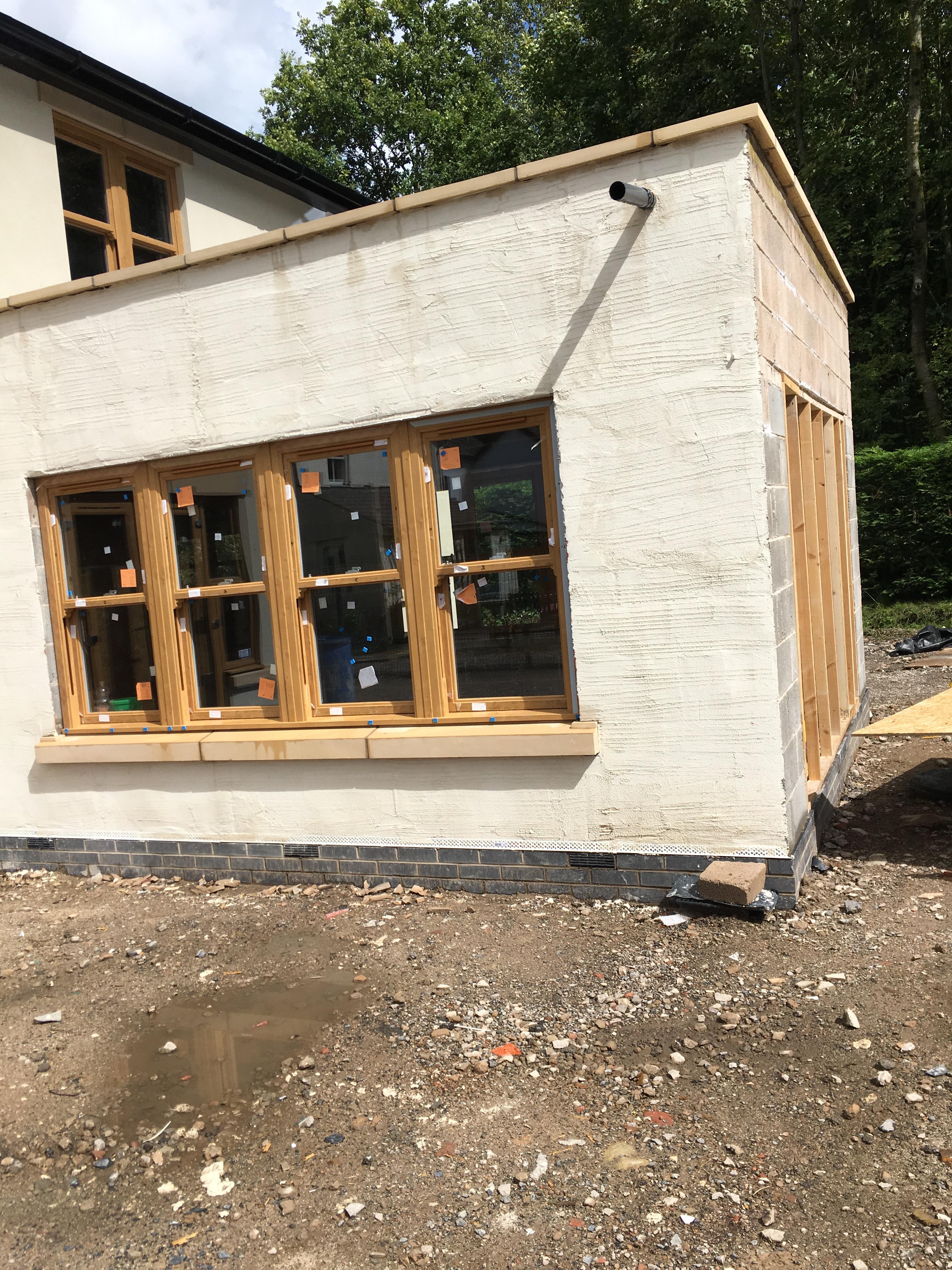

gravelld Posted May 10, 2019 Posted May 10, 2019 @nod what finish is your wall - what is the colour of the finish? Looks nice. And the ramp looks fun.
nod Posted May 11, 2019 Author Posted May 11, 2019 On 10/05/2019 at 11:34, gravelld said: @nod what finish is your wall - what is the colour of the finish? Looks nice. And the ramp looks fun. Sorry just seen your post I used Stirling K rend Scratch coated and meshed above each window Used two coats of K rend silicone directly onto blockwork No need for scratch coat four days work for myself and my son The weather was horrible 1
recoveringbuilder Posted May 11, 2019 Posted May 11, 2019 Did you honestly get signed off with this ramp?? Wouldn’t happen up here!

nod Posted May 11, 2019 Author Posted May 11, 2019 1 hour ago, Christine Walker said: Did you honestly get signed off with this ramp?? Wouldn’t happen up here! Yes all signed off Two different BC If you read the disabled acces Nothing says it has to be tamac or concrete I did it exactly the spec that I was asked 1-20 1200 x1200 flat level acces 100 mil upstands Listed in sign off as temporary Disabled acces Should be a problem anywhere He’s even entered us in an award scheme By the time the photos are taken a permant DA acces will be in place
newhome Posted May 11, 2019 Posted May 11, 2019 @Christine Walker is in Scotland. We have different regs here so wouldn't get away with something like that. Congrats on the award scheme though! 1
nod Posted May 12, 2019 Author Posted May 12, 2019 16 hours ago, Christine Walker said: Did you honestly get signed off with this ramp?? Wouldn’t happen up here! Why ?
newhome Posted May 12, 2019 Posted May 12, 2019 13 minutes ago, nod said: Why ? Because Scotland has different regs and a wooden ramp wouldn’t be allowed.
scottishjohn Posted May 12, 2019 Posted May 12, 2019 11 minutes ago, newhome said: Because Scotland has different regs and a wooden ramp wouldn’t be allowed. you could be right ,but alot of council buildings have removable ramps at town halls and places -which are only there when they are open .and they don,t even comply with the angle so that would be a good example --only need ramp when it needs to be used
nod Posted May 12, 2019 Author Posted May 12, 2019 8 minutes ago, scottishjohn said: you could be right ,but alot of council buildings have removable ramps at town halls and places -which are only there when they are open .and they don,t even comply with the angle so that would be a good example --only need ramp when it needs to be used Exactly 9 minutes ago, scottishjohn said: you could be right ,but alot of council buildings have removable ramps at town halls and places -which are only there when they are open .and they don,t even comply with the angle so that would be a good example --only need ramp when it needs to be used I couldn’t find anything in the English regs that said No Wooden construction Id be really interested to see how the Scots rules differ To save me trolling through like I did with the English regs Paste and copy the section that prohibits the use of timber Also you have to remember this has been listed as temporary on our sign off
newhome Posted May 12, 2019 Posted May 12, 2019 12 minutes ago, scottishjohn said: you could be right ,but alot of council buildings have removable ramps at town halls and places -which are only there when they are open .and they don,t even comply with the angle so that would be a good example --only need ramp when it needs to be used Building control are really fussy up here about it for a new build. I imagine most of the council buildings are retrofits that like renovations don’t have to comply with the current domestic regs.
nod Posted May 12, 2019 Author Posted May 12, 2019 35 minutes ago, newhome said: Building control are really fussy up here about it for a new build. I imagine most of the council buildings are retrofits that like renovations don’t have to comply with the current domestic regs. We have several hundred new builds going up in our area Same to local authority BC that have visited ours They where less happy with the new builds across As they said the DA access didn’t comply No level landing in front of the door Paving sloping from either side If I had built it in concrete or flags It would have been pretty obvious what my intentions where I haven’t got away with anything Just simply followed the rules I would say to anyone who needed to get signed off and wasn’t ready to grade the outside yet Try it and if refused Ask BC to show you the paragraph that prohibits the use of wood It worked for us
Ed Davies Posted May 12, 2019 Posted May 12, 2019 1 hour ago, nod said: Paste and copy the section that prohibits the use of timber There isn't a prohibition in Scottish regs for timber ramps. My house design has a timber ramp - no problem. What they are sniffy about is people obviously putting in something temporary which will be ripped out (presumably, if they don't know it's going to be replaced by something proper, not that I've head of any like that before this).
nod Posted May 12, 2019 Author Posted May 12, 2019 6 minutes ago, Ed Davies said: There isn't a prohibition in Scottish regs for timber ramps. My house design has a timber ramp - no problem. What they are sniffy about is people obviously putting in something temporary which will be ripped out (presumably, if they don't know it's going to be replaced by something proper, not that I've head of any like that before this). Pretty much the same as England then I’ve all the paving arriving on Friday So a few months time the paving will comply But I was very conscious of our vat claim as we have been in since December I think the point I was trying to make was Some in here may find them selfs at the top of there budget getting there House liveable would be the main priority Or May even need the vat back to complete The way I’ve gone about it allows you to comply with building regs and keep your wallet in your pocket I spent a £100 on materials and an afternoon in the workshop Two hours fitting Who knows I may have started a trend
newhome Posted May 12, 2019 Posted May 12, 2019 50 minutes ago, nod said: I think the point I was trying to make was Some in here may find them selfs at the top of there budget getting there House liveable would be the main priority I believe @ProDave is looking at getting a temp habitation certificate here in Scotland to allow him to claim the VAT back. Not sure if the ramp needs to be in for that? Actually getting a temp habitation certificate isn’t a bad strategy to reclaim the VAT IMO as HMRC can hardly claim that the house was complete eons ago if there are still things preventing full sign off, and that would mean more than decorative things. You could presumably deliberately leave a couple of things pending for full sign off to be achieved.
ProDave Posted May 12, 2019 Posted May 12, 2019 1 minute ago, newhome said: I believe @ProDave is looking at getting a temp habitation certificate here in Scotland to allow him to claim the VAT back. Not sure if the ramp needs to be in for that? No, the ramp does not have to be there. The property has to be basically safe, working heating and hot water, working kitchen, at least 1 working bathroom and WC and an electrical certificate. I hope to get the temporary habitation towards the end of this year and use that for my VAT clam. That of course means I won't be able to reclaim the VAT on anything after that, but the largest remaining purchase will be the doors and windows for the sun room, so I should still be able to get those "supply and fit" VAT free.
