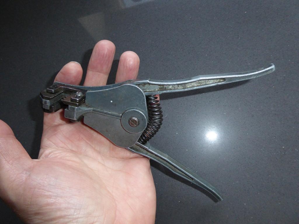

Jeremy Harris Posted May 9, 2019 Posted May 9, 2019 But they last a long time. These are around 40 years old and still work perfectly:
scottishjohn Posted May 9, 2019 Posted May 9, 2019 I doubt i would get the use out of them --40years --i would be oldest self builder in the world .LOL also they are not insulated --so picking up wrong wire by mistake could be painful-- thats how my first pair of fancy side cutters were relegated to mechanical work --picked up a neutral that was still live and blunted the cutting notch . LOL one of those things if you not done it yet --you will sooner or later when playing with system that some of it is still live--
ProDave Posted May 9, 2019 Posted May 9, 2019 13 minutes ago, JSHarris said: But they last a long time. These are around 40 years old and still work perfectly: Yep, mine must be 30 years old if not more.
Jeremy Harris Posted May 9, 2019 Posted May 9, 2019 4 minutes ago, scottishjohn said: I doubt i would get the use out of them --40years --i would be oldest self builder in the world .LOL also they are not insulated --so picking up wrong wire by mistake could be painful-- thats how my first pair of fancy side cutters were relegated to mechanical work --picked up a neutral that was still live and blunted the cutting notch . LOL one of those things if you not done it yet --you will sooner or later when playing with system that some of it is still live-- I've already had about 40 years worth out of them! I'm not a fan of insulated tools at all, with the exception of screwdrivers where it might be useful to tighten a live terminal (very rarely). The reason is that my view is that they encourage unsafe working practices. No one, no matter how qualified or experienced they are should be working on a live installation. Isolate the power and check it's really dead before working on it is the golden rule. 1
scottishjohn Posted May 9, 2019 Posted May 9, 2019 Just now, JSHarris said: I've already had about 40 years worth out of them! I'm not a fan of insulated tools at all, with the exception of screwdrivers where it might be useful to tighten a live terminal (very rarely). The reason is that my view is that they encourage unsafe working practices. No one, no matter how qualified or experienced they are should be working on a live installation. Isolate the power and check it's really dead before working on it is the golden rule. wouldn,t disagree with you --but sometimes hard when there has been a dipstick at the wiring before hand and got loops going all over the place from 2 different consumer units . and control wiring going along way to a different part of house from the other unit --unknown to me at the time . took some sorting out after that little incident cos neutrals were joined from different consumer units all over the place.
