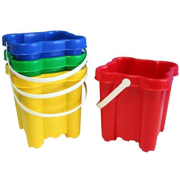

epsilonGreedy Posted May 8, 2019 Share Posted May 8, 2019 When visiting another self builder the other day (who had laid 18,000 facing bricks) we both confessed how easy it is to loose count when loading a cement mixer with set ratios of sand/cement. He resorted to pre filling a set of buckets with sand or cement before loading the mixer and I now intend to do the same to achieve visual mortar consistency above ground. My Question: Can anyone recommend a source for small buckets where six would equate to a half mixer load? Many moons ago I sailed on a french yacht that had a strong mini rubber bucket, this was small enough to be thrown overboard with a rope attached when the vessel was under way and adopt a drogue position without pulling the person overboard. Six such a buckets would be ideal at my mortar mixing station. Link to comment Share on other sites More sharing options...
Big Neil Posted May 8, 2019 Share Posted May 8, 2019 no idea what a 'drogue position' is, but do you mean this sort of thing, albeit bigger? https://www.littlefieldsfarm.com/tubtrug-flexible-micro-370ml-red?of_tid=MFRWG5B5GE4TQJTGMVSWISLEHUYSM4DSN5SESZB5GE3DAMRY&adGroupId=43737471283&device=c&gclid=CjwKCAjw_MnmBRAoEiwAPRRWW-yR2w7nl994MfKA0i5t9PdPCC2V_FOz9nDQKUPqjGnpENotRn5jOBoCeh8QAvD_BwE 1 Link to comment Share on other sites More sharing options...
Big Neil Posted May 8, 2019 Share Posted May 8, 2019 If that's the sort of thing, I think our last one was about 4 quid from Tesco - no hold on - B&Q... Link to comment Share on other sites More sharing options...
epsilonGreedy Posted May 8, 2019 Author Share Posted May 8, 2019 27 minutes ago, Big Neil said: no idea what a 'drogue position' is I was just using the analogy to convey a notion of how small a bucket I was looking for i.e. something larger than a paint kettle but smaller than a full sized garden/builders bucket. On a moving sailing boat if you were to throw a regular size bucket overboard and hang onto a line, it would skip over the waves for a few seconds then bite on solid water as it fills. At this point the operator standing on deck would either be dragged overboard as the filled bucket adopts a drogue (sea anchor) position or would have to let go. Link to comment Share on other sites More sharing options...
bassanclan Posted May 8, 2019 Share Posted May 8, 2019 (edited) 10l paint pot. They won't last but there are always plenty left over from the previous job...and they are free Edited May 8, 2019 by bassanclan Link to comment Share on other sites More sharing options...
epsilonGreedy Posted May 8, 2019 Author Share Posted May 8, 2019 12 minutes ago, Big Neil said: If that's the sort of thing, I think our last one was about 4 quid from Tesco - no hold on - B&Q... Thanks looks like an good option, I will experiment. One thing I realized last year when doing the footings is that the traditional builders technique of tipping a loaded shovel into the mixer is quite safe as it keeps the operator away at arms length. Tipping a full size bucket with a metal handle within the aperture of the drum has the risk of the bucket handle snagging one of the mixing paddles. Link to comment Share on other sites More sharing options...
