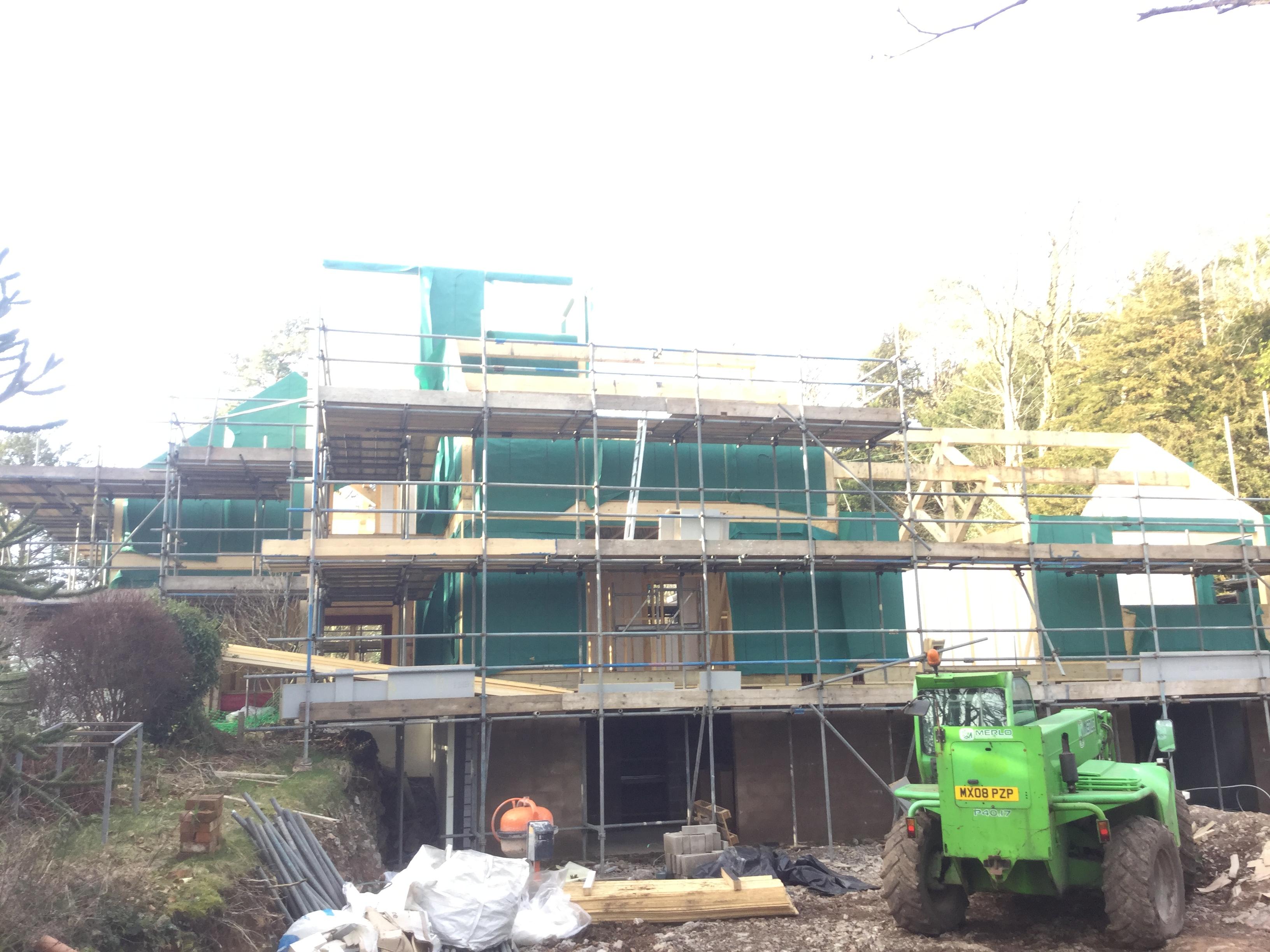

Triassic Posted May 3, 2019 Posted May 3, 2019 (edited) We’ve put our bedrooms in a basement cut into the hillside, they look fine in terms of light. Edited May 3, 2019 by Triassic
