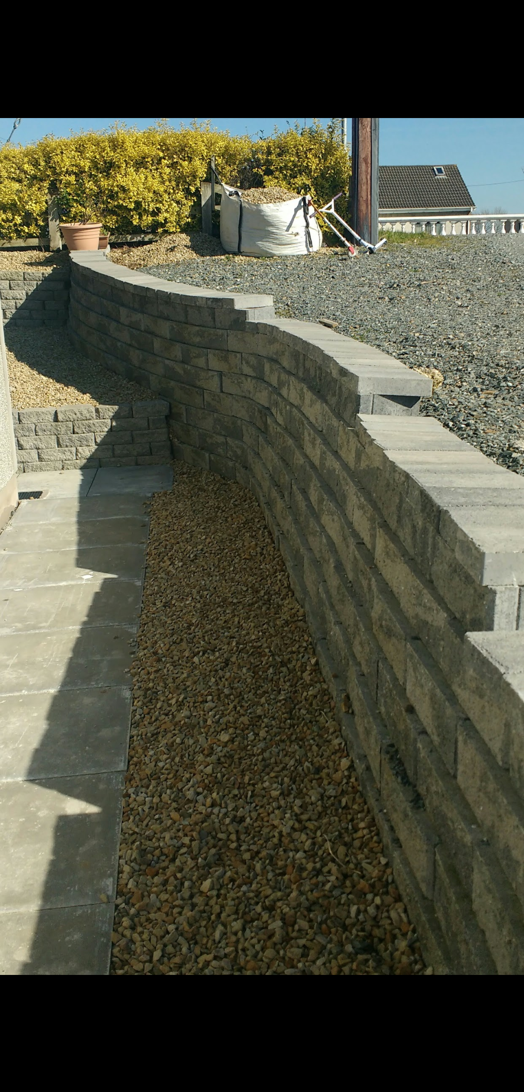

Declan52 Posted April 22, 2019 Share Posted April 22, 2019 There are plenty of dry stone options using either real stone if you can get it cheap or concrete blocks. Either way doesn't require a concrete foundation I used a dry stone concrete block on my drive. Only thing is it might be an expensive option as you won't really see much of it. Gabions and stone and some wire to tie it together is about as low tech as you can get. Link to comment Share on other sites More sharing options...
zoothorn Posted April 22, 2019 Author Share Posted April 22, 2019 Hi Declan- that looks splendid, but I won't need aesthetically good as it won't be seen down side of bank (in fact I entertain idea of most horrible looking.. so my sod n'bors have a wall of concrete to look out on.. is good). I am looking for most effective, & cost effective: even going OTT is good as I just cannot have the situation of the cabin creeping down on one corner even 1 inch.. so mitigating against this is absolute priority. So how would a series of these gabions work in my situation? I can't even visualise what a retaining wall of these might consist of/ how might I plan them with structure in mind? its this structural area, even say having chosen the gabion way, that I have not one iota of an idea of to proceed. Link to comment Share on other sites More sharing options...

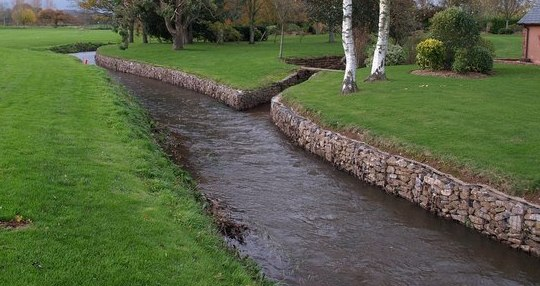

zoothorn Posted April 23, 2019 Author Share Posted April 23, 2019 28 minutes ago, Ferdinand said: Do you have a photo of the brook in full spate? alas not.. but it gets max about 2 ft high & widens to 5 ft or so. Its usually 1ft wide. What I need here, is a "waterproof" retaining wall/ bank. Which points me back to gambions, as they do have this 'waterproof' aspect. The bit that's eluding me in principle is the flat prepped 'trench' of say D100mm into which the gambion sits. Concrete? surely the soil underneath can get washed away. Soil? Im not sure how again it might shift the gambions 'footings' by angry brook action. Compacted hardcore maybe? Then what's to stop the gambion wall falling over into brook, by the weight of the soil pulled down against it? (& cabin ontop too) Link to comment Share on other sites More sharing options...
Jeremy Harris Posted April 23, 2019 Share Posted April 23, 2019 Gabions need to sit on a compacted base, something like MOT 1, whacked down. They seem to work OK as a way of controlling bank erosion along streams and rivers: Link to comment Share on other sites More sharing options...
