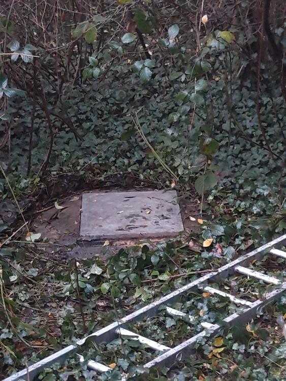

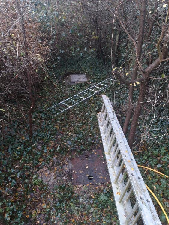

Onoff Posted October 12, 2022 Author Share Posted October 12, 2022 An apparently nice man turned up and emptied the cess pool. SWMBO was there and dealt with it. Reckons he was sucking up "bricks and glass" and "got out what he could". The guy was very concerned about the state of the lid and reckon it's been left too long to repair. Don't suppose she mentioned we only found it in 2019! 😂 Insisted he put "something" over it when finished so she found him a pallet. Said their sister company does "macerator" installs according to SWMBO but I imagine he said / meant treatment plants. They will come and do the dig and install etc. Might get a no obligation quote though from them. Tbh my BiL has diggers etc so would likely look to do it myself with input here from the clever folk. If I go that route I'm favouring the Vortex unit as others have said. Link to comment Share on other sites More sharing options...

Onoff Posted October 12, 2022 Author Share Posted October 12, 2022 1 hour ago, Russell griffiths said: @Onoff do you actually want to spend £5000 minimum on doing this or is it cheaper and easier to just empty it every year for £200. If necessary yes. If the lid is as ****ed as I think it is. It might not stand up to having another slab cast on top. My neighbours is under his drive and of similar vintage. It collapsed when he drove over it in his Range Rover. Link to comment Share on other sites More sharing options...

joe90 Posted October 12, 2022 Share Posted October 12, 2022 17 minutes ago, Onoff said: It might not stand up to having another slab cast on top. How bad is it? Link to comment Share on other sites More sharing options...
Onoff Posted October 12, 2022 Author Share Posted October 12, 2022 56 minutes ago, joe90 said: How bad is it? Until I clear the vegetation I won't know tbh. It's probably next door's ivy holding it all together! Link to comment Share on other sites More sharing options...
