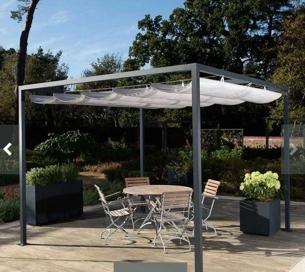

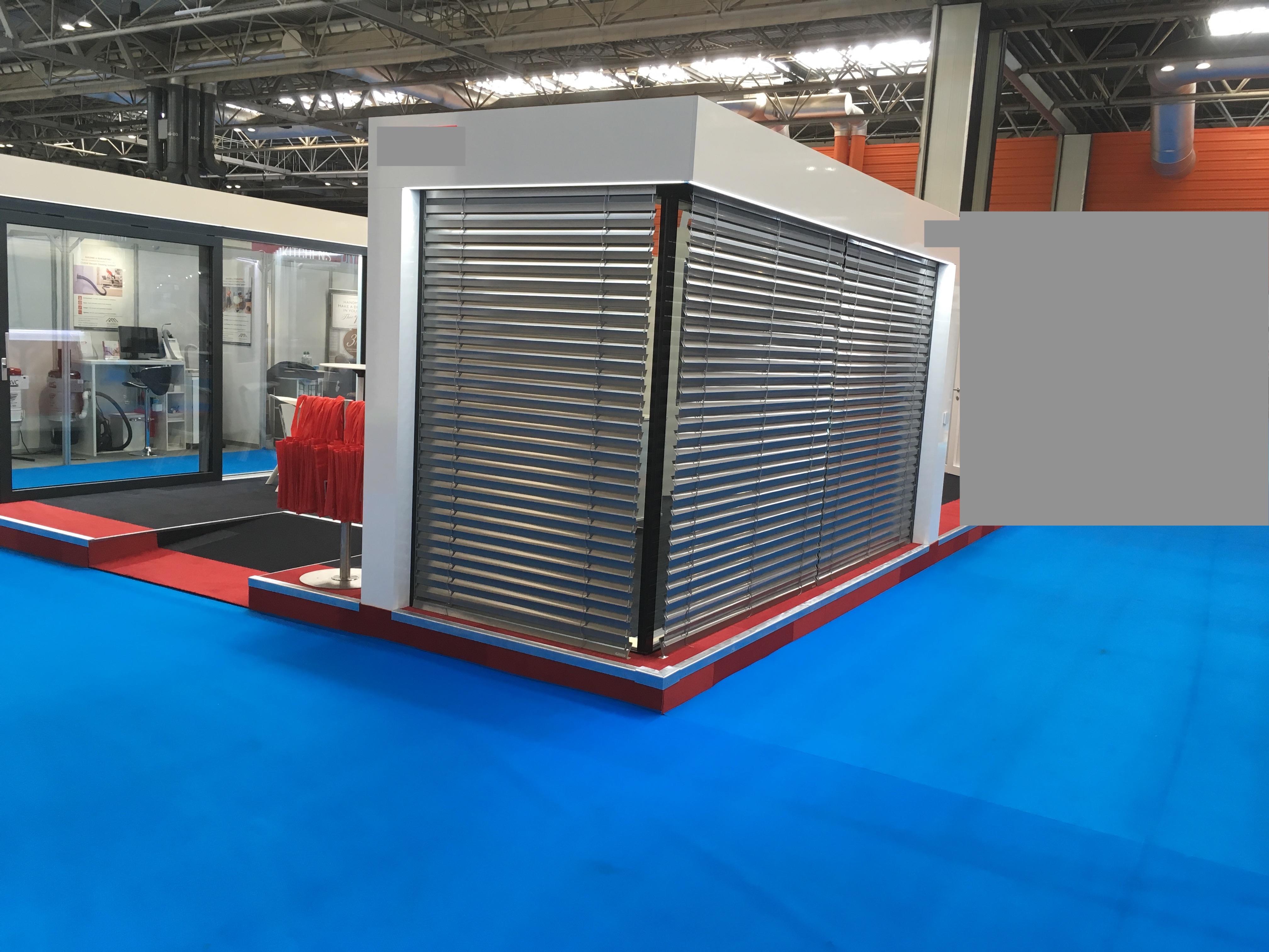

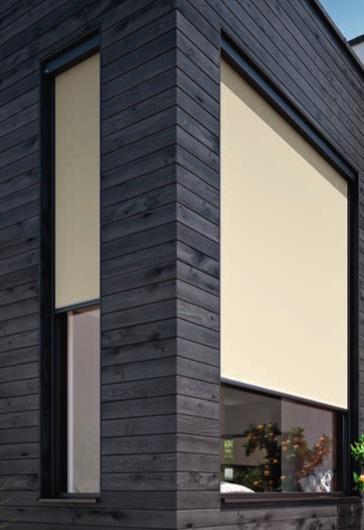

vk108 Posted April 13, 2019 Posted April 13, 2019 (edited) Hi, We are looking for shading options for my new build. Can some one help me with pros and cons of below attached ides please. We are looking to reduce overheating in large south face glazing Edited April 13, 2019 by vk108 edit picture

Triassic Posted April 13, 2019 Posted April 13, 2019 I like the idea of external shutters or blinds. Shutters would be more robust in windy conditions. 1

Gone West Posted April 16, 2019 Posted April 16, 2019 48 minutes ago, vk108 said: Hi @PeterStarck, We are at planning stage at the moment As it's not retrofit I would design in hidden external blinds or shutters but if the cost is okay I would rather consider something like SageGlass like I believe @NSS used. 2

Adam2 Posted April 18, 2019 Posted April 18, 2019 Can't Trump that ^ I'm in a fairly similar position and am planning on low g glass (0.3) so most of the solar energy is blocked by the glazing. We have ~54m2 facing SW with minimal natural external shading. As contingency, should the combination of glazing choice and use of ASHP with cooling mode + MVHR with duct coolers result in too many over-heating days (we generally are happy at mid 20s) then we will fit external shading (Brise soleil) which we are ensuring we have suitable fixings for should they be required. An alternative we may use on the ground floor is a sail type shade but need to think a bit more about location of exterior support post(s) for that. Although you can model the expected gains, there are a lot of factors to consider and you may not really know the degree of over-heating until you experience it - hence our contingencies. Personally not a fan of exterior shutters though they would probably be the most effective option. Electrochromatic glass I really like but my wife says no - she has a hang-up that she's seen it in office environments so can't get past it being more of a commercial solution. And that's before we think about cost! Interior blinds of course will also provide a small degree of help, not a huge amount, but maybe in combination with other measures that may make things bearable. Good luck - so many options and so many costs ?
