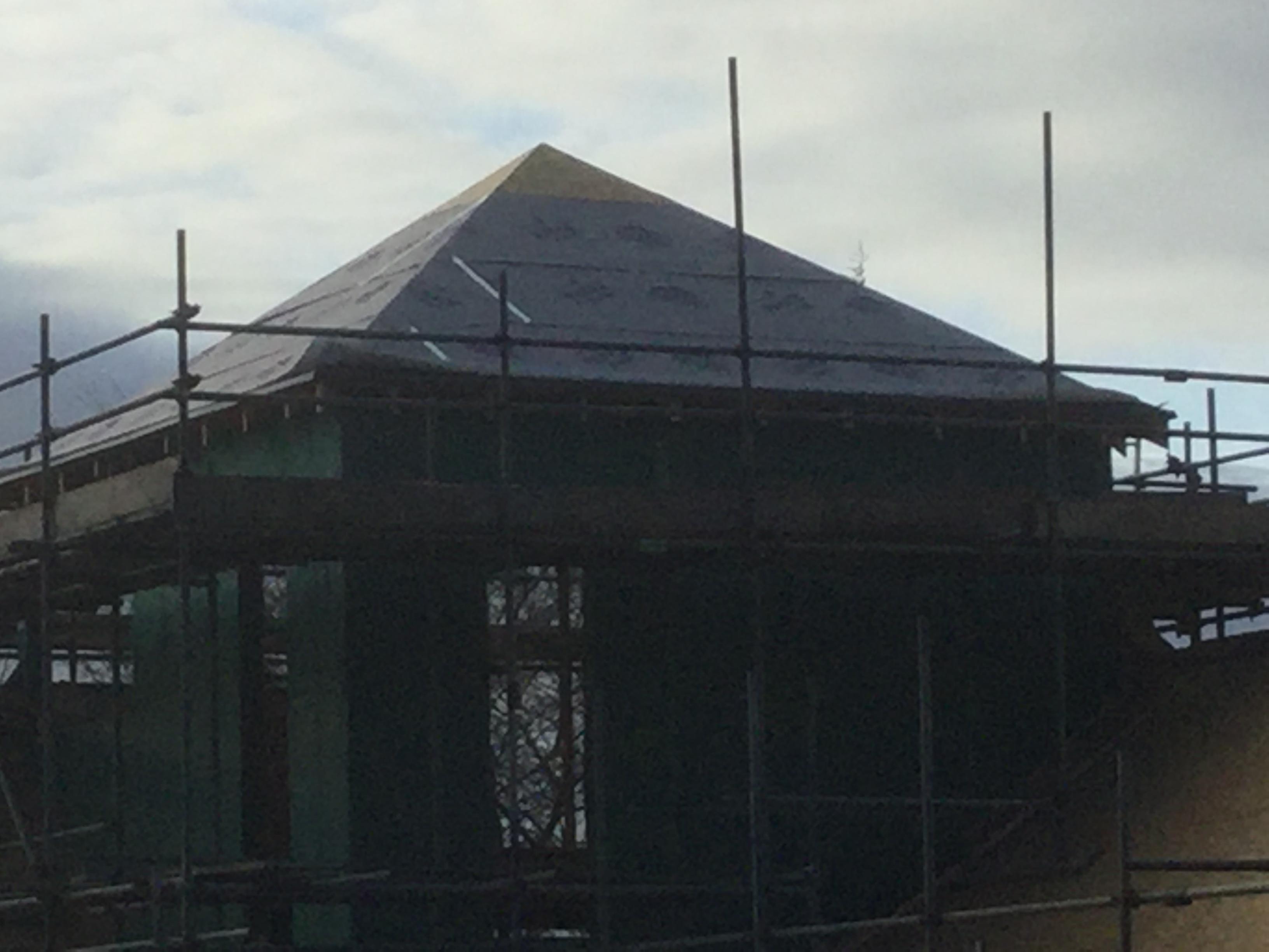

Triassic Posted March 26, 2019 Share Posted March 26, 2019 (edited) The house is up and the designer has asked if she can have a weather cock! looking on line it’s not clear to me how they afix it to the roof, has anyone installed a weather vane and if so how ? She wants it to sit on top of here Edited March 26, 2019 by Triassic Link to comment Share on other sites More sharing options...

ToughButterCup Posted March 26, 2019 Share Posted March 26, 2019 41 minutes ago, Triassic said: [...] She wants it to sit on top of here Nice idea. Very nice idea. The rafters are exposed (albeit under something like Kloeber Permoforte) ? There will be some fitting that works well - use that - and then cap it off with code 5 lead? As usual, I'm short on detail..... Link to comment Share on other sites More sharing options...

Triassic Posted March 26, 2019 Author Share Posted March 26, 2019 Nice video @Ferdinand Now for the technical stuff. I like the idea of making a weather vane, I also want to keeping things local. I need to make the mounting rod that fastens to the house. So, what diameter is the rod sticking up from the mounting plate. I assume it’s solid and the weather vane tube is hollow and slides over it? Link to comment Share on other sites More sharing options...
Triassic Posted March 26, 2019 Author Share Posted March 26, 2019 After more searching I’ve found this about the mount8ng rod diameters and mounting https://www.westcoastweathervanes.com/basic-drilled-installation-instructions-for-medium-large-and-extra-large-weathervanes/ Link to comment Share on other sites More sharing options...
Triassic Posted March 26, 2019 Author Share Posted March 26, 2019 What’s the likelihood of lightning hitting a copper weather vane? Would I need a conductor to earth? Is a weather vane on the highest point of the house a good idea? Link to comment Share on other sites More sharing options...

epsilonGreedy Posted March 26, 2019 Share Posted March 26, 2019 (edited) 42 minutes ago, Triassic said: What’s the likelihood of lightning hitting a copper weather vane? Would I need a conductor to earth? In the world of sailing it is claimed that when a yacht has an earthed mast (big wire electrically connected to a metal keel) then a spiked lighting rod at the top of the mast will discharge a stream of ions in conditions that could lead to a strike. The net result is that a yacht moves within a bubble of reduced electrical potential which persuades a lighting strike to find a path to earth elsewhere. Edited March 26, 2019 by epsilonGreedy Link to comment Share on other sites More sharing options...
