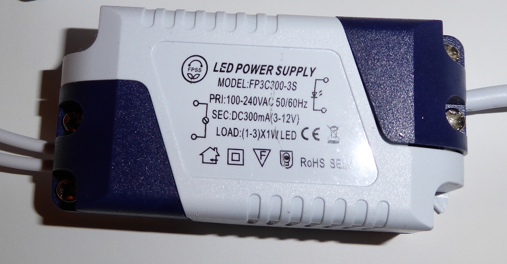

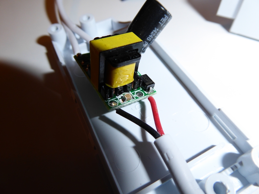

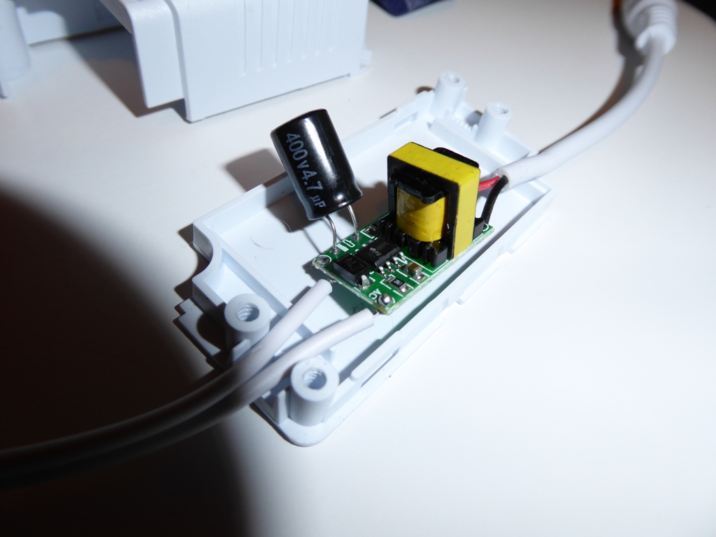

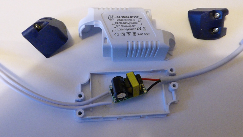

Jeremy Harris Posted March 17, 2019 Posted March 17, 2019 I took one of these constant current drivers apart to see how good the RF screening was and to check as to whether there was any conducted RF suppression. Draw your own conclusions from these photos: First point to note is that the case carries the double box symbol that indicates that it's double insulated. However, it has two single insulated mains conductors coming out of the case, so it clearly isn't compliant with the Class II regs. That tends to cast suspicion on the other approval marks, in my view, so I suspect that, like many such devices, the CE mark is fake (to carry that mark the unit should comply with the LV Directive and the EMC Directive, and it doesn't seem to comply with either). There's a tiny suppression capacitor on the "DC" output (which looks nothing like DC, it's a high frequency pulse train at a hundred kHz or so, with barely rounded edges). There are no suppression components on the incoming AC side, so RF can easily be conducted via the incoming wires, too, which may then act as an antenna. There's no form of screening to prevent or reduce radiated RF emitted by the circuit from passing through the case. 1

Jeremy Harris Posted March 17, 2019 Posted March 17, 2019 2 hours ago, joe90 said: So @JSHarris can you recommend a good source of these things that suppress properly (and meet regs!). Sadly I can't, as it seems to be a very variable and fluctuating market, so there's no easy way to tell if something that was sold a month ago and that was OK would be the same as ostensibly the same item, sold by the same supplier later. I bought several apparently different makes of LED driver and found that around 70% of them were probably fakes, in terms of not actually complying with the marked approval. 1
