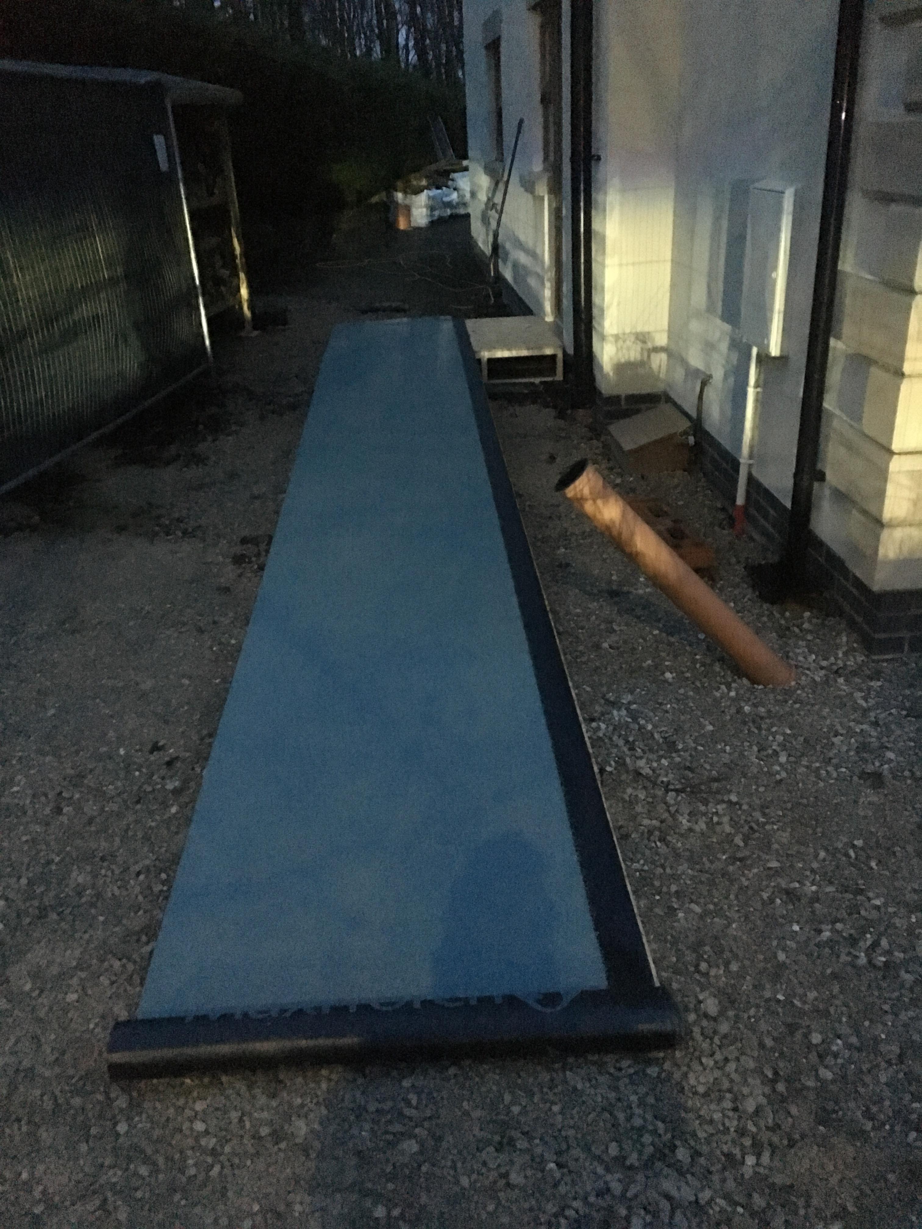

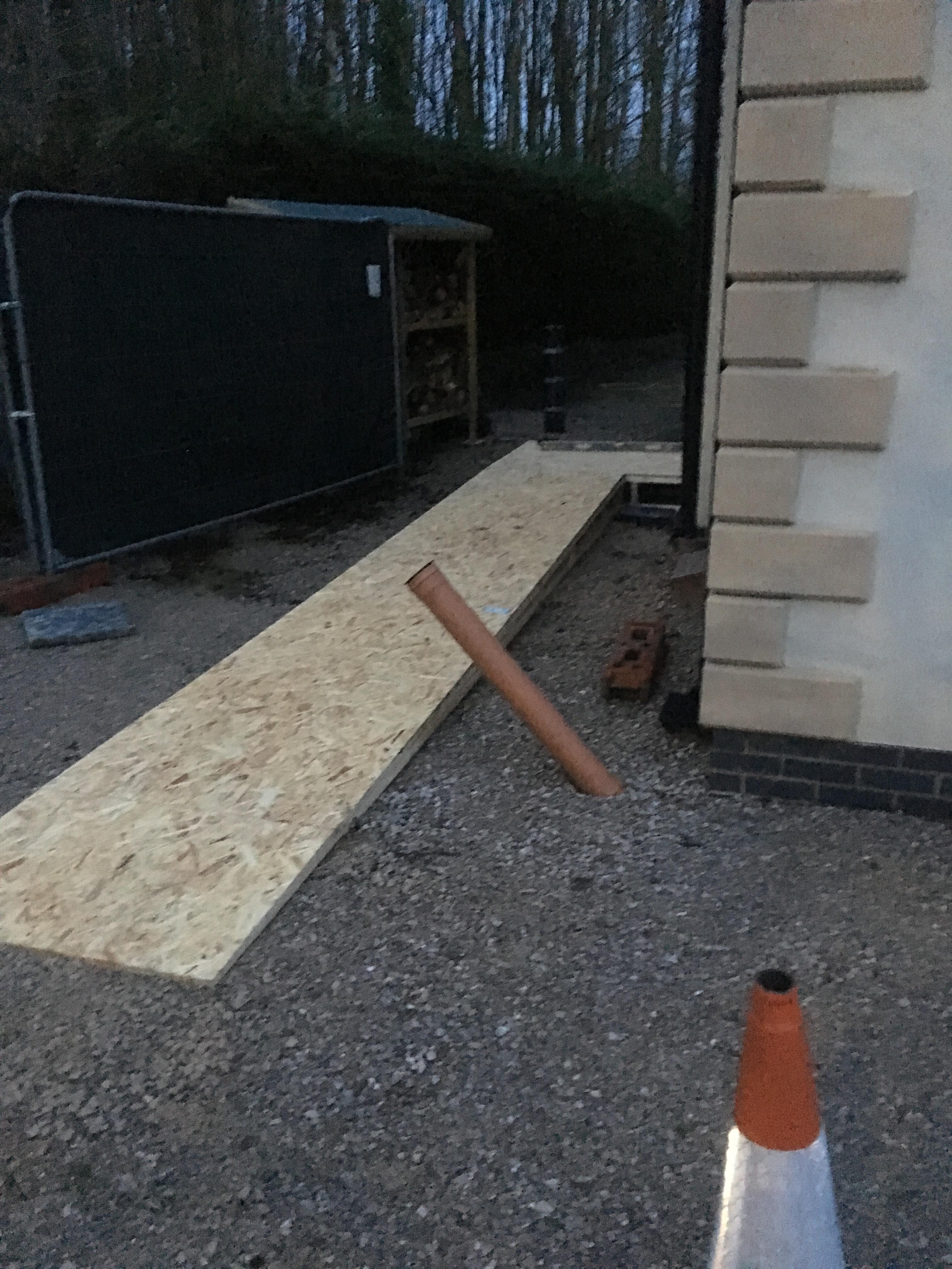

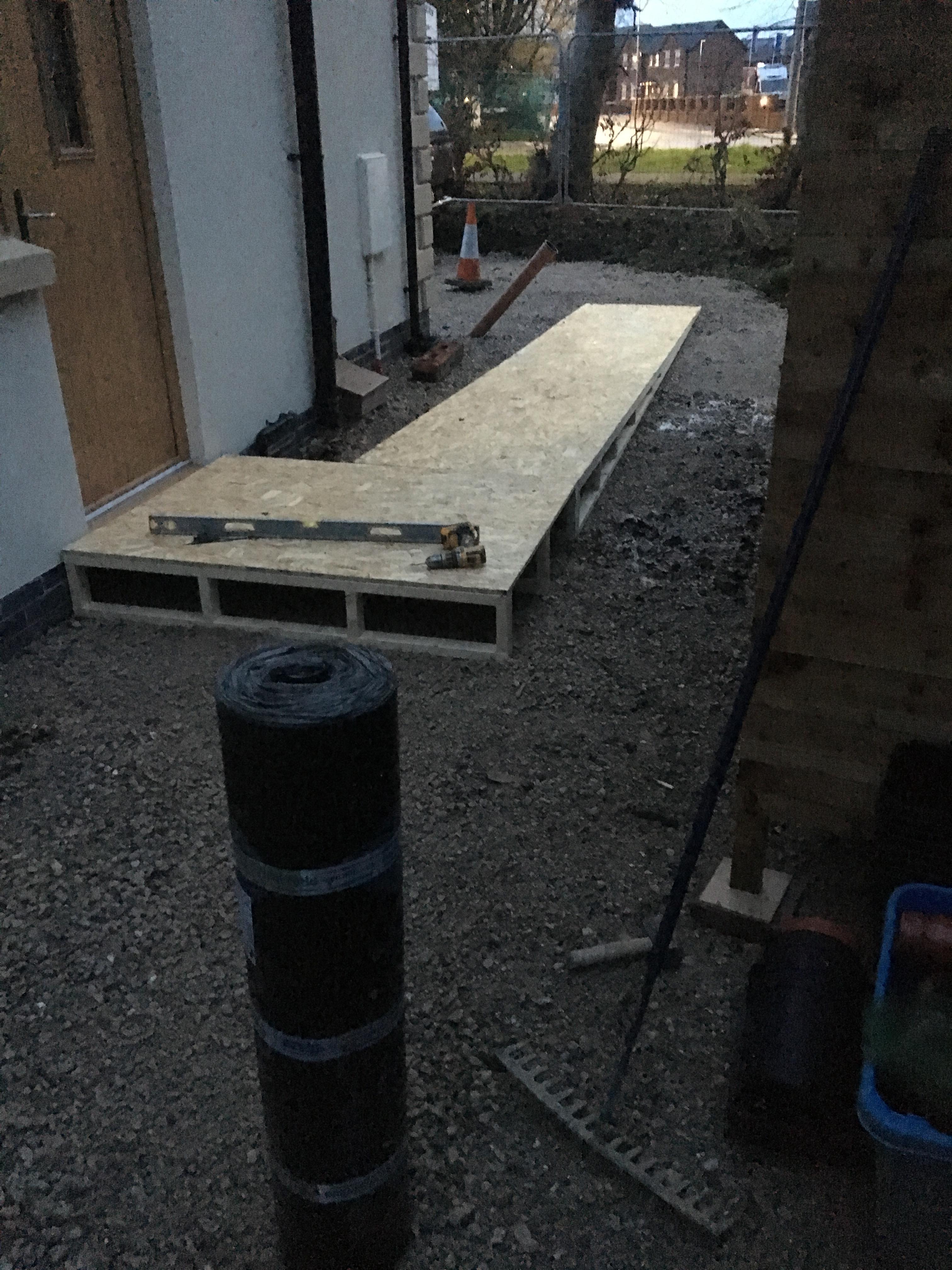

I’ve spent the afternoon making a ramp to satify the disabled part of our sign off
Ofcoutse it isn’t perminant but it should sufice Til we start the paving in the summer
I’ve already had a couple of skateboard jibes

I’m not sure why Dave
The remit I was give was a 1-20 slope
With a level 1200 x1200 platform in front of the door
All with a nonslip surface
No mention of material to be used

I told her planed a concrete flagged area as a temporary measure for the disabled access
She asked WHY and suggested timber
As long as it is 1-20 max fixed in place and of sound construction
She went on to tell me the flat level platform at the top is the biggest problem
Whith many builders sloping block paving upto the door with no level 1200 x1200 area at the top
I realise that I haven’t build a £750000  home to put Somthing like that at the side door BC must realise this But I’ve followed the There rules
