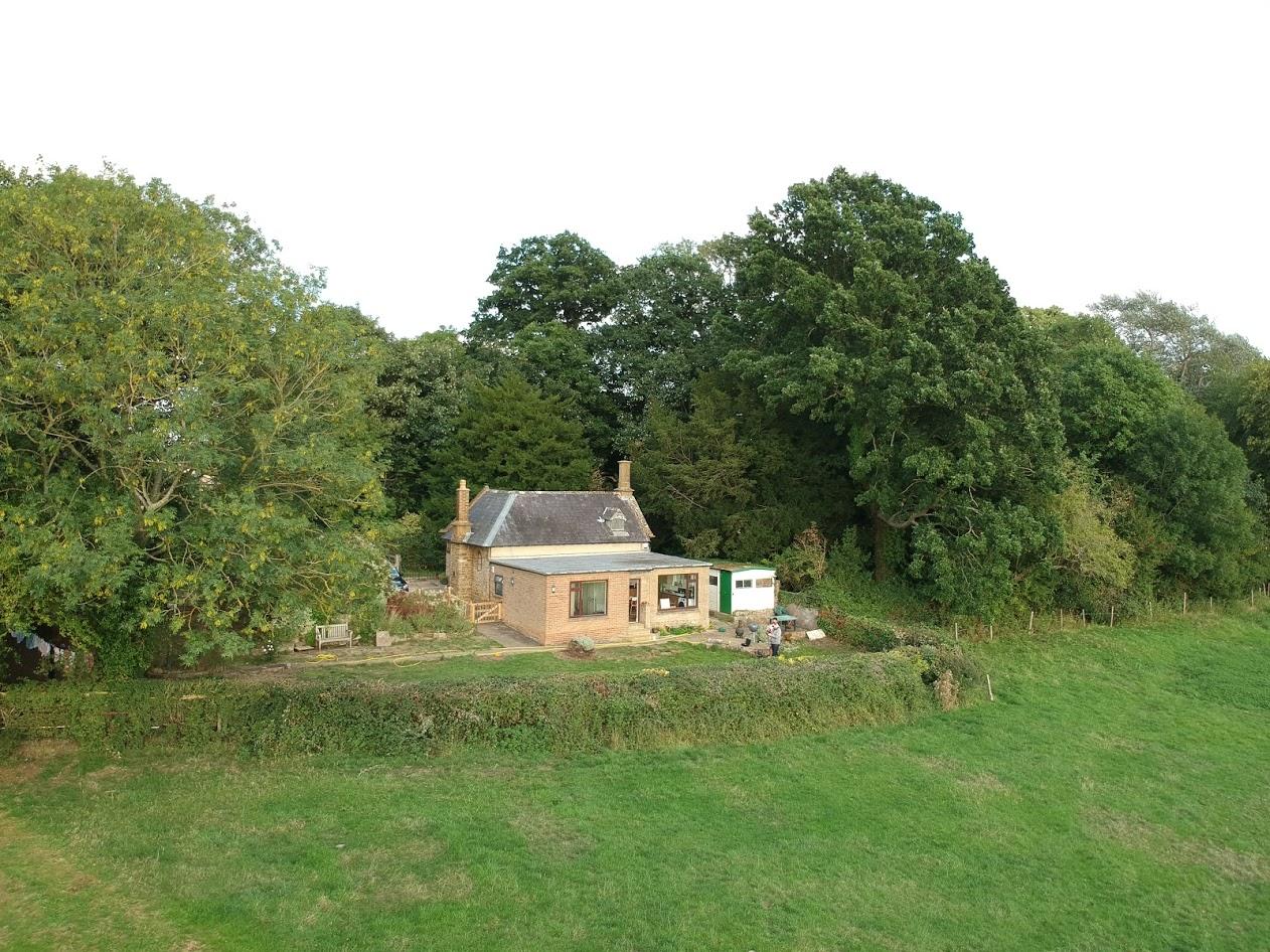

JulianB Posted January 18, 2020 Posted January 18, 2020 Evening All, Thought I'd revive this topic as I'm looking at sizing my ASHP! I've used JHarris's workbook to estimate the heat demand for our old cottage with proposed extension (I've weighted the wall U values from each type of wall construction to maintain the book's simplicity). I've assumed that I'd be able to get to an ACH of 2.5 (or better), and am targetting internal temps of 21degC. Based on minimum daily OAT stats, it looks like Jan will be the greatest CH demand. Using the same methodology as pg1, this gives me a 6kW ASHP requirement, without any safety margin, or any overhead for DHW (& assuming the ASHP is on for half the day). The question is, what should I be apportioning to DHW, given that currently I have no other means of heating this up (other than the immersion?). Also could I ask if it is common place for people to hook their ASHP up to a storage tank, which would then feed either CH or DHW, and avoid the unit switching on and off more regularly? I also quite like the idea of circulating the UFH at specific times of the day to help exploit solar gain in parts of the house. Any suggestions on units people have found to be reliable / good performers would be greatly appreciated! Heat loss through the year, using Met Office historic climate data for the location January February March April May June July August September October November December Mean daily OAT for each month (deg C, from Met Office) = 4 4 6 7.6 11 13.8 16.4 16.2 13.6 10.2 6.6 5 Mean daily delta T (deg C) = 17 17 15 13.4 10 7.2 4.6 4.8 7.4 10.8 14.4 16 Mean minimum daily OAT for each month (deg C, from Met Office) = 1.3 2.4 5.2 4.3 7 11 13.9 13.2 10.4 7.5 4.3 3.7 Minimum daily delta T (deg C) = 19.7 18.6 15.8 16.7 14 10 7.1 7.8 10.6 13.5 16.7 17.3 Days in month = 31 28 31 30 31 30 31 31 30 31 30 31 Mean OAT daily ventilation heat loss energy (J) = 2807805 2807805 2477475 2213211 1651650 1189188 759759 792792 1222221 1783782 2378376 2642640 Mean OAT daily ventilation heat loss power (W) = 780 780 688 615 459 330 211 220 340 495 661 734 Mean OAT daily fabric heat loss power (W) = 1818 1818 1631 1481 1163 901 658 676 920 1238 1575 1725 Total daily heat loss power for average OAT (W) = 2598 2598 2319 2096 1622 1231 869 897 1259 1733 2235 2459 Minimum OAT daily ventilation heat loss energy (J) = 3253751 3072069 2609607 2758256 2312310 1651650 1172672 1288287 1750749 2229728 2758256 2857355 Minimum OAT daily ventilation heat loss power (W) = 904 853 725 766 642 459 326 358 486 619 766 794 Minimum OAT daily fabric heat loss power (W) = 2071 1968 1706 1790 1537 1163 892 957 1219 1491 1790 1846 Total daily heat loss power for minimum OAT (W) = 2975 2821 2431 2556 2180 1622 1217 1315 1706 2110 2556 2640 Monthly heat energy input (kWh) for average OAT = 1933 1746 1725 1509 1207 887 646 667 907 1290 1610 1829 Monthly heat energy input (kWh) for minimum OAT = 2213 1896 1808 1840 1622 1168 906 978 1228 1570 1840 1964
