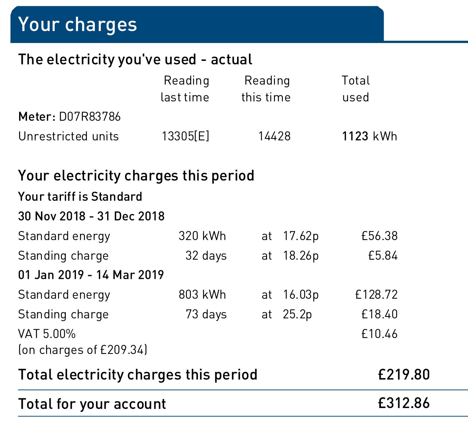

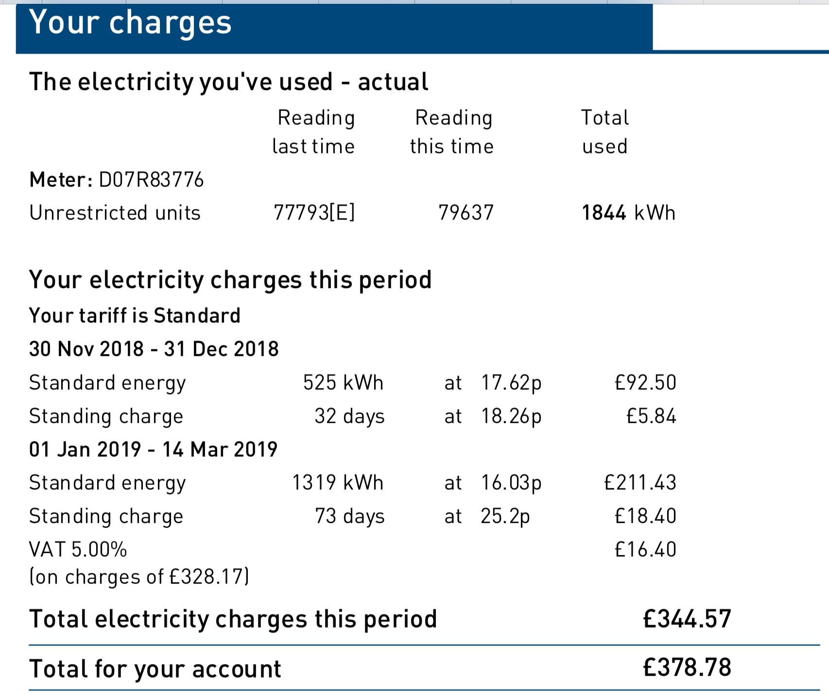

Cpd Posted March 28, 2019 Posted March 28, 2019 HELP ! As a single guy living frugally I was able to keep my electric bills just about under control - add in my partner moving in and 2 children and then (surprise surprise ) I get Chronic Fatigue Syndrome....... then skip 4 years and I’m in recovery and the realisation is ..... my electric bill is now out off control. Admittedly I have two houses, one cabin and a BIG shed... I have two supplies and two meters, both just standered ones. One in the cottage that has a spur to the cabin and one in the main house that has a spur to the shed. The house is lived in 24 hrs a day for 365 days a year, two children two permanent adults and at least one additional adult for 8 months the shed gets a LOT of use ( well I hide in there quite a lot.....) The cottage is in a state of renovation (long delay due to ill health) but obviously lights and power tools but NO heating the cabin is used extensively through the year, heating, hot water, lights etc. estimate of two adults for six months solid. The main house is total sh!te with very little insulation The cottage will be well insulated The cabin is poorly insulated..... The shed is uninsulated I had planned to get the cottage done and rent it out over the summer and live in it during the winter while I undertook the work on the main house but again those plans have been on hold or going very slowly for 4 years due to ill health. So over the last 4 years my usage has gone from aprox 2000Kwh to nearly 9000kwh Obviously this is just madness and I will be doing all I can bar moving into a cave to get things back under control, this is not going to be easy. I have one electric reader that you plug in to an appliance to see what it’s using but will get more ASAP and try and find out where all this electric is going....... pretty sure I need to switch electric provider as SSE have hiked there prices to eye watering levels. I am pretty sure this is all just down to me not paying any attention to this escalation and letting things slip as I was in no state to think about anything but getting better. But I wanted to put this all down (as embarrassing as it is) to make sure I’m not missing anything obvious or doing something really stupid, or some other random thing I have missed. I have included a copy of the last bills (one from each meter) And also an internet quote from bulb and octopus energy based on 9000kwh usage ( which I hope to dramatically reduce.....) if people have anything constructive to say in regards to this situation then I would love to hear it as I need to seriously deal with this mountainous task.....

Jeremy Harris Posted March 29, 2019 Posted March 29, 2019 I reckon you can probably get a quick win by just changing suppliers. I recently switched from SSEs E7 tariff to the E7 tariff from Bulb and saved well over £100 a year, just from that. You do need to check carefully on your local tariff prices, though, as I found that there are wide regional variations, so a supplier that's good value in one region may not be in another. If you choose to switch to Bulb (something we've found pretty painless) then this referral code will save you £50 (and knock £50 off my bill!): bulb.co.uk/refer/jeremyh2413 Worth looking if you can make enough of a saving by switching time of use of stuff to make changing to E7 viable. The general rule of thumb seems to be that if you can move about 35% to 40% of your consumption to the E7 period then you'll start to save money. Shift more to the E7 period and the saving ramps up (currently we've managed to shift usage so that we at around 56% at the off-peak rate, a significant additional saving over just switching supplier). Reducing consumption tends to be a fairly long process of identifying where you may be wasting electricity and doing something about it. The biggest single saving I made by doing this was discovering that our old fridge freezer was using loads more electricity than it should be, and changing it for a new one that only used about 1/3rd as much. Getting the other loads down, especially the plethora of low, but often always on ones, was hard work, and even now our background load is higher than I'd like it to be.
Ian Posted March 29, 2019 Posted March 29, 2019 (edited) If you have a low electricity usage it would be worth looking at one of the suppliers that offer a tariff with no standing charge. I'm using Scottish Power's "Power Up" tariff where you buy the energy up front but there's no standing charge. The more you buy the lower the unit charge - the most you can buy is a 6 month block. In 2018 my usage was 1,528 kWh of electricity and I paid £257.39 in total. That's 16.8p per kWh but I've saved approx £90 by avoiding the usual standing charge which means the equivalent tariff rate compared to a normal rate with a standing charge would have been about 10.9p per kWh. Edited March 29, 2019 by Ian
