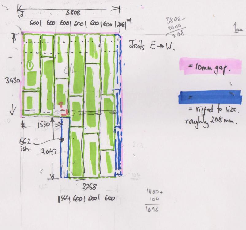

ToughButterCup Posted February 26, 2019 Author Posted February 26, 2019 51 minutes ago, Onoff said: [...] Cut edges much better. I'll do that, I agree... 16 minutes ago, Construction Channel said: I'm with dave cut it back so the tongue lands on a joist. Also measure the width of the room before you start to make sure you don't end up with a silly rip when you get to the other side We don't generally bother with noggins on lose ends but if you wanted to I would put it in the middle of the board Well, that settles it then. Did a drawing to try and get my head round it..... 29 minutes ago, PeterW said: [...] Work to the end, lay a spare full board face up over the last one laid (A), another on top but butted to the wall (B). Scribe a line on the one that is on top of the last fitted one (B), and that’s your cut line. NOW CUT IT Now take the spare bit, go back to the beginning of the new row and use it to start again as long as it goes over a minimum of 2 joists. [...] You assume some intelligence on my part Pete. I'll try this with a spare bit of batten : it'll go click when I do that 1
Construction Channel Posted February 26, 2019 Posted February 26, 2019 looks fine to me, 200mm is acceptable, you could rip 100mm off the first run to make the last board a bit wider but i wouldn't say its necessary, its when you end up with a little 60mm bit that you wish you had started differently
