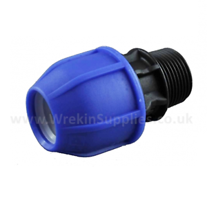

Nickfromwales Posted February 16, 2019 Share Posted February 16, 2019 Chuck a hozelock fitting onto the end of the hose and that gets you to 3/4". one of these screwed into the HL fitting some barrel or other then one of these ? Link to comment Share on other sites More sharing options...
