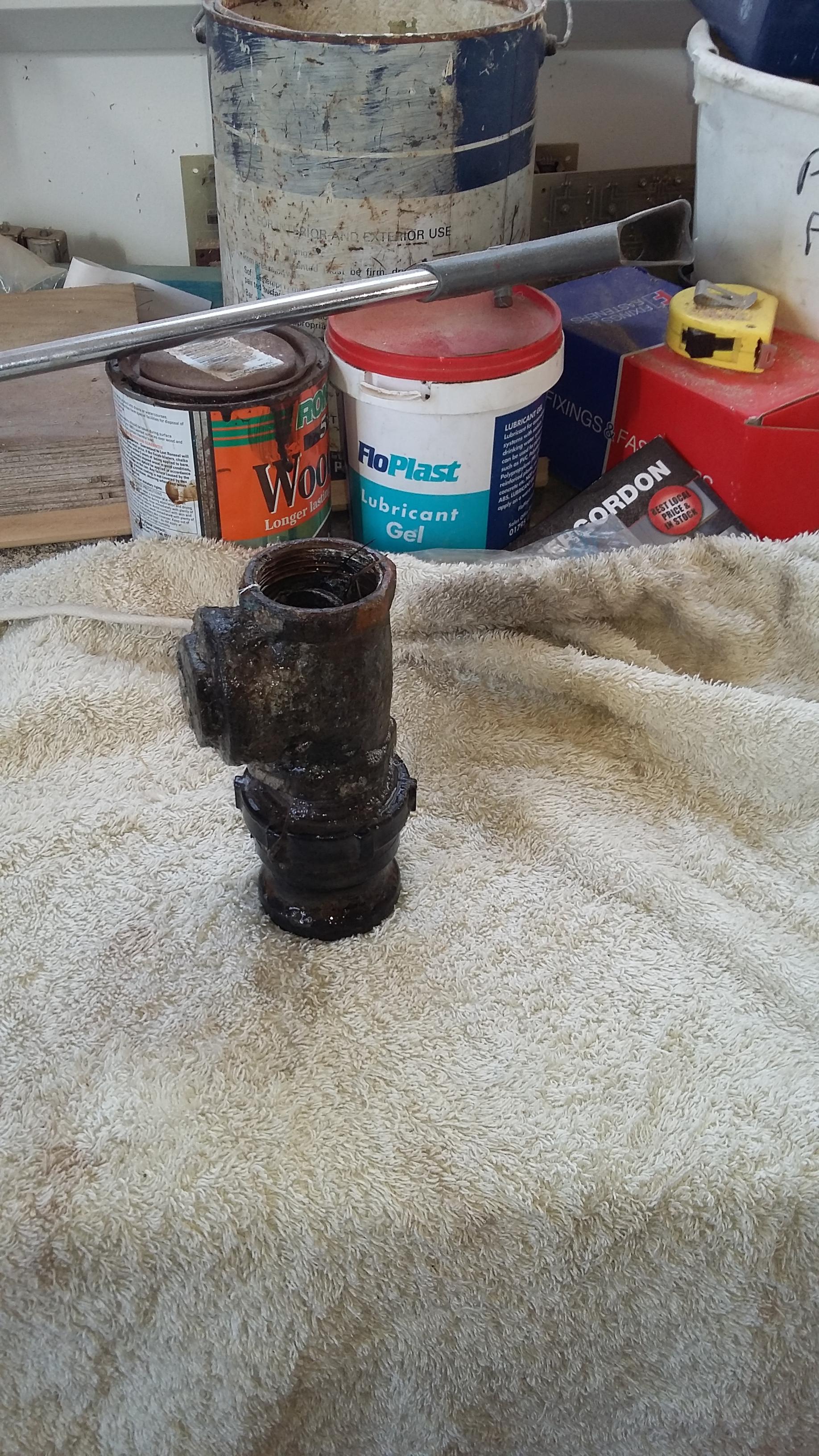

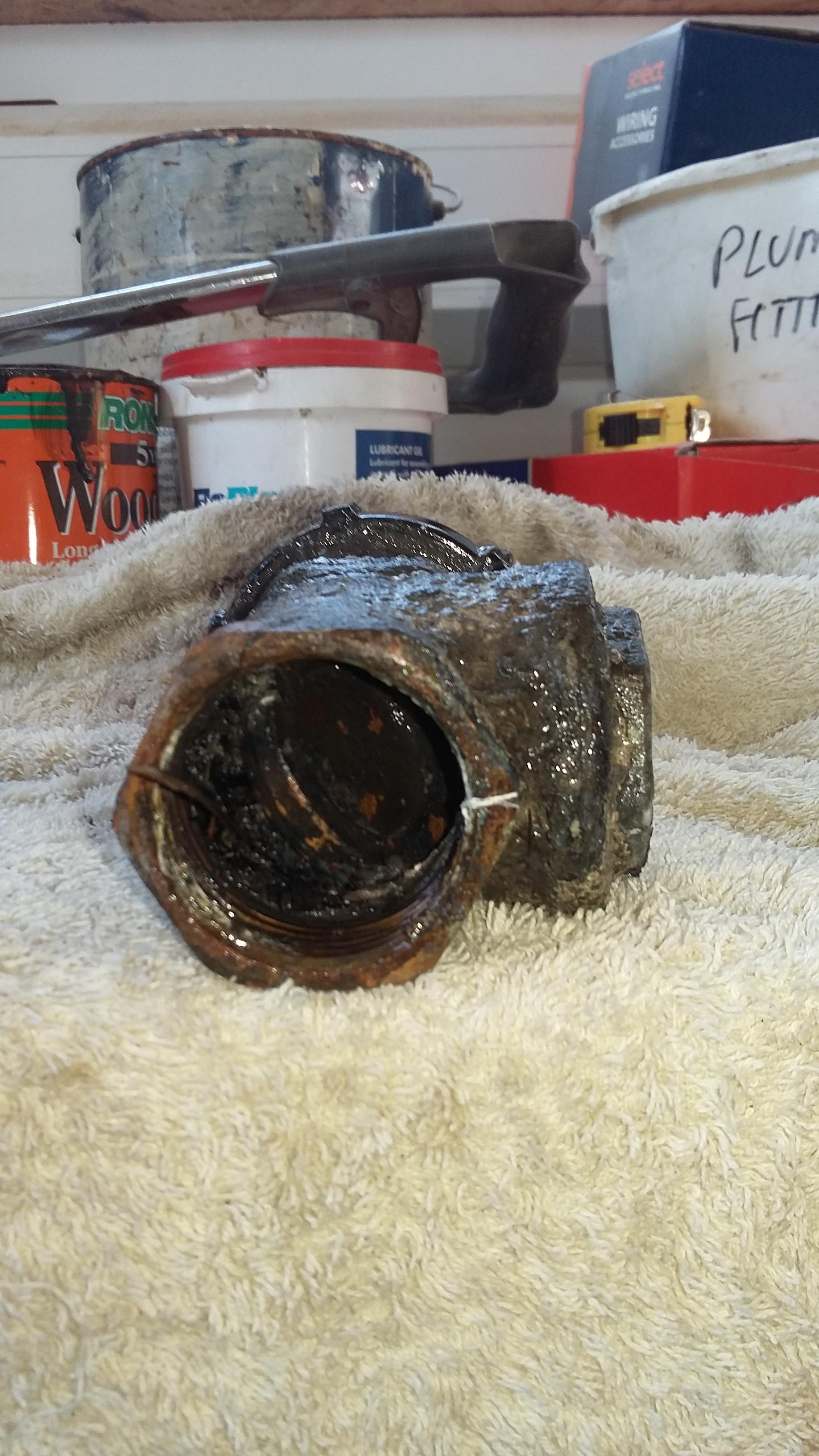

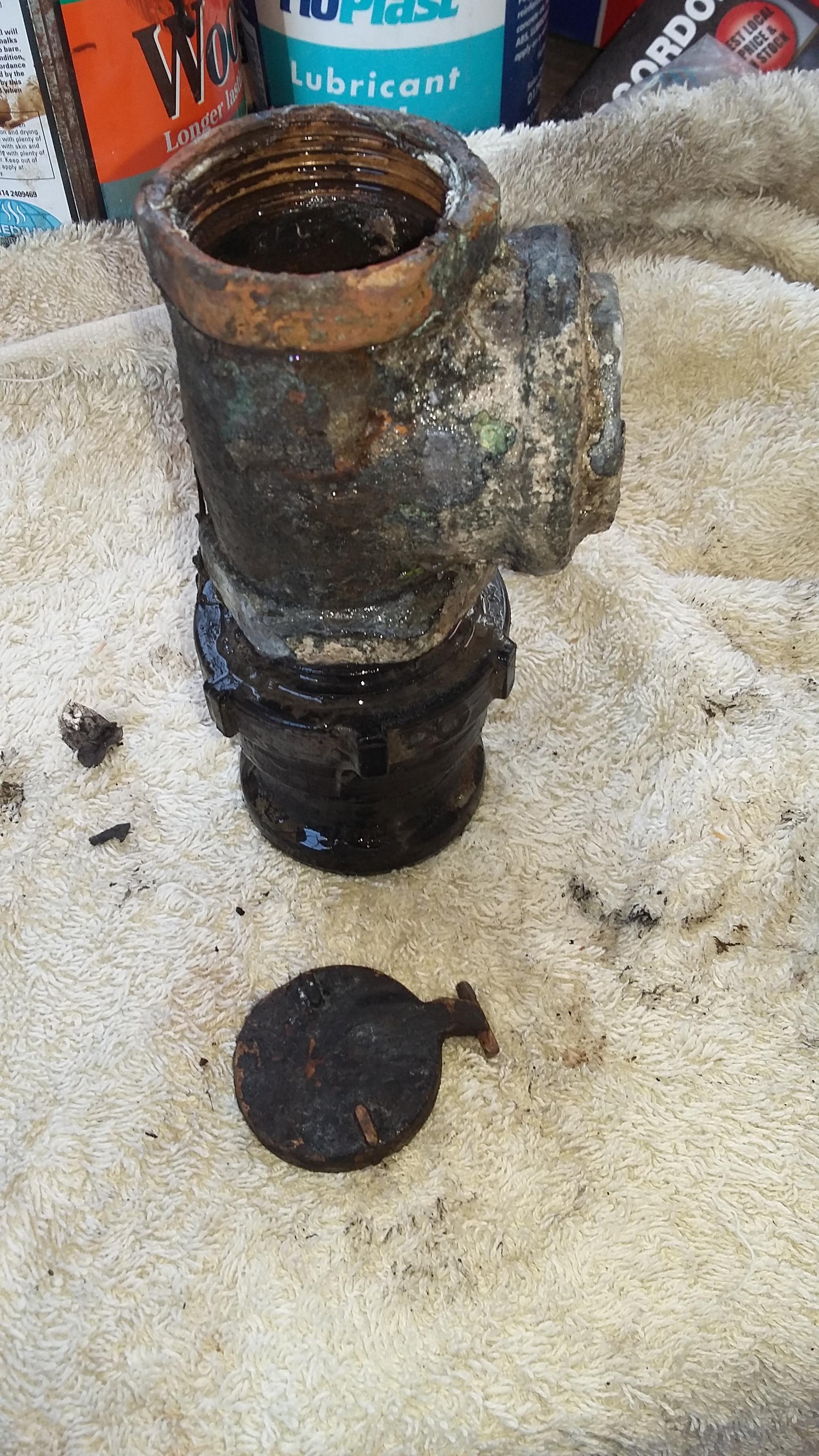

March 11, 20197 yr Author Okay all sorted this morning. Today, being the one good say in the weeks weather forecast, we set off with the intention of digging a hole in the field, But SWMBO talked me out of it. It was that fountain, or lack of fountain, at the upper test hole. WHY were we not seeing a fountain at that upper test hole. Se convinced me digging a massive hole by hand was going to be a waste of time. So we looked again at what was down at the bottom. We decided to scrutinise all the pipes and fittings within the pump chamber. There was this innocent looking fitting. It came as part of the pump chamber plumbing. It went between the 50mm mdpe elbow fitting, and the quick release pump hose fitting. There was never any mention of it being anything special. To me it just looked like they needed a female to female coupling and used a tee with a blank plug. It didn't look like it was any form of strainer. Once I had unscrewed it from the pump chamber it was obvious there was a problem, you could not see through it. . When I cleared it out, there was this what looks like a flap, wedged tight at the top of the fitting with various bits of debris packed in behind it. So it looks like this was a non return flap valve. There was never anmy mention with the pump chamber that it had one supplied, and it never worked as a non return valve as I fitted one attached to the pump at the bottom of the hose because it needed one and the one they didn't tell me they had supplied never worked. I made no attempt to put the flap back, I just cleared it out and put it back together as a dumb straight coupler. It is all now working, and now we did get a fountain out of the top test hole, albeit not very high. But the pump now clears the contents away up the hill into the soakaway at about the rate I always remember it working at. A big relief that the soakaway appears to be functioning correctly and no need to dig up the field. The digger man has been stood down.
March 11, 20197 yr Bugger, what a swine of a thing to find after all that trauma. I'm kicking myself, too, as our unit has exactly the same brass flap-type non-return on the pump outlet; I should have thought of it sooner, but the memory was only triggered when I saw your photo.
March 11, 20197 yr Author The bugger here is it was never described in the documentation with the pump chamber that it WAS a non return valve, although the instructions said you must fit a non return valve. That led me to buy a larger one and fit it on the outlet from the pump a short time later. And this one has never worked as a non return valve so the flap may have been detached all this time.
March 11, 20197 yr Could be the reason it's gone through a couple of pumps, too, perhaps. Maybe they've been working against that partial blockage right from the start.
March 11, 20197 yr Author Yes could be. The blockage is certainly the reason for the recent pump failure. It has the Itallian pump in now, identical to the one originally fitted so I hope this will give a good service life as now everything seems in order. I must say though I am very glad we ended up with a system that needs no pumping in the new house (the original plan had been a pumped outlet to a filter mound) Although we never got to dig the big hole and inspect it, the soakaway does now appear to be draining freely.
