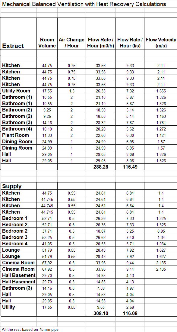

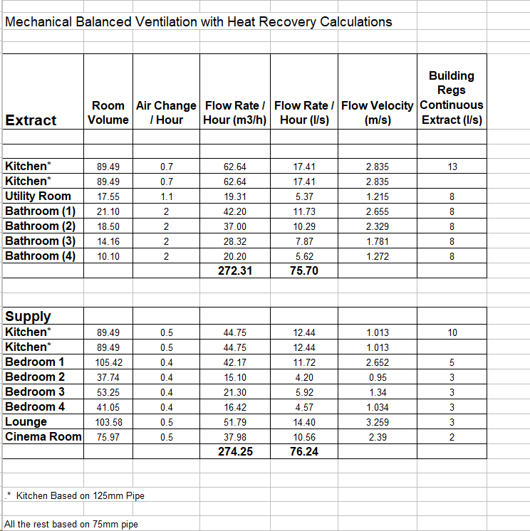

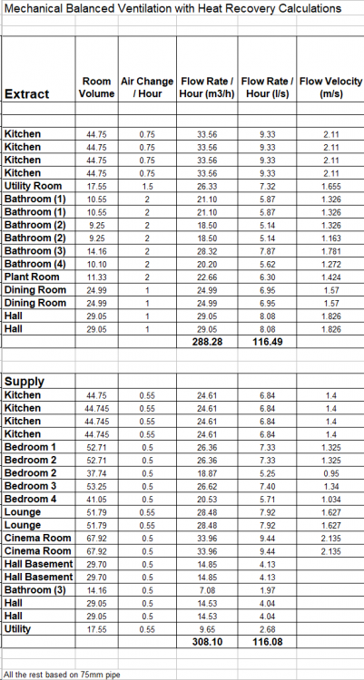

Triassic Posted February 14, 2019 Author Posted February 14, 2019 (edited) @JSHarris Thanks for the feedback, just a couple of questions.. The 0.3 l/s per m² - is this the internal floor area of the rooms being subject to ventilation or the whole house floor area? Could you clarify where the 177 figure comes from? Edited February 14, 2019 by Triassic
Jeremy Harris Posted February 14, 2019 Posted February 14, 2019 (edited) On 14/02/2019 at 16:56, Triassic said: Thanks for the feedback, just a couple of questions.. The 0.3 l/s per m² - is this the internal floor area of the rooms being subject to ventilation or the whole house floor area? Could you clarify where the 177 figure comes from? Expand The floor area figure used is the internal floor area of all floors in the house added together. I thought you'd posted earlier that your floor area was 177m², hence the use of 177 in the sum, but I may have got that wrong. Edited to add: Just realised I have got the floor area wrong. I saw 177m³ and misread it as 177m². If the internal floor area is 310m² then the total supply (or extract) rate needs to be 0.3 x 310 = 93l/s Edited February 14, 2019 by JSHarris Realised I'd got the area wrong...
Triassic Posted February 14, 2019 Author Posted February 14, 2019 (edited) Ah right.. The total internal floor area of the house (every room, over all three floors = 388m2 So 388 x 0.3 = 116 l/s So having reworked the calculations to us 75mm pipe throughout and use more pipes to reduce the velocity, the total flow rate / hour= 75. If I understanding this correctly I need to extract an additional 41l/s to get the rate up to 116 l/s? Edited February 14, 2019 by Triassic 1
Jeremy Harris Posted February 14, 2019 Posted February 14, 2019 You'll probably find that figure dominates the others given in building regs, as it usually does. It will also over-ventilate the house by a fair bit, as 177m³ at the typical PHPP ACH of 0.3 would mean a whole house ventilation rate of around 15l/s, and the ~0.4 ACH figure we run ours at would give you around 20l/s.
Triassic Posted February 14, 2019 Author Posted February 14, 2019 So having reworked the figures and based on a total floor area of 388m2 x 0.3 ACH the whole house ventilation rate is 116 l/s . It's starting to look like a very large MVHR system with lots of pipes!
Jeremy Harris Posted February 14, 2019 Posted February 14, 2019 Looks about right to me. It's a shame that the building regs mandated figures are so high, especially in your case where the disparity between the floor area-mandated rate and the sensible ventilation rate is so great. I think you could probably rely on having the MVHR running at a higher than normal level in order to achieve BR compliance, through, then wind it down to something more sensible as others have done. This might mean you could accept duct velocities of around 2.5m/s in order to achieve the BR rates, secure in the knowledge that in reality you'd be running at a lot lower flow rate pretty much all the time.
