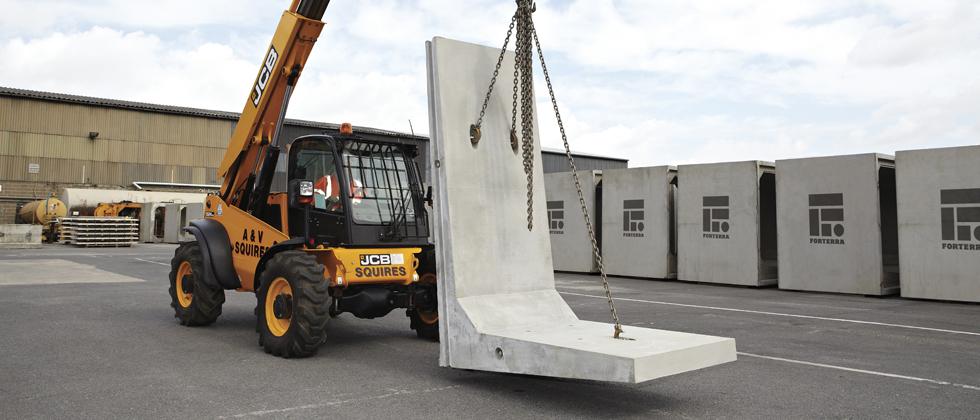

iSelfBuild Posted February 8, 2019 Posted February 8, 2019 Have you considered precast concrete? I built a very large reinforced block work retaining wall... never again. Took us months to get out of the ground, it burst on us in the first pour. Loads of photos here: https://www.facebook.com/pg/iSelfBuild/photos/?tab=albums I'm a consultant within precast concrete (the manufacturing side of things) and a lot of manufacturers are starting to offer retaining wall units with waterproof tanking pre-installed. Mainly used on commercial projects for now. That is the way I would go if I do another retaining wall.
ProDave Posted February 8, 2019 Posted February 8, 2019 6 minutes ago, iSelfBuild said: Have you considered precast concrete? I built a very large reinforced block work retaining wall... never again. Took us months to get out of the ground, it burst on us in the first pour. Loads of photos here: https://www.facebook.com/pg/iSelfBuild/photos/?tab=albums I'm a consultant within precast concrete (the manufacturing side of things) and a lot of manufacturers are starting to offer retaining wall units with waterproof tanking pre-installed. Mainly used on commercial projects for now. That is the way I would go if I do another retaining wall. Is that the system I saw on a job last year? An old leaning garden retaining wall, holding back about a metre of soil. the replacement "wall" seemed to comprise H profile steel beams concreted quite deep into the ground, and then pre cast concrete panels lowered into the beams.

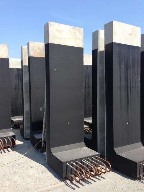

iSelfBuild Posted February 8, 2019 Posted February 8, 2019 More like this, you can see a T + G profile in the edge, these can have connection wire ropes embedded and filled with grout for high load situations which make it monolithic. Also exposed rebar can be left at the edges for additional casting on site to make it monolithic.
scottishjohn Posted February 8, 2019 Posted February 8, 2019 (edited) 34 minutes ago, iSelfBuild said: More like this, you can see a T + G profile in the edge, these can have connection wire ropes embedded and filled with grout for high load situations which make it monolithic. Also exposed rebar can be left at the edges for additional casting on site to make it monolithic. and how much each are those pieces ? before you tell me i know now no self builder could afford them or use them to build a basement with them . ICF will do anything you need for a domestic build at affordable prices Edited February 8, 2019 by scottishjohn
iSelfBuild Posted February 8, 2019 Posted February 8, 2019 (edited) I have absolutely no idea on price, it would depend on so many job specific factors. I know a few precasters welcome residential projects. Edited February 8, 2019 by iSelfBuild
Bitpipe Posted February 8, 2019 Posted February 8, 2019 (edited) I think you'd struggle to get a waterproof join between those. The contractor I used knocked out my 110m2 basement with 42 liner metres of 2.5m high walls in about 3 weeks and not even the slightest sign of a breakout but they were using industrial quality shuttering and were very experienced. Rebar work was impeccable too (all 14t of it) they even spotted a few mistakes in the SE drawings which they sheepishly acknowledged when I called them up about it. The BCO turned up for a pre-pour inspection and left after 10 mins saying he didn't need to see any more Cost was about £1000/m2 - i.e about £100k for the whole basement including excavation, muck away, drainage, the basement itself and backfill with clean stone. Edited February 8, 2019 by Bitpipe 1

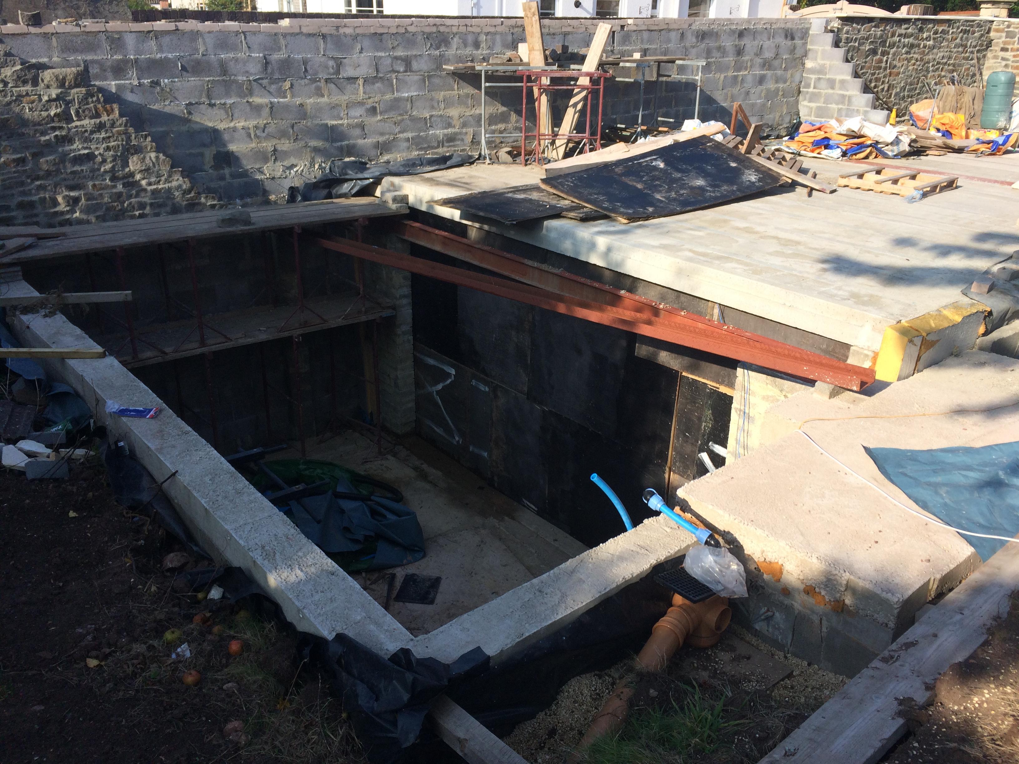

Pocster Posted February 9, 2019 Posted February 9, 2019 (edited) 6 hours ago, cherryfountain said: Has anyone on here used Stepoc blocks for basement walls? What are the pros and cons for this system? Yep ! Worked great ! Simply bed the first course then off you go . I had to add rebar in as I went . I shuttered any corners before the pour . Poured the whole lot in 1 go ! ; few minor issues but no real problems I insulated on the outside . Also land drain at base . Internally I will have membraned walls going into an internal drain then out to sump . The main thing is that stepoc is an easy diy approach - Christ ; I did it so it must be ! . Edited February 9, 2019 by pocster 1
