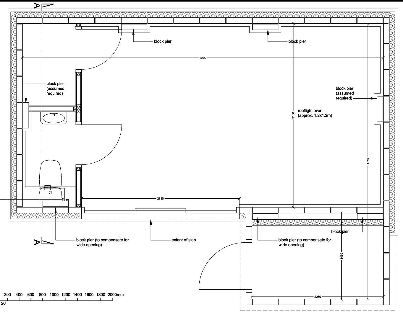

bikerchris Posted May 10, 2021 Author Share Posted May 10, 2021 Hello all, I thought it had been a while, and it had! As you were all so helpful, I just wanted to give an update. I've finally gotten round to starting the office build. Here's a pic of the final design...it changed quite a bit: I've removed the shed, dug out and shuttered as of a few days ago, concrete pour happening next week. Link to comment Share on other sites More sharing options...
Conor Posted May 11, 2021 Share Posted May 11, 2021 Very tidy. Why is your soil pipe white? Should be red/brown for underground use I would have thought? 1 Link to comment Share on other sites More sharing options...
bikerchris Posted May 11, 2021 Author Share Posted May 11, 2021 Thank you, I've tried. The white pipe is just something for me to get the water supply in. When I have time, I'll dig under slab, then dig a trench 750mm deep to house and lay MDPE. The gradient is bad so I have to get a maserator ? Link to comment Share on other sites More sharing options...

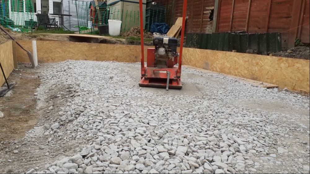

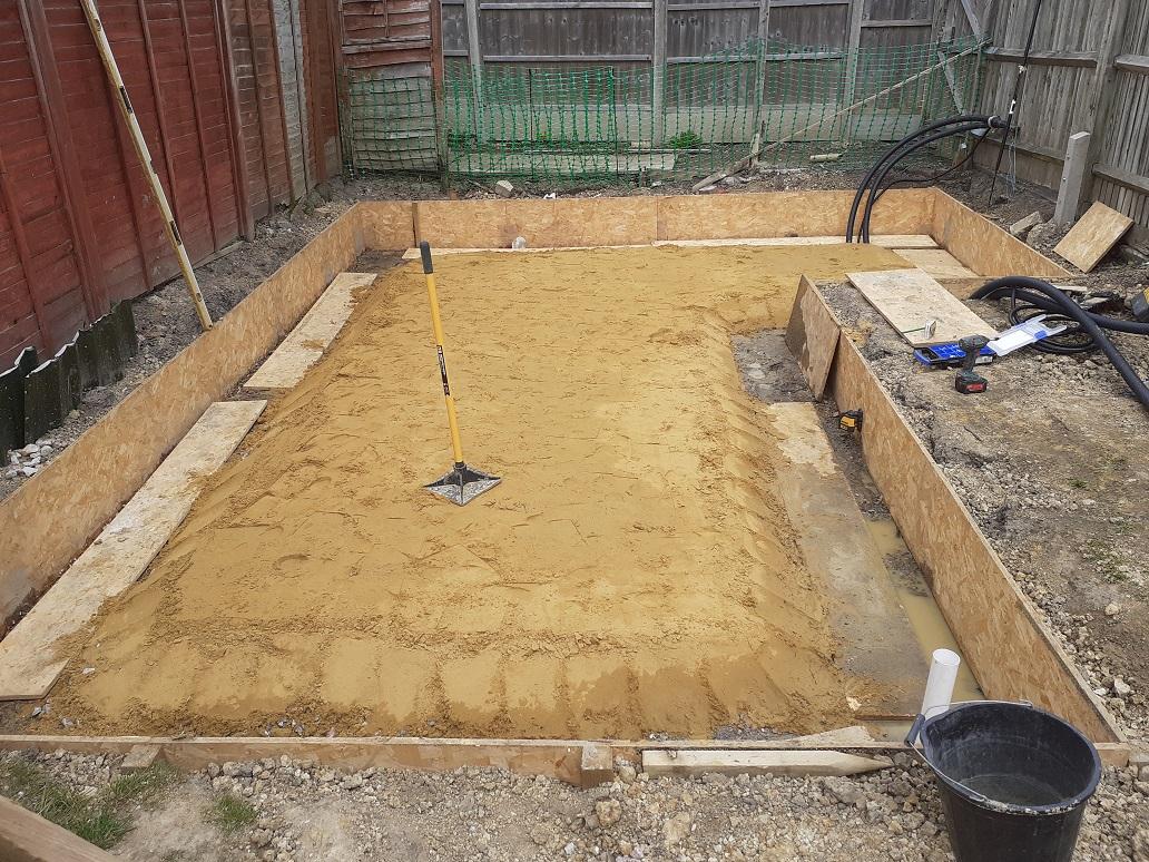

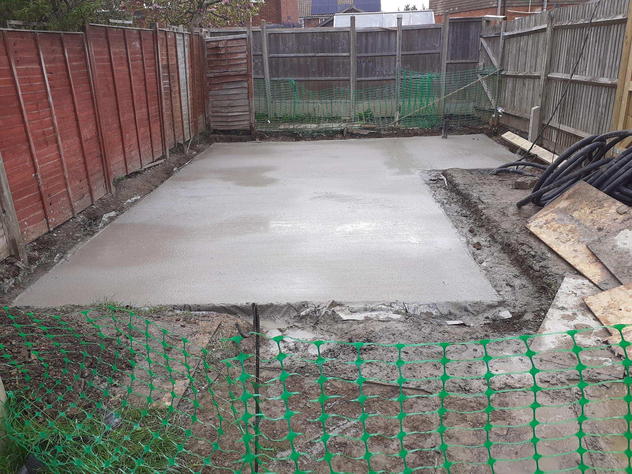

bikerchris Posted May 17, 2021 Author Share Posted May 17, 2021 Hi all, Might be the wrong thing to do, and may be I should create another post, but I finished the slab today (with a little..well, a lot of help from my friends). 1 Link to comment Share on other sites More sharing options...
