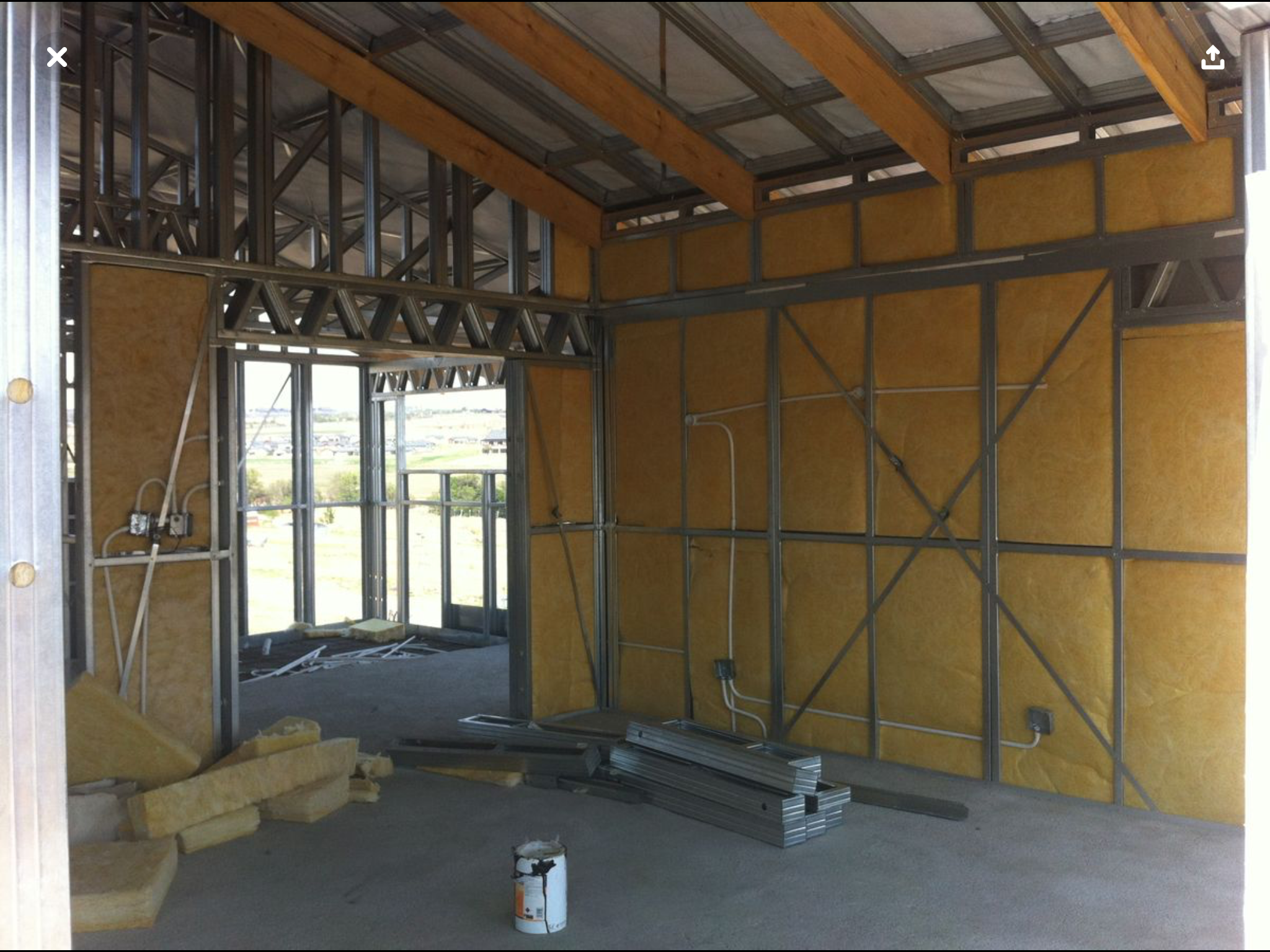

Only put about 1 minutes thought into this, could you put up steel track n stud wall and spray foam the back side against the granite fully filling to the face of the studs.
Stud wall 70 mm, gap behind for wobbly granite 10-15 mm total 100mm with plasterboard
so 88mm of closed cell spray foam.

What you are describing is what I see regularly on Scottish stone houses. Usually done VERY badly.
The inside face of the stone wall is way too irregular to just fix insulation to and hope for it to be flat.
Usually a 50mm frame is installed, as already noted with the thin studs being supported at intervals with fixings and packers from the stone wall.
If you are lucky a bit of insulation might be poorly fitted between the studs before the plasterboard. Usually though  nothing.
And the last poor detail that makes it so rubbish is the top and bottom of the gap so created is usually open so cold air enters from the loft creating the ubiquitous "plasterboard tent"
To do this properly, you need to make your frame fixed to the walls.  Then line the entire wall with well detailed and well sealed sheets of insulation paying particular attention to seal the top bottom and all edges (expanding foam?) so no air can enter behind from outside.  Then on the inside of your now well sealed insulating box you need to fix battens to create a service void so pipes and cables can all run inside without penetrating the insulation and letting cold in.
It all comes down to getting the detail right.
