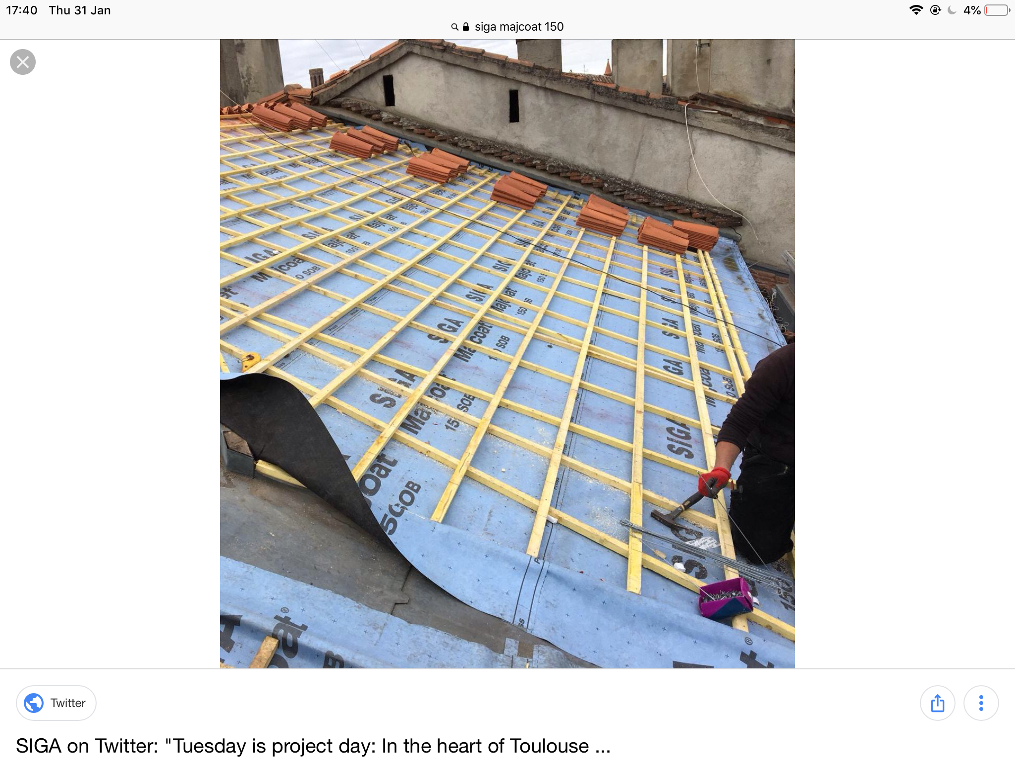

Russell griffiths Posted January 31, 2019 Share Posted January 31, 2019 i would put the membrane directly on top of the sarking boards and then your counter batten but it works both ways, many ways to skin a cat i just like the look of the membrane on top of the sarking with lapped and taped joins i had the siga rep down this week and we were talking about this very thing. 2 Link to comment Share on other sites More sharing options...
Russell griffiths Posted January 31, 2019 Share Posted January 31, 2019 Like this. Link to comment Share on other sites More sharing options...

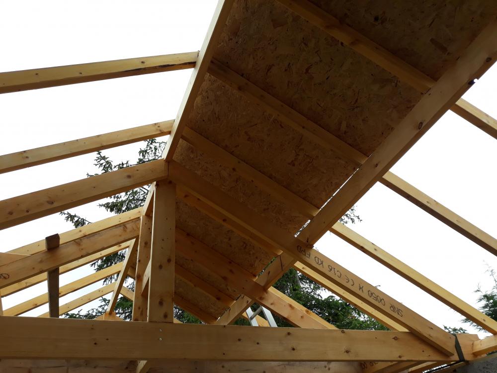

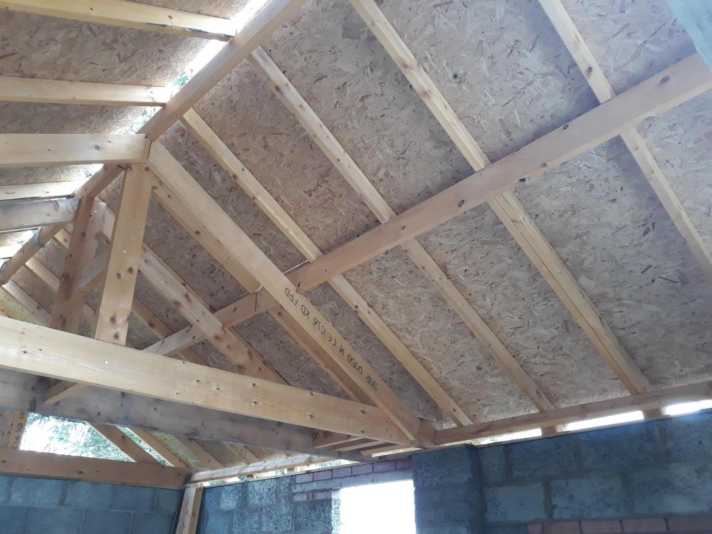

Jeremy Harris Posted February 1, 2019 Share Posted February 1, 2019 This has made me go back and check the spec for the OSB we have as sarking and as racking layer on the outside of our frame. It seems I was wrong about the specs. The sarking is 18mm OSB, T&G boards that seem to be specified for use as sarking boards, but there's nothing in the spec about what they actually are. I suspect they may well be roofdek, or similar, as looking at the photos the boards seem to be a lighter colour than the OSB/3 boards. Our racking layer wall boards are definitely 9mm OSB/3. Both the walls and roof have a ventilated space that should ensure that water vapour can escape from the boards OK. I may try and see if I can try and measure the RH at the surface of the boards, as it shouldn't be too hard to get a sensor up under the eaves and in contact with the board surface. Not sure how useful the data might be, but it'd be interesting to see the relationship between the RH of the air outside and that at the surface of the boards. Have to wait until summer, though. It's still snowing here, has been on and off since yesterday evening. Link to comment Share on other sites More sharing options...

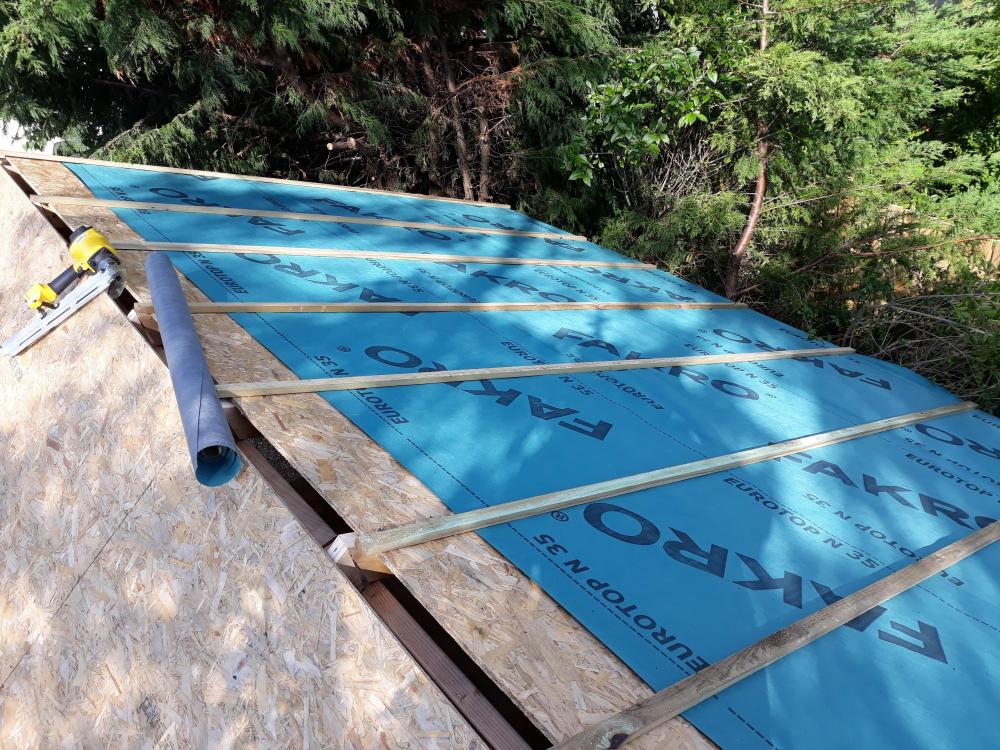

scottishjohn Posted February 1, 2019 Share Posted February 1, 2019 I would follow the way kingspan do it on the sips roofs osb -membrane ,vertical battons then cross battons +slates I have seen some that like a second layer of membrane between the 2 sets of battons as another water shedding layer should n,t be a a problem if VPC is correct and edges tape sealed well. roof should be cold anyway with a draft up it If your OSB is warm --then insulation in roof is crap +air leaks and if you really want to be belt and braces use the peel and stick type of membrane on the osb , nothing getting through that from outside Link to comment Share on other sites More sharing options...
