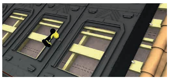

BMcN Posted January 25, 2019 Share Posted January 25, 2019 Has anyone used GSE in roof system? It is not clear in the manual where to pass the cables through. I presume you can just drill a hole anywhere in the centre of the mount, as this should be a dry area, and pass the cable through? Thanks Link to comment Share on other sites More sharing options...
Jeremy Harris Posted January 25, 2019 Share Posted January 25, 2019 Yes, we have the GSE system. No need to drill any holes anywhere for cables, they run into the big hole in the centre and then out under the battens at either side. Link to comment Share on other sites More sharing options...
BMcN Posted January 25, 2019 Author Share Posted January 25, 2019 5 hours ago, JSHarris said: Yes, we have the GSE system. No need to drill any holes anywhere for cables, they run into the big hole in the centre and then out under the battens at either side. Sorry I just screenshotted that from the manual to show the centre. I wasn't suggesting drilling the GSE mount. Mine are mounted on sarking as we are in Scotland, so unable to run cables under the straps/battens. I presume for me I will need to just run each set of connectors through the sarking in the centre of every mount and do the connections inside? Link to comment Share on other sites More sharing options...
Jeremy Harris Posted January 25, 2019 Share Posted January 25, 2019 12 minutes ago, BMcN said: Sorry I just screenshotted that from the manual to show the centre. I wasn't suggesting drilling the GSE mount. Mine are mounted on sarking as we are in Scotland, so unable to run cables under the straps/battens. I presume for me I will need to just run each set of connectors through the sarking in the centre of every mount and do the connections inside? How are you providing the essential ventilation under the panels? The panels need cooling, from air flow underneath them, hence the need to raise them on battens fitted to counterbattens, as shown in that screen shot (which is exactly as ours are fitted). We also have sarking, but that's overlaid with counterbattens that run along the line of each rafter, then battens to which the frames and slates are fixed. Link to comment Share on other sites More sharing options...
BMcN Posted January 25, 2019 Author Share Posted January 25, 2019 Both wagner and midsummer said that the mounts could be fixed directly to the sarking. It is a garage roof so will never be a warm roof. Link to comment Share on other sites More sharing options...
Onoff Posted January 25, 2019 Share Posted January 25, 2019 11 minutes ago, BMcN said: Both wagner and midsummer said that the mounts could be fixed directly to the sarking. It is a garage roof so will never be a warm roof. I think its more for ventilation under the panels. Keeping the panels cool I believe improves efficiency too. Link to comment Share on other sites More sharing options...

Jeremy Harris Posted January 26, 2019 Share Posted January 26, 2019 With respect to the UK resellers, I'd suggest that they aren't aware of the essential requirement to provide ventilation under all PV panels and I'd question how much real world experience they have with installing in-roof PV systems. It doesn't matter whether the underlying roof is warm or cold, as the heat comes from the sun shining on the panels. They can easily reach temperatures of 50 deg C plus in bright sun, and that heat needs to be got rid of, and the way all PV panels are designed is for over-heating to be alleviated by free air ventilation under the panels. That's why both Easyroof and GSE show the same fixing method for the in-roof frames, with spaces above the sarking provided by counterbattens to allow the essential ventilation. The eaves and ridge ridge also need to be ventilated to allow air to flow up the roof behind the panels. The main problem is that the panels will have a much reduced output if they run hot, plus the reliability may be impacted, too. Anything you can do to aid the cooling of the panels will improve both performance and reliability. Link to comment Share on other sites More sharing options...
