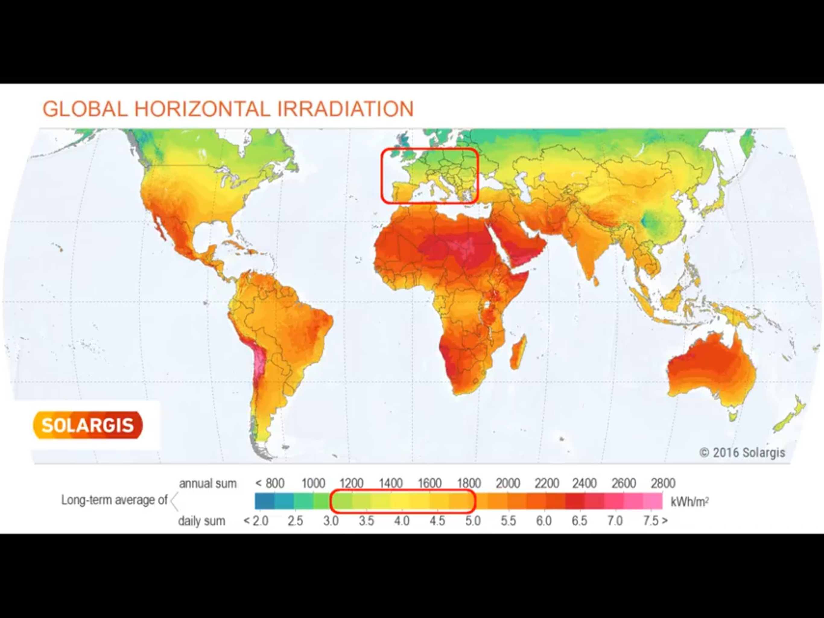

K78 Posted April 4, 2019 Share Posted April 4, 2019 (edited) On 17/01/2019 at 11:16, Big Neil said: Amendment to building regs to require each new house to have a minimum of 2 solar panels in roof. Maybe not JOB DONE, but its a start at least. How many of us have been given a DVD or VHS for Christmas and ended up buying the series. Same habit would apply i reckon. What would 2 PV panels achieve in the uk? As the map shows we are the one country that shouldn’t bother. Yet we have more PV than countries in Southern Europe. Because some idiots in Westminster thought it would be something to boast about if they subsidised it. The rest of the world laughs. Just like they do about brexit. We need to replace the inbred, political classes that have never lived in the real world. With real people. Edited April 4, 2019 by K78 1 Link to comment Share on other sites More sharing options...
sam Posted April 4, 2019 Share Posted April 4, 2019 19 minutes ago, K78 said: As the map shows we are the one country that shouldn’t bother. Yet there have been some grid scale subsidy free PV built in the UK and there will likely be many more to come. Onshore wind is marginally cheaper but with planning near impossible PV is currently the cheapest form of generation. Cost effective sites are under £500k/MW to build. The market for building on your own roof top (either residential or industrial) is distorted as 'private wire' avoids the grids distribution charges but this is likely to change soon. On 05/02/2019 at 12:29, Ferdinand said: Does anyone know if more offshore wind will be built around the UK? Yes - off shore wind is still being subsidised with CfDs. I was recently involved in financing an almost 1 GW project which is now under construction. On 17/01/2019 at 15:09, Big Neil said: Guesstimate question. How much a 1MW grid tied battery installed and ready to go? based on the Tesla one in Australia a simple division puts it somewhere around £450 grand. What think we? That's about right: £450k-£500k/MW (or MWh as most are just over 1 hour) for containerised batteries. These are currently being built almost subsidy free given National Grid's Capacity Market is almost negligible for batteries. Link to comment Share on other sites More sharing options...
Ed Davies Posted April 4, 2019 Share Posted April 4, 2019 1 hour ago, K78 said: As the map shows we are the one country that shouldn’t bother. Yet we have more PV than countries in Southern Europe. Because some idiots in Westminster thought it would be something to boast about if they subsidised it. The rest of the world laughs. PV is well worthwhile in the UK as a good complement to wind. It's the countries in southern Europe with less that we should be laughing at. 2 Link to comment Share on other sites More sharing options...
K78 Posted April 4, 2019 Share Posted April 4, 2019 1 hour ago, Ed Davies said: PV is well worthwhile in the UK as a good complement to wind. It's the countries in southern Europe with less that we should be laughing at. On a individual basis for a self builder? I’m not being argumentative by the way. It’s a genuine question. Governments in Southern Europe don’t see the initial investment as worth it for the return. The reasons we see so many in the uk, are the ridiculously high initial FIT (now scrapped) and the usual salesmen and cowboys jumped on the bandwagon. Many people were conned into thinking they were getting free solar panels. When in fact the installers were taking the FIT and using their roofs. I honestly think the whole situation is a scam, but it’s only my opinion. Similar with EWI grants. Although at least EWI works even if the price is ridiculous. As soon as the grants started, so did the 2 day £2000 courses to become a “certified” installer. The fact we have the highest percentage of homes with solar panels in Europe, when we have the worst conditions for them is crazy. Shows what inept fools we have at the top level making these decisions. The money put into pushing solar could have been much better spent. Wind obviously makes sense in the uk, but solar? I remember when they were telling us diesel cars were “green”. I don’t think we should be laughing at any country in the Eu at the moment. I’m genuinley ashamed at the current state of the uk. Link to comment Share on other sites More sharing options...
