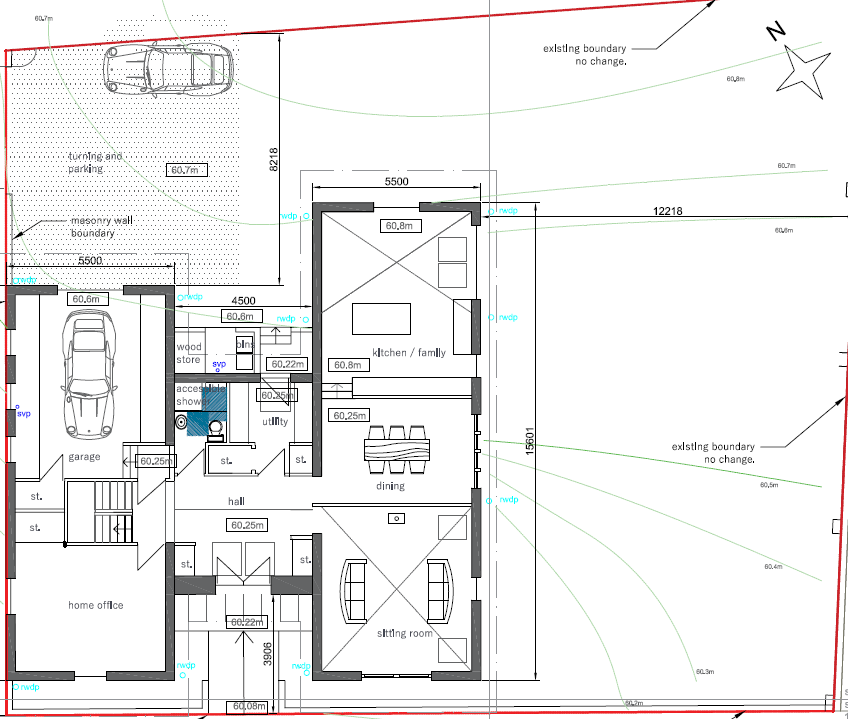

kingie573 Posted January 16, 2019 Posted January 16, 2019 Good Afternoon folks! Below is a copy of our plans that have just been submitted to planning. We would like to hear anything you think would cause issues or give advice for changing anything prior to getting the technical drawings done for build regs. TIA

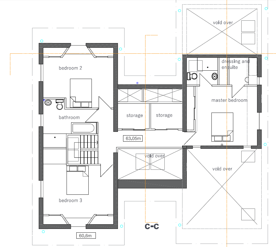

Big Neil Posted January 16, 2019 Posted January 16, 2019 (edited) I like more or less everything about that. Have I read right that the only access to the kitchen is through the dining room? How come only 3 bed instead of 4? Edited January 16, 2019 by Big Neil
Weebles Posted January 16, 2019 Posted January 16, 2019 Is it right that the front door is the other side of the house to the parking? I am just thinking of the inevitable unloading of shopping to the kitchen........maybe through the back door / utility? How are you going to actually use the house / garage / parking? We had stepped levels between our kitchen / diner in our first planning application. Removed them at the second stage because was causing additional construction costs and complications and we felt they removed flexibility if we ever needed to seat more people at an extended table. Does your partition between kitchen and dining room go full height?

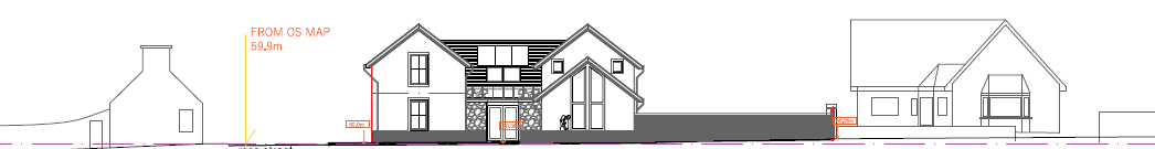

Russell griffiths Posted January 16, 2019 Posted January 16, 2019 Is that correct in that your gutter and roofline over hang the boundary.
TerryE Posted January 16, 2019 Posted January 16, 2019 (edited) I really do wonder why it is still popular to include a garage within the fabric of the house. If you price out the cost per m², then this is bloody expensive off-road parking -- especially as most people end up using it as an inefficiently laid out glory hole because of the hassle of getting a modern-sized car into a standard garage opening. This is especially in your case where the turning circle for access doesn't even comply with highways guidelines. My advice is to lose the garage and use the space for something more functional. Modern cars don't really need garaging in the UK; using decent powered gates can provide secure and a lot more cost-effective off-street parking. As @Weebles suggests: really consider losing the split levels. These are a real PITA for construction and will add to costs. Also a big downer in terms of mobility access. Yes, your site has a gradient, but any competent architect should be able to do the cut and fill calcs so that you can level the site at least covering the foundation area and parking. (Extend this level area in front of the kitchen. Even if you don't want to park here regularly, having this as overspill when friends and family are using BR 2 and 3 is really useful.) This amount of moving soil and levelling within the site is cheap -- and a lot cheaper in terms of overall build costs. It only starts to become expensive if you have to move a lot of soil and subsoil off site. I see that you have a "wood store". Why? If you are planning a wood-stove then where are you going to fit it? Your plans don't seem to facilitate one, or is that what is shown in the living room? Wood stoves are very fashionable but IMO totally impractical for a new build conforming to decent build standards. The minimum practical output of a wood-stove on tickover is about 3 kW. This will rapidly overheat a room the size of your sitting room even if you are attempting to build to minimum compliance to current BRegs. You or your architect need to do the heat calcs and consider the implications. Also search this forum, as there are many topics discussing the pros and mostly cons of using a wood-stove. Edited January 17, 2019 by TerryE
ProDave Posted January 16, 2019 Posted January 16, 2019 I don't like the stairs pushed off to one side, they would be better in the central entrance hall. Definitely needs a door direct into the kitchen from the parking area.
Mr Punter Posted January 16, 2019 Posted January 16, 2019 I like the entrance and hallway. I would do 4 beds, 3 baths, level the site, lose the garage the woodburner and the steps on the ground floor. Also get the bathrooms properly designed so that they look sleek, modern, hotel-like (unless you hate the look). The kitchen should be the centre of the home but yours seems a bit disconnected. Where will the big telly go?
Tom Posted January 16, 2019 Posted January 16, 2019 55 minutes ago, TerryE said: I really do wonder why it is still popular to include a garage within the fabric of the house. If you price out the cost per m², then this is bloody expensive off-road parking -- especially as most people end up using it as an inefficiently laid out glory whole because of the hassle of getting a modern-sized car into a standard garage opening. This is especially in your case where the turning circle for access doesn't even comply with highways guidelines. My advice is to lose the garage and use the space for something more functional. Modern cars don't really need garaging in the UK; using decent powered gates can provide secure and a lot more cost-effective off-street parking.@Weebles Ah yes, but looks like they're 911's so a nice carpeted garage and a tooth brush for detailing should be included IMO
recoveringbuilder Posted January 16, 2019 Posted January 16, 2019 Disagree with losing the garage, we had a garage attached to our last house so it was built as part of the house whereas this time we have permission for a detached garage which is not built and probably won’t be until we get more funds leaving us with the problem of nowhere to store anything, tools garden equipment etc. Really miss my garage even although the cars were never in it!
Bored Shopper Posted January 16, 2019 Posted January 16, 2019 Do you really need that much empty space in Bathroom adjacent to Bedroom 2? Seems that the funny shape of the bathroom eats into useful space in bedroom.
Big Neil Posted January 16, 2019 Posted January 16, 2019 3 hours ago, Tom said: 911 didn't think anyone else wou;d notice. WHat do you think - 997?
mvincentd Posted January 16, 2019 Posted January 16, 2019 11 minutes ago, Big Neil said: WHat do you think - 997? No, 997's aren't capable of flipping their fuel flap positions at will....
