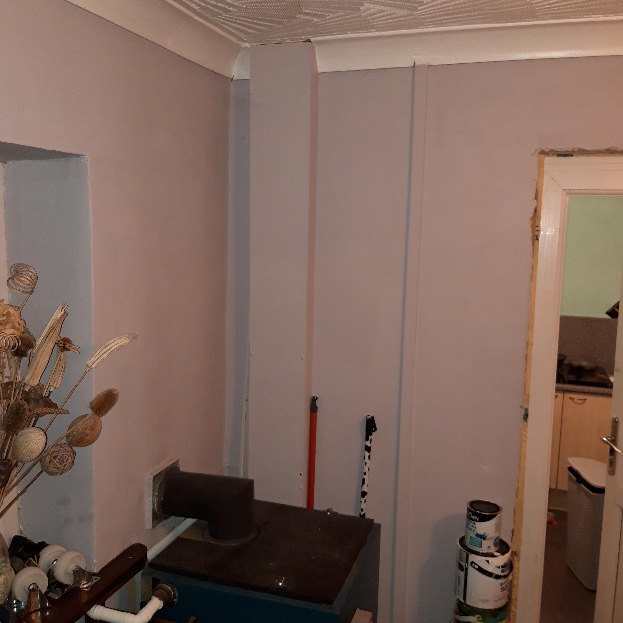

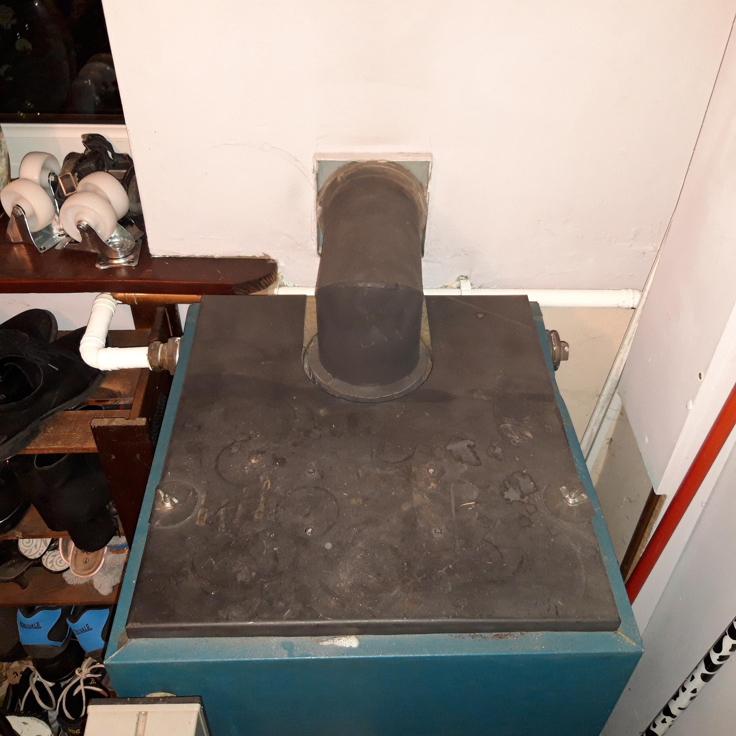

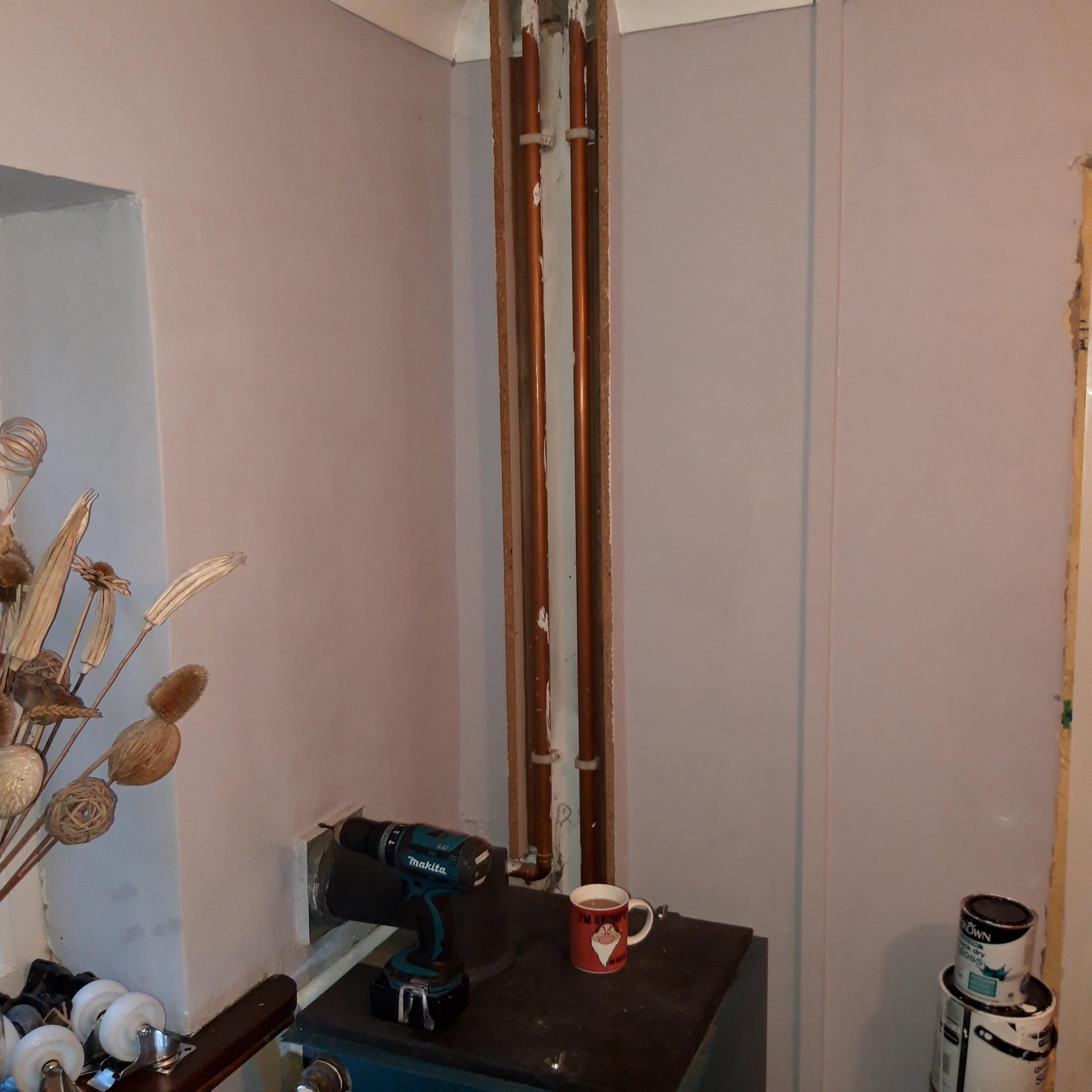

Onoff Posted October 4, 2020 Author Posted October 4, 2020 9 minutes ago, PeterW said: £70 inc https://www.heatingspares247.com/product/intaklean-2-28mm-central-heating-magnetic-filter-ik2mf28/ Cheers. Just ordered from your link. Thinking to place it in the 28mm pipe coming up from the boiler. There's the flow and return pipes in that boxed in section behind the broom handles. Not sure though if the pipes are spaced off the wall enough. Probably not knowing my luck! I might as well swap the 28mm flow pipe from the top lhs to the right at the same time. That'll put the flow and return the same side of the boiler unless that's an issue? Makes it easier as I'd like to box the boiler in sometime.
PeterW Posted October 4, 2020 Posted October 4, 2020 Odd as I fit them on the return as the galleries in the boiler are what they are designed to protect. 1
Onoff Posted October 4, 2020 Author Posted October 4, 2020 1 minute ago, PeterW said: Odd as I fit them on the return as the galleries in the boiler are what they are designed to protect. No worries, it can go in either pipe, whatever's best. I must admit I thought they were meant to stop crap getting into the pump and valves. 1

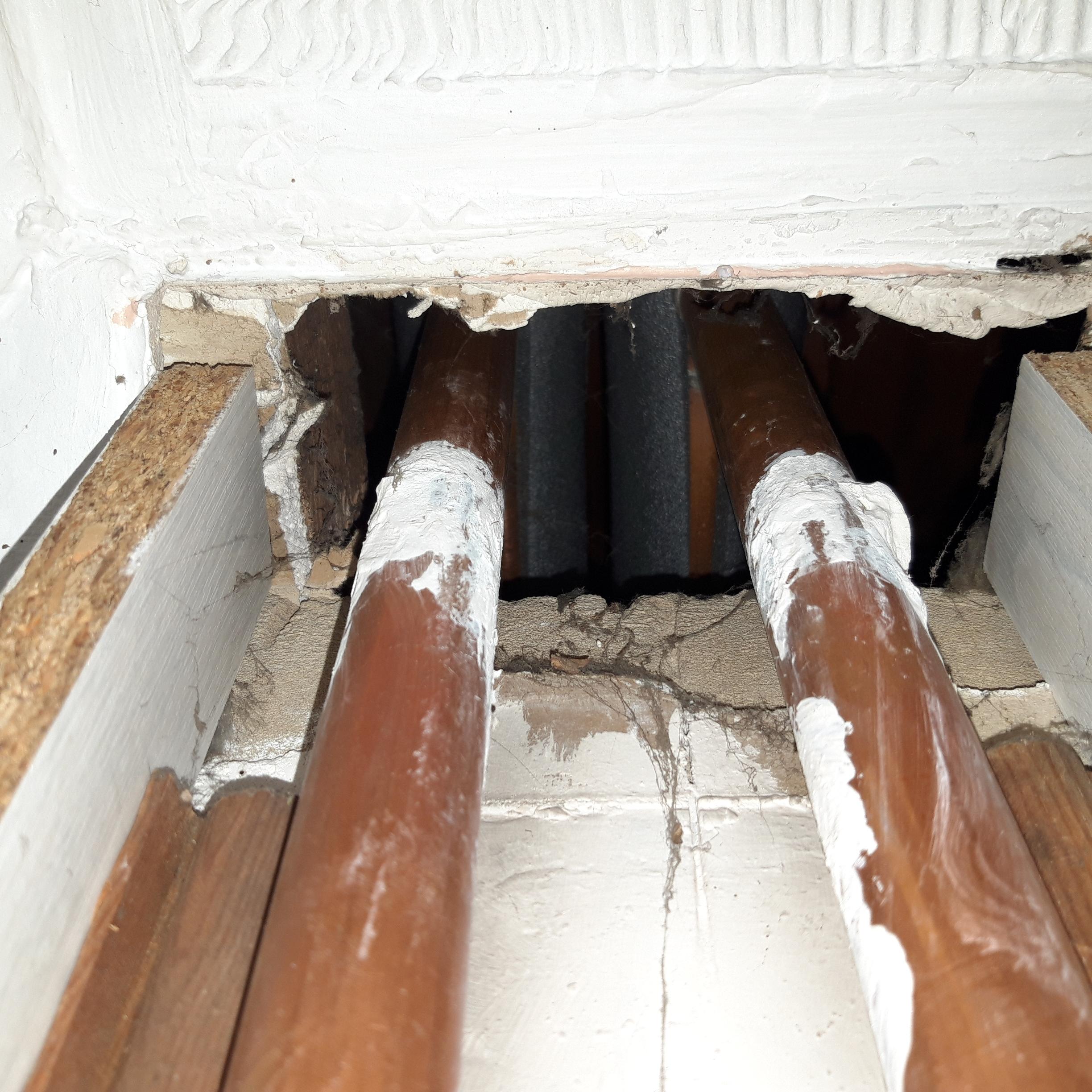

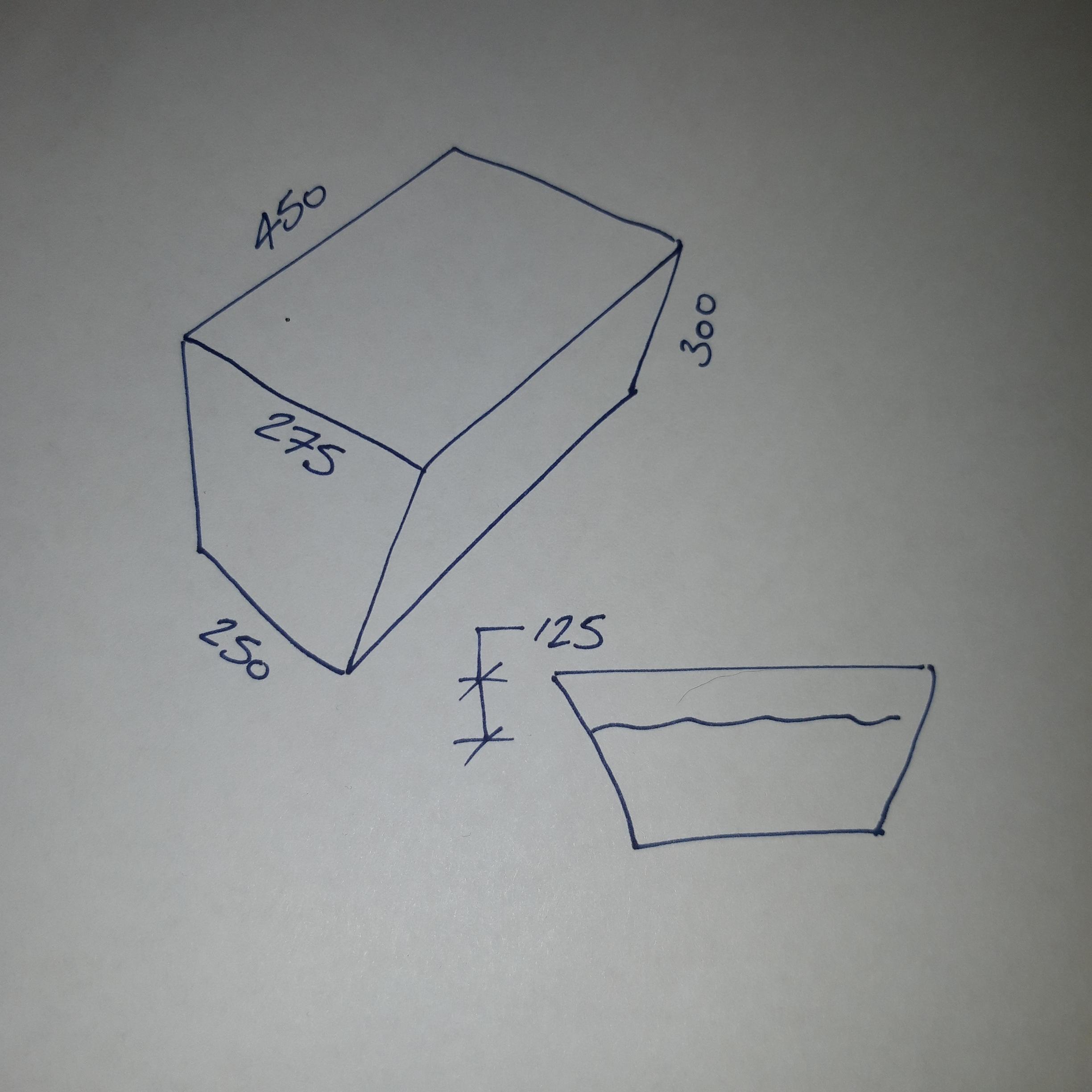

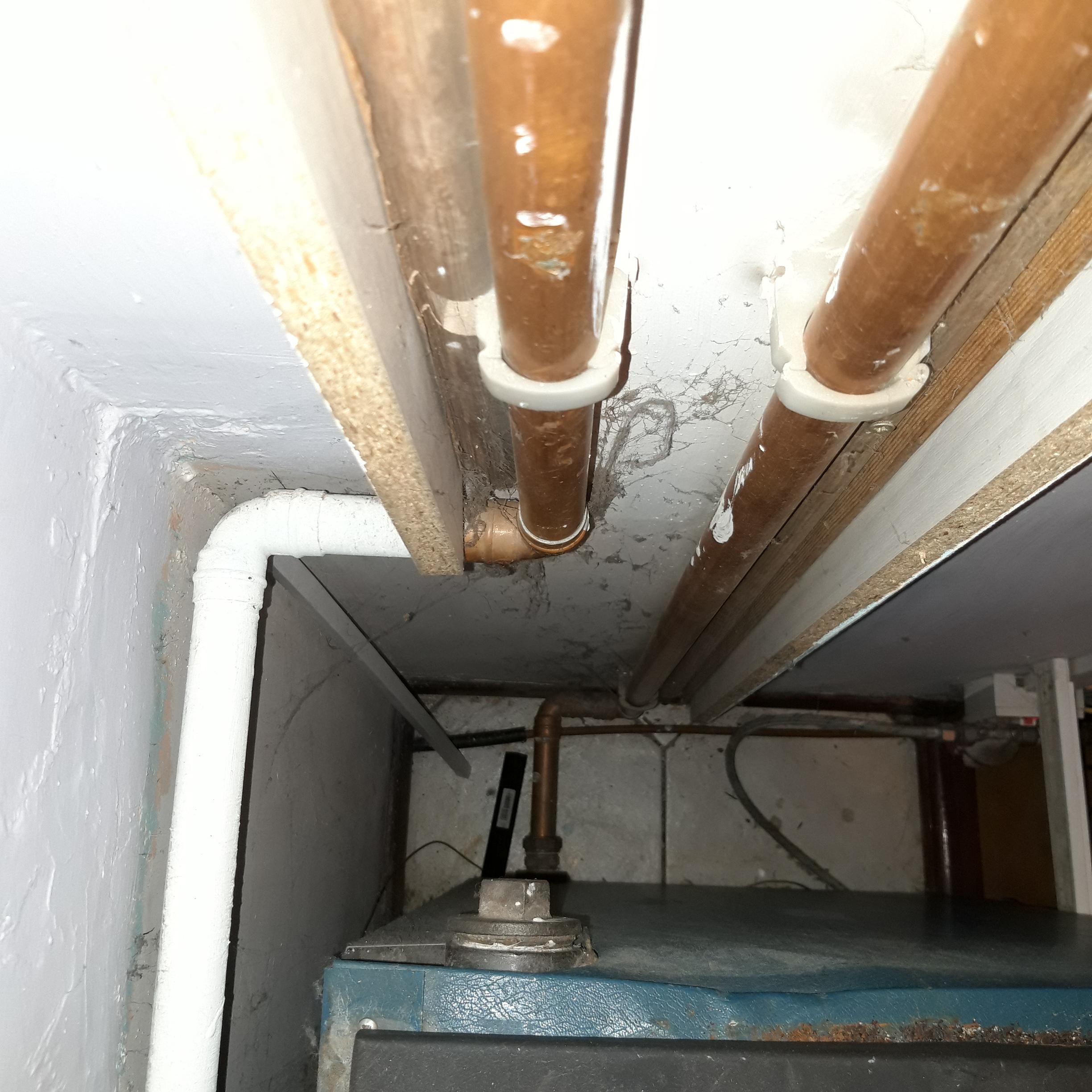

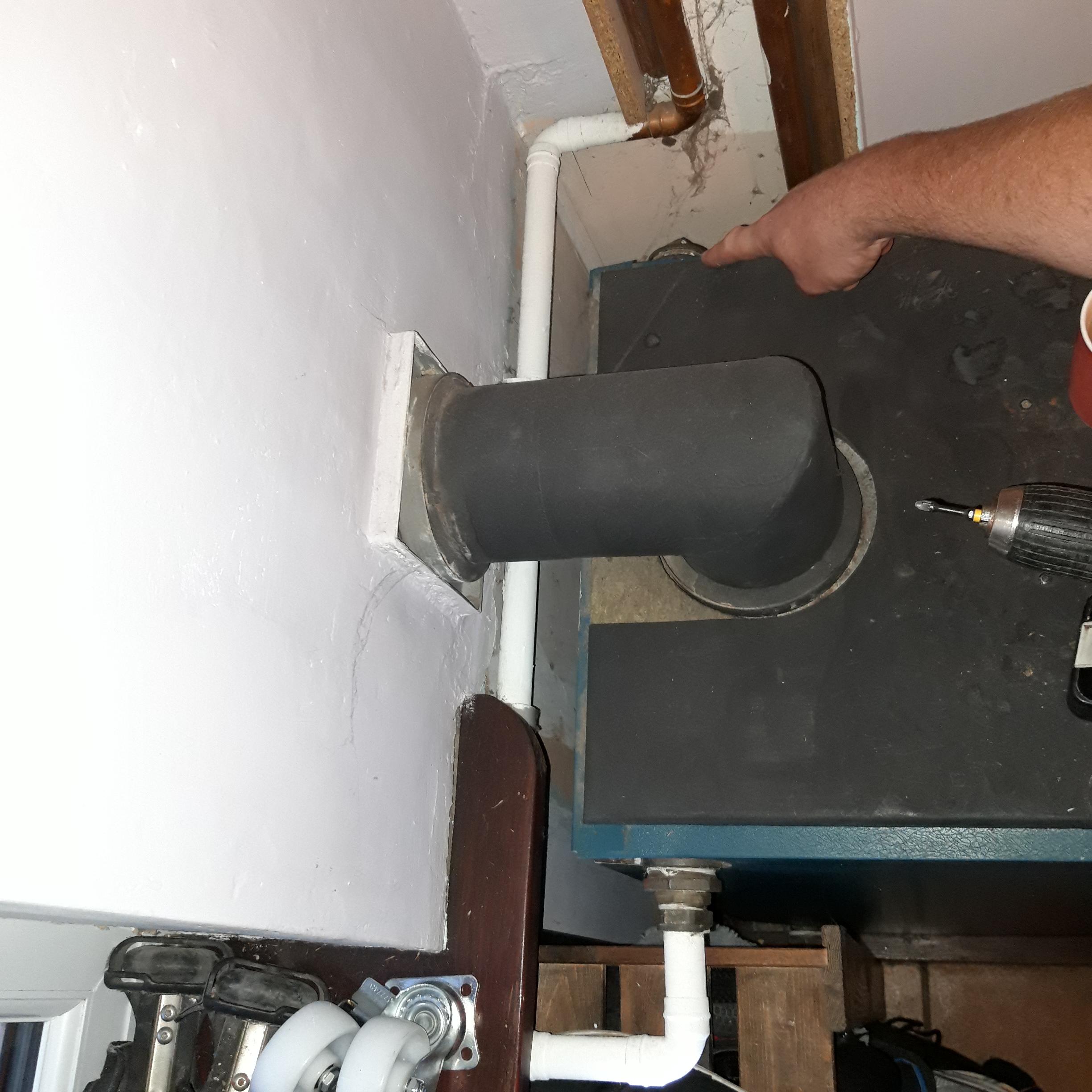

Onoff Posted October 5, 2020 Author Posted October 5, 2020 Who knew? I removed the covering board from the 28mm flow and return pipes to the boiler and there's a bloody great gap where I can see straight into the loft. Must be some heat loss up through there! Plan is to put the Magnaflow in the right hand pipe, return to the boiler. Can anyone see why I can't move the flow from one side top to the other? It's not quite in line though: I've been up above the dormer ceiling and though I can't look inside, I've measured the header tank as best as. I reckon there's about 20L of water in it. If I tie off the header tank ball cock then drain off say 30L of water via the boiler drain cock can I chuck my 2L of system cleaner into the header? Then I assume let refill then bleed the rads.
PeterW Posted October 5, 2020 Posted October 5, 2020 Why don’t you drain down and chuck the magnaclean in, leave enough room to put a container under the drain tap. The one you ordered holds 500ml of fluid - you just turn the isolators, open the drain tap and crack the top open. Then close the drain when it’s empty, refil with system cleaner and open the valves and run for 2 mins, then do the same again. That way it is directly through the boiler and also means the magnaclean is collecting the crud the system cleaner is chucking out ... 1 1
PeterW Posted October 5, 2020 Posted October 5, 2020 And I would leave the boiler alone - a leak on that fitting will be a complete biatch to fix.

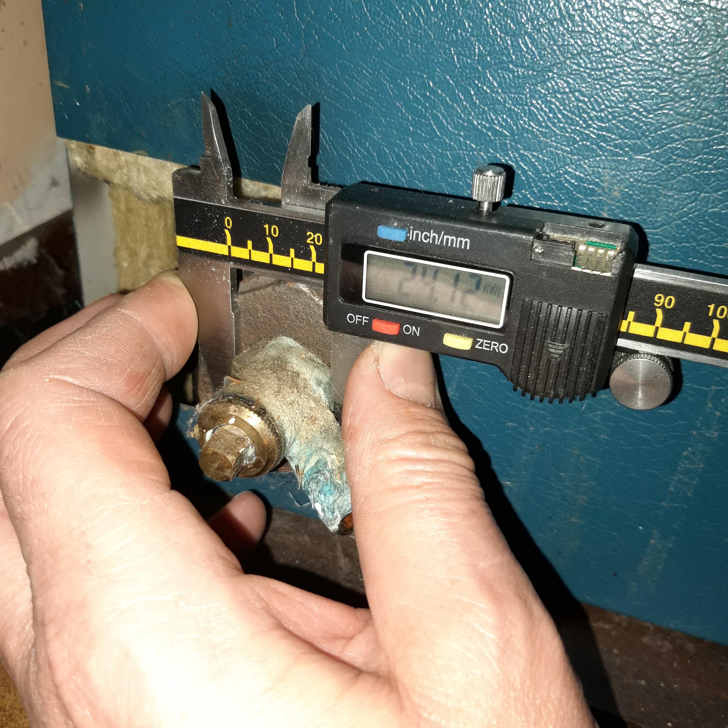

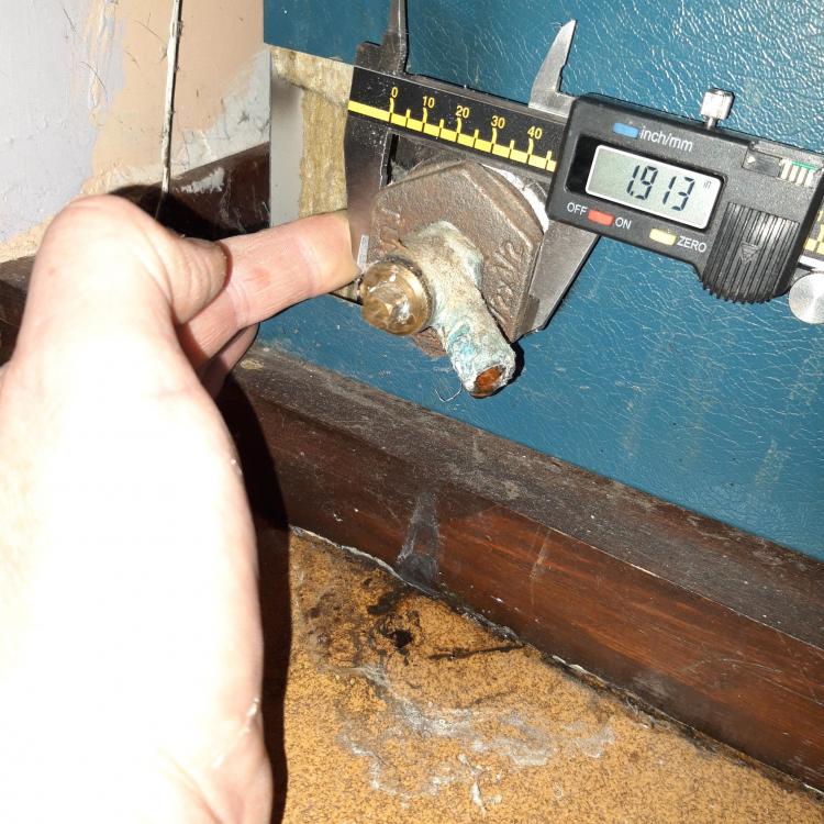

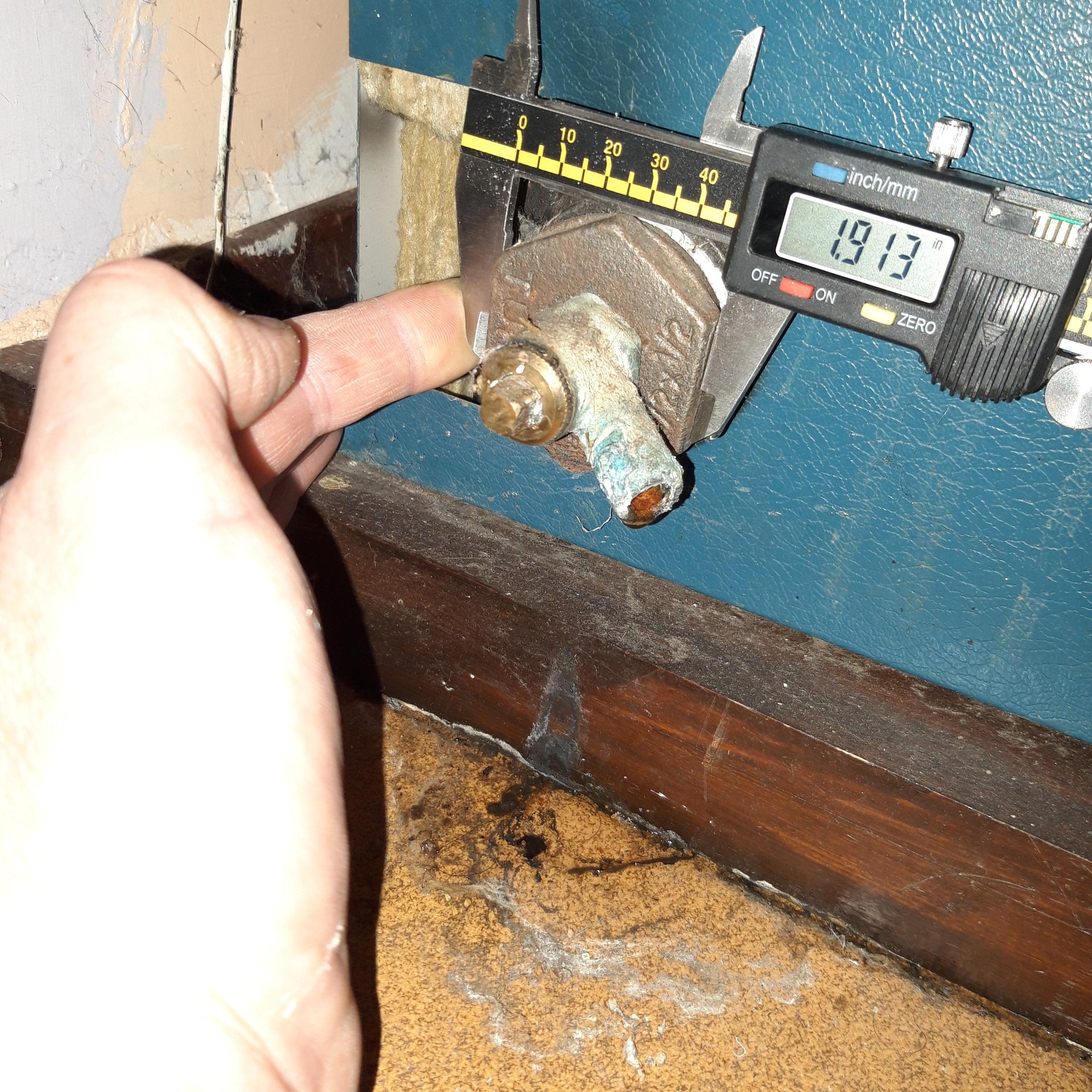

Onoff Posted October 5, 2020 Author Posted October 5, 2020 14 minutes ago, PeterW said: Why don’t you drain down and chuck the magnaclean in, leave enough room to put a container under the drain tap. The one you ordered holds 500ml of fluid - you just turn the isolators, open the drain tap and crack the top open. Then close the drain when it’s empty, refil with system cleaner and open the valves and run for 2 mins, then do the same again. That way it is directly through the boiler and also means the magnaclean is collecting the crud the system cleaner is chucking out ... Thanks. Was just thinking less to drain down to add the cleaner from the header. As you say though, I'll need to drain down to fit the Magnaclean! I'll see if I can borrow a 28mm pipe slice from work. I'll do at the weekend. Kid less then so nobody but SWMBO to complain they're cold! 15 minutes ago, PeterW said: And I would leave the boiler alone - a leak on that fitting will be a complete biatch to fix. I'm going to have to sort this one I think. When I've drained from here before it takes an age to drain, hardly comes out at all to start with. This isn't anyway the lowest drain on the CH system. Down to 4 different floor levels in the house since I did the bathroom! ? Looks like 1" and 2" spanners.
Nickfromwales Posted October 5, 2020 Posted October 5, 2020 Those unions will wind out and go back in just fine. Use a PTFE tape like this to sort those deep thread valleys as PTFE tape will struggle. Bit of boss white on the internal thread ( not too much ) and don't over-tighten first time around. Pinch up later if they weep, but with just F&E there's not much more than 1 bar there I'm guessing. +1 on using the filter to dose via. Don't use the F&E as it's the most elongated method of dosing there is. If you're worried about that, drain the towel rad when the systems down and fill that with the cleaner. Is that connected to the single pipe atm? I forget lol it's been a bit of a journey
