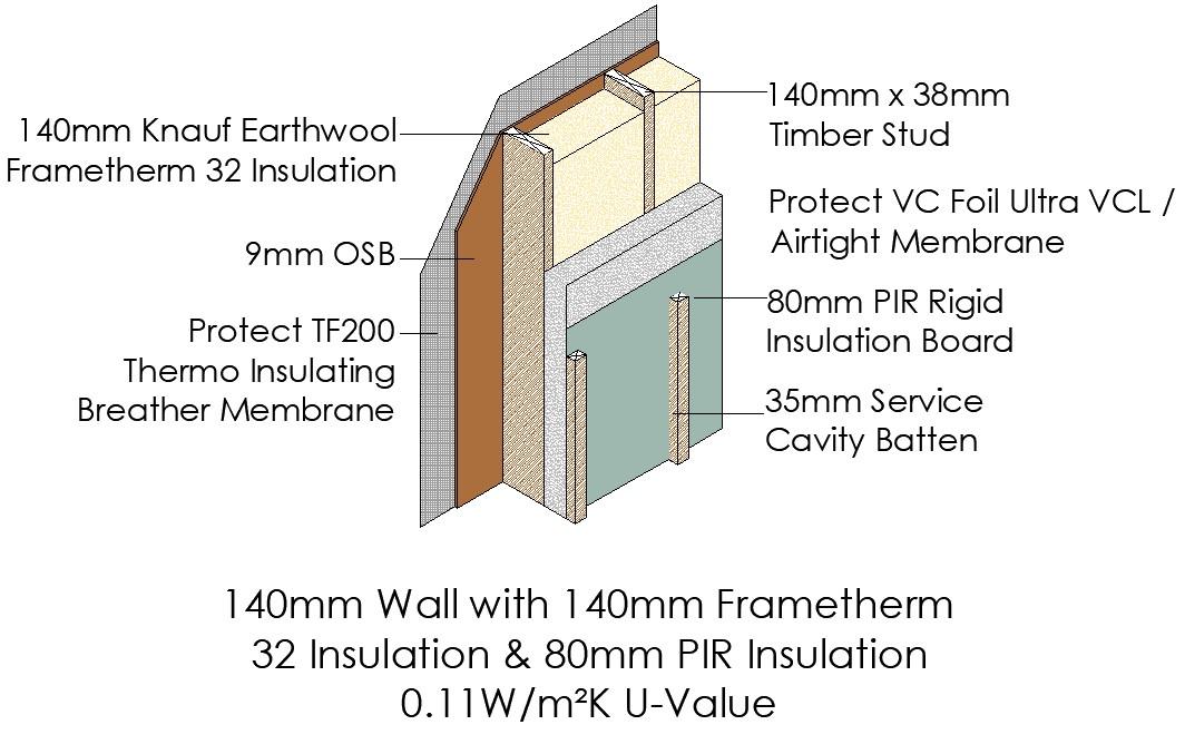

What type of insulation will you fill the 140mm gap with?
Here you go (from MBC) …

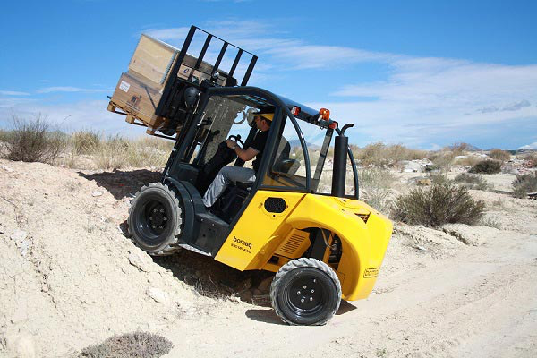

Yes, one of those baby telehandlers might just fit or one of these off-road fork lifts:

A 13t digger with an extension in the boom will lift whatever you need esp if it's only  a single storey.  You can get diggers with no tail swing that will be not much more than 2m wide.
  • Like 1
I may be completely wrong but isn't that U factor of 0.11W/m2K better than the standard 300mm twin stud wall with cellulose insulation which I thought was 0.12Wm2K. So why not use it?

Just to throw my usual observation into the debate, worth looking at the decrement delay for the various options.  U value is, on its own, not a good indication of the comfort level that may be achieved.  A low decrement delay build up, like the thinner foam panel lined walls, will have a much shorter decrement delay.  This may not have a massive impact in winter, but it will almost certainly be noticeable in hot, sunny weather, where heat will be transmitted into the house more quickly than would be the case for walls with the same U value but a longer decrement delay.
Not an issue if you have a relatively fast response heating/cooling system, though, as that should be able to adjust for the lower decrement delay OK, but may be an issue if, like us, you have a relatively slow to respond heating/cooling system.

I suppose the advantages of the 300mm double-stud over the 140mm open are:
  1. Improved decrement delay, as @JSHarris rightly says above. More on that in the next post
  2. Improved sound proofing
  3. In some nebulous way that I cannot put my finger on, less cold bridging. (I am aware that a U-value (as compared with, for example, a λ value) should take into account but I have feeling I am missing something here)
  4. Less carbon embodiment
Have I missed anything?
Your usual observation is very welcome. Through your repeated emphasis on the such matters I have learnt so much.
Here's the conundrum. In my design, most of the walls of my bungalow will be shaded by an overhanging simple pitched slate roof. Thus, sun's energy that could risk overheating in the summer predominately falls on the roof. Now here's the key part. The section I showed above is only for the walls, the roof is different. The roof system that MBC specifies to go along with the 140mm open stud wall system has 400mm of blown-cellulose insulation (see below). Thus, I am putting the cellulose in the place it is most needed for enhancing decrement delay, the roof.
Thus I am getting the best of both worlds, while also reducing panel bulk, and saving the 30% price premium. Am I right?
From MBC again …
