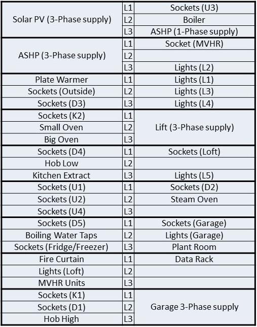

puntloos Posted March 14, 2021 Posted March 14, 2021 Dredging this topic up one-more-time.. but: Any update on the world here? Octopus Energy rolling out 3phase better now? I'd love to see some list of devices that benefit from 3phase (as a rule of thumb at least) ASHP? MVHR? Lathe? Death Ray? PhotoPanels? Electric Car Charger?
newhome Posted March 14, 2021 Posted March 14, 2021 1 hour ago, puntloos said: I'd love to see some list of devices that benefit from 3phase (as a rule of thumb at least) 24kw Electric boiler 1 hour ago, puntloos said: Any update on the world here? Octopus Energy rolling out 3phase better now? I’m still ‘on the list’ and have heard nowt. Of course these days covid is the excuse for just about everything.
joth Posted March 15, 2021 Posted March 15, 2021 17 hours ago, puntloos said: Dredging this topic up one-more-time.. but: Any update on the world here? Octopus Energy rolling out 3phase better now? I'd love to see some list of devices that benefit from 3phase (as a rule of thumb at least) ASHP? MVHR? Lathe? Death Ray? PhotoPanels? Electric Car Charger? Elevator. (Always a good future proofing thought for a "forever home") Car chargerS (plural). e.g. young kids may want their own car one day. If there's parking space for >1 car, think about how to charge them all.
pdf27 Posted March 15, 2021 Posted March 15, 2021 17 hours ago, puntloos said: Dredging this topic up one-more-time.. but: Any update on the world here? Octopus Energy rolling out 3phase better now? I'd love to see some list of devices that benefit from 3phase (as a rule of thumb at least) ASHP? MVHR? Lathe? Death Ray? PhotoPanels? Electric Car Charger? Car charging already mentioned - most of Europe uses 3-phase so I think we're highly likely to see the more powerful chargers being 3-phase only. VW are working on an interesting one which is DC-coupled to the car so will be able to do vehicle-to-grid quite easily. I think that's very interesting for people on something like Agile. More PV: 8.5 kW in GSE trays to fit our proposed roof is £5700 ex VAT from Midsummer Wholesale. The 4kW equivalent is £3400 and the fixed costs of fitting it should be very similar - plus we save an additional 24m2 of tiles - so while the value of electricity from a bigger PV system goes down as you consume less, the cost does too. That's an extra 4200 kWh/year for ~£1600 up front which is probably a bit better than the payback on a 4kW system. Not great as an investment, but if you're doing it I think it works better if you go big. Any machine tools. I'm an engineer and when I've mentioned I'd like to get 3-phase everybody immediately starts talking about how they'd love to have a lathe/mill/etc. in their shed but it needs 3-phase. Essentially anything with a cheap-ish electric motor in it benefits massively. I'm not sure that I'd pay very much to get any of these, but in my case we're going to have to disconnect the supply to allow for demolition and there is 3-phase at the end of my driveway so the marginal cost of upgrading should be comfortably worth it. The key point is that it doesn't add any new limitations beyond possibly the metering technology - the distribution network is all 3-phase, and normally you're just connected up to one of them.

andy Posted March 22, 2021 Posted March 22, 2021 On 14/03/2021 at 18:41, puntloos said: I'd love to see some list of devices that benefit from 3phase My reason for going 3 phase was two-fold: 1. Overall usage of the house may have exceeded 100A ultimately and sparky wasn't happy. 2. Future-proof for EV car charging and additional PV (already have 6.1kW so doubt I will add more now).
