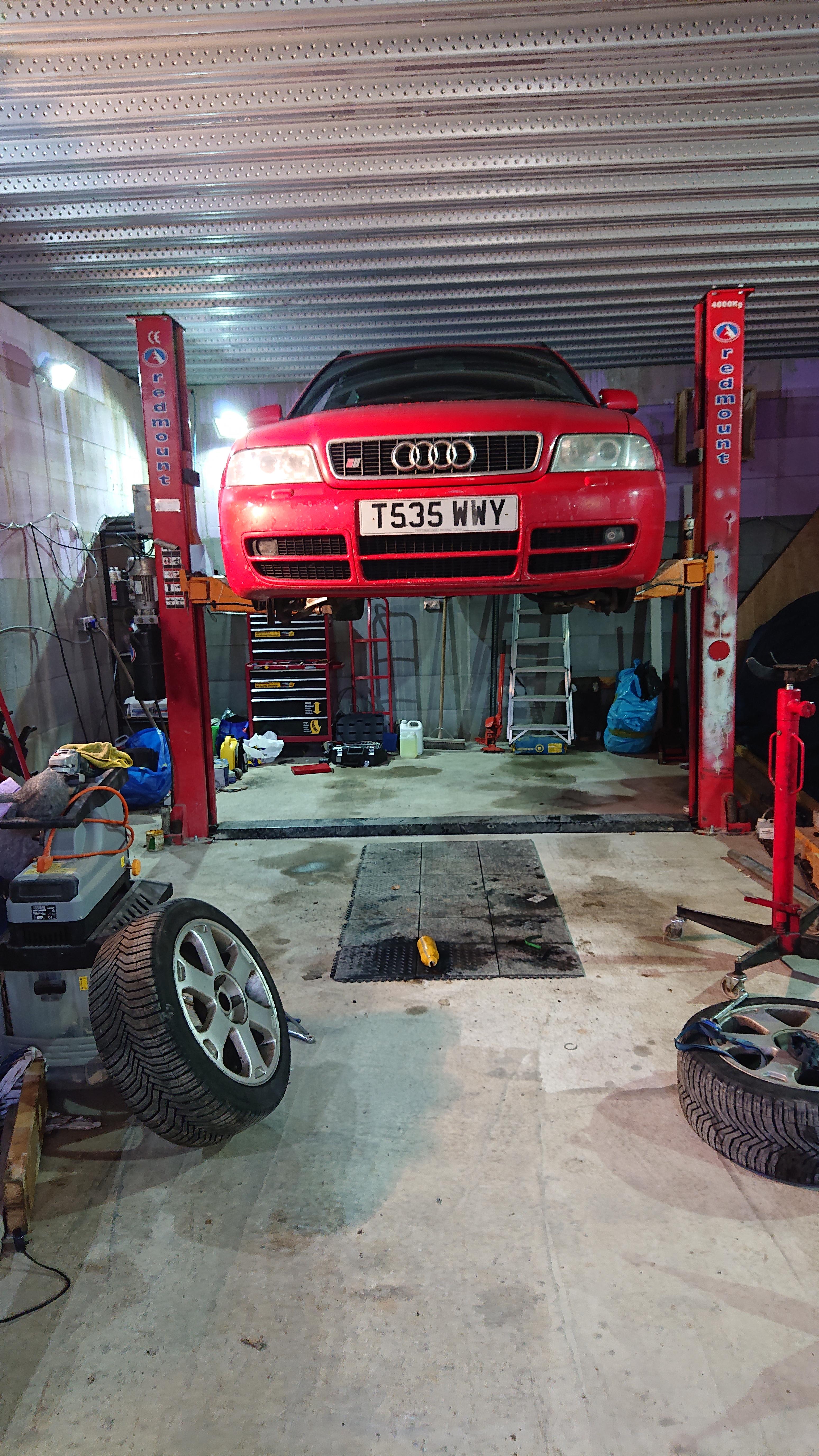

scottishjohn Posted January 2, 2019 Share Posted January 2, 2019 the ramps in my garage have motors that can be wired either single or 3 phase ramp only need a 2hp motor so --so a single phase 2 hp is no problem I ,ll sell you one if you like !! 2 poster hoffman 3ton Link to comment Share on other sites More sharing options...

scottishjohn Posted January 3, 2019 Share Posted January 3, 2019 (edited) 15 hours ago, joe90 said: https://www.ebay.co.uk/itm/2-POST-LIFT-CAR-VEHICLE-RAMP-HOIST-4-TON-NEW-999-18-month-warranty/321740808920 i am getting too old to crawl under cars nowadays. ? wouldn,t have it as a gift -no stabilising bars going front to back from 4 bolt bases to spread load from bases £1000 brand new gives you a clue on the quality had enough garages +ramps and seen all the problems of ramps fitted to doubtful floors you start swinging on a g/box and it is easy for them to come loose from floor If you are going use that --then floor needs to be minimum 8" with lots of weld mesh and BIG bolts http://www.garageequipmentdirect.co.uk/contents/en-uk/d12.html look at second one down --"boston " that is actually a hoffmann under different name --and is same set -up as ones i have -you can swing on it all day and it won.t tip over Edited January 3, 2019 by scottishjohn Link to comment Share on other sites More sharing options...
jamiehamy Posted January 3, 2019 Share Posted January 3, 2019 1 hour ago, scottishjohn said: wouldn,t have it as a gift -no stabilising bars going front to back from 4 bolt bases to spread load from bases £1000 brand new gives you a clue on the quality had enough garages +ramps and seen all the problems of ramps fitted to doubtful floors you start swinging on a g/box and it is easy for them to come loose from floor If you are going use that --then floor needs to be minimum 8" with lots of weld mesh and BIG bolts http://www.garageequipmentdirect.co.uk/contents/en-uk/d12.html look at second one down --"boston " that is actually a hoffmann under different name --and is same set -up as ones i have -you can swing on it all day and it won.t tip over Mine is secured with the stipulated 5nos. M18x160mm anchor bolts per side. 'swinging' on a gear box is more likely to disturb the vehicle on the arms and not going to make the slightest difference to the security of the posts. For something that takes 2t per side, if an 80kg human can pull it from the ground then I'd say you'd be lucky not to already have been flattened! Link to comment Share on other sites More sharing options...
