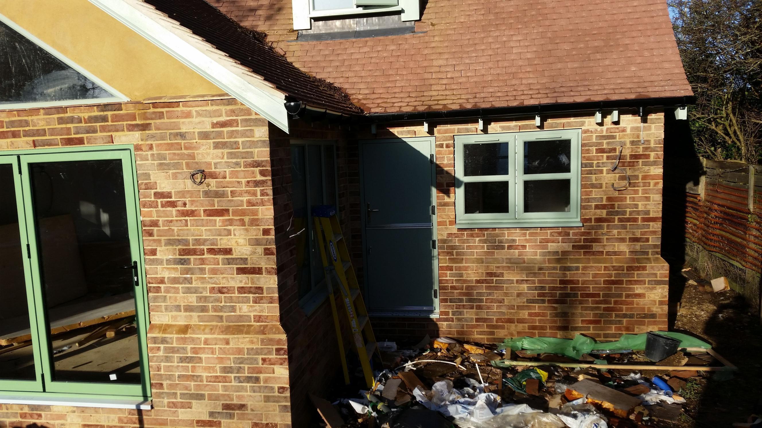

Well that tops off a really crap week!
Just had the fitters come and fit the last doors ....INCLUDING the specially made aluminium bifold
Of course like everything else outside the house ...it is in "chartwell green" ...UPVC doors, Windows, Rafter Feet,
Fascia Board ....EVERYTHING
Off i went to make them tea and butties and when i came back BOOM...WTF
...I hope thats plastic film i asked!
>No my friend ....its the colour
I said ...it is NOTHING like chartwell green
>I agree my friend
So why have i got it
> We dont make these doors is aluminium you need to talk boss...is special made to order
Yes i remember
>and we gave your wife a colour swatch and a form to fill in
why, just make them the same as the PVC ones you supplied
>because they only do the RAL colour ..so you have to choose close match
well she never picked this
>ok , you call office, i am only fitter
so after an hour.... i got a scan of the order and sure enough she wrote down swatch RAL 6021
which according to the internet is the closest RAL colour to chartwell bloody green
but she SWEARS the swatch was nowhere near as dark as this
So ...i am sure she cant live with it ....see picture ..
They will not refund our £2k as we chose the colour
So i guess we have to change the colour ourselves....
Anyone have any ideas? ...only the outside

Aluminium is often powder coated and is very difficult to re-coat.  I did enquire a few years ago when we were looking at an office to convert to resi.  The place had a lot of blue powder coated windows and we were able to get a quote to have the colour changed, so it is possible but quite expensive.
Oooh, that is very different.  Far greener, less grey.  I can offer no advice, I'm afraid, only sympathy.
Spot on.  In general powder coating is a real pain to re-coat, as you need to get back to bare metal in order to enable a good bond.  Trying to powder coat on top of an existing finish will probably result in it just chipping or flaking off, plus the whole frame and door assembly would need to be stripped out and have all the glazing and fittings removed in order to be able to hang the bits up to charge them.  We once had to re-powder coat a steel tube aircraft fuselage and ended up getting it bead blasted back to bare metal and starting again, after a couple of goes at just re-coating it.
However, if the powder coat is polyester (which is most likely, I think) then you can often spray paint on top of it with a bit of careful surface prep.  It would still mean stripping all the hinges, handles, glazing etc off, but the frame could be painted in situ I'd have thought.  Might be a job for one of the mobile repair companies to have a go at, as they can usually match colours very well.

The Builder who built a neighbours extension told me that they had ordered a UPVC window in the wrong colour and then had it painted to match by a specialist company.
Try something like this:
https://colourmywindows.com/
Part of the info :  Colour My Windows by G I Sykes can re-spray uPVC, Composite and Aluminium doors, including Patio and Bi-Fold Doors. Extending their lifespan, brightening your home and giving you the highest quality finish.

Hmm ..I like the idea
as then it wouldnt look so bad ..i.e a failed match...CLEVER
but of course it would still have to be painted,, and i suppose if thats the case
it may as well be in the old chartwell
I mean its not uber noticeable until the SUN hits that side of the house ...then it looks painful
I went out last night to check the house was locked up and to be honest i couldnt tell the difference...Result ?

Sorry just seen this and may have already been dealt with, we use two companies for aluminium paint repairs / recovering.
Spray Clad & Magicman, both give 10 year gaurantees on the finish and will colour match.
Thanks Craig
I went with a local company ....as distance seemed to factor in price ...
they are sorting the right colour using some outsource spectrometer thingy
Watch this space
