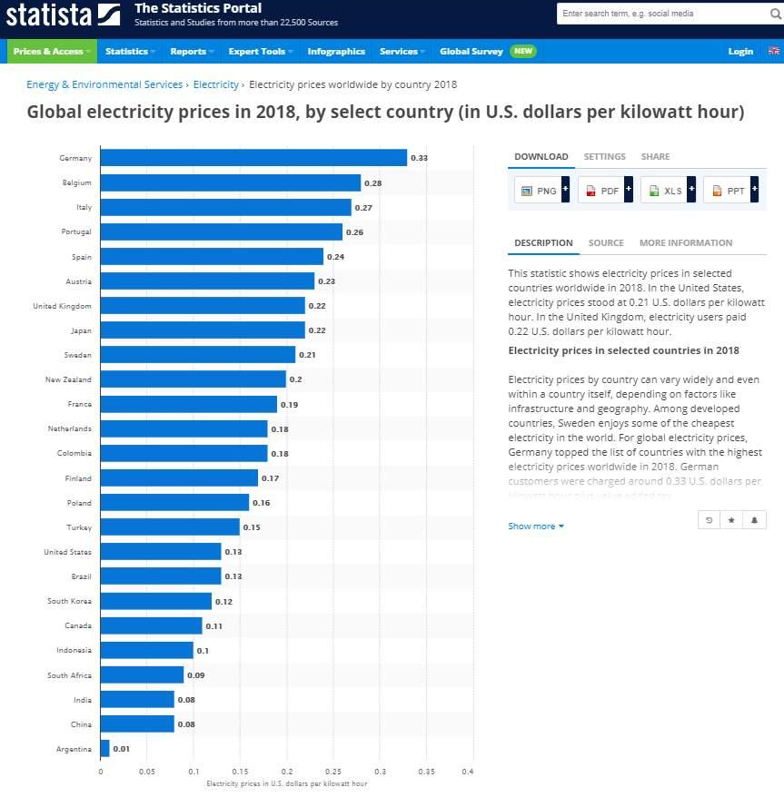

AliG Posted December 21, 2018 Posted December 21, 2018 @Ed Davies calculations above for PV panels made sense. Wholesale electricity costs do not vary that much globally. Generally electricity is made using globally available and priced generating equipment. The cost of fuel may vary, but again fossil fuels often have a global pricing structure. The retail price of electricity in China is around 8c per kWh compared to 13c in the US and 22c in the UK. Retail prices can be affected by distribution costs, government subsidies and taxes. https://www.statista.com/statistics/263492/electricity-prices-in-selected-countries/ This paper from the US Department of Energy references various studies that seem to suggest a 2-3 year payback for a PV system in terms of energy. https://www.nrel.gov/docs/fy04osti/35489.pdf As to wind turbines, Berkshire Hathaway opened Pacificorp, recently announced that due to improved efficiency of equipment they plan to "repower" their existing wind turbines, that I believe had been in use for less than 12 years as the efficiency of new equipment was so much higher that the investment would pay for itself. I would like to hope that people making billions of dollars of investment know a little bit about the expected return on the investment which would be considerably affected by the life expectancy and repair costs. http://www.pacificorp.com/es/energy-vision-2020.html You hear this kind of anti progress or renewables chat all the time, such as that electric cars use more energy in their production than they save, they don't. Or that the batteries only last a few miles, there are Teslas already with hundreds of thousands of miles on the clock. As with most cars something else will give out long before the motor/battery combination. There are places where EVs are barely cleaner than ICE cars depending on the local generating mix, but the good thing is that in general generating is getting less carbon intensive all the time. https://cleantechnica.com/2018/02/19/electric-car-well-to-wheel-emissions-myth/ Cement does produce a lot of CO2, but again you would have to look at this relative to its lifespan and the emissions of alternatives to see whether or not it is an environmentally friendly material. In general I think human ingenuity fixes these issues as it has in the past. I don't see us running out of resources. 3

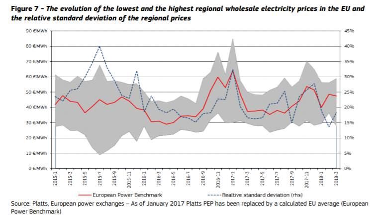

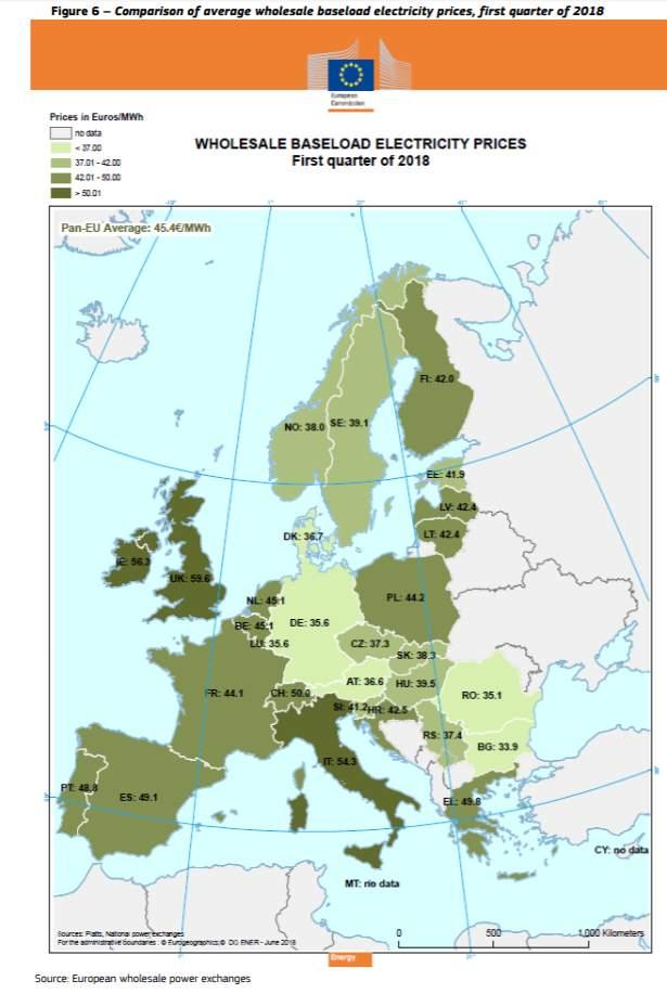

Ferdinand Posted December 22, 2018 Posted December 22, 2018 (edited) 18 hours ago, AliG said: Wholesale electricity costs do not vary that much globally. Generally electricity is made using globally available and priced generating equipment. The cost of fuel may vary, but again fossil fuels often have a global pricing structure. The retail price of electricity in China is around 8c per kWh compared to 13c in the US and 22c in the UK. Retail prices can be affected by distribution costs, government subsidies and taxes. https://www.statista.com/statistics/263492/electricity-prices-in-selected-countries/ I'm not entirely convinced by this statement that wholesale electricity prices do not vary that much globally. Here is the graph of retail prices from your link: Here is a graph from the EU of wholesale prices in Europe in Spring 2018, which shows a variation of more than 100% relative to the lower price. (Source: https://ec.europa.eu/energy/sites/ener/files/documents/quarterly_report_on_european_electricity_markets_q1_2018.pdf) And here is the "bandwidth" (max/min) graph for the EU countries from the same source. That wholesale price data is a lot of things, but consistent is not one of them. ? It could be the variation in quotes for an identical building job ! Comments on further post. F Edited December 22, 2018 by Ferdinand
Ferdinand Posted December 22, 2018 Posted December 22, 2018 (edited) eg Compare Germany vs UK vs Poland. The difference in wholesale vs retail prices for Germany is huge. Fine - Germany is an outlier, but there are at least half a dozen or ten other not dissimilar outliers just within the EU. Retail 2018: 0.33 vs 0.22 vs 0.16 Euro per kWh. Wholesale: 0.0356 vs 0.0596 vs 0.0442 Euro per kWh. Ratio Retail/Wholesale: 9 vs 3.7 vs 3.6. Obvs there are issues of definition, and extraordinary political shenanigans from time to time or constantly (eg in Spain where retail prices do not seemed to have shifted much since about 2010 whilst retail inflation is about 12-14% and there is a corresponding massive subsidy iirc, never mind all the Solar Tax buggering about), and we do not know where France will end up after their current "Reform"-"Burn-Down-Paris"-"Cancel-Reform" cycle (perhaps exactly where they started). Suspect that the real thing highlighted here is that EU stats are not really "wholesale", but "wholesale after political messing about", and that Germany is subsidising energy for industry - whilst the UK refused to do so for large intensive users and we now have no aluminium industry left. There is also probably the hangover of Frau Merkel's (I think it was Mutti) anti-nuclear spasm after the accident in Japan, but that impact seems to be less than I thought, and perhaps also a residual headache from the subsidies for the now-gone solar manufacturing sector in Germany. Comments most welcome, as I think is probably about elucidation not basic disagreement. F Edited December 22, 2018 by Ferdinand
