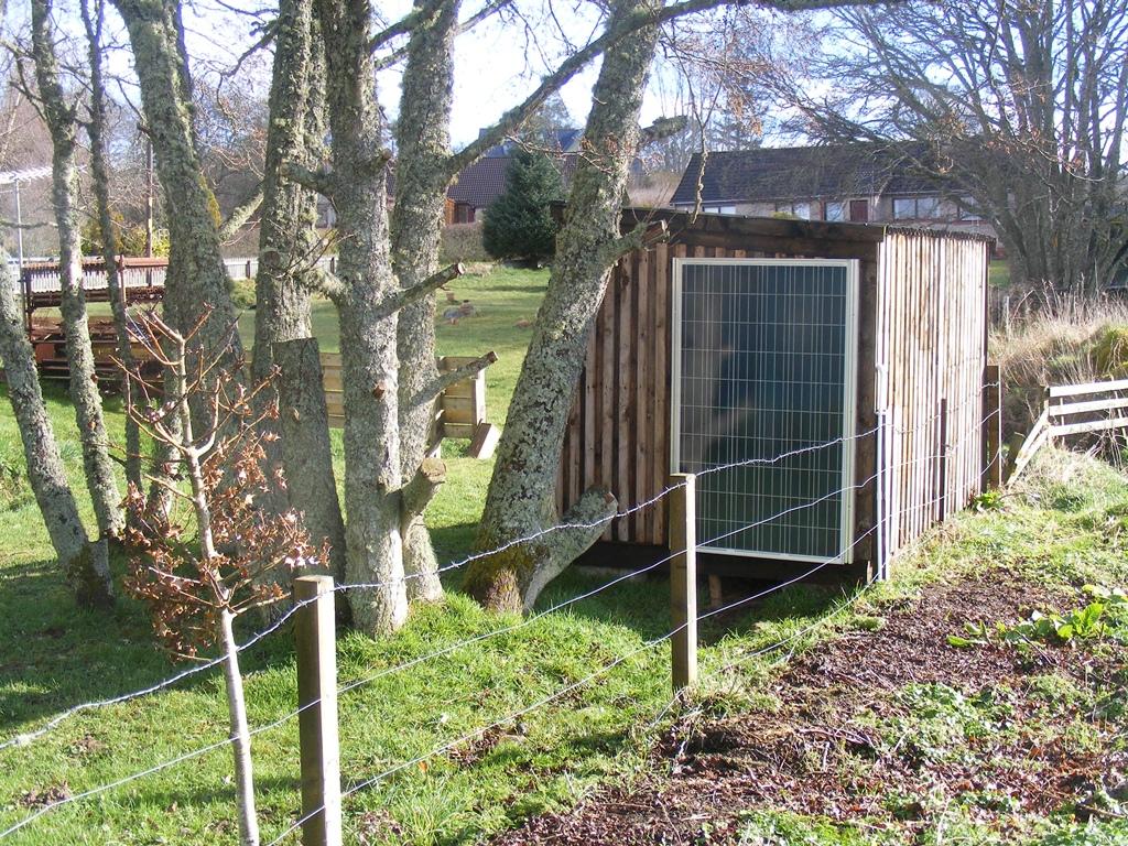

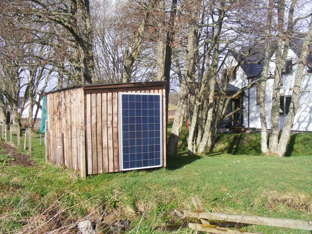

ProDave Posted March 23, 2019 Author Posted March 23, 2019 I think the panels in parallel idea should work. Today I mounted the panel on the east side of the shed. Now well into the afternoon with the sun shining on the W side of the shed and the E panel well and truly in the shade, it is still showing a Voc of 34 volts. So I don't think it's going to bother the active panel.
ProDave Posted March 24, 2019 Author Posted March 24, 2019 So here they are mounted on the shed. The east facing panel basking in the morning sunshine And the west facing panel, at this time of the morning still in complete shade Now all I need is for the cheap Chinese inverter to arrive.

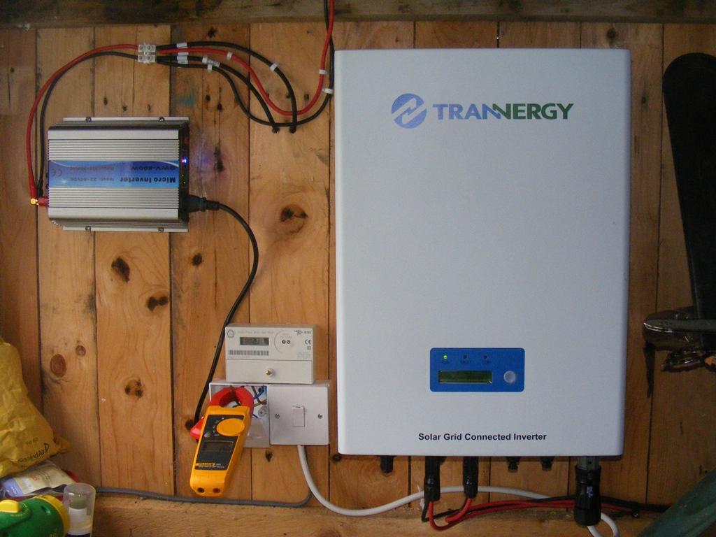

ProDave Posted March 30, 2019 Author Posted March 30, 2019 Today the Chinese inverter arrived. I think that is a record for an ebay purchase from China, getting here in just 9 days. So of course today's job was to install it in the shed with it's big brother. I have still got the clamp meter on there to assess it's performance, it only has the most basic of a display. So far it is looking good. It was mid morning before I got it connected and I was then getting 150W from the E facing panel, even though the sun was well on it's way towards south. And this afternoon as it is moving round to the west, I have seen up to 200W from that panel Sadly the sunny day has become cloudy and somewhat hazy so that's probably it's peak for today. But it shows the principle that these 2 otherwise spare panels should add some useful extra generation at the ends of the day. 1
