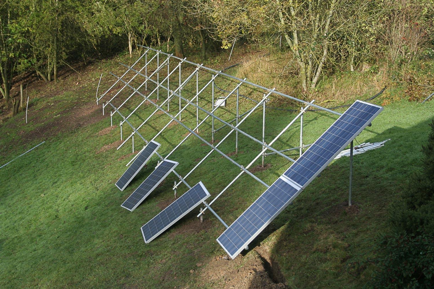

I choose about 45 degrees slope and SSW orientation ('cause that's the way the bank faces).

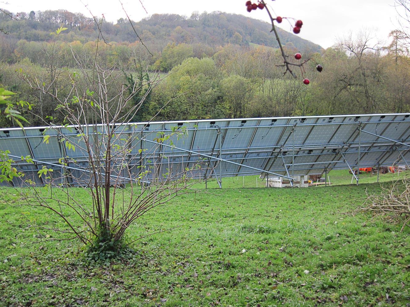

I made a frame of scaffold poles, as the commercial systems were too expensive, and I wasn't convinced of the longevity of wooden posts.
Used U-bolts to attach the panels to the scaffold poles, drilled holes in the frame for them.

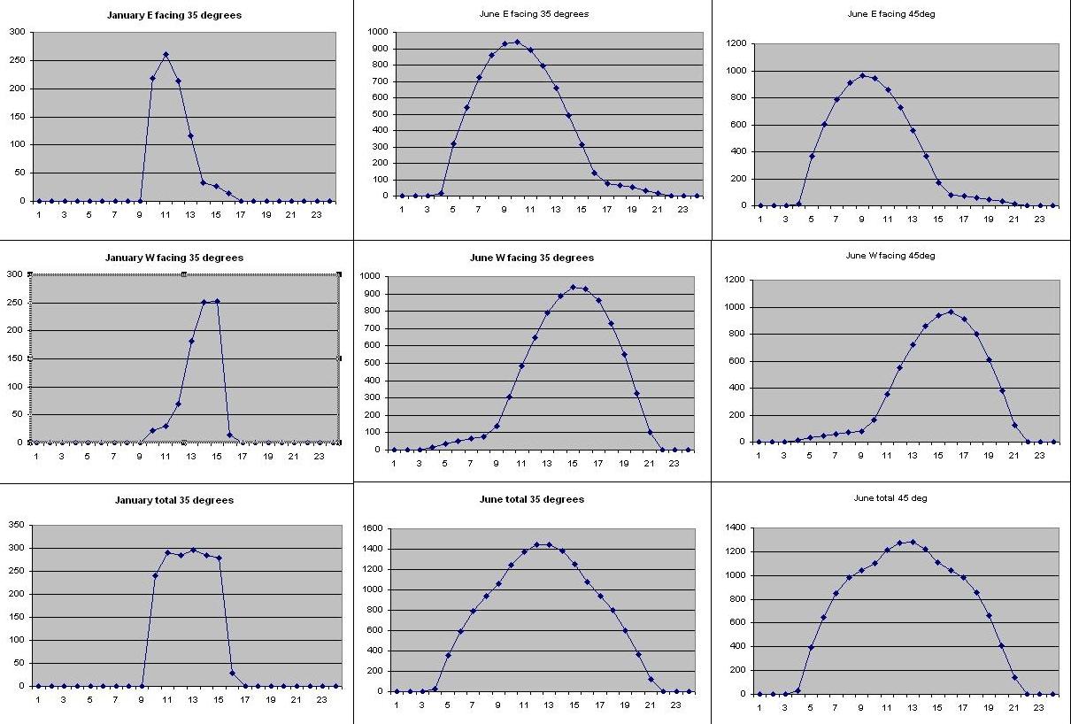

Okay I have played with PVGIS a bit more and it will give output throughout the day, but only for ONE string at a time.  So I can see if I go for an E/W split the E half peaks before mid day and the W half peaks after mid day.
But I want to see the SUM of the output from the 2 strings on the same graph.  I guess I could download the PVGIS output as CVS and impot it into a spreadsheet and sum the 2 outputs but that is all getting a bit clumsy.
I cannot believe I am the first to want to optimise an E/W split for maximum length of usable generation so I can't be the first looking for a better bit of software to do it can  I?
The E/W split idea is an attempt to get a more broad and more level output, rather than a relatively narrow massive peak in the middle of the day. And the low angle idea is to get more in the winter when the sun is low and also I believe it gathers more from a bright but cloudy day.  But this is why I want to model it so I have some idea what it will give.
Whenever I've used PVGIS I've just copied the data from the tables into a spreadsheet and then done comparisons using that.  That way you can do things like combine the predicted output for several arrays and see what the overall shape looks like.
It's a bit tedious getting the data out of PVGIS and into a spreadsheet, as you need to do several PVGIS runs and then a bit of cutting and pasting of data from each, but once done you can play around with it far more easily.
Right now I wish we had some East facing PV, as we have clear skies and sun from the East but are generating sod all, as our 45 deg pitch array faces slightly West of South.  It's a nuisance, as I want to charge my car...
I have done some modeling with PVGIS.  It is a tedious struggle as the CVS file is produces won't just import into excell properly requiring some manual editing, so I have just modeled a few scenarios
Firstly panel elevation 35 degrees for January and June.  January shows a nice flat top for the combined data but June still shows quite a large mid day peak (though the usable duration is much longer than all south)
So I then tried June at 45 degree elevation.  This widens the peak somewhat.
These are all for E/W split.
So the steeper angle looks better with a lower but wider profile.

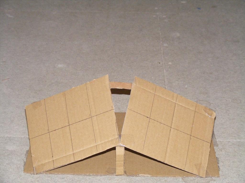

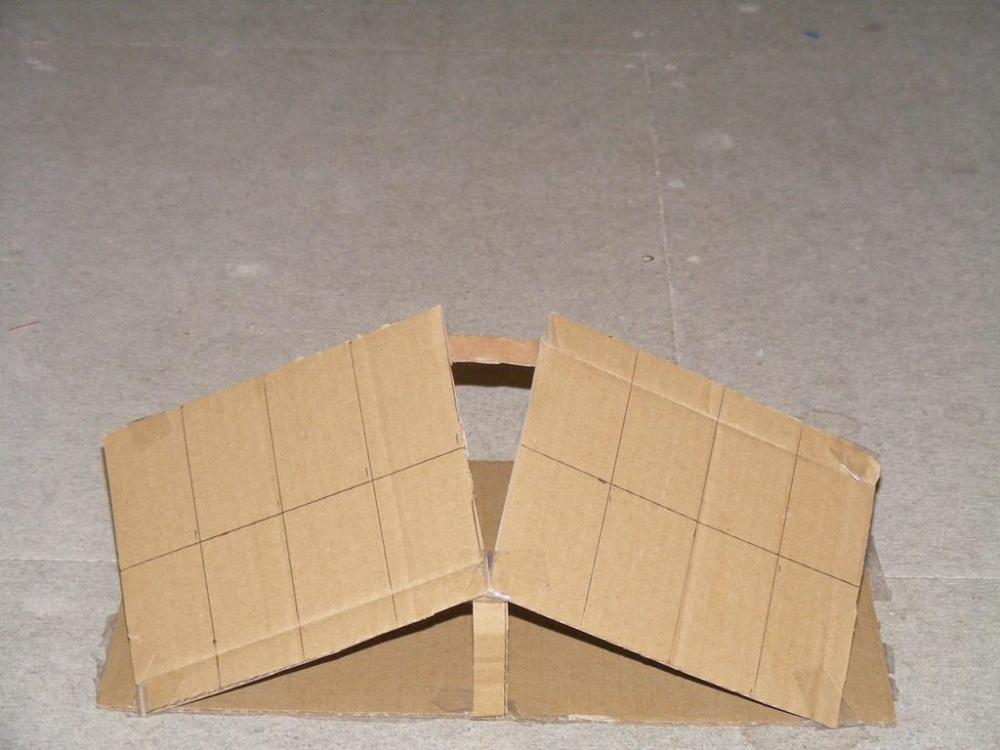

You have now got me thinking of a compound angle.  Keep them E/W split, but then cant both halves over so the S side of the roof is lower, so some slope to the S as well.
I can see the cardboard and sticky tape coming out now.........
A quick CAD model (cardboard aided design). An E/W split, with both halves tilted south a bit as well, viewed from the south.
Might still achieve the objective of longer usable generation with the tilt hoping to improve winter performance.
Anyone care to suggest how to model that on PVGIS?
Effectively you now have a plane inclined facing SSW & SSE (approximately), so that can go into Pvgis.
