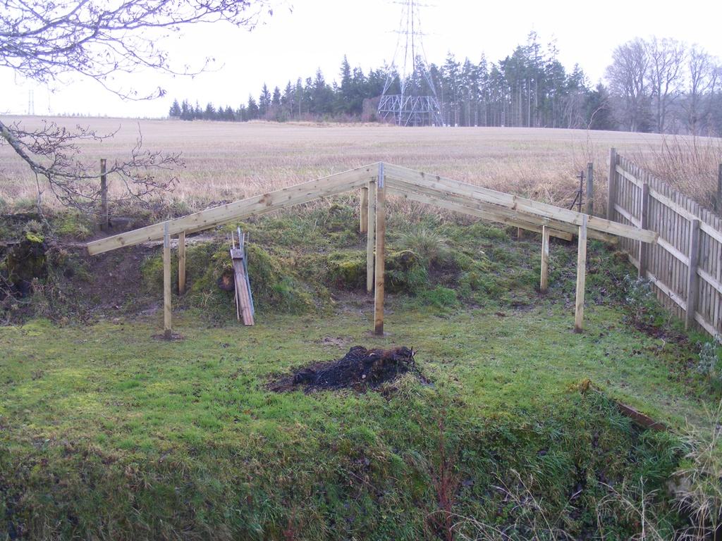

Stage 1 of mount done. Tanalised fence posts and decking joists.
The Unistrut will span front to back over the decking joist to mount the panels on. Then I will asses how rigid the structure is and what diagonal bracing needs to be added.
The eaves are over long at the moment and will be cut when the panels are on and I know where they really come to.
The space underneath will eventually be boarded in to become a shed with the top part up the bank just having a rough platform for limited storage, and the lower part looks an ideal candidate to become the bike shed.

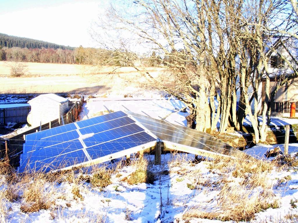

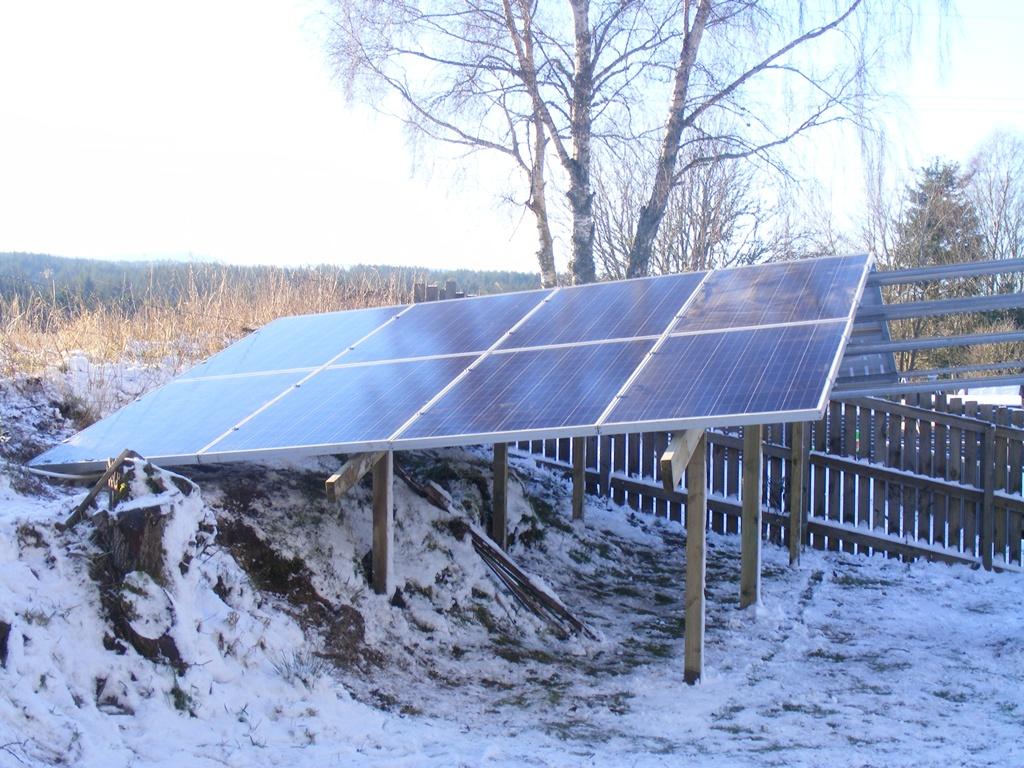

Significant progress in spite of the weather.
All panels now mounted, view from the East
View from the south
The unistrut is still to be cut to length.

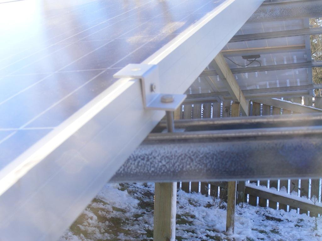

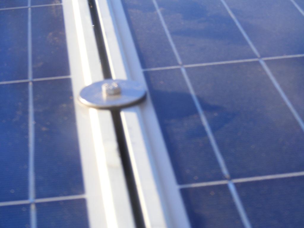

Fixings worked reasonably well.  Between panels a simple penny washer and matching rubber washer
The end fixing was not so good. Plenty of people on ebay selling the same solar pv brackets but nobody gives any dimensions of them. As it happens they are too small for these panels, so the self tapping screw has been added to stop any inclination for the bracket to slide off.
I connected one string today, just the east facing string. It was just gone mid day when I connected it, so well past it's peak and it was generating 300W in the low winter sunshine, and gradually reduced as the sun went further.  Although all the cables are in place, I can't connect the other string until the rest of the MC4 connectors that I have ordered arrive here.
