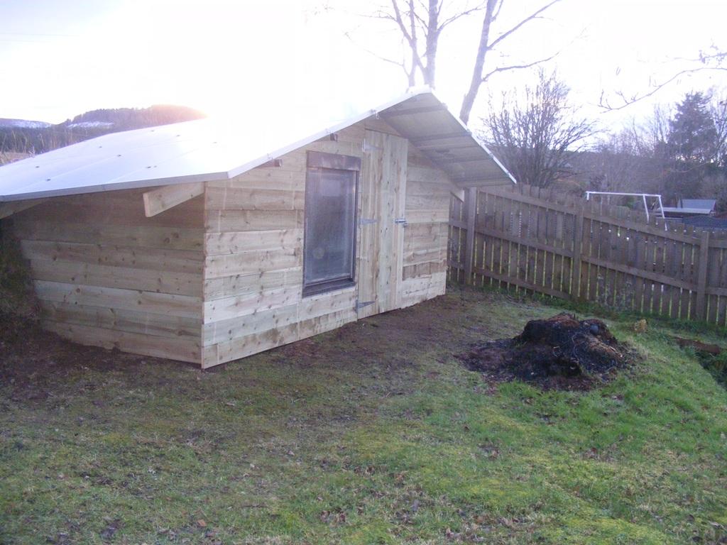

ProDave Posted February 10, 2019 Author Share Posted February 10, 2019 Well I have been busy with some timber, and enclosed the space under the panels to form a shed . Henceforth to be known as the Swiss chalet. 5 Link to comment Share on other sites More sharing options...
Onoff Posted February 10, 2019 Share Posted February 10, 2019 5 minutes ago, ProDave said: Well I have been busy with some timber, and enclosed the space under the panels to form a shed . Henceforth to be known as the Swiss chalet. That looks fantastic! ? Link to comment Share on other sites More sharing options...
newhome Posted February 10, 2019 Share Posted February 10, 2019 Wow that looks fab! Link to comment Share on other sites More sharing options...
Onoff Posted February 10, 2019 Share Posted February 10, 2019 I've got to ask have you got power IN there? Link to comment Share on other sites More sharing options...
ProDave Posted February 10, 2019 Author Share Posted February 10, 2019 No, no power yet. Making a shed of it was an afterthought. There is a SWA buried ready to feed another shed just the other side of the burn, so I can extend from there when I am ready. I could always just put some solar panels on the roof. Oh wait a minute...... 1 Link to comment Share on other sites More sharing options...
Miek Posted February 10, 2019 Share Posted February 10, 2019 Looks cool. Is the roof watertight? Like, between the panel gaps? Link to comment Share on other sites More sharing options...
joe90 Posted February 10, 2019 Share Posted February 10, 2019 Brill @ProDave looks really good ? Link to comment Share on other sites More sharing options...
ProDave Posted February 10, 2019 Author Share Posted February 10, 2019 22 minutes ago, Miek said: Looks cool. Is the roof watertight? Like, between the panel gaps? At the moment, not entirely. The vertical gaps let a little water in. The plan is an internal gutter to catch it and direct it out at the eaves. It will never be totally dry, condensation forms on the back of the panels then drips off in the morning. But it is only a covered shelter, nothing that particular will be kept in it. Link to comment Share on other sites More sharing options...

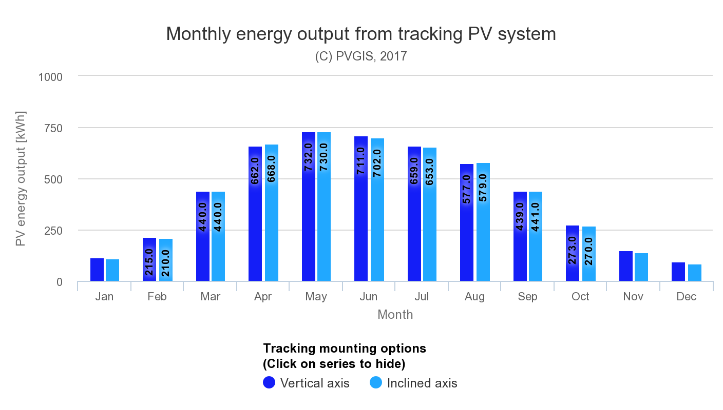

scottishjohn Posted February 18, 2019 Share Posted February 18, 2019 On 17/12/2018 at 08:44, JSHarris said: Whenever I've used PVGIS I've just copied the data from the tables into a spreadsheet and then done comparisons using that. That way you can do things like combine the predicted output for several arrays and see what the overall shape looks like. It's a bit tedious getting the data out of PVGIS and into a spreadsheet, as you need to do several PVGIS runs and then a bit of cutting and pasting of data from each, but once done you can play around with it far more easily. Right now I wish we had some East facing PV, as we have clear skies and sun from the East but are generating sod all, as our 45 deg pitch array faces slightly West of South. It's a nuisance, as I want to charge my car... how do PV paenls work hung vertically on side of house I know a man in denmark with solar thermal and he does that to limit summer outputand get max in winter would it worrk same with PV if so that may work for quite few folk Link to comment Share on other sites More sharing options...
Jeremy Harris Posted February 18, 2019 Share Posted February 18, 2019 11 minutes ago, scottishjohn said: how do PV paenls work hung vertically on side of house I know a man in denmark with solar thermal and he does that to limit summer outputand get max in winter would it worrk same with PV if so that may work for quite few folk Easy enough to check with PVGIS for any location. Just stick in your location, the direction the panels will face and set the inclination to vertical and it will give you the predicted output over a year. It seems to be pretty accurate as far as I can tell. For us it predicted our total annual generation to within better than about 5%. Link to comment Share on other sites More sharing options...

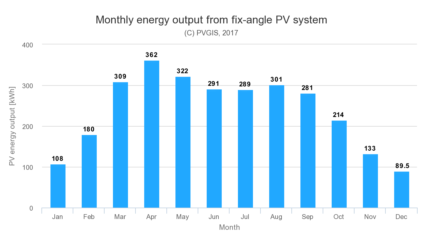

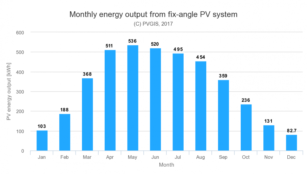

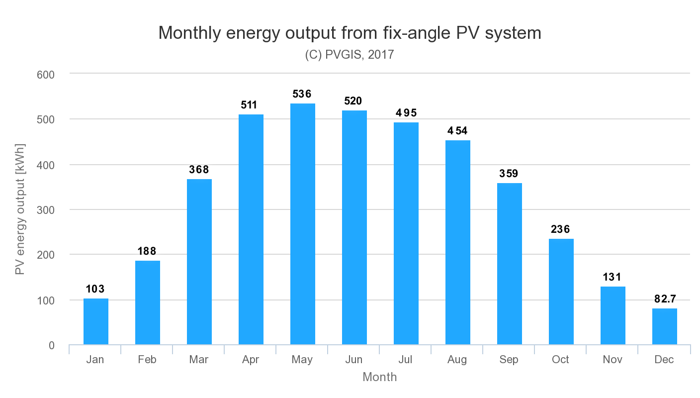

Stones Posted February 18, 2019 Share Posted February 18, 2019 2 hours ago, scottishjohn said: how do PV paenls work hung vertically on side of house I know a man in denmark with solar thermal and he does that to limit summer outputand get max in winter would it worrk same with PV if so that may work for quite few folk My PV array will be mounted vertically. PVGIS suggests an approx 20% reduction in annual output for my location / array orientation compared to optimal mounting angle. Link to comment Share on other sites More sharing options...
scottishjohn Posted February 18, 2019 Share Posted February 18, 2019 1 minute ago, Stones said: My PV array will be mounted vertically. PVGIS suggests an approx 20% reduction in annual output for my location / array orientation compared to optimal mounting angle. does it show more in winter than optimal orientation Link to comment Share on other sites More sharing options...
Jeremy Harris Posted February 18, 2019 Share Posted February 18, 2019 5 minutes ago, scottishjohn said: does it show more in winter than optimal orientation It varies a lot with location and orientation, so the best bet is to go to PVGIS here: http://re.jrc.ec.europa.eu/pvg_tools/en/tools.html#PVP and start by putting in your location. There are initial instructions here: http://re.jrc.ec.europa.eu/pvg_static/en/intro.html . You can then just change the orientation and do another run to get a set of predictions for a year, month by month. There is an option in PVGIS to model a tracking system for any location as well. For example,for our old house in Portpatrick, with a fixed 4 kWp array facing South, then this would be the likely output with the panels at 45°: and this would be the likely output for the same array mounted vertically: Link to comment Share on other sites More sharing options...
scottishjohn Posted February 18, 2019 Share Posted February 18, 2019 so conclusion from those numbers is basically NO only dec+jan fractionally better --rest well down Link to comment Share on other sites More sharing options...
Jeremy Harris Posted February 18, 2019 Share Posted February 18, 2019 2 minutes ago, scottishjohn said: so conclusion from those numbers is basically NO only dec+jan fractionally better --rest well down Vertical will usually give a lower overall output than any other inclination, but the difference tends to reduce as you go North (or South if in the Southern hemisphere). @Stones is up in Orkney, so the difference there may well be smaller than for somewhere further South. It also depends a bit on the local horizon. The location I chose to use is partially set down in the valley at Portpatrick (it's on the old railway line, about 100ft above sea level) so has a clear view to the West, but the horizon to the South and East is higher, which probably impacts the winter generation a bit. For completeness, this is what the same array would probably give if mounted on a two axis tracker: Link to comment Share on other sites More sharing options...
