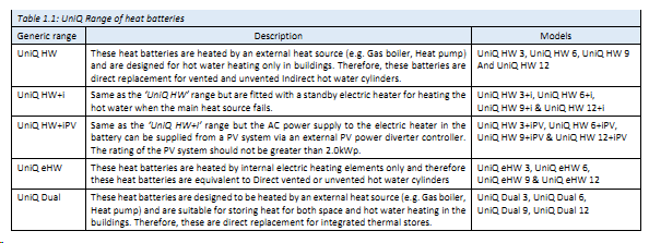

@JSHarris, I have been pondering your issue for a while and think I know the issue.  It is a differing of understanding between you and SunAmp.  Your system is purely electrical and designed for PV input (only), which worked well with the original SunAmp.  The UniQ systems have 3 options:
  1. The UniQ e___ series designed only for electric input.
  2. The UniQ  ___ series designed only for external heat source input.
  3. The UniQ ___ + i__ series which takes both.
The UniQ eHW/eHeat/eDual is designed for permanent connection to power and will recharge when 90%/50 depleted.
The UniQ HW/Heat/Dual is designed for an external heat source (boiler/HT ASHP/…) and will signal for recharge at 50%/90% depletion.
The UniQ HW +i/HW +iPV  has both and will signal for the external heat source at 50%/90% depletion, but accept PV charge whenever it is available (what you want).
You have an eHW but want eHW+iPV control so that it will always accept PV charge when available but could also accept mains charge when reaching 50%/90% depeletion.
The problem being that the eHW charges/discharges in the opposite direction to the other units.
You could potentially wire up as an eHW+iPV with mains on the control circuit and PV on the power diverter circuit, then when the control circuit is at 50%/90% depleted the control circuit could switch a mains relay changing from PV diversion to mains power (not enough PV to charge) and charge from the mains.  Hopefully it would never reach this level of depletion.  You would probably need the UniQ_SBC_02 controllers (suspect you can’t reprogram yours different connectors) and have to plumb the units up the other way round (flow/return).
This problem is I suspect a lack of understanding from SunAMp on how units are being deployed, PV reinforcement the system should work perfectly, but for PV only the programming is wrong.

I'm somewhat flabbergasted by this post. In all my communications with Sunamp the "+i" option has never been mentioned. The system was specified by Sunamp with the full knowledge of my desire to maximise PV usage.
If what you've written is right I'm at a complete loss as to why when Sunamp replaced my entire system (2 units) at their cost they didn't change my units to "+i".
Can I ask where you got this information?
Posted
The snag is that the iPV model will only work with small PV systems, < 2.0 kW:
Anyway, the controller I have is clearly labelled as being a "UniQ_SBC_01_PV", so there's really no valid excuse for it not reliably charging from PV, or the early morning off-peak boost charge (it fails to charge from either at times, hence the reason we've run out of hot water).
Note that the unit I have is specifically quoted as being "equivalent to Direct vented and unvented hot water cylinders".  It isn't, though, at least until the refusal to accept charge when there is available charge capacity issue is resolved.
BTW, the PV setting is just an option in the controller, and is set for my unit.

From the UniQ manual posted here by somebody else.  I just read through all the options.  It appears that the system is capable of of doing what is wanted jut not configured by SunAmp in the appropriate manner.
SunAmp should have an eHW+iPV model that is plumbed as an e__ model but controlled as a +i__ model.  Ideally it should have 3 mains feeds, one permanent supply, one PV shunt and an economy 7/10 threshold take power from the normal supply.  Ideally it would have more sensors than the 3 at the moment (10) so you could select each of the thresholds on setup.
SunAmp could offer the units as standard or advanced, with the advanced having more sensors and control options for a small premium.
Surely that is just an power limit, if you have more power the UniQ just won't accept it/you diverter channels it elsewhere.  Again a control issue.
Posted
Sadly this isn't the case.  There is no option to enable the controller (any controller) to switch on power to the electric heating element until the controller has guesstimated that the heat cell is ~50% discharged.  I've been through all the possible options and settings and had them clarified by Sunamp, and the ~50% discharged, before accepting any charge, threshold is something that's common to all electrically heated units.
The iPV version is a dual model, that has the ability to be heated by both hot water from a boiler, plus diverted excess PV.  In essence the control logic, as far as controlling the heating from PV is concerned, is much the same as the eHW, except that I'm not 100% sure that it has the "cold start" routine, where it pulses power on and off when heating from cold, I think it may well rely on there not being an excess of power available from any PV diversion, hence the <2 kW or <2.5 kW limit (the manual confusingly quotes two figures).  I also seem to recall that the heating element in the iPV has a lower power rating.  This is only hinted at in the manual, where they state clearly that only the eHW has a 2.8 kW heating element and that the i models have  "standby electric heating elements".
I agree, they could, and should, offer enhanced controller functionality for those whose primary requirement is to heat hot water from excess PV generation.  Shame they don't, although my controller hints at this by having a clear label stating that it is a UniQ_SBC_01_PV, which strongly implies that it is a PV capable unit, and that's borne out by it having the PV option in the menu (which is set).
