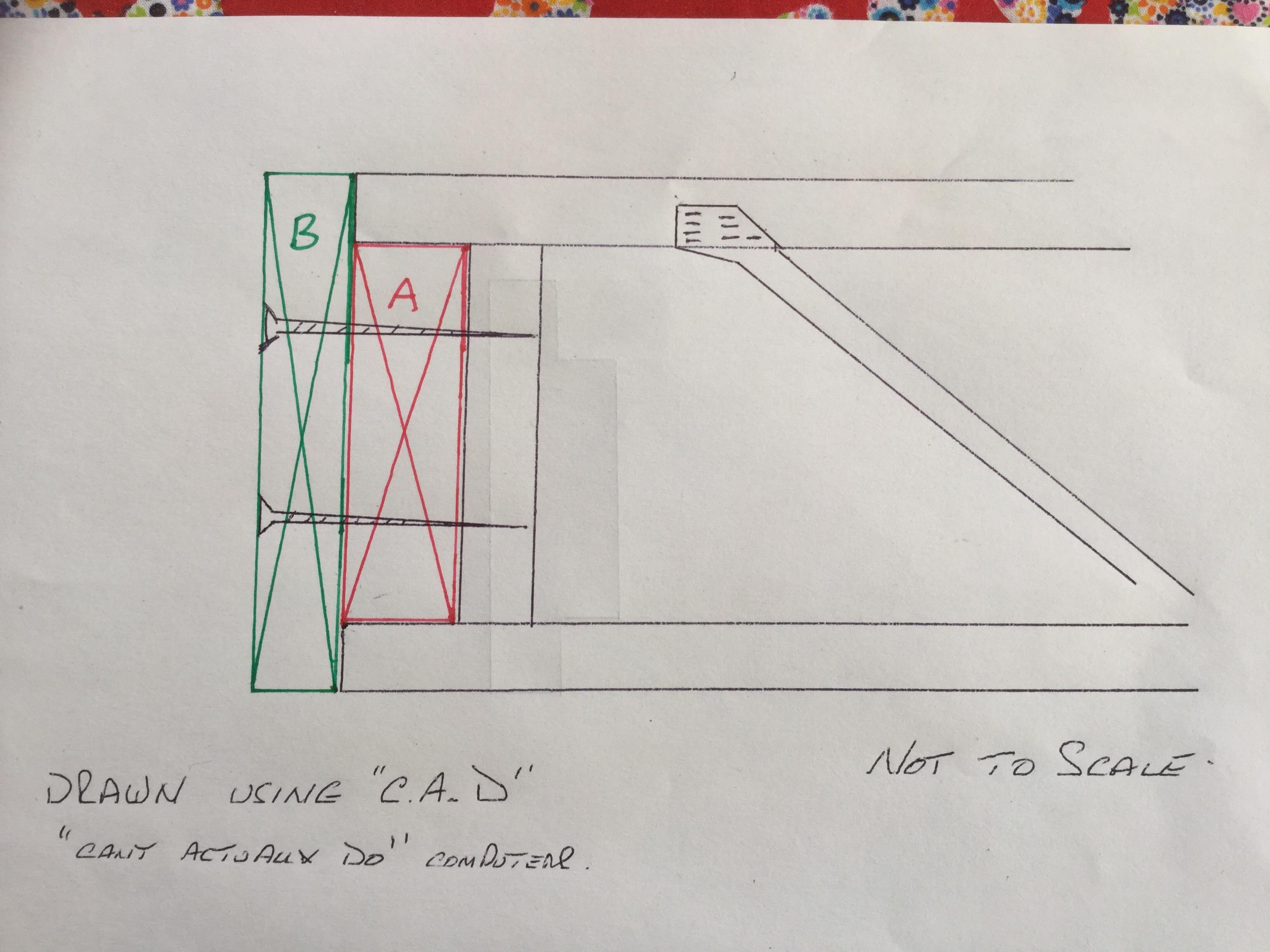

Mr Punter Posted November 29, 2018 Share Posted November 29, 2018 The proposed solution shows 2 vertical pieces and new 3" block. The photo on @recoveringacademic's original post just has a single upright and I can't see how this will work. Maybe just screw length but a new drawing may be needed. Link to comment Share on other sites More sharing options...
joe90 Posted November 29, 2018 Share Posted November 29, 2018 (edited) I think you will find that some joists only have one end vertical piece and others have two. I still think it depends on what the BCO will accept. Like others I don’t like the 3” block idea and prefer my “T” piece idea, again it’s down to what the BCO will accept. On reflection rather than try to make lots of “T” pieces, (which I could do with my woodworking machines but more difficult without) I think two pieces glued together might be simpler. If @recoveringacademic wants me to I will draw a diagram of what I propose and he could send it to Nicola, if they accept it (in writing) that will keep building control happy. Edited November 29, 2018 by joe90 Link to comment Share on other sites More sharing options...

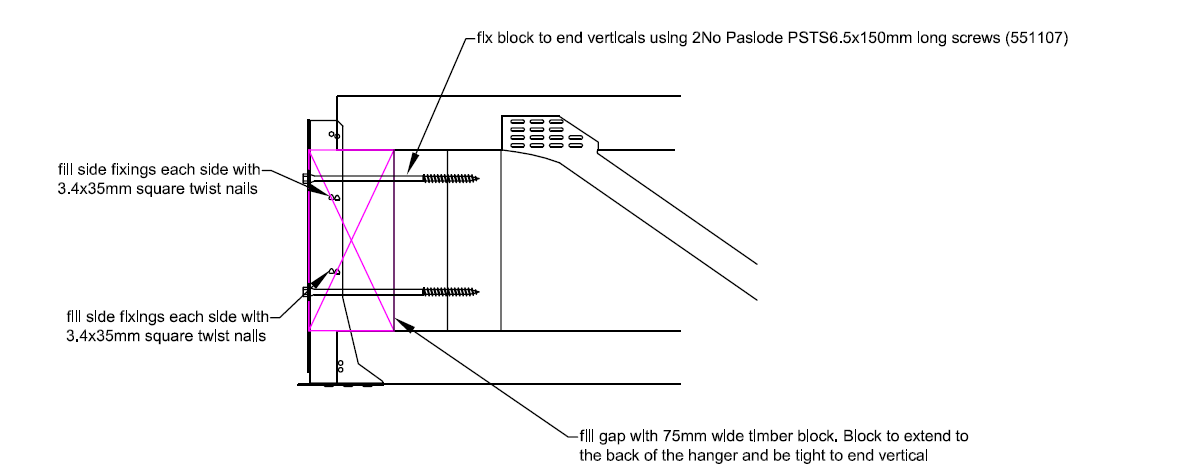

ToughButterCup Posted November 29, 2018 Author Share Posted November 29, 2018 Thanks folks. Here's a copy and paste from the manufacturer I spoke to the engineer who calculated the detail at Cullen and have had this response below. “Hi Steve, They are welcome to put blocks in above and below but they are not required. If they feel they want to do this it’s fine as long as the screws are in and the middle block is tight first. Regards,” So yes, if you want to fill the areas above and below then not a problem but it is not required for the floor performance. Best regards, Steve In other words, the top and bottom chords can be supported. One by one we're knocking them down............. Now then, how to handle the BCO? Advice please. If the manufacturer has designed and signed off a solution to the problem, has the BCO the authority to refuse to allow the modification? If he / she were to refuse (and in this case a refusal really would offend) surely it would have to be on the basis of reasoned argument? Put another way, this solution enables the BCO to argue that it's nothing to do with him (in this case it is a him). For the sake of completeness, I attach the relevant document for review. 104 18 - Cheshire Roof Truss_28-11-2018_R-104 18_RevA.pdf Link to comment Share on other sites More sharing options...
joe90 Posted November 29, 2018 Share Posted November 29, 2018 In my experience BCO,s cover their backs with documents given by suppliers, they don’t usually disagree with them. I would just present the BCO with what you have been supplied with by the manufacturer and get him to agree that you can do this (I would be extremely surprised if he disagreed). Then I will do you a diagram (if you want) of what I would do that would satisfy the manufacturer and your BCO. and is easy to do. Link to comment Share on other sites More sharing options...
ToughButterCup Posted November 29, 2018 Author Share Posted November 29, 2018 1 minute ago, joe90 said: In my experience BCO,s cover their backs with documents given by suppliers, they don’t usually disagree with them. I would just present the BCO with what you have been supplied with by the manufacturer and get him to agree that you can do this (I would be extremely surprised if he disagreed). Then I will do you a diagram (if you want) of what I would do that would satisfy the manufacturer and your BCO. and is easy to do. Thanks Joe. The cheque is in the post...... I like the sound of the last bit... the diagram and .... easy to do. I like that a lot. Link to comment Share on other sites More sharing options...
joe90 Posted November 29, 2018 Share Posted November 29, 2018 (edited) I would make up the “T” piece using two blocks A and B as per below, glue all in place with d4 expanding glue, I would countersink the screws in a little that gives you some timber to plane off in case it’s too tight in the hangers. Also drill pilot holes in A and B so you don’t split them. Make sure the blocks are the same width of the joists. Using two blocks saves you having to cut a “T” section if you don’t have woodworking machines. Shame I am not closer, I would help you out with this, it’s right up my street this woodworking malarky. Edited November 29, 2018 by joe90 Link to comment Share on other sites More sharing options...

joe90 Posted November 29, 2018 Share Posted November 29, 2018 3 minutes ago, Declan52 said: Instead of long screws would something like coach bolts not be stronger. As everything is in compression I am not sure it would add anything, plus, the manufacturer stipulated screws and the BCO would want that followed. Link to comment Share on other sites More sharing options...
mvincentd Posted November 29, 2018 Share Posted November 29, 2018 I really don't understand why they are saying the filler block (particularly at bottom) isn't necessary, given its so easy to achieve and surely good practice at least even if not critical at an engineering level. Their drawing shows a single block reaching from back of joist hanger to joist vertical. Might they baulk at splitting that into two blocks...suggesting a shear line is introduced as per pink on drawing below left. In which case does drawing right mitigate. 1 1 Link to comment Share on other sites More sharing options...

ToughButterCup Posted November 30, 2018 Author Share Posted November 30, 2018 Thanks boys... only just seen this. I sent the drawings and email exchange to the BCO yesterday. He's visiting on Monday. Would it make sense to put another block tight up against the top chord - in the same way that there's a yellow block on the bottom chord in your drawing @mvincentd ? I'll try a mock-up over the weekend. Link to comment Share on other sites More sharing options...
joe90 Posted November 30, 2018 Share Posted November 30, 2018 Yes I would also block the top, but then again my wife says I am OCD . 1 Link to comment Share on other sites More sharing options...

ToughButterCup Posted November 30, 2018 Author Share Posted November 30, 2018 Key issue ( @scottishjohn ) is sign off....... by the SE at Cullens, and the BCO. @mvincentd, I have asked directly whether I may put blocks in top and bottom because I thought - given all the posts by you @JSHarris and others about compression, shear and bouncing POSIs. I'm surprised you make the point above - '...and surely good practice at least even if not critical at an engineering level....' I thought it was critical. But then what do I know? [ A whole lot more than I did on Monday] Link to comment Share on other sites More sharing options...
joe90 Posted November 30, 2018 Share Posted November 30, 2018 (edited) 20 minutes ago, scottishjohn said: suggested that 4 pages ago ..double up the thunder bolts+ screw wall plates together --job done - he would be doing the flooring by now--maybe even the carpets.LOL But that had not been sanctioned by either the joist company or the BCO for signoff, personally I would rather extend the joists in an engineered fashion. oops, cross posted with @recoveringacademic (Great minds think alike ?). Frankly it is critical, there is nothing worse than a bouncing of flexing floor that can’t be put right after the build is finished. Edited November 30, 2018 by joe90 Link to comment Share on other sites More sharing options...
