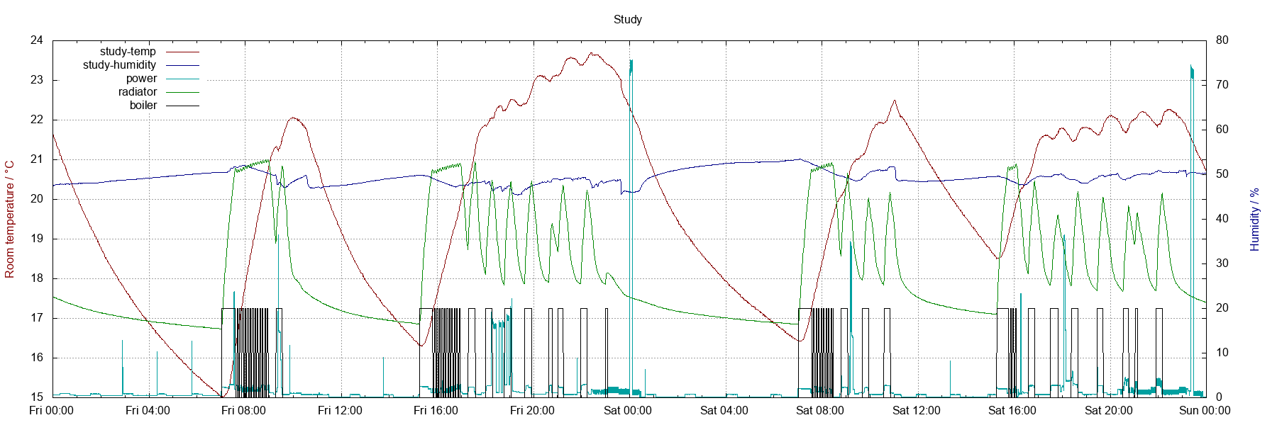

Ed Davies Posted November 25, 2018 Posted November 25, 2018 My preference when sitting still is anywhere between 21 and 23 °C. That's wearing a thickish sweatshirt and a pullover. I keep to that in the spare bedroom which I'm now using as a study, the rest of the house is at various cooler levels though the bathroom's about the same. The kitchen is usually a bit less than 18 °C which if fine for cooking and eating. Bedroom surfaces are various temperatures from about 14 to 17°C. I don't use the main living room except for storage, and only have one of the two radiators in there turned on, which makes temperature control awkward as the main thermostat is in there. I'm doing a little experiment to compare running the heating on a timed cycle vs running it continuously (just letting the thermostat do its thing). Mostly I've had it timed to run from 07:00 to 23:00 then switch it off manually when I go out but with it set to switch itself on again late afternoon. Did a week of continuous the week before last and this afternoon set the programmer to do it again for this week. Comparing just that one week of continuous with the rest of November so far there's no obvious difference. It'll need comparing against the weather, of course. Quick plots showed little correlation with outside temperature but a bit more with wind. I'll need at least a few more week's of data and some thinking about how to deal with “windchill”.

Ed Davies Posted November 26, 2018 Posted November 26, 2018 9 hours ago, newhome said: What do you use for heating? This is for the house I'm renting during the build, not what I'd choose for myself. It's an oil boiler direct to radiators. DHW is from a conventional vented cylinder. My landlord had the oil boiler replaced in the summer and the system was converted then to S-plan: two zone valves, one for the CH and one for the DHW indirect coil. The programmer is set to heat the DHW cylinder for an hour or so in the late afternoon and generally does so in half an hour. That gives plenty of hot water for the washing up in the evening and general washing evening and morning. The shower is electric (presumably to get mains pressure) so, except for the occasional bath, there's always more than enough hot water. Graph of relevant data for Friday and Saturday attached. Room temperature (red) on the left hand scale. All other variables on the right hand one (arbitrarily labelled humidity). Humidity is percent RH, power (pale blue/cyan) is in hundreds of watts (so the two big spikes just before the midnights are my showers, 7 kW electric shower). Boiler state is derived from the temperature of the radiator (so doesn't include DHW heating). It it were my house I'd add a couple of relays hung off the wiring centre to monitor the calls for heat by the CH and DHW tank but don't want to mess with my landlord's wiring. The blibs of power overnight and while I'm out are the fridge running. Sometimes the power monitor picks up the start current spike from that. When the heating is stabilised the boiler just runs for 15 minutes or so in each hour to a fairly regular pattern, controlled by the living room thermostat. When it's cold and windy the runs get closer together. When I've left the heating off while I'm out or overnight it initially runs continuously for 20 minutes then, once the circulating water is all up to temperature, short cycles for a while till the living room thermostat stops calling for heat. What's not obvious from just eyeballing the graph is how much is actually saved by letting the house cool down overnight and while I'm out then heating it back up. Just looking at the graph it seems like it's a bit of a wash hence my attempts to measure more accurately. Intuitively, any time the house is cooler it should be losing heat more slowly so the net amount of heating should be less but I speculate that there are other factors which mean there's less difference than you might expect. 1

Ed Davies Posted November 26, 2018 Posted November 26, 2018 35 minutes ago, jack said: Our entire house temperature dropped to 14.5°C My bedroom temperature drops more than that overnight without the heating on and is clearly on the way further down when the heating comes on in the morning, but then even a well-built Victorian or Edwardian (not sure) house is not likely to compare well against a modern one. More interestingly, any idea if your house had stabilised at that temperature or was still cooling? I'm guessing that any bright days would have kept it at something not far below that temperature just by solar gain alone.

newhome Posted November 26, 2018 Posted November 26, 2018 3 hours ago, Ed Davies said: When the heating is stabilised the boiler just runs for 15 minutes or so in each hour to a fairly regular pattern, If that happened here I would use 6kw every hour. I don’t think it would as the room temps don’t drop that much, if at all, in an hour. When the boiler fires once a day it takes an hour to an hour and a half to reach the temp that the cylinder stats are set to, so that’s between 24 and 36kw. I can’t see it being less than that (or the same) if the heating is set to be a constant temperature. May have to try it over a few days and check however I don’t have a snazzy way of monitoring it so it will be rough and ready from meter readings (heating / DHW is on a different meter so I can work that out ok at least).

TerryE Posted November 26, 2018 Posted November 26, 2018 4 hours ago, Ed Davies said: What's not obvious from just eyeballing the graph is how much is actually saved by letting the house cool down overnight and while I'm out then heating it back up. Just looking at the graph it seems like it's a bit of a wash hence my attempts to measure more accurately. Intuitively, any time the house is cooler it should be losing heat more slowly so the net amount of heating should be less but I speculate that there are other factors which mean there's less difference than you might expect. It seems to me that there are two broad thermal management approaches: Thermos flask, that is you have a very low U-value external boundary and minimise other heat losses, but within this outer boundary any heat barriers are an order of magnitude+ lower than the external barrier. In this scenario it makes sense to keep the whole internal environment at the same time-constant set point and accept the heatflow at the barrier. That's in reality what people like Jeremy, Jason, and I do. Energy costs are very small because of the efficiency of the external barrier, and because there aren't material internal barrier you can use a single heat source like groundfloor UFH , so the whole heating system is so much simpler -- we have no rads; no upper floor UFH or the like with all of the entailed costs and complexity. Onion ring / many layers. This is opposite to the thermos flask approach: only heat the living space that you use and when you use it to the comfortable temperature, so the snug might be at 21°C for 7 hrs a day, the other lived-in rooms at 19°C for 12 hrs a day, the whole house at 14°C etc. This is a sort of defence-in-depth approach to heat losses. @Ed Davies, in your case you seem to be running the living room at an average of around 18½-19°C by ToD heating rather than a target of 21°C . The rest of the house probably has similar but stepped down figures. so the first order would be to plug a ΔT of 2½ °C into your houses U-value calcs for see what the energy implications would be. 22 minutes ago, newhome said: What determines how low a house’s temperature will drop to with no heating on? In the side of the house that I don’t use the temperatures both upstairs and down are just over 11 degrees. Karen, in practice you seem to be using your house as 2×Semis with one effectively unheated. There will be an internal wall interface between the two halves, and an internal stud wall with PBoard either side and acoustic insulation will have a U-value of roughly 1 W/m²K and the heat flowing from the warm to the cold side at a ΔT of 10°C will be 10X W where X is the area of the internal partition interface. So this internal wall is like a huge radiator sucking heat out of the warm half and heating the cold half. The cold half will be in rough equilibrium with external wall losses matched by the input from the warm side. Keeping half the house warm will save around maybe 25% or less of the heating bill rather than the 50% that you might expect -- still this is still a non-trivial amount. 36 minutes ago, jack said: Why do you conclude that this decision was about money? TBH, J in your case I didn't think that it was about money, but we've now dismissed this. As far as monitoring our HA I use a combination of the Node RED node-email to push alarms which I pick up anywhere using my phone, and OpenVPN which is simple to use and is brilliant for doing remote access / monitoring. I run the server install on an RPi which opens a (non-standard) port onto the internet for SSL connection, and so I can securely access my HA and other services / servers in the house from anywhere -- and I can also watch iPlayer from a Greek Taverna.

Ed Davies Posted November 26, 2018 Posted November 26, 2018 Wot @TerryE just sed: if one room's at 21 °C and 50% relative humidity and another room is at 11 °C then any air that filters through from the warm room to the cool room will just about reach its condensation level. Rough rule of thumb: the equilibrium vapour pressure doubles (halves) for each 10 °C increase (decrease) in temperature. 2
Ed Davies Posted November 26, 2018 Posted November 26, 2018 1 hour ago, TerryE said: so the first order would be to plug a ΔT of 2½ °C into your houses U-value calcs for see what the energy implications would be. ? It's a rental house which I really hope this is my last winter in it. I've had a quick scan through the EPC and I'm sure the estate office would let me have a copy if I asked but I doubt the assessor had any better idea of the insulation and actual U-values that I have (i.e,, very little). I'm doing monitoring for short-term comfort at minimum cost (oil burn) and to have tools to hand for tuning when I move into the house I'm building.
