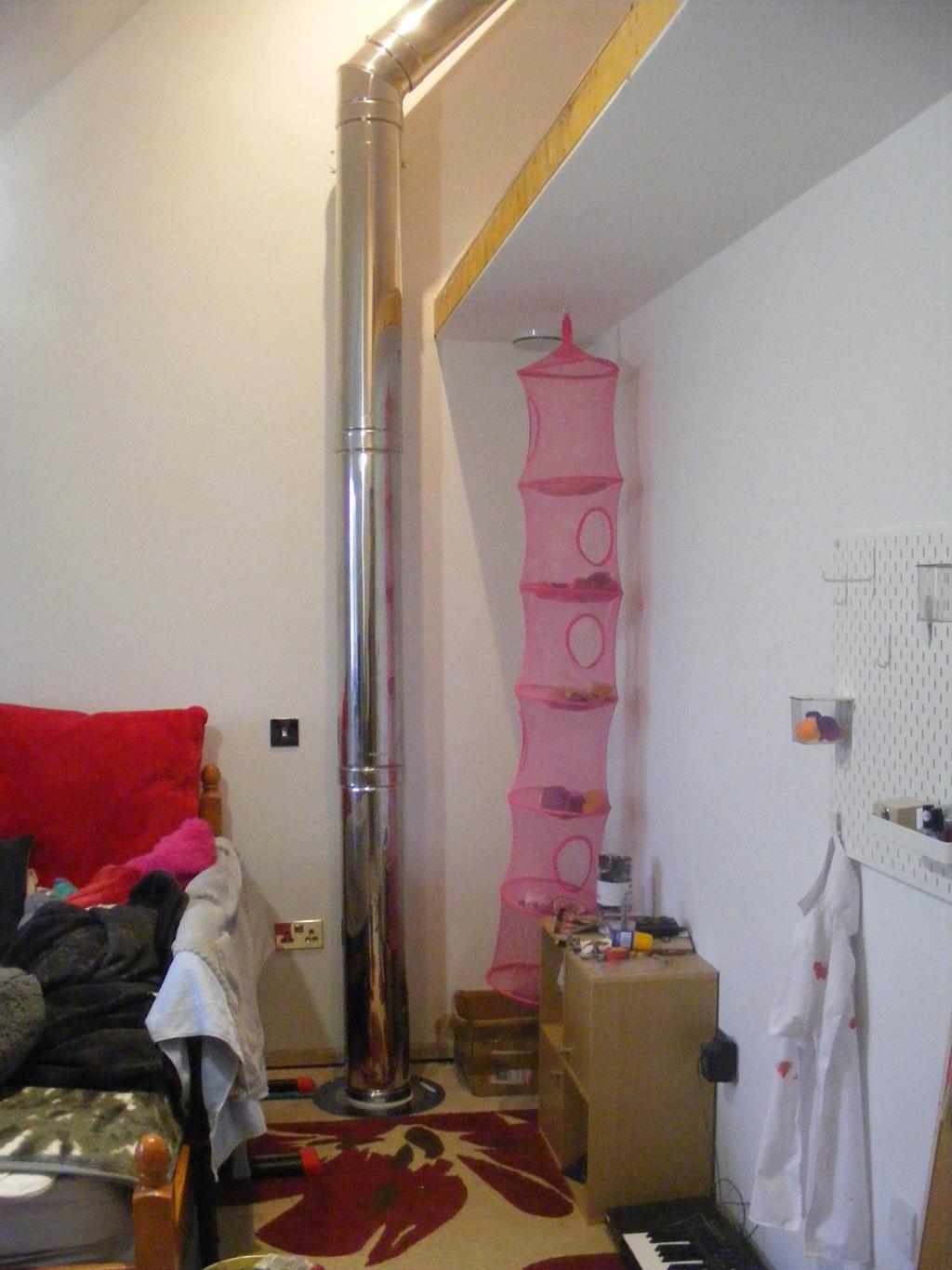

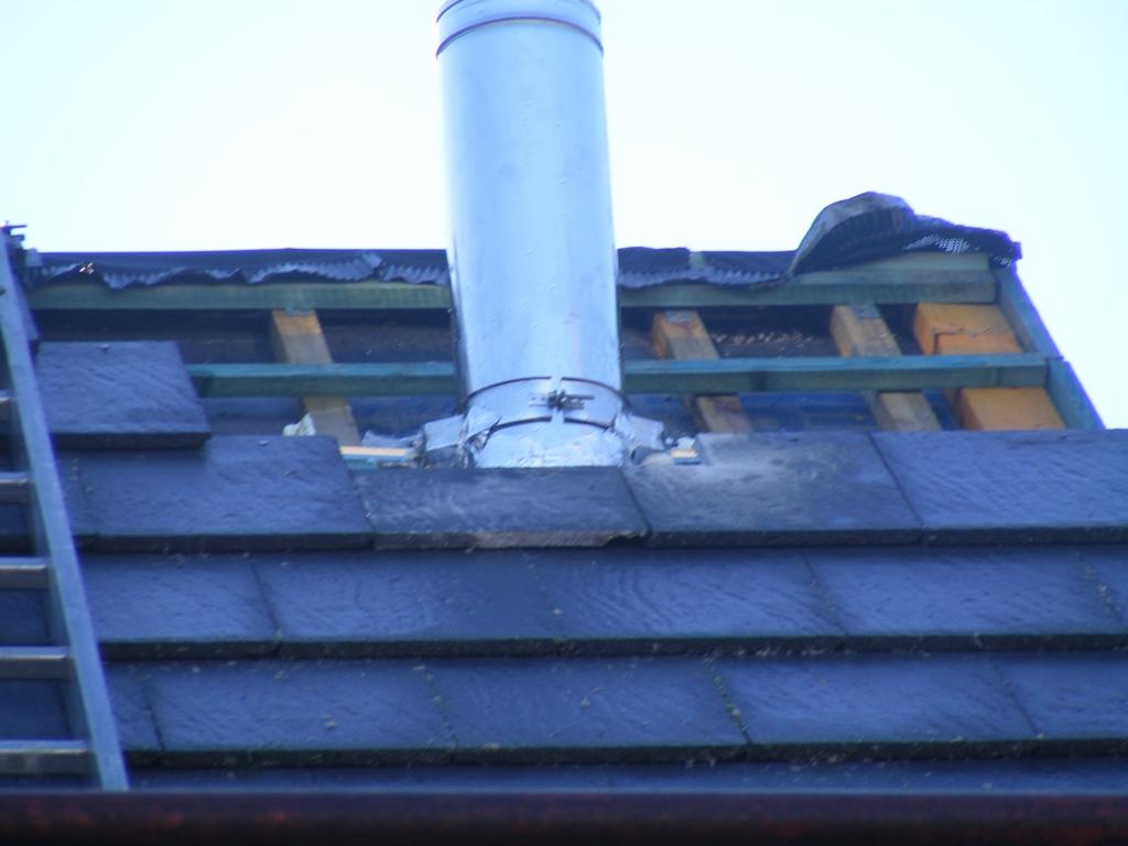

ProDave Posted November 19, 2018 Posted November 19, 2018 The last few days has seen me installing the flue for the wood burning stove. First put up some scaffold and remove a few roof tiles Cut a hole and put the flue through the roof, shown here after the first row of tiles was put back. It is worth noting some detail. I wanted to retain as much air tightness as possible, but flamable materials (the wood fibe sarking board) must remain 6cm from the flue pipe. Solution: An insulated sleeve. Obviously this is made of non flamable material, and is >6cm thick so this can be made a snug fit through the wood fibre, and any gap sealed with foam. Here is the flashing on and tiles put back The flue then runs down through the bedroom, down through the kitchen into the stove. The cover plates cover up the holes that are at least 6cm larger than the flue in all directions. And the test firing And now a few questions: I am going to need a heat shield plate up behind that flue downstairs. Does anyone know where I can buy one that does not cost an arm and a leg? (seen prices of about £250 so far)? And I expect the bedroom with the flue pipe is going to need a CO alarm. Are there any regs saying how close to the flue it needs to be? In particular with the flue going so high up the room does the CO alarm need to be that high? (Is CO lighter or heavier than air?) 1

gravelld Posted November 19, 2018 Posted November 19, 2018 Doesn't the pipe in the bedroom get a bit hot - don't you need to guard around it?
ProDave Posted November 19, 2018 Author Posted November 19, 2018 2 hours ago, dpmiller said: Looks neat, but is there not now a requirement for a longer length of twinwall to be through the ceiling, 450mm or something? I fear you might be right. It's the 3 times diameter to combustibles rule for single flue pipe. Easy to fix if I have to, insert an extra short section of twin wall above to push that twin to single wall adaptor down. I might leave that as the "fault" for BC to find and fix it then.
ProDave Posted November 19, 2018 Author Posted November 19, 2018 30 minutes ago, gravelld said: Doesn't the pipe in the bedroom get a bit hot - don't you need to guard around it? No it's barely warm to the touch, quite safe. The rules say it has to remain 6cm from combustible materials but there is no way it is hot enough to do any harm. You have to box it in if pt passes through a loft, but not where it passes through a room. 1

Nestor Posted November 22, 2018 Posted November 22, 2018 On 19/11/2018 at 13:52, ProDave said: It is worth noting some detail. I wanted to retain as much air tightness as possible, but flamable materials (the wood fibe sarking board) must remain 6cm from the flue pipe. Solution: An insulated sleeve. Obviously this is made of non flamable material, and is >6cm thick so this can be made a snug fit through the wood fibre, and any gap sealed with foam. Great work Dave. I need to fit a flue through 40mm Pavatherm and then Tata steel roof soon. Have you just used some taped Rockwool as a sleeve? Do you know what distance the stove / flue needs to be away from flammable material, thanks for your help.
ProDave Posted November 22, 2018 Author Posted November 22, 2018 In my case the flue came from flue-pipes.com It has to be 60mm from flamables. That sleeve was sold by the flue manufacturer as an insulated wall / ceiling sleeve so made for the job, you cut it to the angle of your roof, 45 degrees in my case. It is a hard sort of rockwool batt type material. Obviously as it is sold for this purpose by the flue manufacturer, it is a non flamable material, and as it's >60mm thick, it is okay for flamable material to touch the outside of the sleeve as that flamable material will be >60mm from the flue. 1
