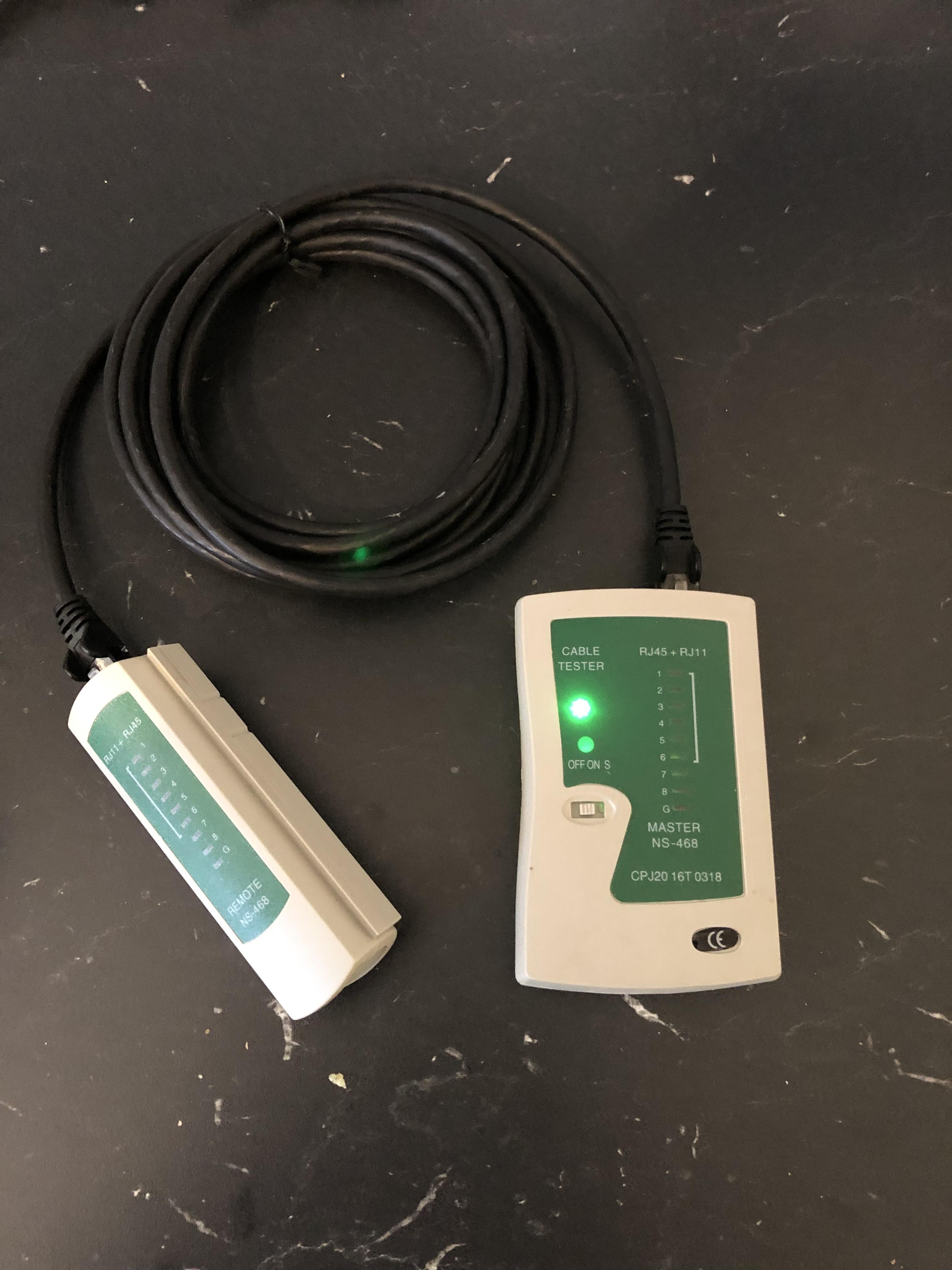

Pocster Posted November 22, 2018 Author Posted November 22, 2018 Got new crimper - seems excellent! So filled with confidence I crimp away . Use the connection checker - nothing ! Cant believe I’ve crimped that bad so use checker on a bought pre wired cat5 cable ! - nothing !!!! . Ffs the checker is crap too !!!!
Pocster Posted November 22, 2018 Author Posted November 22, 2018 This crap ! green light just stays on !! . If I kick it and swear at it green light sometimes goes off . ffs x 2 Needless to say hopefully a ‘quality’ tester ordered ....

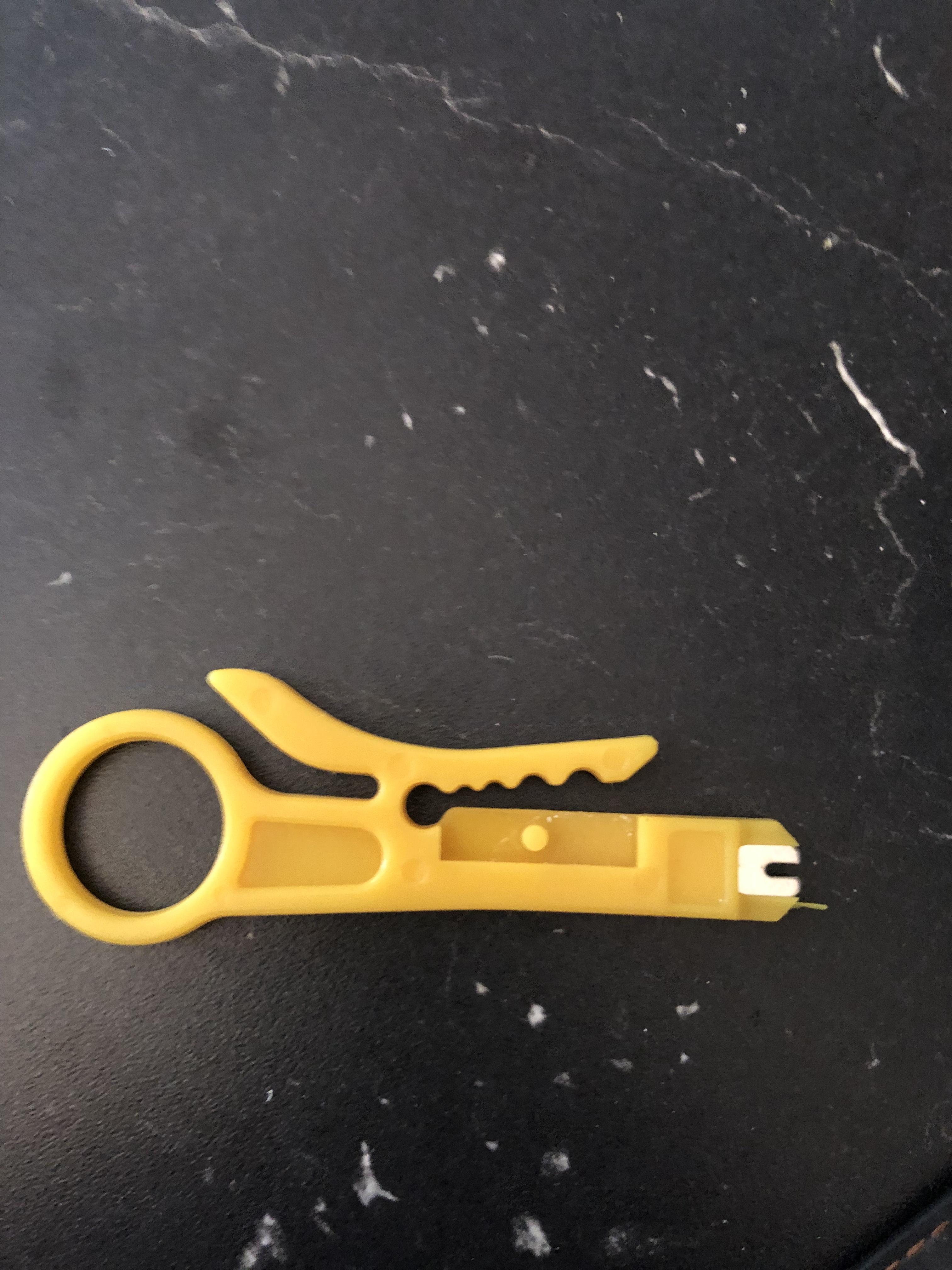

Pocster Posted November 22, 2018 Author Posted November 22, 2018 Oh yeah ! Now I also notice the blade has fallen out from the quality cable stripper . So ! In this bargain pack you have ... A crimper that doesn’t crimp A tester that doesn’t test A cable stripper that doesn’t strip Come in a nice case though ! 1
daiking Posted November 22, 2018 Posted November 22, 2018 On 22/11/2018 at 12:02, pocster said: Oh yeah ! Now I also notice the blade has fallen out from the quality cable stripper . So ! In this bargain pack you have ... A crimper that doesn’t crimp A tester that doesn’t test A cable stripper that doesn’t strip Come in a nice case though ! Expand I’ve seen better strippers in my time. 1
ProDave Posted November 22, 2018 Posted November 22, 2018 I have that same tester and mine works fine as do the crimpers that came with the kit. I use an ordinary decent pair of side cutters to strip the cable.
PeterW Posted November 22, 2018 Posted November 22, 2018 On 22/11/2018 at 11:58, pocster said: This crap ! green light just stays on !! . If I kick it and swear at it green light sometimes goes off . ffs x 2 Needless to say hopefully a ‘quality’ tester ordered .... Expand Push the switch all the way to the right ...
Pocster Posted November 22, 2018 Author Posted November 22, 2018 On 22/11/2018 at 12:31, PeterW said: Push the switch all the way to the right ... Expand Yeah done that . Green light always on It did appear to work a few days ago . Now it’s just a rubbish torch ?

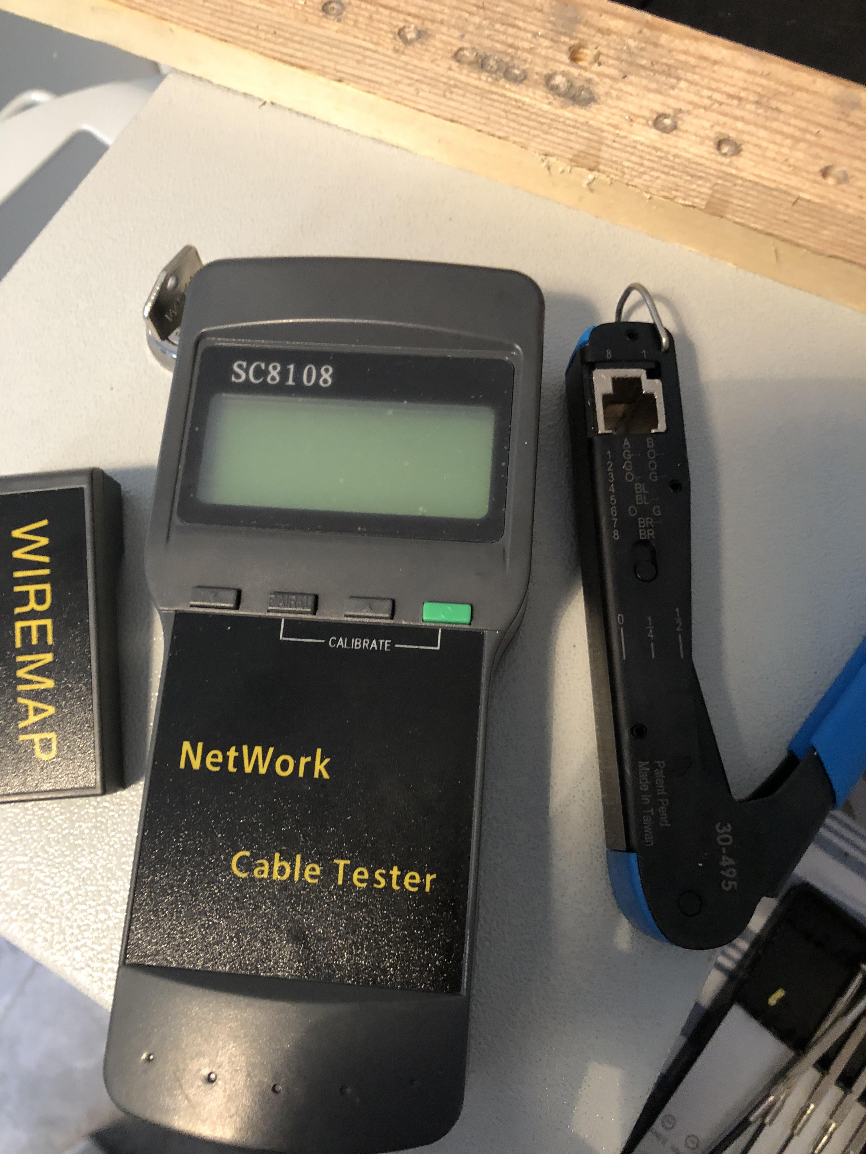

Pocster Posted December 5, 2018 Author Posted December 5, 2018 Well ! What a difference proper tools make . This push thru crimper is excellent . Also the new cable tester is great ( display a little poor to read as unlit ). So far out of 5 fitted rj45 ‘s ZERO failures . 1
PeterW Posted December 5, 2018 Posted December 5, 2018 Looks like an Ideal crimper - S’fix sell them as do others. 1
Pocster Posted December 5, 2018 Author Posted December 5, 2018 It’s a dream ! https://www.screwfix.com/p/ideal-industries-rj45-ft-45-feed-thru-crimp-tool/8518x
Onoff Posted December 5, 2018 Posted December 5, 2018 On 05/12/2018 at 15:34, pocster said: It’s a dream ! https://www.screwfix.com/p/ideal-industries-rj45-ft-45-feed-thru-crimp-tool/8518x Expand Now be honest, it was the shape that attracted you? 1
Pocster Posted December 5, 2018 Author Posted December 5, 2018 On 05/12/2018 at 15:49, Onoff said: Now be honest, it was the shape that attracted you? Expand Nah ! It really is ace . Once you have the wires lined up the push thru rj45 does seem to guide them through . Quick visible inspection ; then a surprisingly gentle ‘crimp’ action and you’re done . If a 2nd referendum was a crimper it would be this crimper . The other shite crimper is Brexit .
