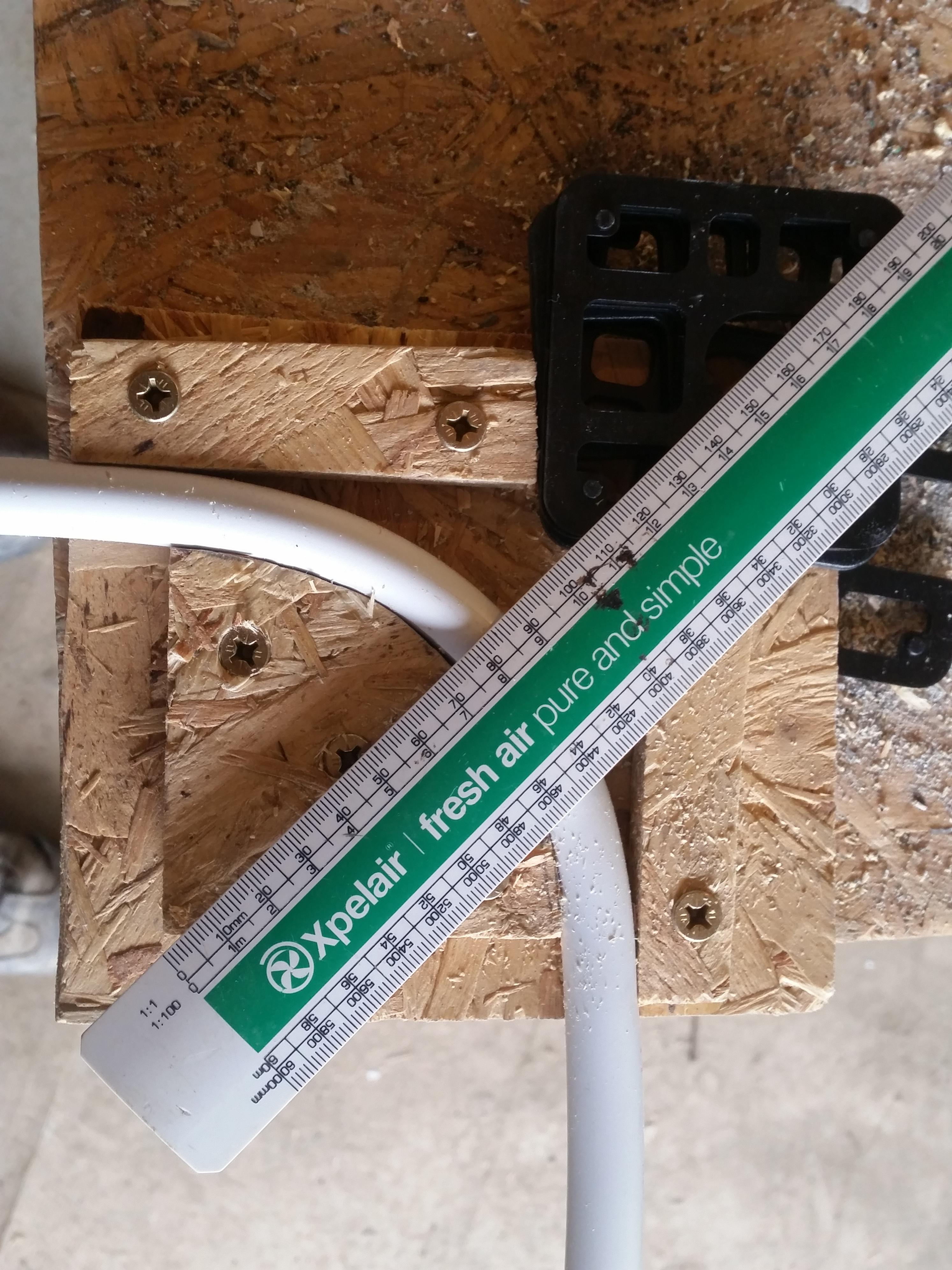

MikeSharp01 Posted November 15, 2018 Posted November 15, 2018 I have to run some pipework inside the wall around one of our showers. I had decided on plastic (HEP / JG or some such) but I have to turn it 90 deg inside the wall and then another 90 deg to bring it out of the wall. I can get it 50mm deep and protect it behind a metal duct cover along the run and the wall will be tiled anyway. My concern is the two 90 deg bends and their reliability over the N years the house will be up. I wonder if I might be more sensible to run this in copper or use compression fittings on the plastic pipe for the 90 deg bends. (I will pressure test it once it is in and before the wall coverings go on naturally.) I have a load of JG push fit fittings that have held sound for 10+ years now back at millstone manor although I can get at all of them if needs be. Any thoughts?

Pete Posted November 15, 2018 Posted November 15, 2018 It depends on how acute your bends are as the pipe makers supply a former that goes around the outside of the pipe to create a 90 degree bend thus doing away with a join
MikeSharp01 Posted November 15, 2018 Author Posted November 15, 2018 2 minutes ago, Pete said: acute your bends are as the pipe makers supply Great idea - I have not tried bending this pipe tight, I will look it up, but I guess I could and I have got about 80mm depth to turn 90 deg.

MikeSharp01 Posted November 15, 2018 Author Posted November 15, 2018 18 minutes ago, Pete said: pipe makers supply a former HEP do supply a former, it can deliver 120mm radius, I wonder if I can squeeze it down a bit more, will give it a try later. 3 minutes ago, PeterW said: Wavin guarantee it for 50 years and I Yes but will they pay the bill for the damage or the water used I suspect not. One of my former colleagues had a push joint fail and it wrecked his whole house, he was out for 6 months while they fixed it. It was a new build and the builders blamed their plumbing contractor but in the end his house insurance picked up the whole tab and are, as far as I am aware, 4 years later, still chasing the builder. 11 minutes ago, ProDave said: Soldered copper for me with bends formed in the bender rather than elbows where possible. Yes that is the way I wanted to go but its a pain to get in, and I will need soldered joints somewhere. If I can get a 90 deg bend into 80mm I will go with HEP I think otherwise - given my colleagues experience I will find a way to get the copper in there. Thanks all for you support...

MikeSharp01 Posted November 15, 2018 Author Posted November 15, 2018 Ok, quick trial with a wooden former and I can get the pipe in with a 90 deg bend, so I will build formers into the wall and run it as one continuous length of HEP 2 pipe. PS Other air handling companies are available - but perhaps they don't give out free scale rules at exhibitions. 1
