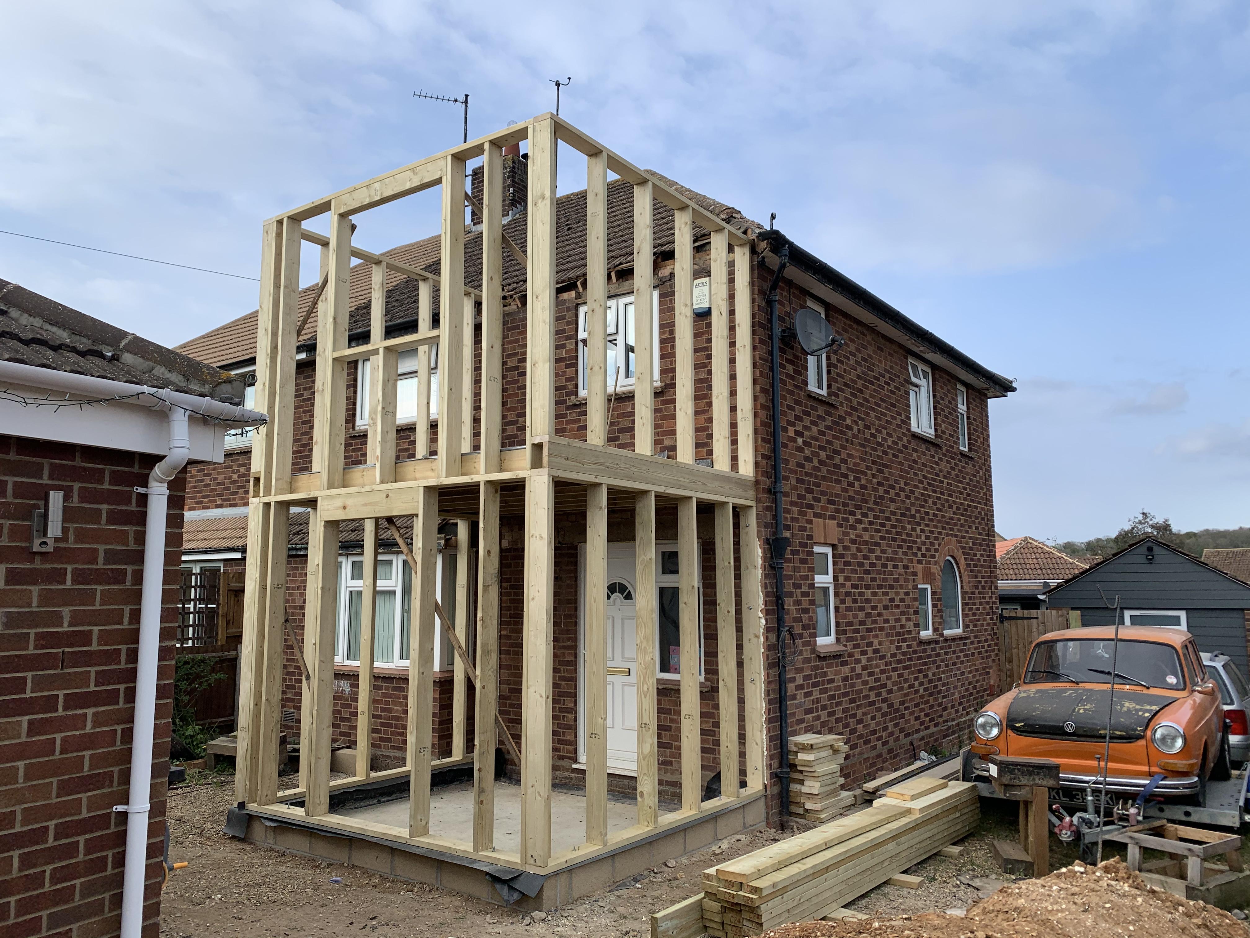

DragsterDriver Posted May 2, 2021 Posted May 2, 2021 I built this for a mate yesterday, need to cut a roof on it but I’m too old to be doing it without some Scaffold. Still undecided on stick building my own place, easy enough but if the panels Are cheap it’s so much easier and quicker with a forklift on site 1
