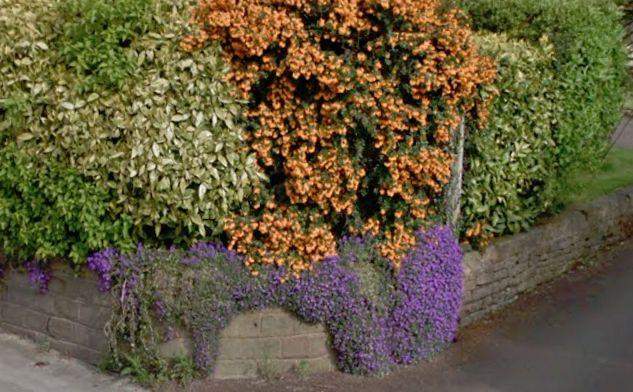

Ferdinand Posted October 30, 2018 Posted October 30, 2018 (edited) What about tapping a vertical edging in at the inner edge of the haunch, then fill the 'trough' you have created with the same gravel. You could use something such as slates or edging tiles. I suspect that the concrete, in addition to taking up rootspace, may also be sucking any water that does get there away - just as the soil always dries out at the bottom of walls.There might be a benefit in painting the concrete with some sort of paint-on-DPM, or even lining with plastic sheet. Another thing you could try would be to grow something that flops over the edge, such as one of the hardy ground cover flowery cushion things your grandma had along the edge of her path, and create a narrow border there. Have a look around the locality. I'm trying to remember the name of the one with bluey-purple flowers that we still have, but I can't rmember the name. This one: (update: aubretia) I guess that something Alpine or Rockery might match the conditions. Or you could even use something like Thyme, or a creeping conifer. Or what about planting it in a deep gutter set into the ground if you need to keep control? https://www.pinterest.co.uk/pmapinterest/border-plants/?lp=true F Edited October 30, 2018 by Ferdinand 1
