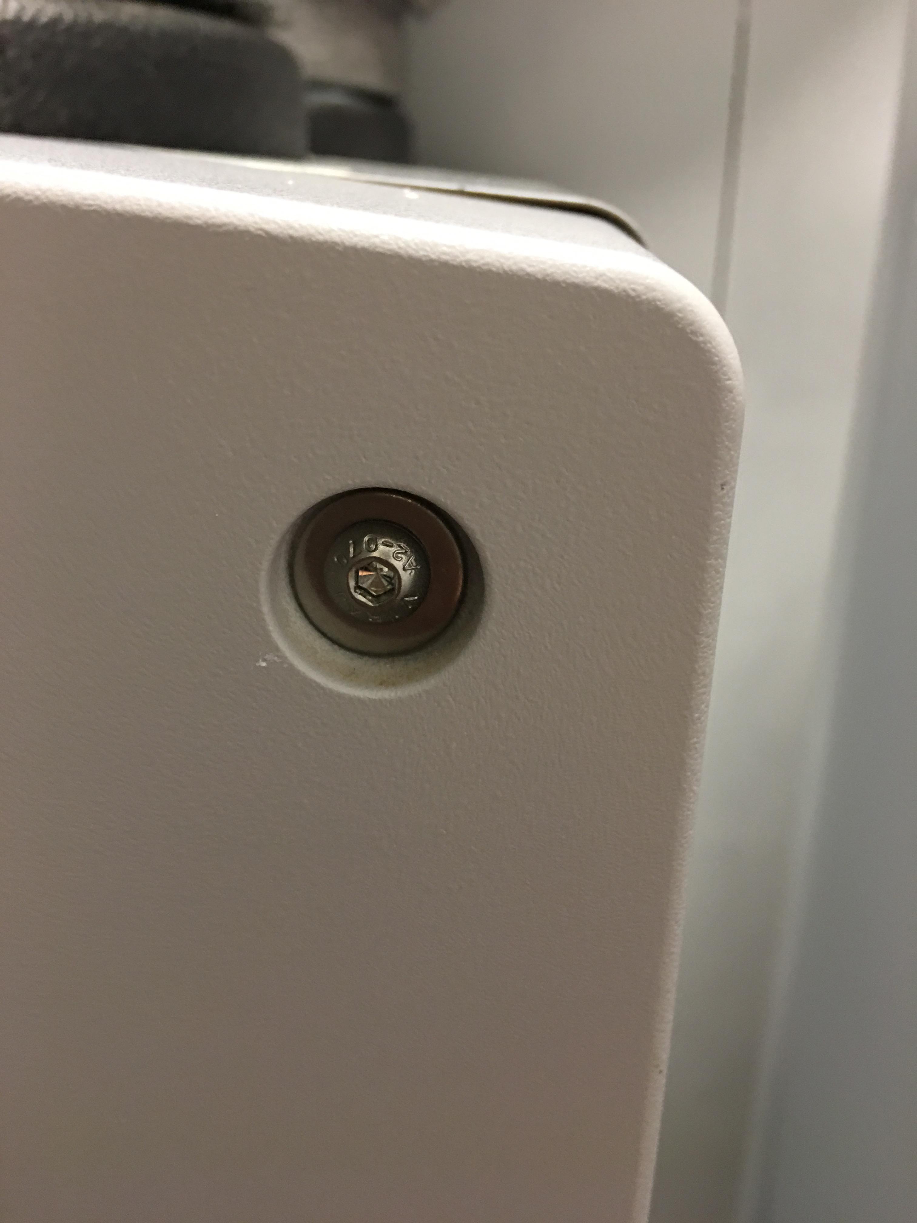

lizzie Posted October 27, 2018 Author Posted October 27, 2018 14 minutes ago, PeterStarck said: This is a condensate drain isn't it so can't the drain be filled from inside the unit by taking the cover off? I cant take cover off unit ....its large ......the wnole of the front....and probably heavy and only has those special rivet sort of screws that dont fit a screwdriver.... I would like to see inside to get an idea of what periodic sloshing noise is. 1
Gone West Posted October 27, 2018 Posted October 27, 2018 5 minutes ago, lizzie said: I cant take cover off unit ....its large ......the wnole of the front....and probably heavy and only has those special rivet sort of screws that dont fit a screwdriver.... I would like to see inside to get an idea of what periodic sloshing noise is. If it's like mine the whole of the front comes off but it's not heavy. Mine is held on with hex bolts so it can be undone with an allen key or hex head on the screwdriver.
lizzie Posted October 27, 2018 Author Posted October 27, 2018 26 minutes ago, PeterStarck said: If it's like mine the whole of the front comes off but it's not heavy. Mine is held on with hex bolts so it can be undone with an allen key or hex head on the screwdriver. There are 6 of these and when I tried a few months ago I couldnt find anything to fit them. Will have to get my toolbox out and try again
Jeremy Harris Posted October 27, 2018 Posted October 27, 2018 Those are Allen head screws, so you'll need an Allen key to undo and replace them. You can either use a conventional "L" shaped set of Allen keys, or it would be better to buy a screwdriver with interchangeable bits, as often they will come with a small selection of Allen head bits. This is what a cheap Allen key set looks like: https://www.screwfix.com/p/magnusson-long-arm-ball-end-metric-hex-key-set-9pcs/8113v and this is a cheap screwdriver set with interchangeable bits that includes Allen bits: https://www.screwfix.com/p/magnusson-ratcheting-screwdriver-bit-set-46pcs/9131v
lizzie Posted October 27, 2018 Author Posted October 27, 2018 @JSHarris thank you! I have a bunch of allen keys somewhere will look them out.

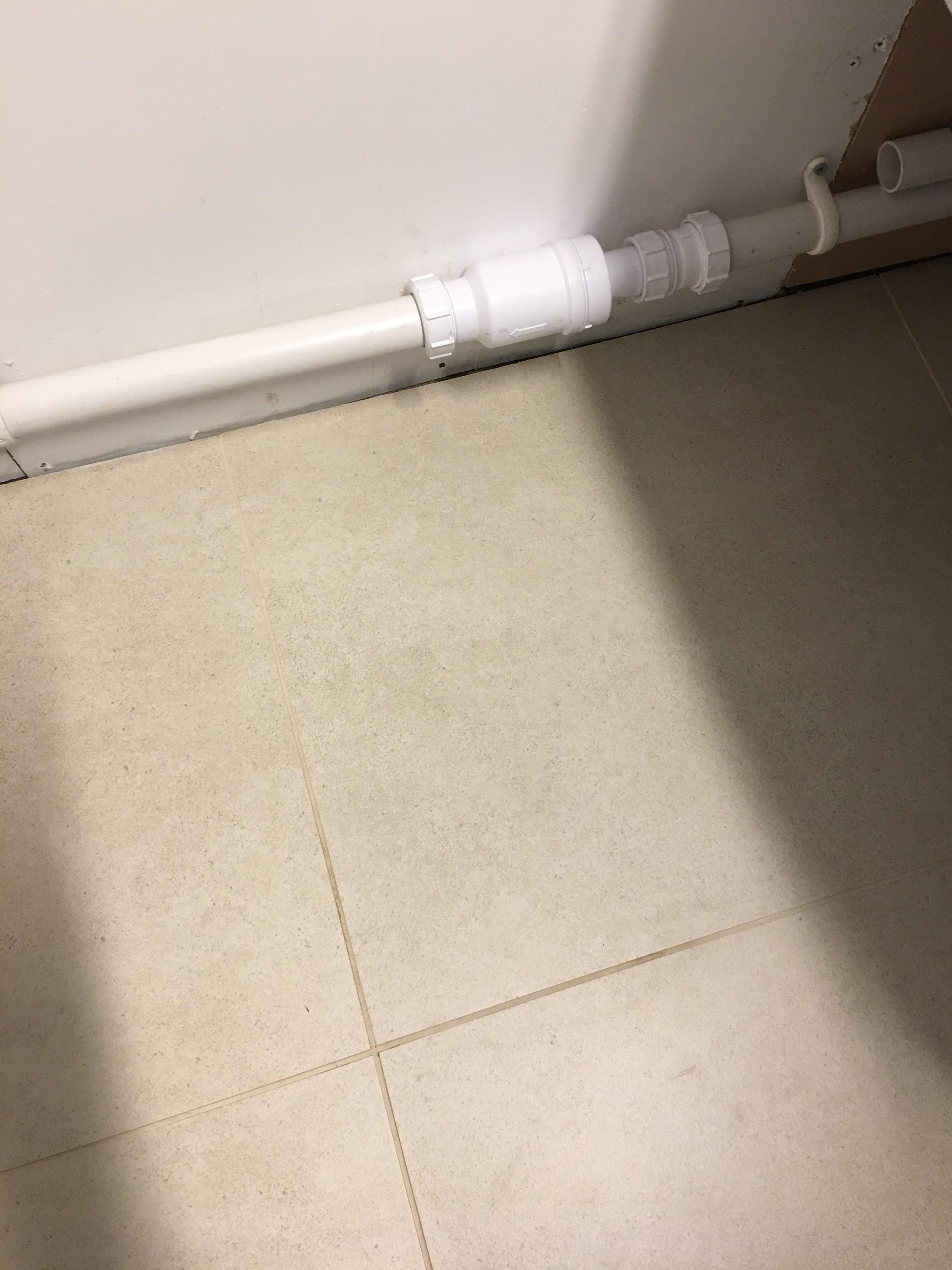

lizzie Posted November 1, 2018 Author Posted November 1, 2018 Great news I finally persuaded a plumber to come and fit the waterless trap (I rang 5 before i got one that turned up). He has fitted it on the straigt run after the mvhr condensate junction so it catches both boiler and mvhr condensate as suggested here. He said it should be ok but has left me the cut piece of pipe in case it doesnt work and so we can fit it back on with adaptors. He was a lovely man, knows nothing about these type of houses but was fascinated, 5 minute job and an hour talking house......he refused to take any money for doing the job either. What a star and what a rare find. Thank you all for the help on it, another thing ticked off the list (installer still not materialised) 2
