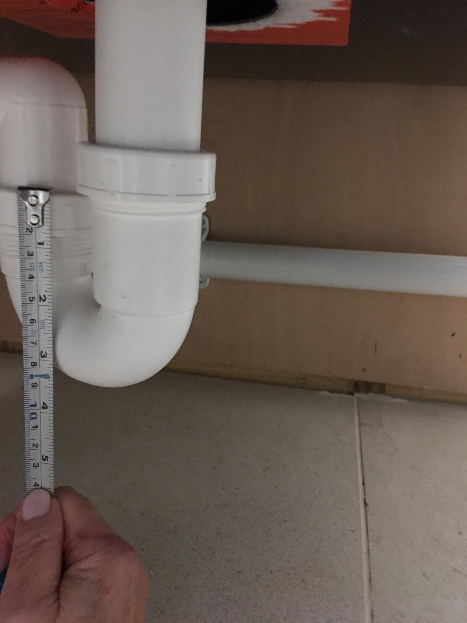

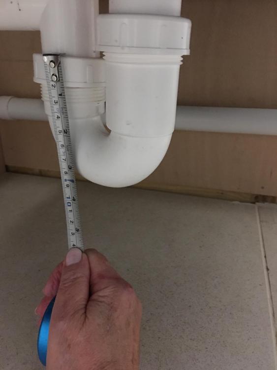

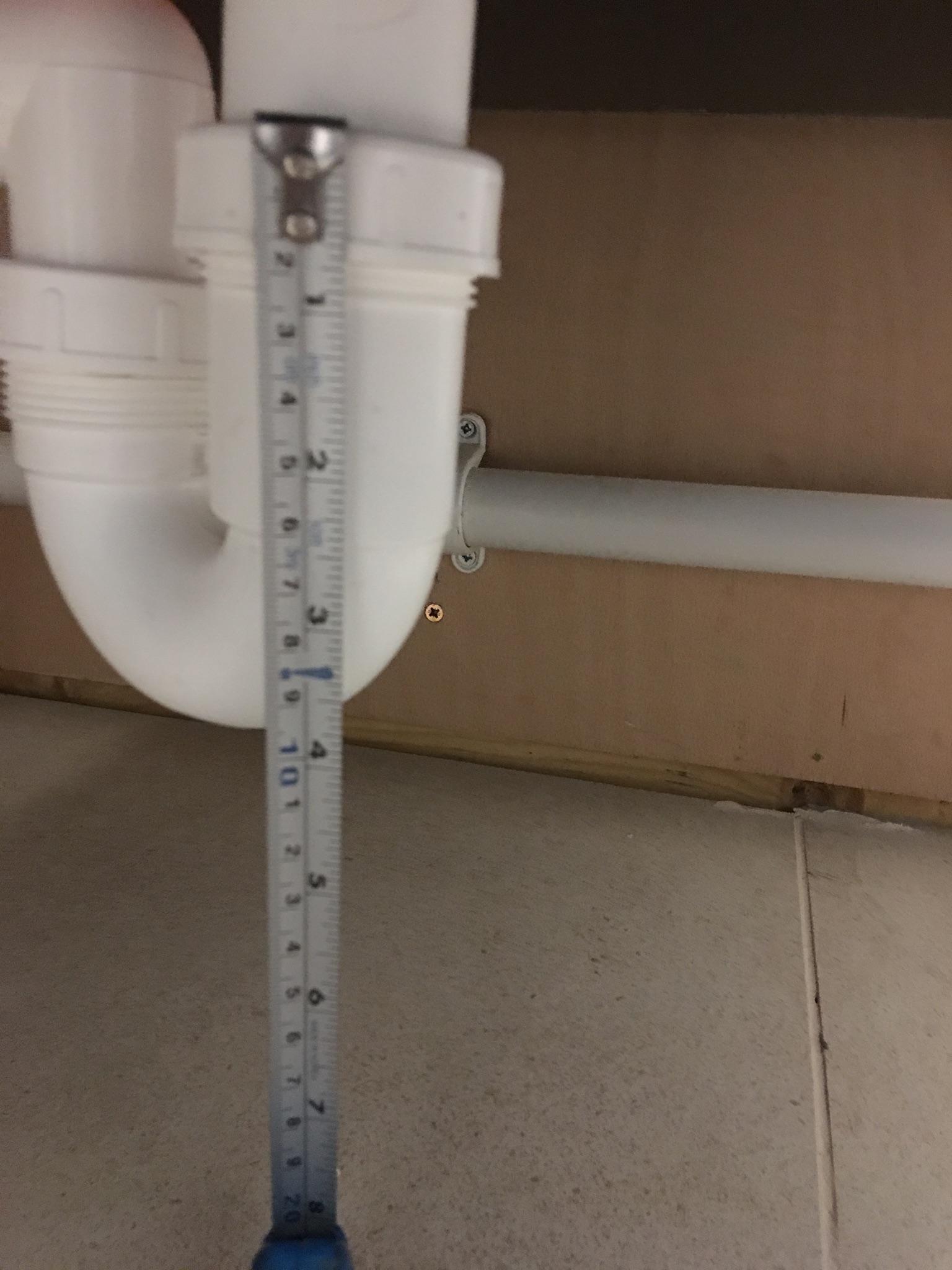

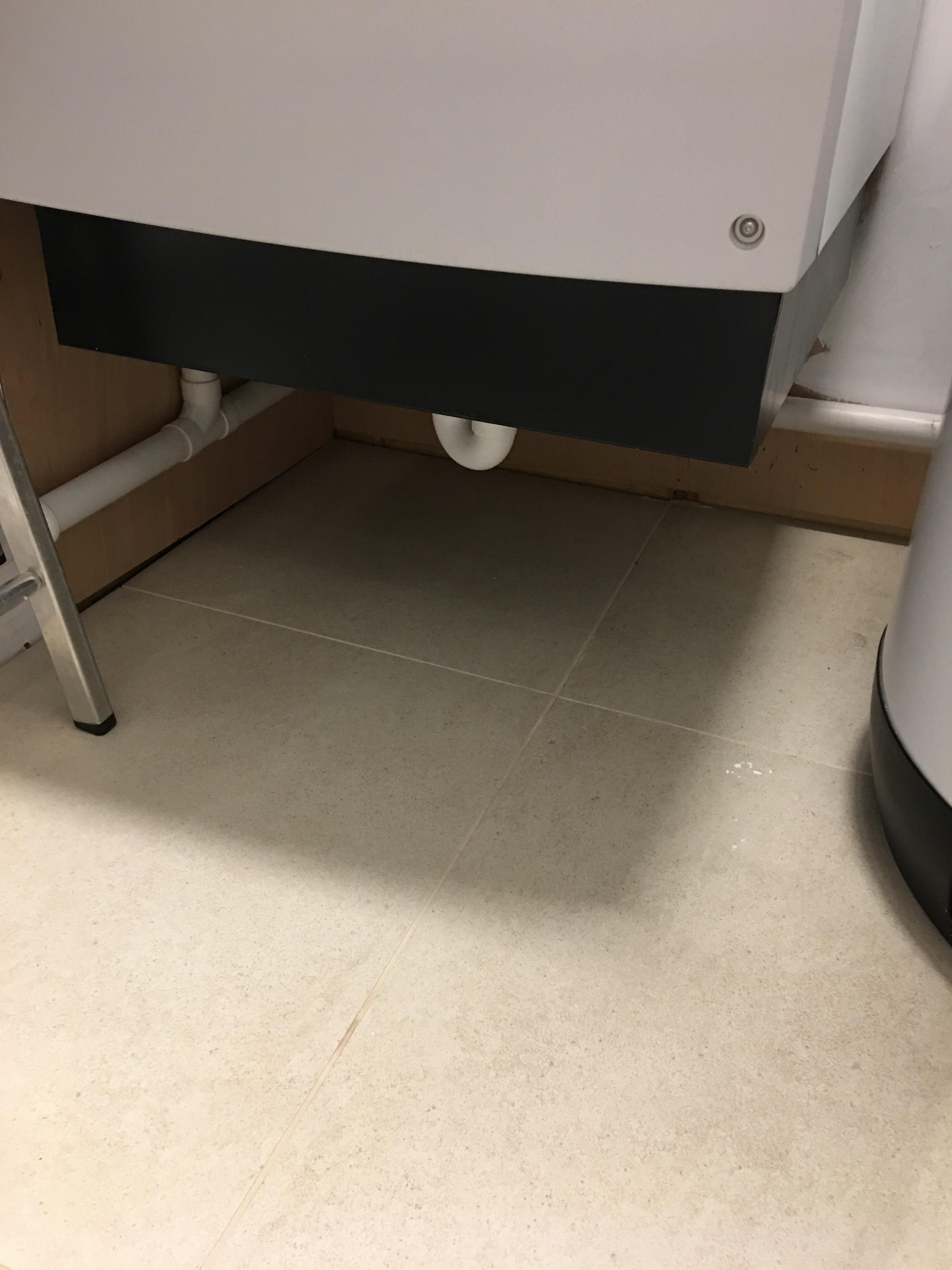

My MVHR/UFH installer has still not been back to sort out issues etc, months later.  One of the things he needs to sort out is the waste from MVHR which keeps drying out and pumping sewage smells around the house.
I am sick to death of getting on my hands and knees under this unit every few days and filling the trap with water.  I think it needs a water less trap.  Can anyone point me to the one I need to buy please...making a trip to Screwfix tomorrow so could pick one up there if they had them.  I have looked and can't work out what I need....will be fitting it myself too.
Pics of existing attached.
Thank you for any help advice you can give.

  • Thanks @lizzie   So the trap is part of the actual unit itself so can’t be replaced. It fits into a 40mm pushfit from the looks of it so it’s a relatively simple fix to put a Hep20 dry trap

16 minutes ago, Alphonsox said:
Screwfix sells the OSMA "self sealing" traps, They come in 40mm and 32mm so make sure you get the correct one for your needs.
https://www.screwfix.com/p/osma-waste-valve-white-x/3962k
https://www.screwfix.com/p/osma-waste-valve-white-x/1819k
They can be mounted either vertically or horizontally as your installation allows.
Thank you...I take it the 32/40 is the diameter of the pipe?
Looking at them they are just one straight piece of pipe, any idea how I get that to fit my uneven 'u'?
Perhaps leave the wet trap, and just insert the waterless trap in the pipe leading out of it?  A lot less messing about, and the dried out "wet" trap will do no harm left like that.

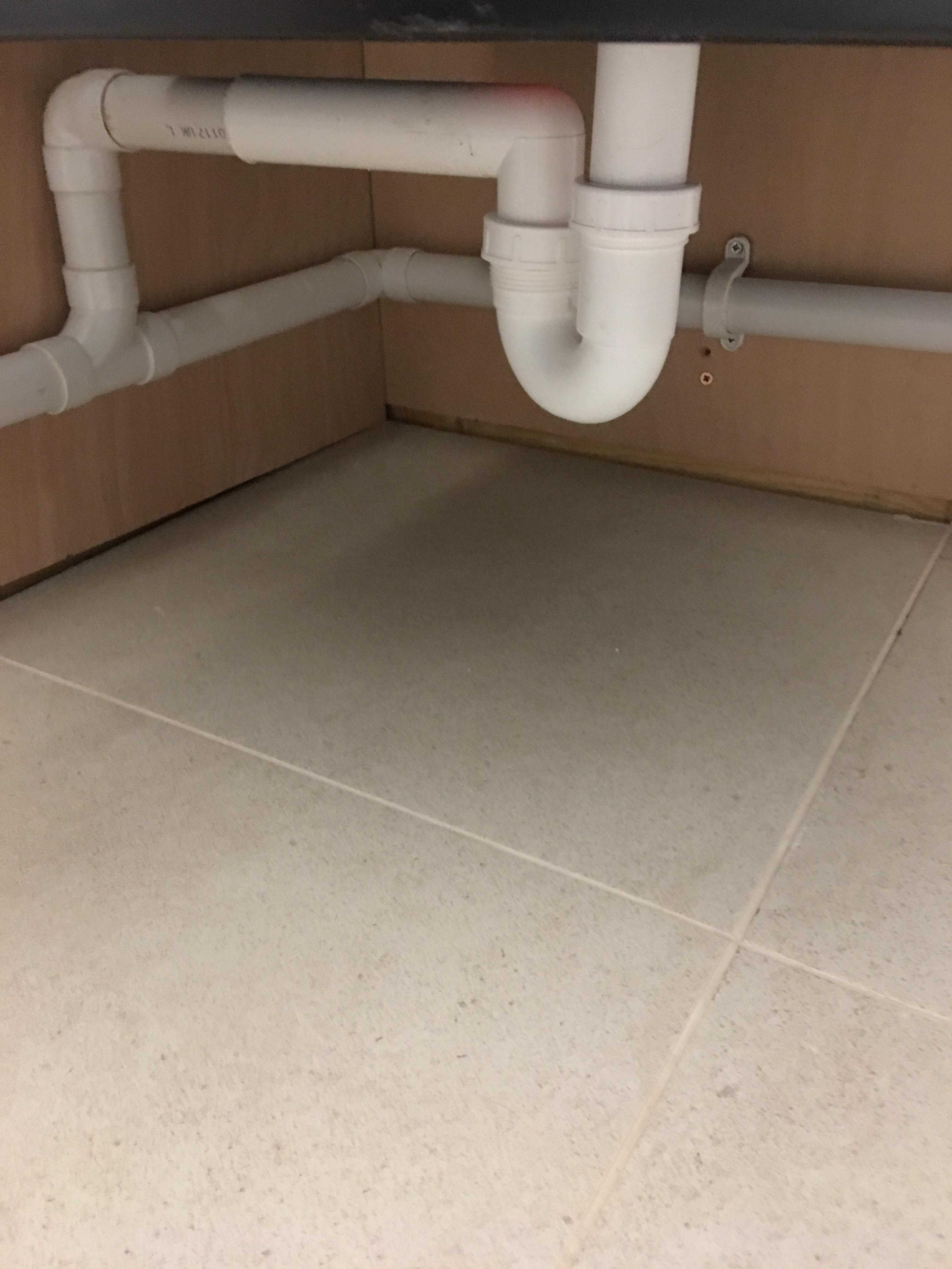

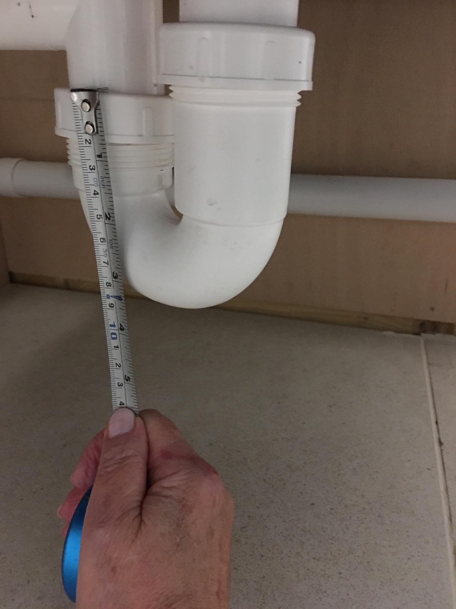

21 minutes ago, Declan52 said:
Take a pic from further out to show the full layout of what's beneath.
this is it
Edited by lizzie
6 minutes ago, Nickfromwales said:
You won’t get a straight swap. Pipe will need cutting and altering ;)
Well thats cyboshed my plan to do it myself then!  Better look for a plumber. Thank you.
ah...will investigate.  I'm not good if it means cutting pipe though.
This stuff is very forgiving and easy to cut. What's to the left in your photo ?  The best bet may be to fit the new trap where the horizontal pipe currently is.

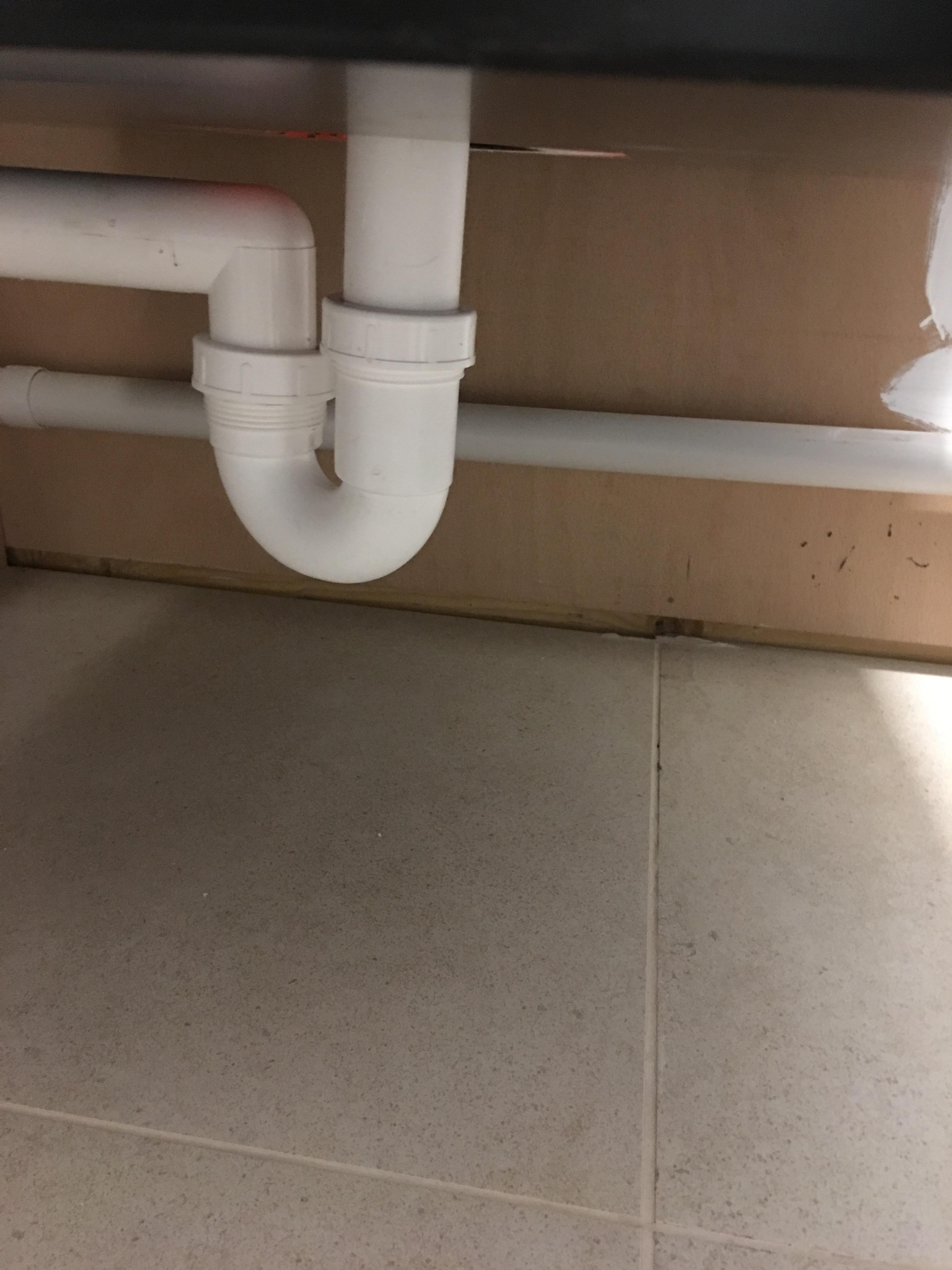

31 minutes ago, lizzie said:
this is it
Is it just me or is that a well and truly bodged setup with one pipe sleeved inside another?
No wonder he does not want to come back.
1 minute ago, ProDave said:
Is it just me or is that a well and truly bodges setup with one pipe sleeved inside another?
I was just thinking the same - very strange setup
Your other (non-plumbing) option is to remove the U-bend and put a bucket under the vertical downpipe. Seal off the horizontal section with a plastic bag or similar.
Empty the bucket every week or so. (This is the mechanism we're currently using due to me buying the wrong size OSMA - I will get round to fixing it properly in a year or so).
its all very loose and rickety and the constant taking off of the u bit isnt helping.  This was mvhr installer who did this not bodger plumber of under sink waste fame!
So the sleeved pipe is not even stuck / sealed with solvent weld?
As suggested, take the trap off, put a bucket under and seal the end of that horizontal pipe initially with cling film and tape but as a permanent fix with a stop end.
Not sealed with anything just one pipe inside another and all very loose, it worries me every time I have to unscrew the u bit I expect the whole thing to fall apart. Thank you
3 minutes ago, ProDave said:
Tell us exactly what the writing on that horizontal bit of pipe says and we can tell you what stop end will fit.
Far as I can make out it is 0117 UK L
Looks like 40 solvent weld but that sleeve is just a mess ..! Couldn’t be bothered to buy a 40mm universal compression fitting ..!!!??

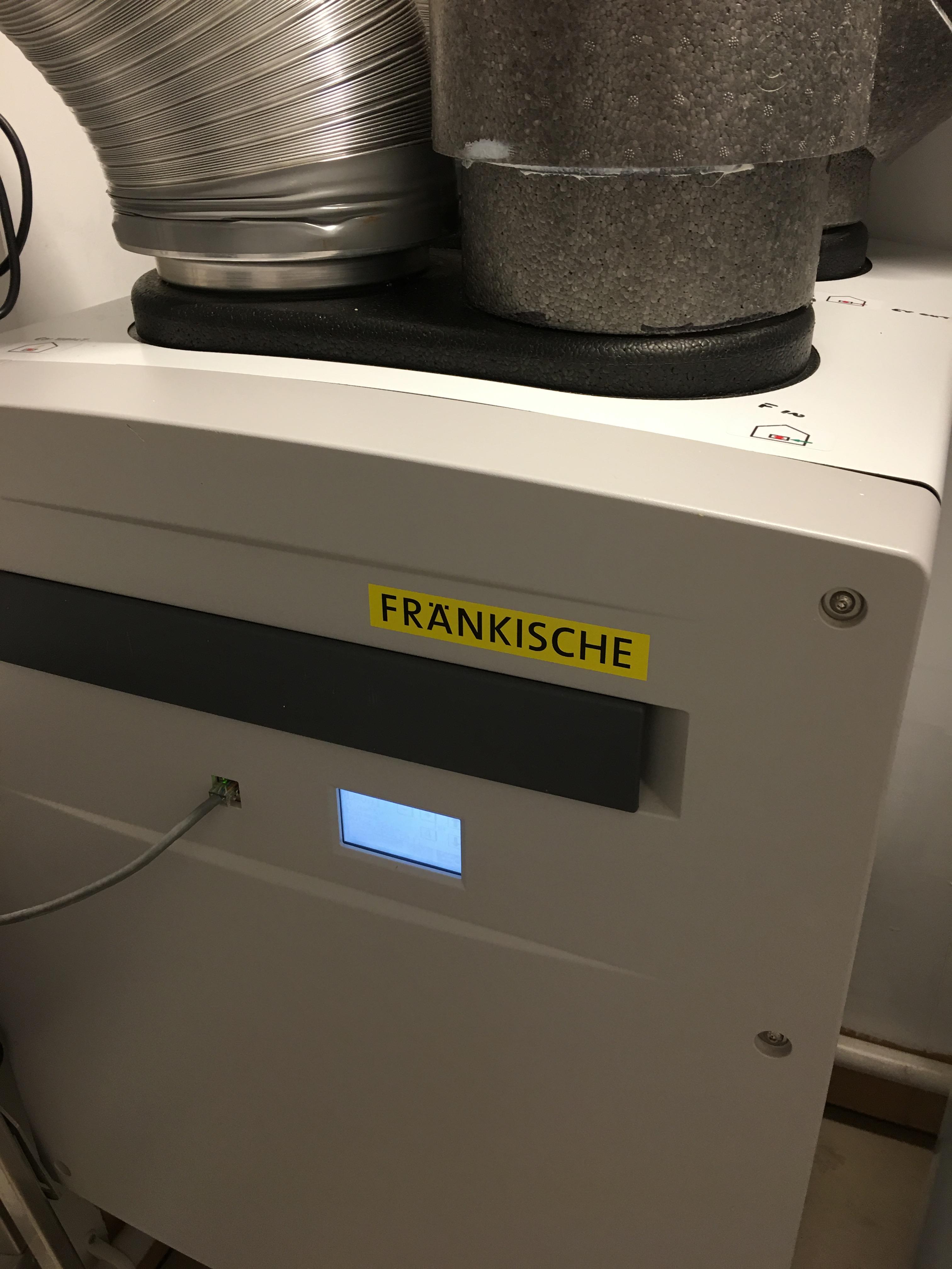

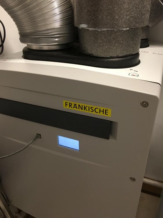

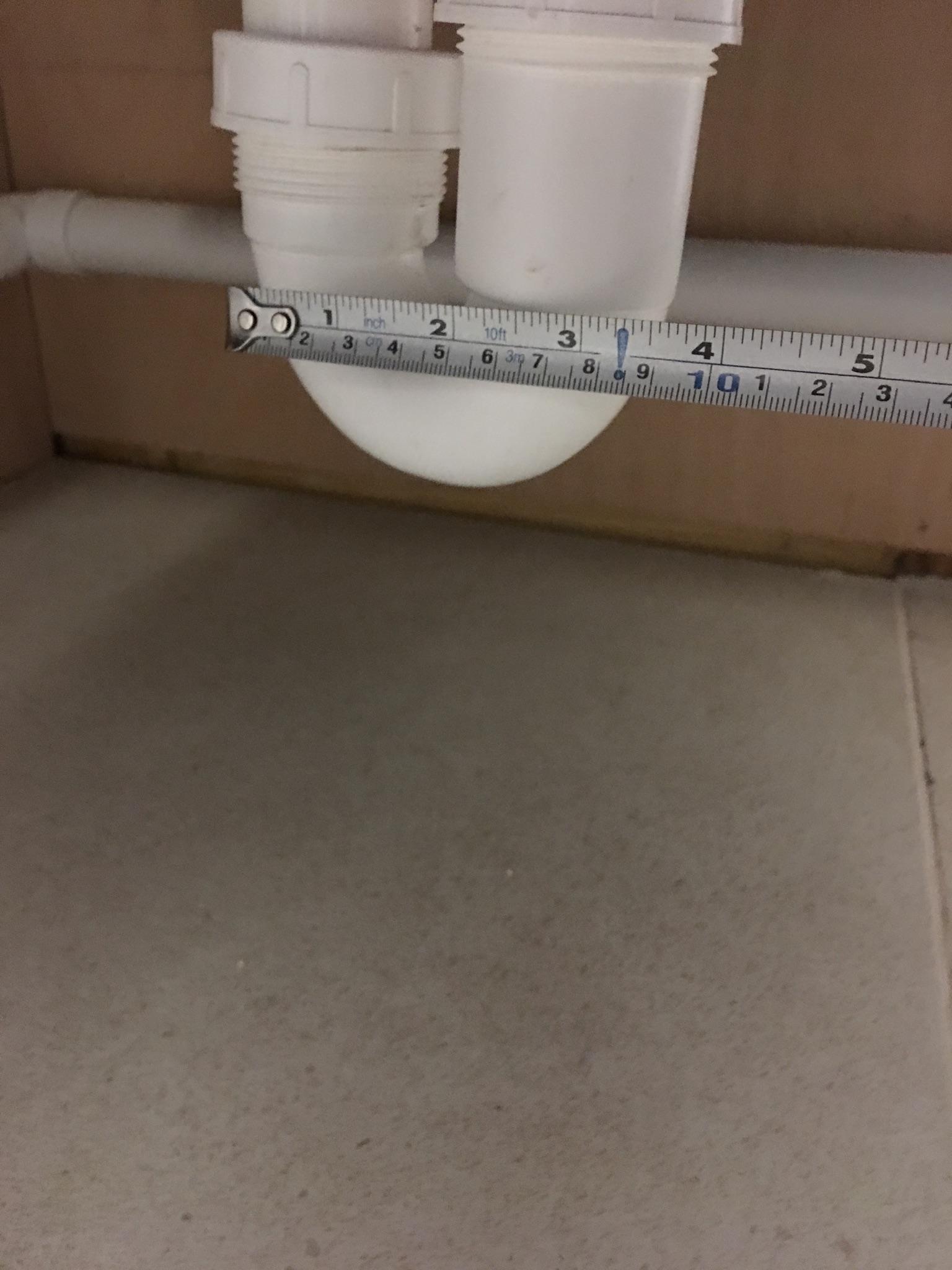

As you are finding out, MVHR doesn’t produce a lot of moisture - I’m surprised the outlet is so large as it’s normally 22.5mm overflow pipe. What’s above the shelf and what sort of unit is it ..?
There is no shelf that is the underside of mvhr unit. I have to lie on floor to get underneath to get at pipe and I find it really difficult to do especially in confined space.
I have Profi air 250 frankische unit
