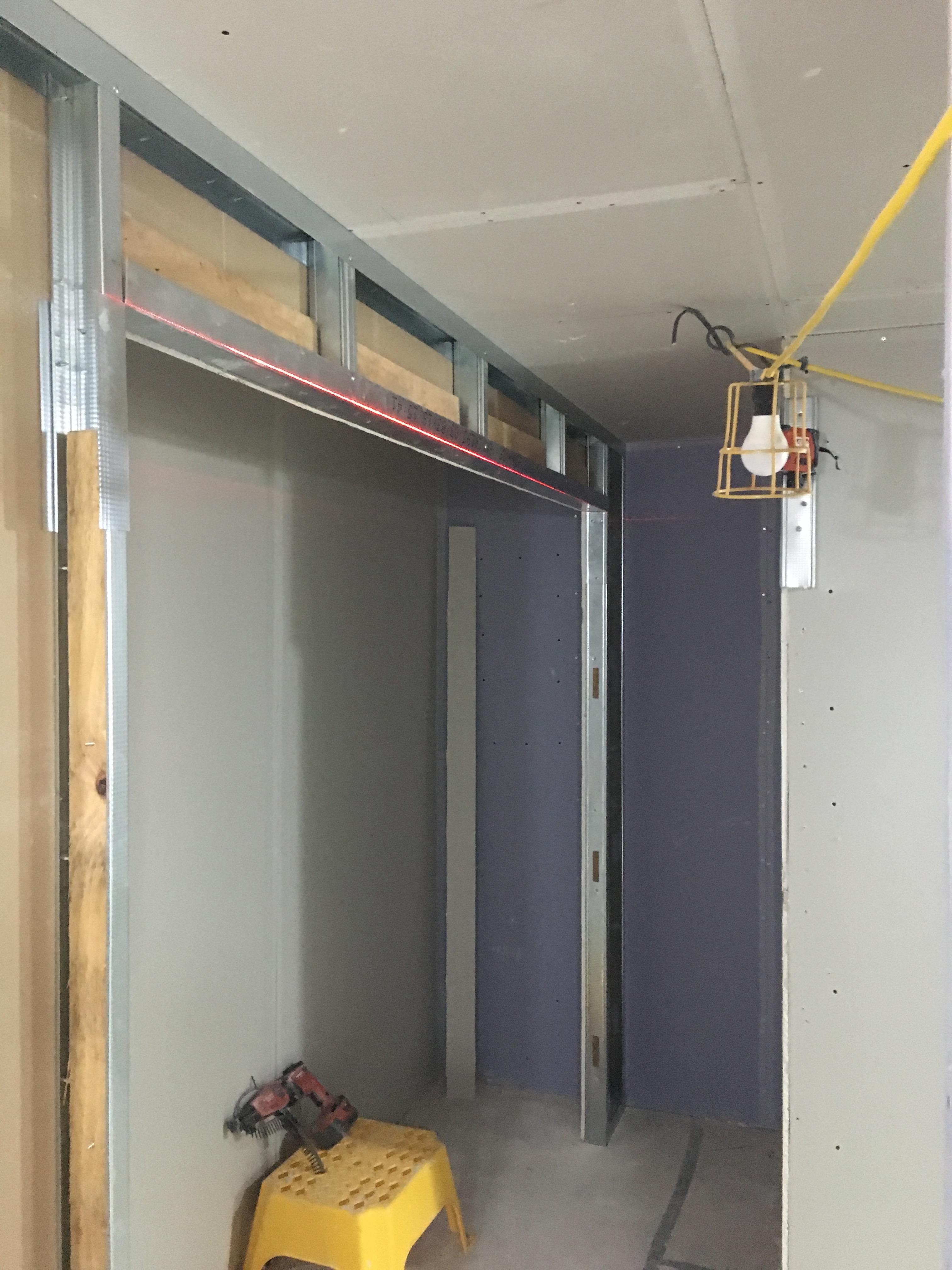

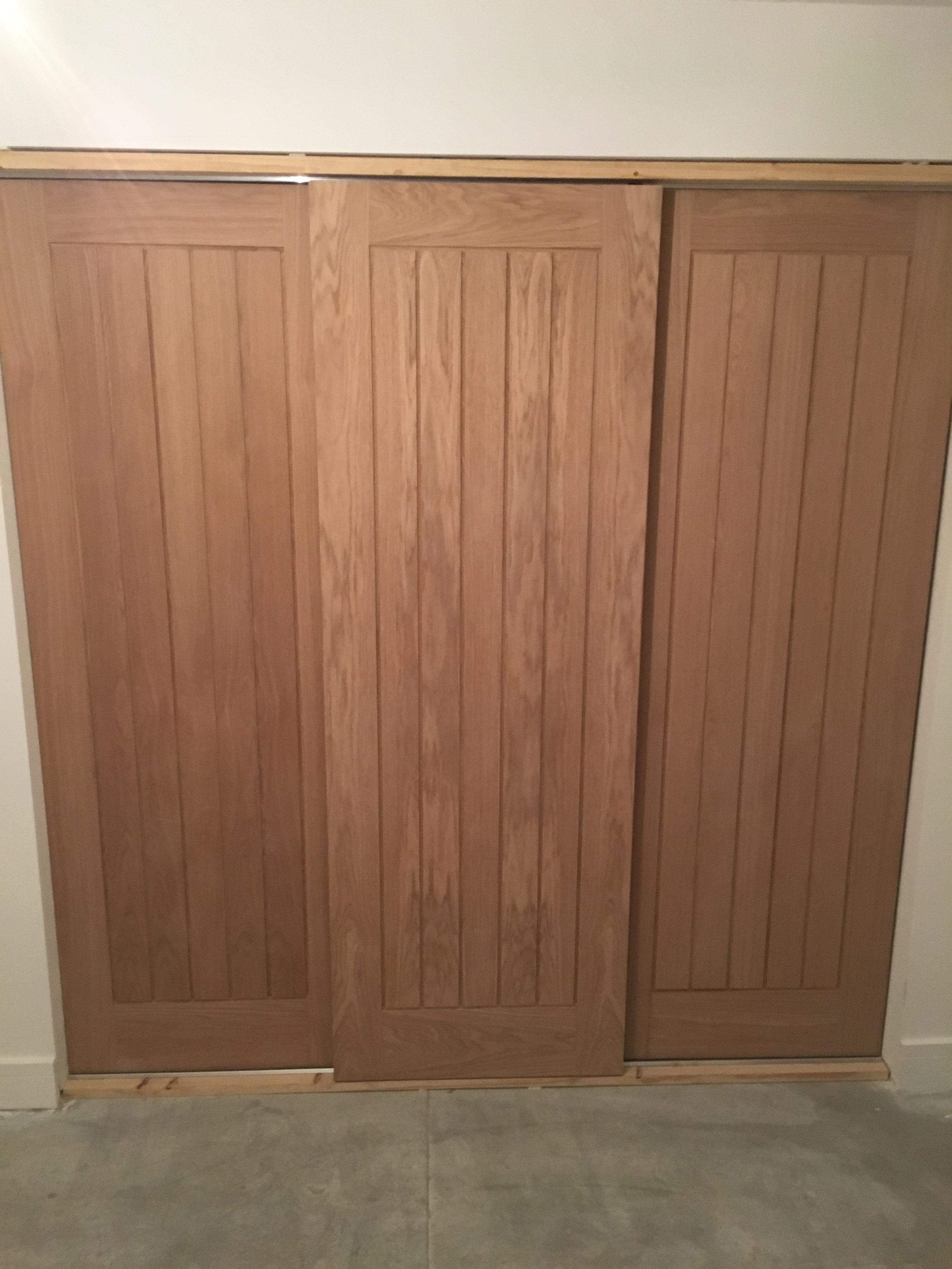

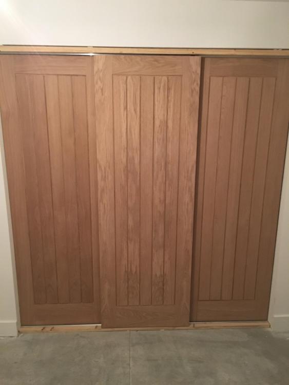

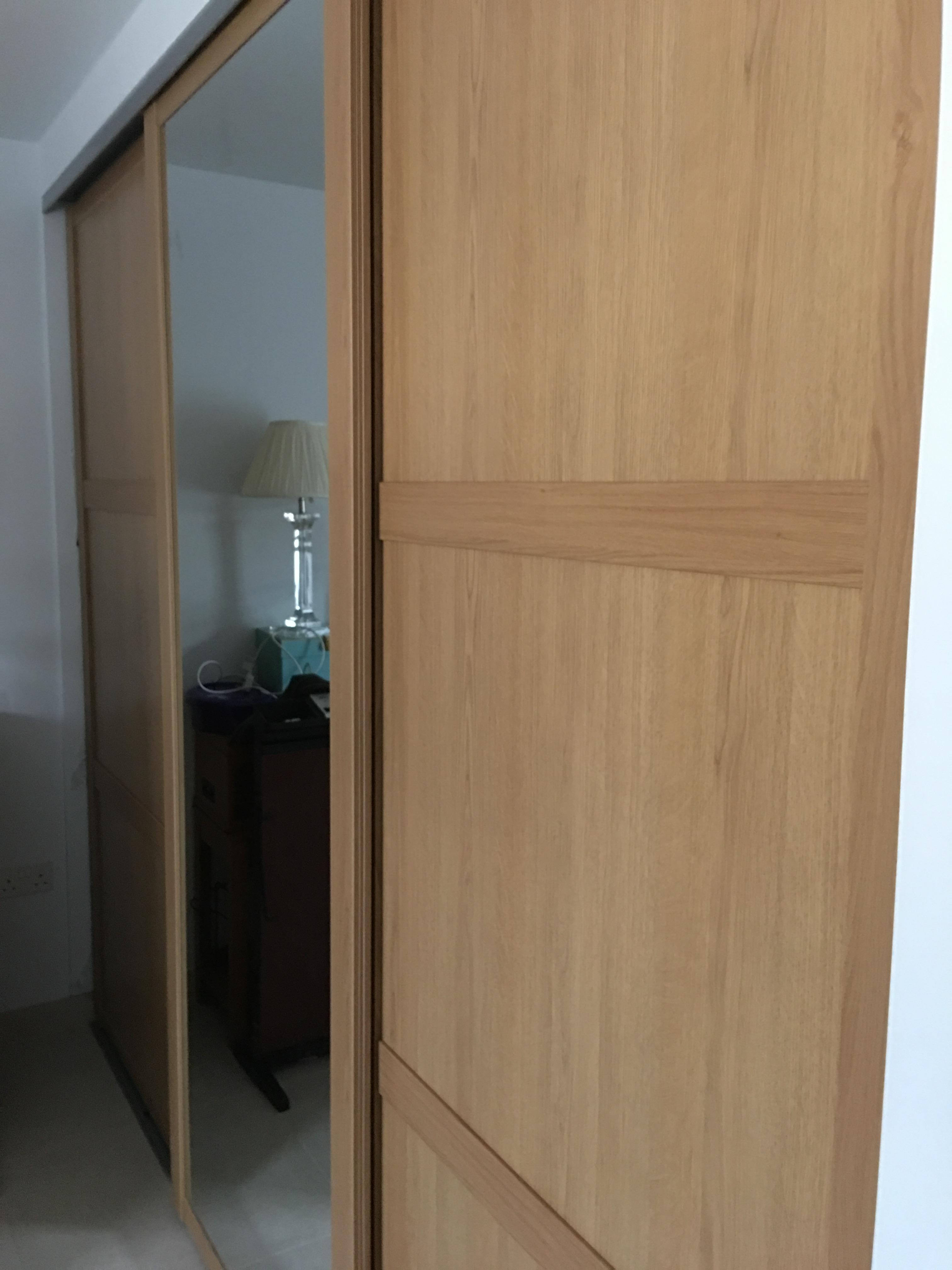

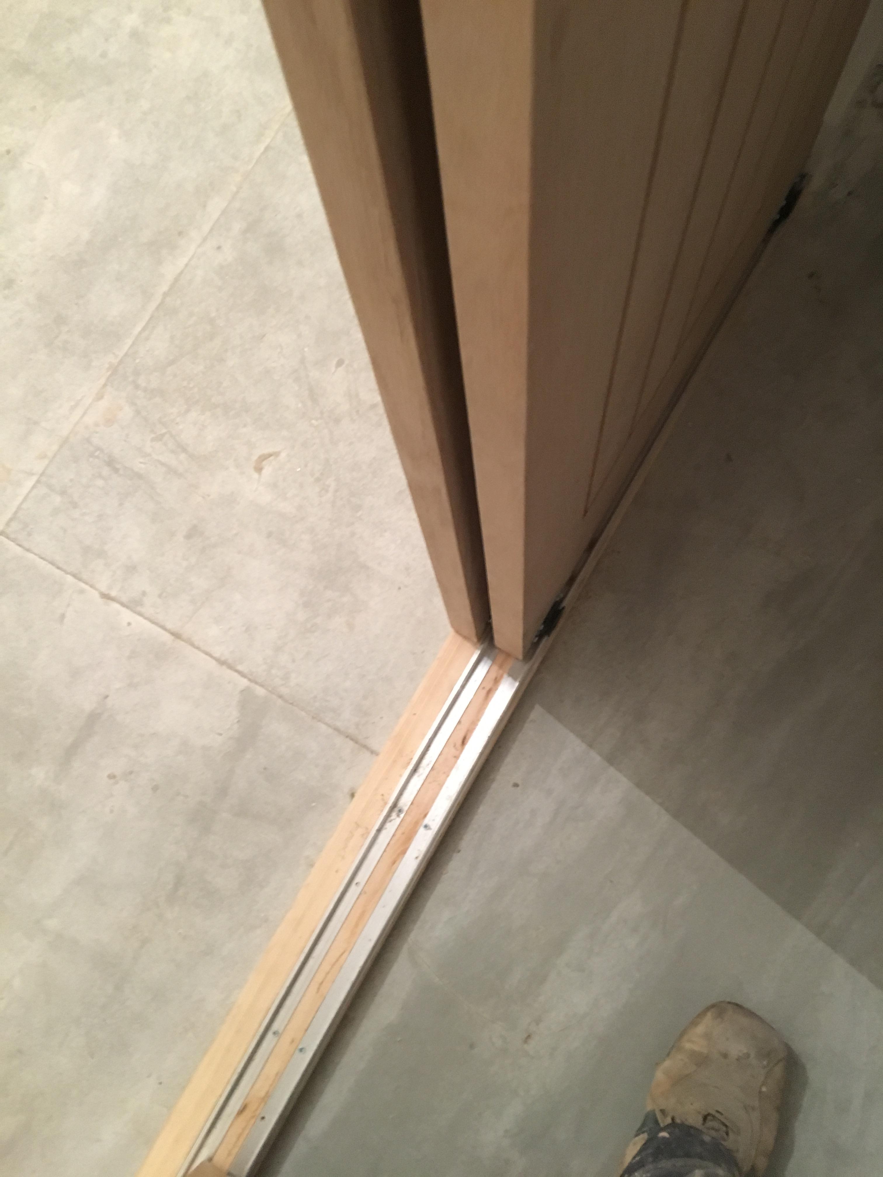

nod Posted October 21, 2018 Posted October 21, 2018 Just thought I’d share this with you Ive been fitting three sets of wardrobes Very quick and easy way to do and quite inexpensive compared to conventional wardrobe I’ve just a piece of oak trim to add to the top and inset handles 7
DavidFrancis Posted October 21, 2018 Posted October 21, 2018 @nod where did you get the parts from? I'm probably going to have to make up a replacement built-in wardrobe in the next few months and I live not far from you. Thanks
nod Posted October 21, 2018 Author Posted October 21, 2018 Just now, DavidFrancis said: @nod where did you get the parts from? I'm probably going to have to make up a replacement built-in wardrobe in the next few months and I live not far from you. Thanks I purchased the runners from Slingers of Preston 1
DavidFrancis Posted October 21, 2018 Posted October 21, 2018 Thanks @nod What about the doors themselves - and even the metal framing?
nod Posted October 21, 2018 Author Posted October 21, 2018 1 hour ago, DavidFrancis said: Thanks @nod What about the doors themselves - and even the metal framing? The doors I bought from Benckmark. We bought 22 on account Was given a price and I made them an offer for a now purchase Worked out about £65 each + and are the very hevy type
ToughButterCup Posted October 21, 2018 Posted October 21, 2018 Gary, you seem to be using a lot of metal carcassing : tell us why.....
Onoff Posted October 21, 2018 Posted October 21, 2018 3 minutes ago, recoveringacademic said: Gary, you seem to be using a lot of metal carcassing : tell us why..... That's just how the professionals do stud walling. Gives you thinner walls than in timber. 1
ProDave Posted October 21, 2018 Posted October 21, 2018 I like the "out of the box" thinking there. When I have done built in wardrobes with sliding doors, I have always taken the timber door frame down the sides and finished off with architrave. I would never have thought of just having the door sliding up to the plasterboarded end of a wall, but I like the simple look now I see it. Let us know how durable it proves to be.

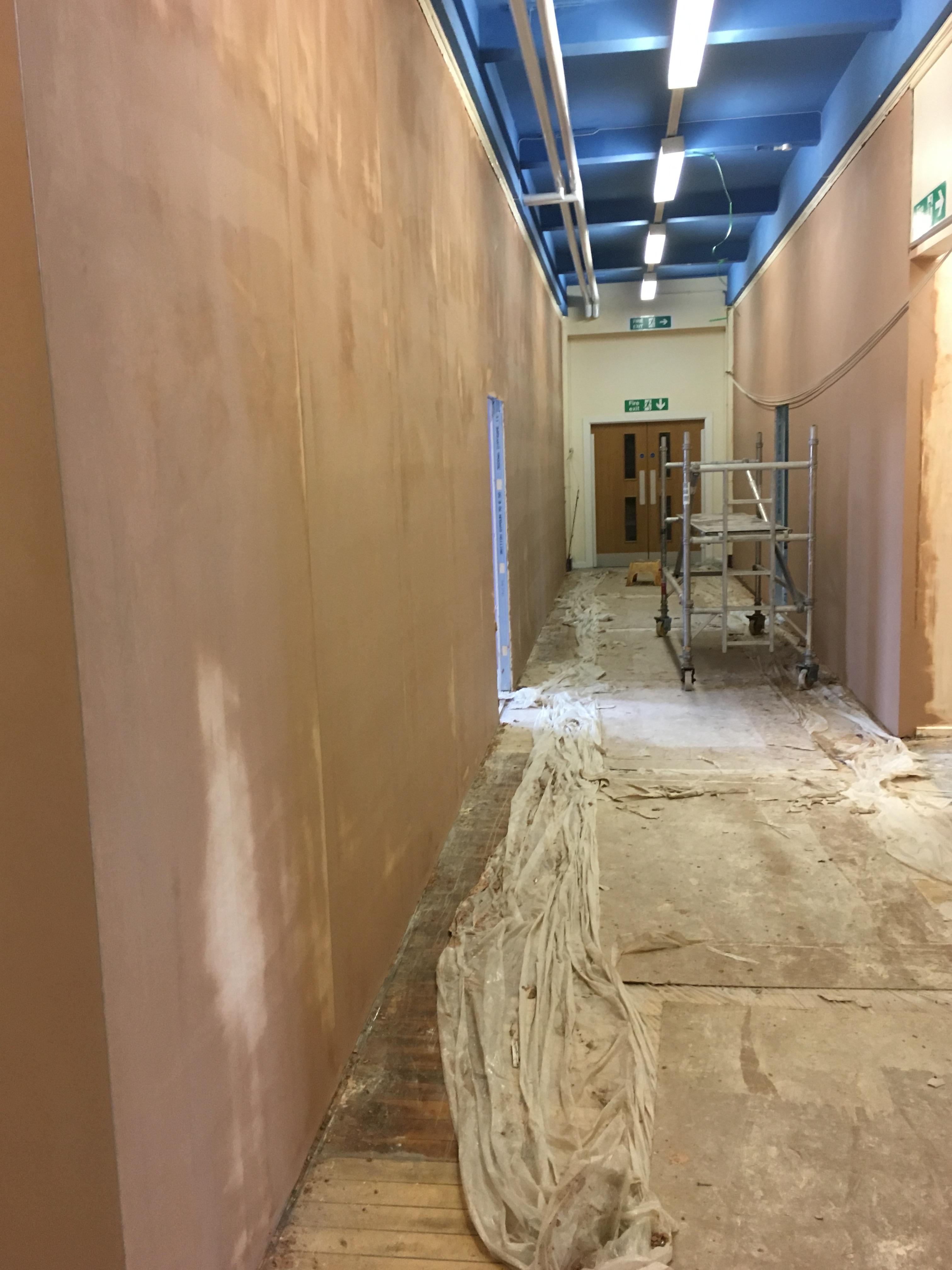

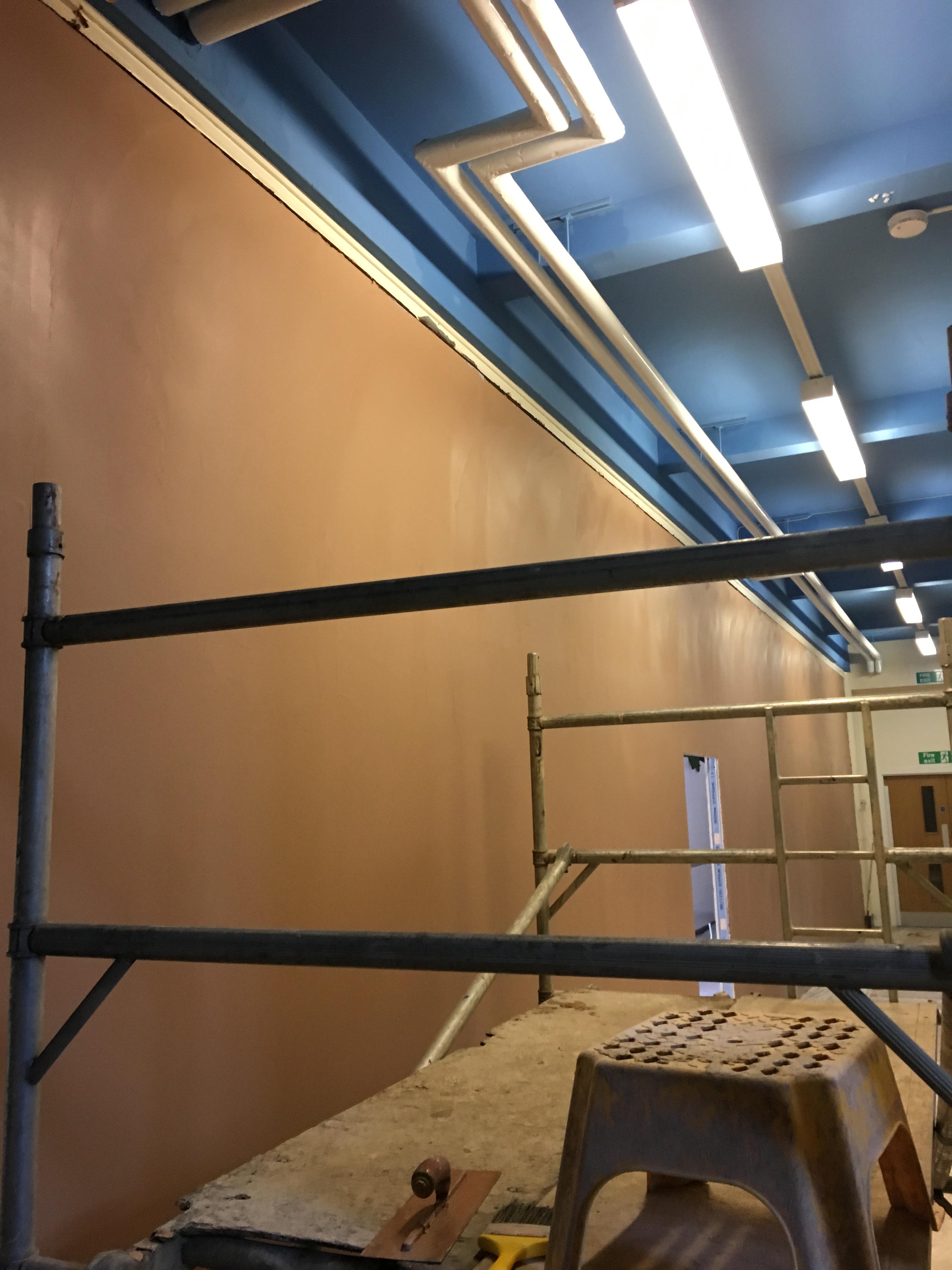

nod Posted October 21, 2018 Author Posted October 21, 2018 11 minutes ago, recoveringacademic said: Gary, you seem to be using a lot of metal carcassing : tell us why..... Yes Ian Personal preference I use it everyday I’ve only a few studs upstairs Mainly making bathrooms up and wardrobes Ive lines all with ply and soundblock and doubled the walls with a 100 mil void between the two unsuits Very solid main advantages millimetre plumb easy to keep square holes Pre cut for services Much better soundproofing than timber Same cost as timber to purchase Five times as fast to install Pictured is a small job I did on a school a couple of months back Build corridor Four classrooms soundblock insulate and skim To be completed in five days Over half term Two days for two of us to build and board with electrician working with us Day and a half for two of us to skim 2

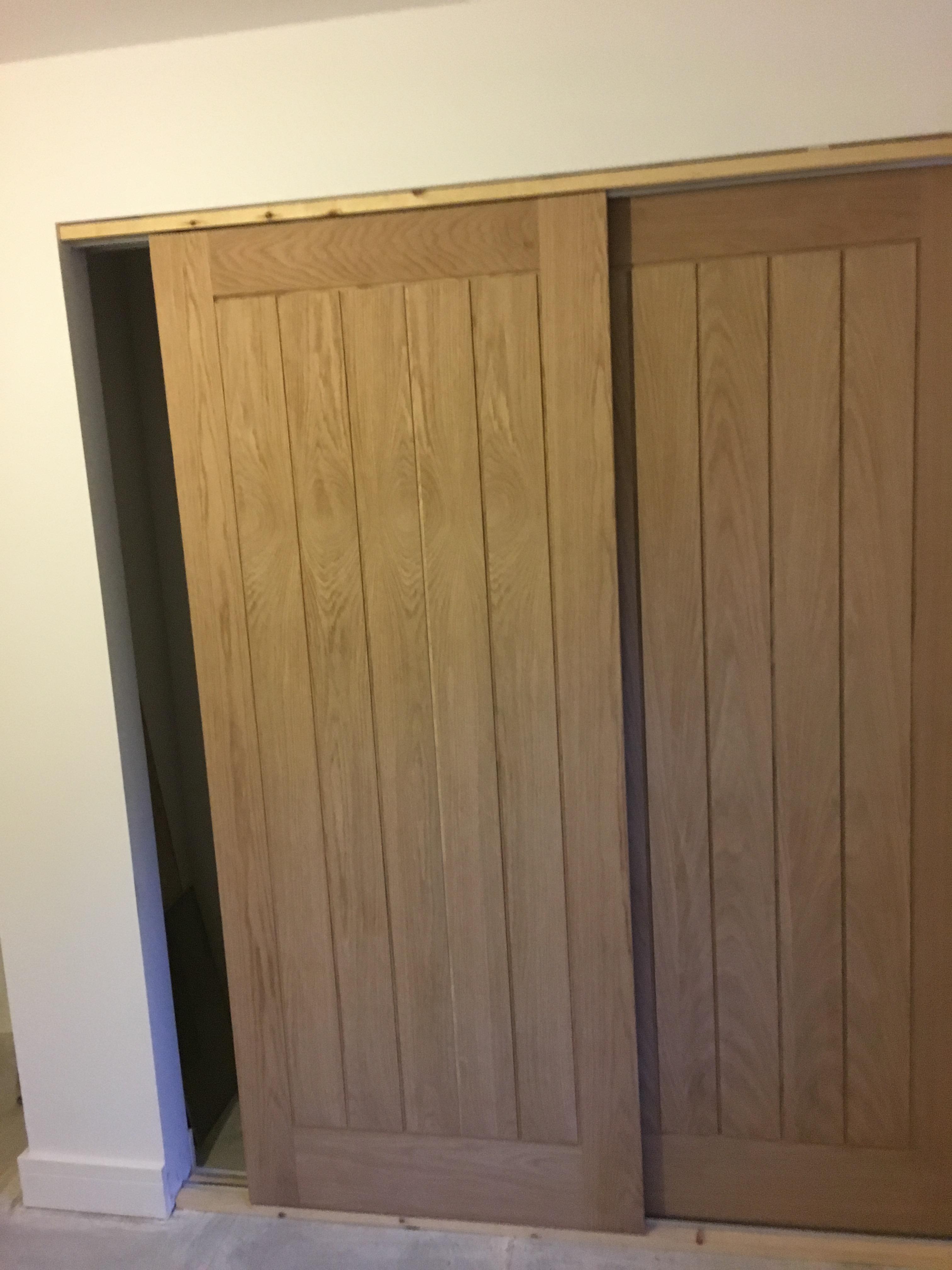

nod Posted October 21, 2018 Author Posted October 21, 2018 8 minutes ago, ProDave said: I like the "out of the box" thinking there. When I have done built in wardrobes with sliding doors, I have always taken the timber door frame down the sides and finished off with architrave. I would never have thought of just having the door sliding up to the plasterboarded end of a wall, but I like the simple look now I see it. Let us know how durable it proves to be. Ive done it like that in the past Dave It was my wife’s idea to not have a frame or Arks It should be pretty durable as there is little or no weight on the frame It’s all on the wheels I even put an upstanding of ply at the back of the head in case we decided to hand from the back
nod Posted October 21, 2018 Author Posted October 21, 2018 Just now, nod said: Ive done it like that in the past Dave It was my wife’s idea to not have a frame or Arks It should be pretty durable as there is little or no weight on the frame It’s all on the wheels I even put an upstanding of ply at the back of the head in case we decided to hand from the back Just looking at the photo I added door timbers should things not work out and I ended putting a frame in ?
Nickfromwales Posted October 21, 2018 Posted October 21, 2018 30 minutes ago, ProDave said: I like the "out of the box" thinking there. When I have done built in wardrobes with sliding doors, I have always taken the timber door frame down the sides and finished off with architrave. I would never have thought of just having the door sliding up to the plasterboarded end of a wall, but I like the simple look now I see it. Let us know how durable it proves to be. A couple of small bump stops top and bottom would stop the door ever meeting the paint
nod Posted October 21, 2018 Author Posted October 21, 2018 3 minutes ago, Nickfromwales said: A couple of small bump stops top and bottom would stop the door ever meeting the paint Yeah kit comes with two splayeyed bits that fit Ito the track 1

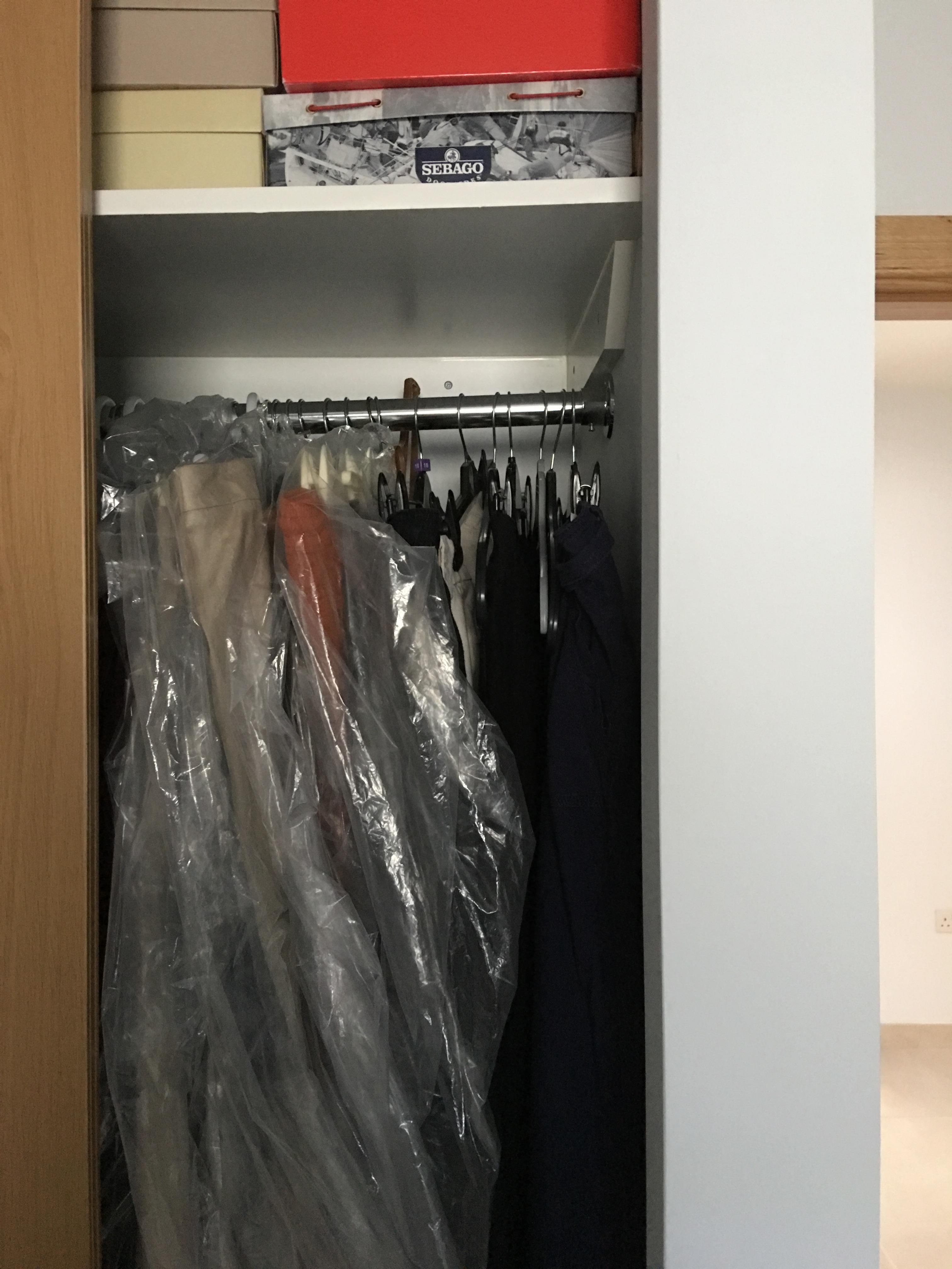

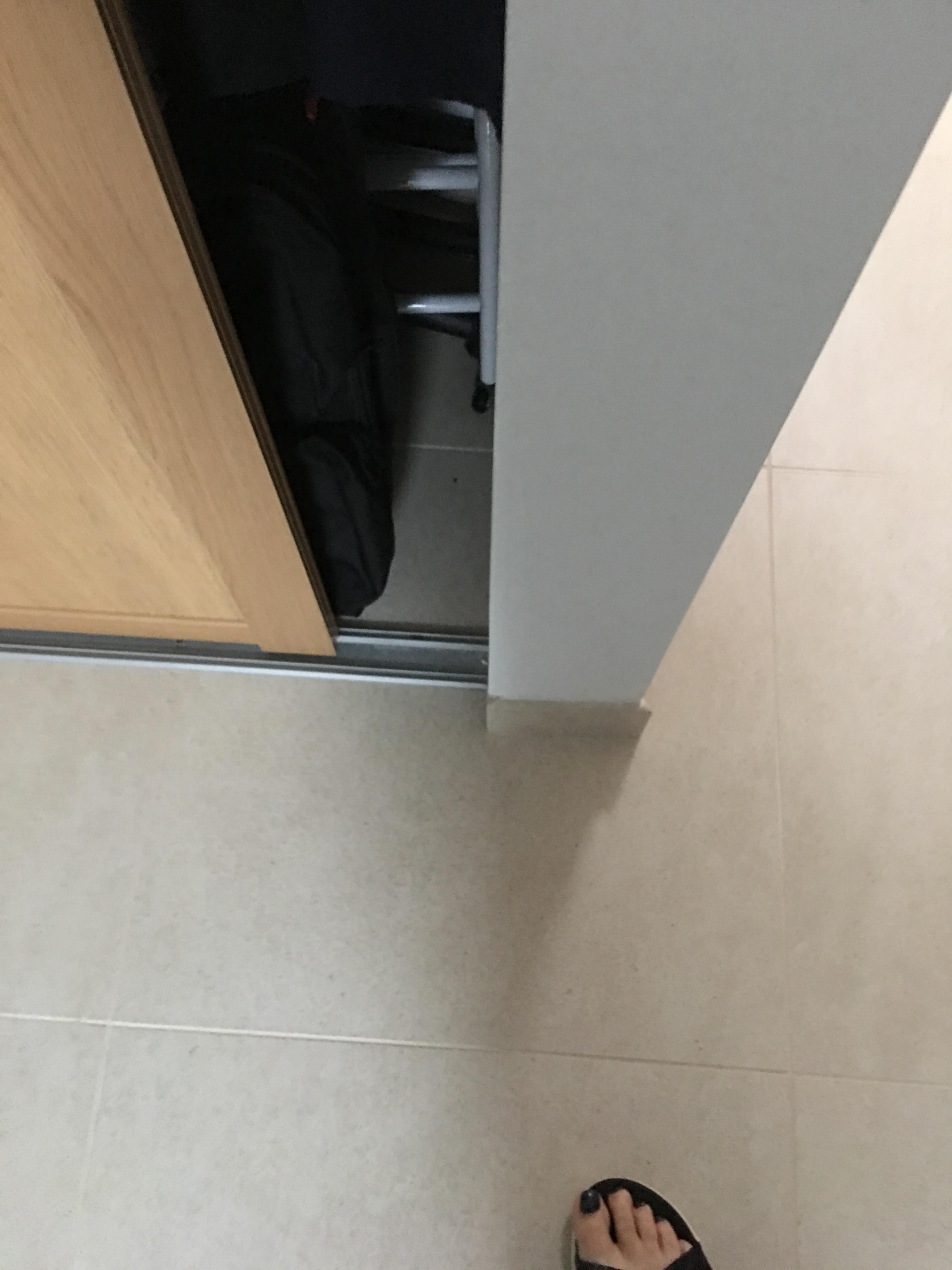

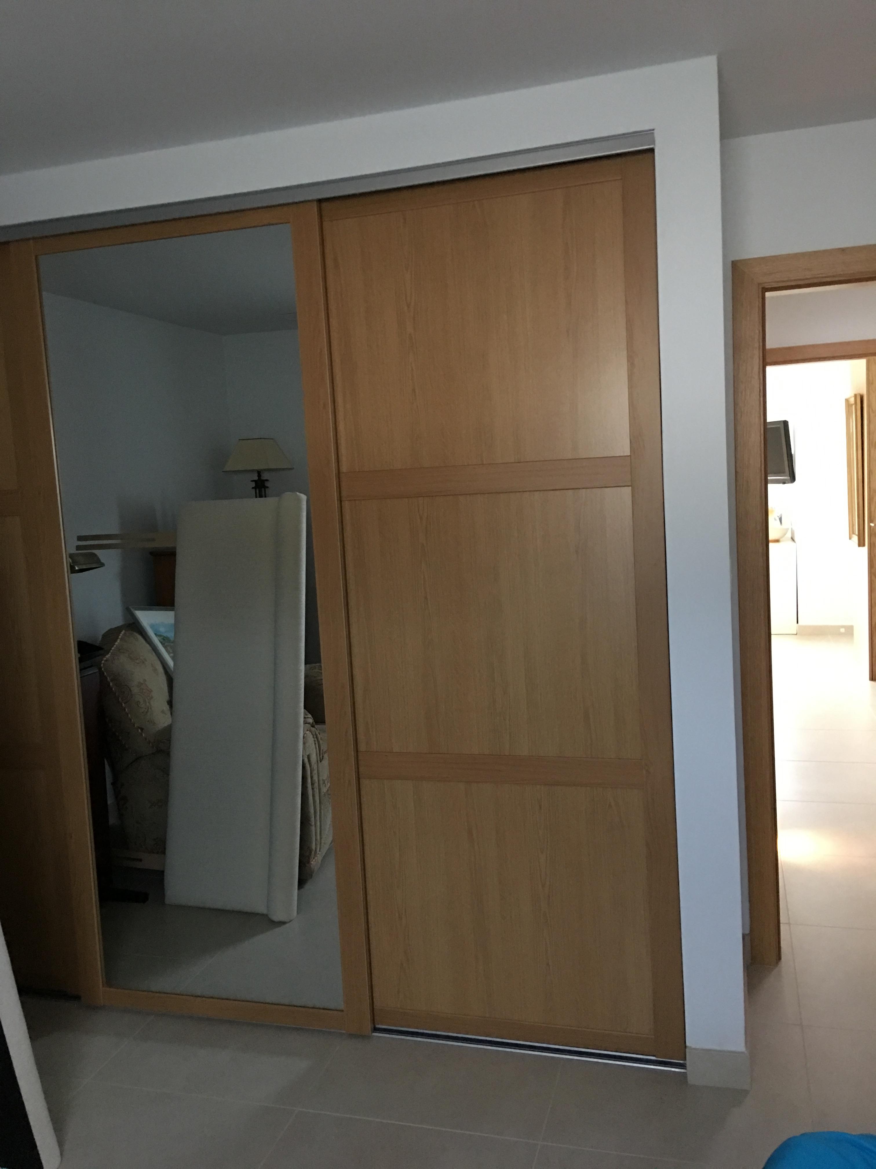

lizzie Posted October 21, 2018 Posted October 21, 2018 In our 2nd & 3rd bedrooms we used cheap as chips Howdens sliders and they are surprisingly good...I wanted a big mirror door too as smaller bedrooms so mirror good for bouncing the light but you can have any configuration of solid/mirror. I chose Oak finish to blend with our interior doors. We just built an extra bit of stud wall to create the alcove. No architraves clean line to plaster edge and floor runners are glued down to tiles so floor runs underneath. Carpenter made a good heavy weight shelf and we fitted rails under that. Even weight of my stuff is not going to make that collapse! Will fit out the other bits as and when, what we have done is vat reclaimable....I hope so anyway its gone in for the claim. I thought they would just be a stop gap solution but they look really good and very capacious. 3
ProDave Posted October 21, 2018 Posted October 21, 2018 @lizzie What are those howdens wardrobe doors actually like? Reading the caralogue, says "8mm paper faced chipboard" It's the "paper faced" not even veneer bit that makes me think they might be rubbish and a poor relation to the real oak doors in the rest of the house.
lizzie Posted October 21, 2018 Posted October 21, 2018 @ProDave that was my though too which is why when i needed something pdq and cheap I thought they would be a temp option. They may well be temp and we will use runners for alternative doors in time but at the mo I am impressed at how good they are for the money, they dont scream paper chipboard near real oak they work ok. Far better than I thought. If you need a budget option for a few years I would go for these.
