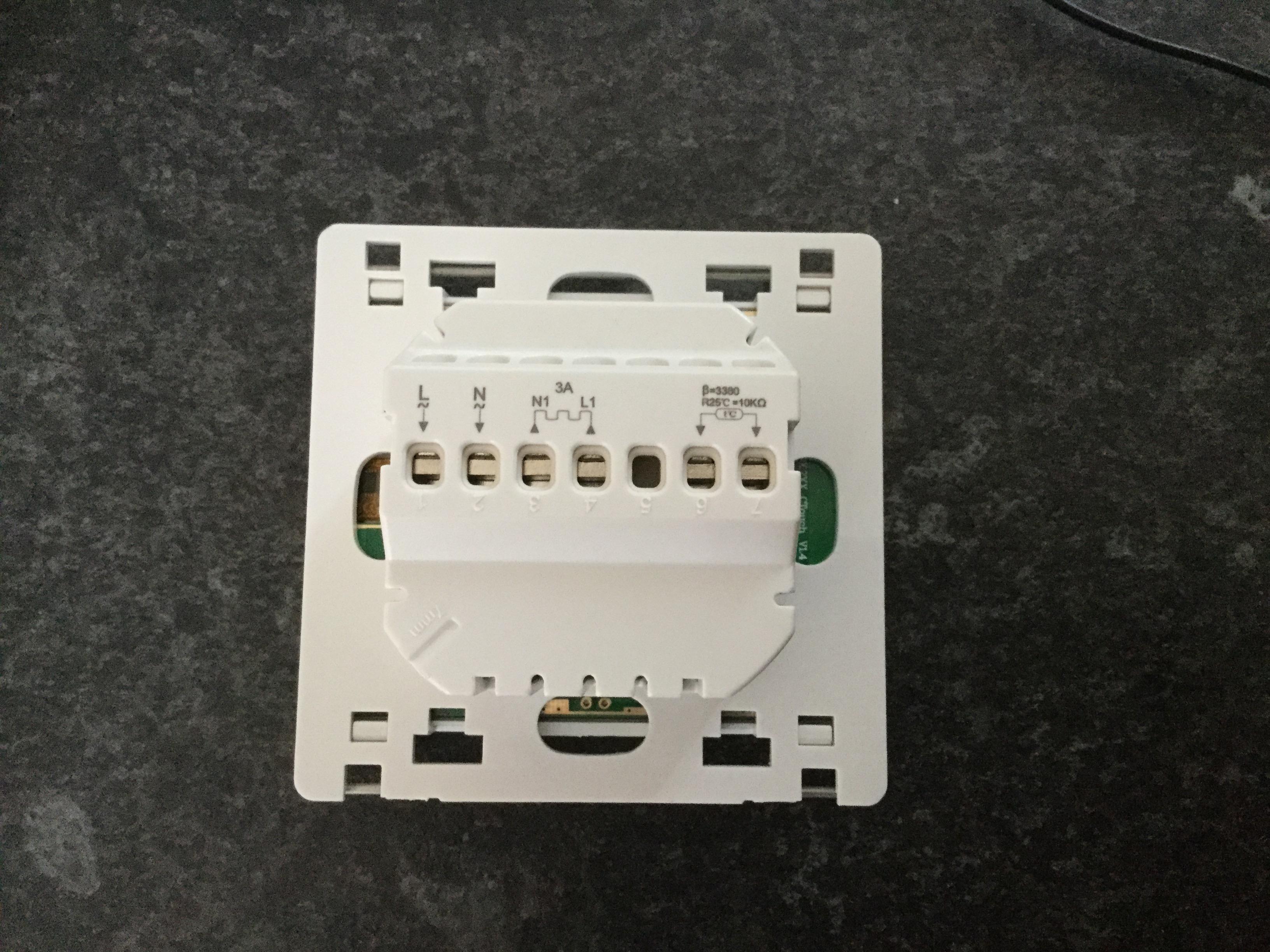

joe90 Posted October 2, 2018 Author Posted October 2, 2018 7 minutes ago, ProDave said: I presume MCBO you really mean RCBO Brain freeze, yes Dave, RCBO. Weird because if I disconnect the switch wires (dry contact) on the room stat it does not happen, when the switch wires are connected a flash appears in the back of the stat and the RCBO trips when the stat calls for heat, the 3 amp fuse does not blow so I guess it’s an earth fault, but these low voltage wires are not connected to the mains. Tomorrow I will see if either the live or neutral going to the stat connects to the switch wires in the stat, which I think would be an internal fault in the stat.

Jeremy Harris Posted October 3, 2018 Posted October 3, 2018 I've managed to find some more info on the thermostat you have, and it seems there are three variants. I've attached the pdf to this, but you may already have it. The part numbers vary for each model: E91.713 and E91.716 are mains output units (not isolated) with the first being the 3 A version and the second being the 16 A version. They have markings that look identical to those on your unit. E91.723 is the version with potential-free contacts on terminals 4 and 5, and looks different to the unit you have. E9_manual.pdf
joe90 Posted October 3, 2018 Author Posted October 3, 2018 (edited) Jeremy, you are a star (again). I have the 713 and looking at the connection tabs on the photo below I was confused by the writing and rang Wunda tech services and they told me the manufacturer printed them wrong and it was an isolated switch contact. Just checked it and yes when the stat calls for heat it produces 240v across n1 - l1. i suppose I will have to drive a relay with this to give me switch contacts to switch the ASHP call to heat? Luckily I have just bought two mains relays (one fir the MVHR using a humidistat). I just hope applying mains across the 12v supply in the ASHP has not done any damage.? Edited October 3, 2018 by joe90

joe90 Posted October 3, 2018 Author Posted October 3, 2018 Bollocks, no joy, the GMC board has an led and this was flashing at 1/2 hz yesterday, nothing now. Checked mains going in and 5 amp fuse on the board is ok. “There is a LED on the GMC board that displays any board errors. The error code can be identified from the flashing LED using the following table. In the case of more than one error, the error with the highest priority will be displayed until it is resolved. In the case of normal operation, the LED flashes at a frequency of 1⁄2 Hz. frequency of 1Hz, it flashes a number of times equal to the error code Diagnostic 6 the flashing is interrupted for 2 seconds between the first and second digits.” I really dont don’t know where I go from here.

Jeremy Harris Posted October 3, 2018 Posted October 3, 2018 12 minutes ago, joe90 said: Yup, that’s my worry. The command unit still appears to be working, displays everything except outdoor air temp! . The command unit is powered from the low voltage supply on the ASHP main board, so it looks like the power is there. The outdoor temperature and humidity data is processed by the main board in the ASHP and transmitted via a serial data link to the command unit, so it looks very much as if the data handling and control side of the main board has failed, rather than the power supply. I suspect a new main board will be needed, but at least you have the command unit, so can programme it with the settings you need, even if it's just to download all the default settings into non-volatile memory on a new board. It may be that a new main board comes with all the defaults programmed, but it's possible that, like a boiler main board, it doesn't, and needs to be initially programmed by connecting the command unit. A new main board seems to be around £100, from that other post; maybe you should try and get Wunda to stump up for it, as they told you that the thermostat had dry contacts when it didn't.
