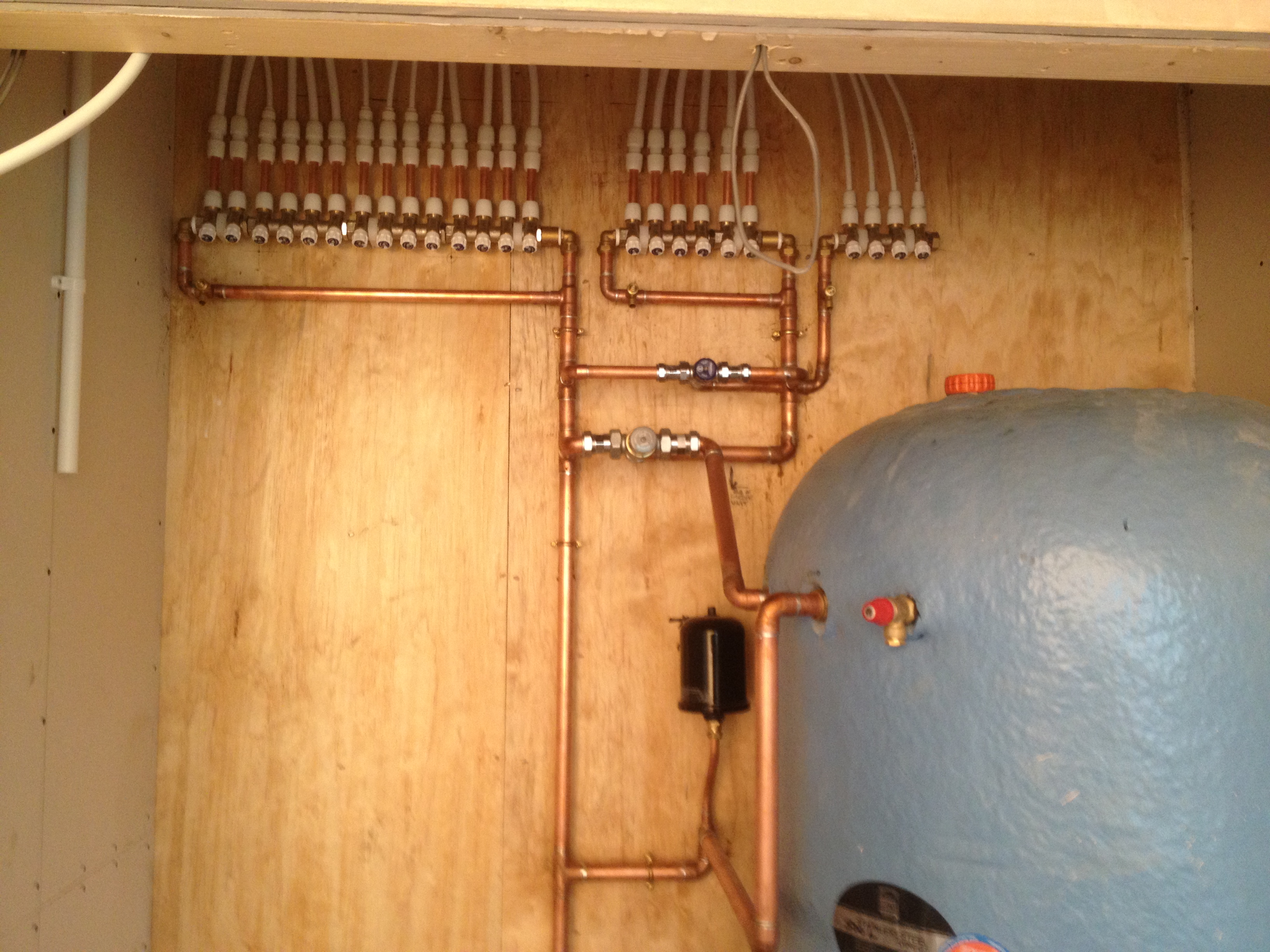

JanetE Posted July 24, 2016 Share Posted July 24, 2016 Just about to start on the Hep 20 plumbing in 15mm and we are having a manifold system. I was wondering how to make up the actual manifold as they do not manufacture one, unlike Speedfit. We have 12 connections on the hot supply and 17 on the cold. I would be interested to know how all you experts go about this? Thanks in advance for your help. Link to comment Share on other sites More sharing options...
Nickfromwales Posted July 24, 2016 Share Posted July 24, 2016 This is the best 'zoom-able' pic I can find. The rails are supported by the pipe work which is held in place with brass Munson rings. Copper to irons on each end, and as a belt n braces job I created a ring so the manifolds got fed from both ends. I did that as the cold manifold was very long and could have suffered loss of flow and I just then carried that across to the hot manifold to as it was easy enough to do. The remit on that job was to be able to use all the showers at the same time and still have some useable flow / pressure elsewhere so went to town on this one. If you zoom in you'll see opaque / white plastic spacers in between the manifolds ( 3 to the long run ). These iirc were 28mm Talon pipe clips which held the rails with near spot on results. Another way to do this, if only feeding from just one end, would be a clip on the input pipe work and then a stub of pipe made off and cap ended ( or a DOC ) the other side, with enough pipe to get a second clip on. 5 Link to comment Share on other sites More sharing options...

Nickfromwales Posted July 24, 2016 Share Posted July 24, 2016 4 hours ago, Barney12 said: so...... The main benefit of this type of setup is maintainable pressure at all outlets? Presumably the main drawback is the sheer amount of pipe to feed each location? A choice people make when deciding upon how they want their system to perform . Having the shower flow / temp fluctuating during use is something people wish to actively negate, and the pipe is cheap enough tbh. 1 hour ago, RandAbuild said: Can you use underfloor heating manifolds? As long as they're brass or stainless then there's no real reason why not, just that the isolations aren't ideally suited to mains pressure / control of. Personally I'd not recommend it. Link to comment Share on other sites More sharing options...

Barney12 Posted July 24, 2016 Share Posted July 24, 2016 OK no next potentially daft question....... Why the short length of copper pipe on each branch? Link to comment Share on other sites More sharing options...
Nickfromwales Posted July 24, 2016 Share Posted July 24, 2016 OCD There was to be a plywood boxing-in to go directly above the manifolds and cover the cuts in the ceiling which are out of view. The problem was, how to fill the holes where the various pipes bent off into their different directions whilst maintaining fire cell qualities and basic neatness. The only reason for the stubs of 15mm copper was that's where the plywood was to be finger-cut to go over the pipes, thus not allowing melted plastic to compromise that transition. The 10mm's to the right hadn't yet been doctored to suit yet as this was the early stages of commissioning and testing and I was pushed to get some services working ( get the downstairs cloak wc working so the portaloo could go etc ) so I just needed to pressurised the manifolds and try's things for leaks. Link to comment Share on other sites More sharing options...

TerryE Posted July 24, 2016 Share Posted July 24, 2016 @Nickfromwales, thanks we found the Hep2O brass manifolds on eBay, etc.. I was thinking of doing the extract from the eBuild post where you posted this pic originally, but of course DB has now removed the ability of registered eBuild members to view pictures, so the pic itself was lost except from memory. I was also planning to replicate something like this : 6+6 high flow (H+C) and 6+11 low flow (H+C). There's a lot of low flow colds -- but that's because it doesn't seem to be worth the hassle of doing local Ts and tapping toilets off wash basin colds. As far as I can see you main copper runs are 22mm rather than 28mm. I can't see any reason for going up to 28 if you have a pressurised system at 2 bar-ish. Link to comment Share on other sites More sharing options...
Nickfromwales Posted July 24, 2016 Share Posted July 24, 2016 The only reason for 28mm in that job was because of the accumulator. 22mm is fine on a non-acc install. No,point in going over what your cold main will deliver / is sized at. You can only get a pint out of a pint jar Link to comment Share on other sites More sharing options...

Nickfromwales Posted July 25, 2016 Share Posted July 25, 2016 Yup, one of the major benefits. That job had semi-pedestals at each basin so more of a pita to get at them later. The other major benefit is being able to leave rooms isolated if they haven't yet been first fixed and then bringing them online, one feed at a time, to check for leaks / commission. Very handy in a part-complete build as you don't have to keep draining down and interrupting the water supply to already connected outlets. There was another 2-port manifold at the bottom of that pic ( yet to be fitted at the time iirc ) which serviced non-softened water. One to the boiler filling loop, and one to the kitchen sink cold tap ( for filtered water tap & cooking quality water ) plus it also tee'd off at the kitchen sink and supplied the outside tap. In an installation with a softener and an accumulator, the point where you tee the outside tap off from is of critical importance. It needs to be directly after the incoming cold stopcock and before the non-return valve of the accumulator**, or multi-block of an UVC arrangement. The outside tap should be before any pressure reducing measures so it influences the cold pressure to the house as little as possible. **You don't want the outside tap to be using stored energy from the accumulators, 1 Link to comment Share on other sites More sharing options...
TerryE Posted July 31, 2016 Share Posted July 31, 2016 @Nickfromwales, just walking though your layout about I can understand the first TMV, but why cascade in a second for the low flow hots? Was this so that all of the washbasin hots were at a lower hand-hot temperature? If so, then I take it that you only dry-shave? Also, Is there any specific reason from mounting the TMVs horizontally and standing out of the layout plane -- other than your drive for neatness? Link to comment Share on other sites More sharing options...
Nickfromwales Posted July 31, 2016 Share Posted July 31, 2016 Sorry for any night terrors, but I wet shave in the shower . Smoother than Ghandi's heel . The only thing id do differently from that pic, with hindsight and no pressure being a wonderful thing, would have been to put the secondary tmv immediately off the TS hot outlet. Upon reflection, and with 28mm hot pipework before it, there may have been a bit too much 'dead' cold water to draw through everything ( as it is there ) thus offsetting the benefits of running 10mm to the basins. It was a tricky install actually, with both high flow dhw plus energy efficiency being thrown into the remit. At the time my assumption was that the leg of 28 before the first blending valve would never be 'stone' cold, and the subsequent design was born. I don't loiter after jobs so can't really report on the actual outcome, but I'm reasonably sure that the TS, being kept hot 24/7, would have allowed a bit of heat to escape and reside in that first leg thus reducing the 'issue' somewhat. That install was done 'on the fly' so not too bad considering. Tmvs can be mounted in any orientation, I just wanted that as easy to lag as possible, hence the Munson rings to space the pipe from the ply etc. Link to comment Share on other sites More sharing options...
Nickfromwales Posted July 31, 2016 Share Posted July 31, 2016 Fwiw, if there's no dependant kids / infirm occupants you can certainly do away with the second tmv if you wish. The tmv should be set around 50oC anyway so not going to cause issue for a normal household tbh. Personally I just like the hot water comfort of flicking the tap to the hot position and opening it and getting the exact same flow and temp each time regardless of what others are doing with outlets elsewhere in the property. Can't be arsed setting the temp, then it stabilises, then having to set it again, a proper pita. Link to comment Share on other sites More sharing options...
