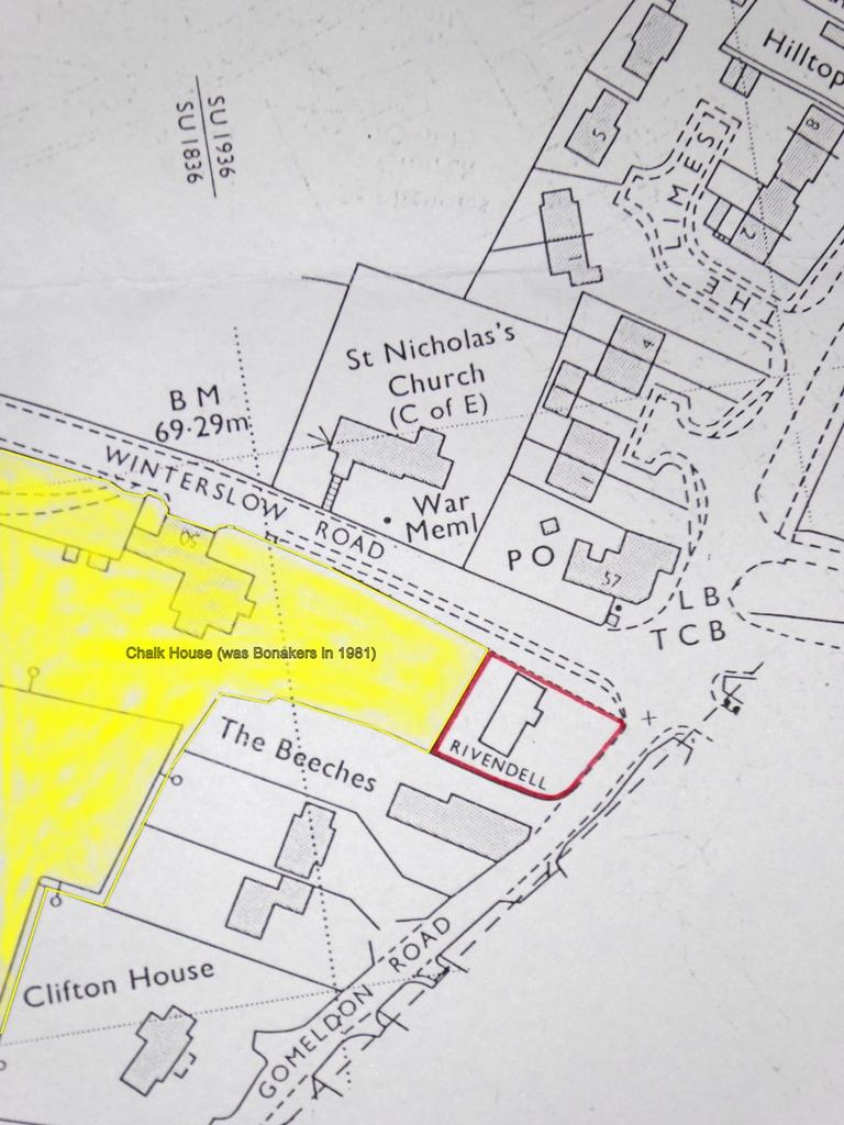

Jeremy Harris Posted September 24, 2018 Share Posted September 24, 2018 Hopefully the OP won't mind me tagging on to this as it's the same topic. We're being asked to stump up for a single premium insurance (plus a hefty fee from our solicitor) to cover a covenant that can't ever be enforced, for two reasons. Firstly, it's a "right to light" covenant where the property that has the right to light is not identified (for whatever reason the deeds/land registry documents don't identify the property). Secondly, there are other covenant clauses that restrict the house to single storey, and as such it couldn't possibly block anyone's light, especially as it's got hedges on the two sides facing distant neighbours that are around 12 to 15ft tall. My inclination is to say no, we won't pay for insurance, as it's not something that can ever be enforced. I'm getting a bit fed up with our buyer trying to get us to jump through hoops, especially as we gave her the details of the covenant BEFORE she made an offer. I'm inclined to the view that these one-off indemnity insurances are a bit of a scam. Anyone got any views about them in a case like this? Link to comment Share on other sites More sharing options...

Jeremy Harris Posted September 24, 2018 Share Posted September 24, 2018 Our buyer is a cash buyer who doesn't need a mortgage and definitely doesn't want to develop the house, she's buying it for an ageing parent and was fully informed of the covenant when she viewed the house. Having been caught out by the first sale falling through because the buyer pulled out when seeing the covenants I made sure I showed them to every person who viewed the second time around. What hacks me off is that it's our solicitor pushing for the insurance, and the fat fee they get for providing it (more than half the premium!). I know that neither of the neighbours know anything about this, as neither has anything in their deeds or Land Registry documents that mention any covenant regarding our house. Both have checked their deeds to be sure and have come back saying that they can't find anything at all referring to our house. One of the houses is 60m away anyway, so is well outside the "right to light" provisions, and the other is much higher than our house and our house is completely hidden from it by a 15ft high yew hedge. Link to comment Share on other sites More sharing options...

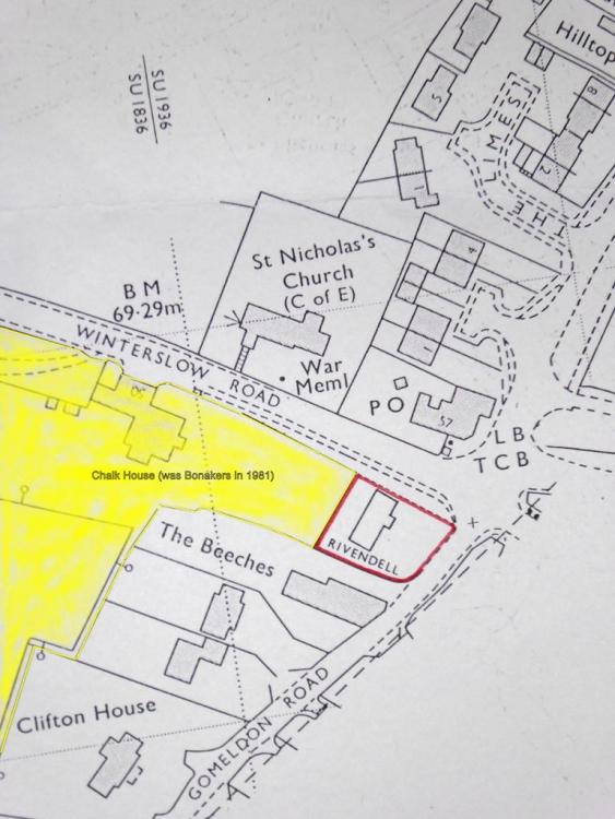

Jeremy Harris Posted September 25, 2018 Share Posted September 25, 2018 Thanks all. The wording of the part of the covenant that no longer defines the land to which it applies (the plan it refers to is missing, we don't have a copy, the Land Registry don't have a copy and the current owners of the house next door, which sold the land our house is on in 1981, don't have a copy) is: Quote "EXCEPT AND RESERVED unto the Vendors and their successors in title the full and unrestricted right at any time hereafter and from time to time to erect or permit to be erected any buildings or other erections and to alter any building or other erection on the Vendors adjoining land edged with green on the said Plan numbered One (hereinafter called "the green land") in such manner as to obstruct or interfere with the passage and access of light and air to any buildings which may be erected upon any part of the land hereby conveyed and so that all privileges of light and air now or hereafter to be enjoyed over any part of the green land by or in respect of the property hereby conveyed shall be deemed to be enjoyed by the licence or consent of the Vendors and not as of right AND FURTHER the Vendors reserve such rights of light and air for the benefit of the green land as they would be entitled to if the property hereby conveyed and the green land were in separate ownership and indefeasible rights of light and air as at present enjoyed in respect of the green land had been acquired under the Prescription Act 1832." The vendors at that time were the owners of the house to the West, some ~40m away, and their beneficiaries in title are the current owners of that house. The house to the South of our house was built around 1930 and has been in private ownership since it was built, so cannot be the land referred to in the above clause. I know full well that the "land edged with green" can only be the 1981 vendor's land, as there is no other land adjoining our house that it could be (the local authority own the grass verge to the North, we own the grass verge to the East). I've shaded in the area in yellow that is the only land to which the above clause could apply to on this plan: From the link that @Temp gave, I note that in the section on enforceability there is this note: Quote 2. There must be a benefited and a burdened land and the two must be “reasonably close together” – close enough for the benefited land to be genuinely adversely affected by a breach. I find it very hard to see how a "right to light" could possibly apply given the distance between the 1981 vendors house to the West and our house. I'm certain that it would fail the "reasonably close together" test. AFAIK, the "right to light" cannot now be enforced for an area of garden, only a dwelling. Link to comment Share on other sites More sharing options...
Tyke2 Posted September 25, 2018 Share Posted September 25, 2018 I think that right to light is a legally defined term for existing buildings. Specifically windows. So land in itself wouldn't have a right to light. You need a right to light surveyor with experience in such matters and probably a lawyer. Don't try and second guess it now with "expert" advice from the likes of myself :-) 1 Link to comment Share on other sites More sharing options...
Jeremy Harris Posted September 25, 2018 Share Posted September 25, 2018 9 minutes ago, Tyke2 said: I think that right to light is a legally defined term for existing buildings. Specifically windows. So land in itself wouldn't have a right to light. You need a right to light surveyor with experience in such matters and probably a lawyer. Don't try and second guess it now with "expert" advice from the likes of myself ? That's my understanding from a previous debate we had, either here or on this forum's predecessor, where someone (almost certainly @Temp) found chapter and verse on the "right to light" legislation. Either way, I can't see how a house ~40m away from our boundary could possibly have a "right to light" with regard to land so far away, especially as there's a very big hedge on our boundary, on their side. 1 Link to comment Share on other sites More sharing options...

jack Posted September 25, 2018 Share Posted September 25, 2018 (edited) 1 hour ago, JSHarris said: I find it very hard to see how a "right to light" could possibly apply given the distance between the 1981 vendors house to the West and our house. I'm certain that it would fail the "reasonably close together" test. AFAIK, the "right to light" cannot now be enforced for an area of garden, only a dwelling. I think your arguments are generally sound, except that it's the benefited and burdened lands that need to be "reasonably close together", rather than the dwellings. I think it passes that test, but not all the others. Also, having read your comments above, I misinterpreted the covenant when I initially skim-read it. For the sake of others that might make the same mistake, all of the stuff up until "AND FURTHER" is actually protecting the right of the vendor to build other buildings that interfere with the light and air enjoyed by Jeremy's property by way of the "green land". The only rights that the green land enjoys are "such rights of light and air ... as they would be entitled to if the property hereby conveyed and the green land were in separate ownership and indefeasible rights of light and air as at present enjoyed in respect of the green land had been acquired under the Prescription Act 1832." If I interpret this clause correctly, then all it's saying is that the green land enjoys a specific, limited right to light and air only to the extent that it would have existed had the properties previously been owned separately at the time Jeremy's land was conveyed, and even then only to the extent that such rights would have been acquired under the Prescription Act 1832. In other words, I don't think you should even look at the current right to light laws to interpret this part of the covenant. For example, I don't think that common law rights are covered by this clause, unless they're referenced in the Prescription Act 1832. Since no dwelling on the green land appears to have had such benefit of light and air (although you might want to check out the "Prescription Act 1832" to be sure!) at the time of conveyance, I can't see that any such right can exist now. Edited September 25, 2018 by jack Clarification of second last paragraph 1 Link to comment Share on other sites More sharing options...
