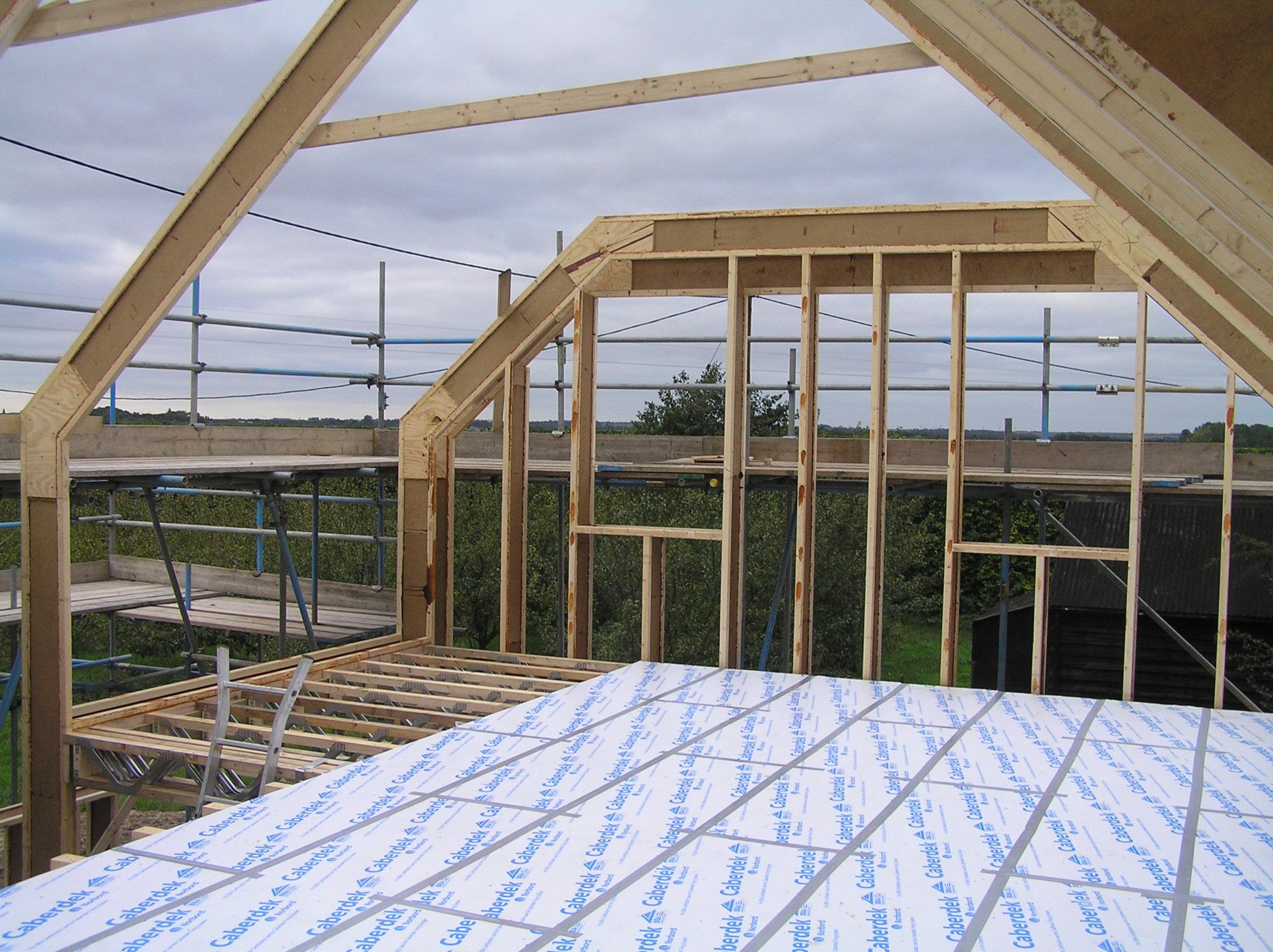

MikeSharp01 Posted September 5, 2018 Share Posted September 5, 2018 Trying to be my usual efficient self, not always a good idea, I have been working out how much floor boarding I need and laying delivery out against the build sequence and I think I have hit a snag. I need to board out the first floor, largely, to put the ridge beam elements in place so it will be open to the elements until the rafters & sarking are up. Have just tried to find floor boarding I can leave out in all weathers and the best they can do is 'water resistant' just how resistant is that then? I might be able to cover it but there is no way it won't get wet! Is there an alternative I can use, I don't want to OSB it if I can avoid it as that will be wasteful. Any thoughts. Link to comment Share on other sites More sharing options...

Gone West Posted September 5, 2018 Share Posted September 5, 2018 We had 22mm CaberDek laid on our first floor while the frame was being constructed. It comes covered in plastic and the joins on ours were taped as well. It survived out in the open. 2 Link to comment Share on other sites More sharing options...
ProDave Posted September 5, 2018 Share Posted September 5, 2018 Ours was floored in 11mm OSB as a temporary deck. It didn't get wasted, that eventually got cut into strips to drop into the bottom of the JJI joists to support the insulation. For that application it didn't matter that some of the edges had swelled a little. Link to comment Share on other sites More sharing options...
Mr Punter Posted September 5, 2018 Share Posted September 5, 2018 I like Egger Protect 22mm chipboard. The coating is permanent and on both sides so if you have subsequent leaks it should not turn to Weetabix too quickly. 2 Link to comment Share on other sites More sharing options...

PeterW Posted September 5, 2018 Share Posted September 5, 2018 Egger Protect glued and nailed to joists and the other boards is what I use. Weatherproof for 9 weeks from memory with 20% rain. If it is glued properly it is structural and makes the whole structure rigid and will turn your first floor into a swimming pool ... Link to comment Share on other sites More sharing options...
Hecateh Posted September 5, 2018 Share Posted September 5, 2018 Mine was the weather resist board and was open to the sky for at least a month during the snow. Standing snow melted onto it and it was absolutely fine. I've even got a few pieces of spare board that have been left outside since and they are also still fine despite no sealing on the edges Link to comment Share on other sites More sharing options...
Tyke2 Posted September 5, 2018 Share Posted September 5, 2018 46 minutes ago, PeterW said: Egger Protect glued and nailed to joists and the other boards is what I use. Weatherproof for 9 weeks from memory with 20% rain. If it is glued properly it is structural and makes the whole structure rigid and will turn your first floor into a swimming pool ... I used a similar phonelic coated chipboard. Left open to the elements for weeks over winter. https://www.mkmbs.co.uk/prodt000653-chipboard-tg-p5-phenolic-weyroc-protect-2400mm-x-600mm-x-22mm-fsc/ Link to comment Share on other sites More sharing options...
PeterW Posted September 5, 2018 Share Posted September 5, 2018 6 minutes ago, Tyke2 said: I used a similar phonelic coated chipboard. Left open to the elements for weeks over winter. https://www.mkmbs.co.uk/prodt000653-chipboard-tg-p5-phenolic-weyroc-protect-2400mm-x-600mm-x-22mm-fsc/ Thats actually Egger Protect - I have an account with MKM. Good stuff and really decent service from the local branch too. 1 Link to comment Share on other sites More sharing options...
Tyke2 Posted September 5, 2018 Share Posted September 5, 2018 29 minutes ago, PeterW said: Thats actually Egger Protect - I have an account with MKM. Good stuff and really decent service from the local branch too. Im not sure what actual make I used as it was a while ago. But glue and tape the joints and edges and it all works great. Link to comment Share on other sites More sharing options...
