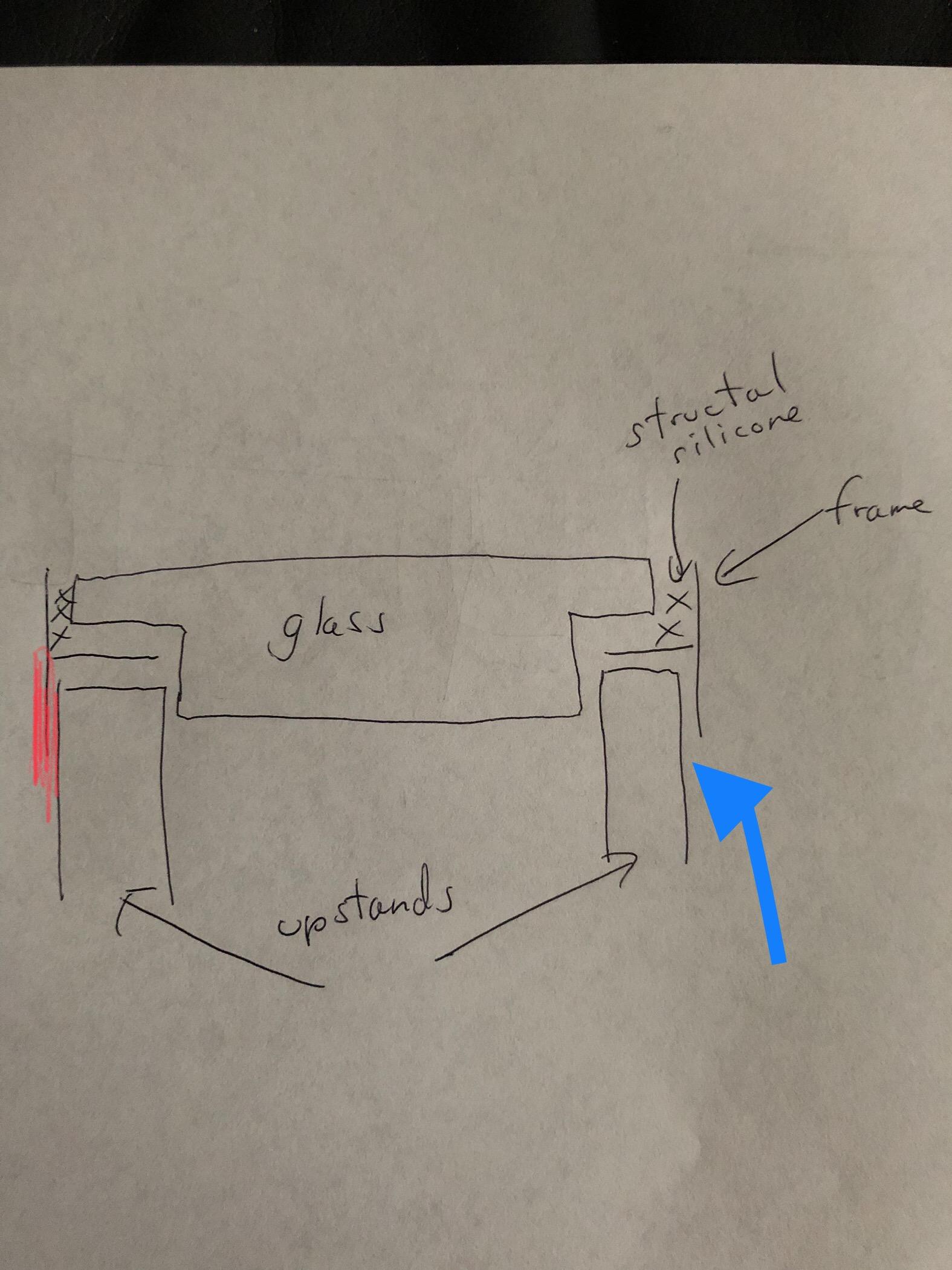

Nickfromwales Posted August 28, 2018 Posted August 28, 2018 So where is the CT1 ? Under the T against the top of the upstand?
Declan52 Posted August 28, 2018 Posted August 28, 2018 What did you use to attach the T bracket to the upstand?? What did you use to seal the red line in the pic??
Pocster Posted August 28, 2018 Author Posted August 28, 2018 9 minutes ago, Nickfromwales said: So where is the CT1 ? Under the T against the top of the upstand? Yep - presumably not enough !
Pocster Posted August 28, 2018 Author Posted August 28, 2018 4 minutes ago, Declan52 said: What did you use to attach the T bracket to the upstand?? What did you use to seal the red line in the pic?? You can’t seal along and under . Just along . T frame isn’t ‘tight’ to upstand - needed wiggle room . So ct1 is only horizontal- but as said - must be gaps
Russell griffiths Posted August 28, 2018 Posted August 28, 2018 I would put it up the vertical gap as well can you squirt the entire contents out on a bit of board and slide it up the gap with your fingers. 1
Pocster Posted August 28, 2018 Author Posted August 28, 2018 (edited) 3 minutes ago, Russell griffiths said: I would put it up the vertical gap as well can you squirt the entire contents out on a bit of board and slide it up the gap with your fingers. Yeah I was thinking that . The size of that gap ( depending on which window ) can be a few mm from t frame to upstand . Too 15mm . Need a lot of ct1 for 4 windows . Can get my camera phone under the edge to check it’s good .... Edited August 28, 2018 by pocster
Nickfromwales Posted August 28, 2018 Posted August 28, 2018 7 minutes ago, Russell griffiths said: I would put it up the vertical gap as well can you squirt the entire contents out on a bit of board and slide it up the gap with your fingers. Yup. Smother them to death and then wipe any excess off with the cheapest baby wipes you can find, lots and lots of them. Buy a can of CT1 Multi-Solve spray to do the final spit n polish. Pump the bastard stuff in there and watch it ooze out of everything. You could seal a submarine with that stuff. Dont be tight or you'll be doing it again, and dont forget that when you put it in the next time I doubt you'll ever be able to get them out intact again so 'one shot' or 'deep shit'....... 2
PeterW Posted August 28, 2018 Posted August 28, 2018 I think there may be another way using self adhesive EDPM tape. It is definitely a drainage issue so you also need to fix that somehow too. If the frame had a slight twist in it, it will leak i expect water alter is getting in the blue arrow - can you bond all the way round with EDPM tape to the upstand and fill any initial gaps with sealant or foam ..?
Russell griffiths Posted August 28, 2018 Posted August 28, 2018 Could you make a Flexi nozzle some 10mm hose slipped over the silicone tube two person job, one squeezing the handle, one guiding the hose.
Pocster Posted August 28, 2018 Author Posted August 28, 2018 4 minutes ago, Russell griffiths said: Could you make a Flexi nozzle some 10mm hose slipped over the silicone tube two person job, one squeezing the handle, one guiding the hose. That’s a good idea !
Cpd Posted August 28, 2018 Posted August 28, 2018 7 minutes ago, PeterW said: can you bond all the way round with EDPM tape Thats what I was getting at. Yes fill up with ct1 or foam etc and then a serious tape exercise to give a seemless finish 2
Declan52 Posted August 28, 2018 Posted August 28, 2018 Would something like that expanding window tape.
Pocster Posted August 28, 2018 Author Posted August 28, 2018 1 minute ago, Declan52 said: Would something like that expanding window tape. Link ? . An expanding waterproof tape would be well handy !!
Pocster Posted August 28, 2018 Author Posted August 28, 2018 http://expandingfoamtape.co.uk/m/index.php?main_page=index&cPath=25 ????? This any good
Declan52 Posted August 28, 2018 Posted August 28, 2018 This stuff. https://www.sealantsonline.co.uk/Products/Compriband-foam-tapeshttps://www.sealantsonline.co.uk/Products/Compriband-foam-tapes 1
Pocster Posted August 28, 2018 Author Posted August 28, 2018 12 minutes ago, Declan52 said: This stuff. https://www.sealantsonline.co.uk/Products/Compriband-foam-tapeshttps://www.sealantsonline.co.uk/Products/Compriband-foam-tapes Thanks which one ? I assume stuck on the underside of the T frame so it expands towards the upstand ?

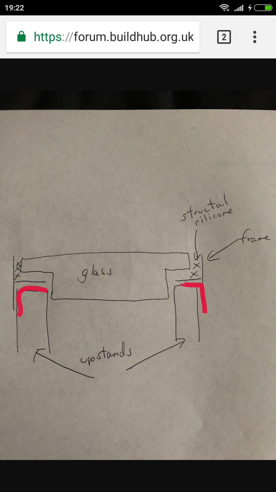

AliG Posted August 29, 2018 Posted August 29, 2018 Could you buy neoprene rubber sheets and cut them to make a rectangular gasket that the t-frame would sit on top of? A large sheet costs about £15 and could be used to make a continuous seal. You could try one and at least if it doesn’t work it can be taken apart again easily unlike CT1
Pocster Posted August 29, 2018 Author Posted August 29, 2018 Well i managed to get the smaller window out which does leak . looking at it - hard to imagine the water level got that high I.e over the black rubber . Some photos - perhaps someone will see something I haven’t cheers
Pocster Posted August 29, 2018 Author Posted August 29, 2018 (edited) It’s strange looking at that concrete block to the right - it’s damp . But no water from above . Like it’s soaked ‘through’ it rather than over it . Of course it’s part of the upstand and has the rubber going over it . So not sure ... Timber and rubber above bone dry ... Edited August 29, 2018 by pocster
AliG Posted August 29, 2018 Posted August 29, 2018 (edited) I was just telling someone I'd much rather work with electricity than water. Water's ability to get through the smallest gap is amazing. From your last post it sounds like the water might be getting under the rubber. Thinking about it, although this is on the ground, it is effectively the same as building a flat roof, should the rubber covering the upstand not be flashed out across the ground and sealed as if you were building the flashing around a roof window? i.e. like this Re my earlier post it looks like you have created a kind of rubber gasket as I suggested but with a lot of joins. What I was thinking is if you by a rectangle of neoprene you can cut the centre out of it and create a continuous gasket with no joins. Looking at the frame as is though, I would be worried that the number of screws in the frame would not create a tight enough seal all the way round. Of course if the water is getting under the rubber this is a moot point. Edited August 29, 2018 by AliG
Pocster Posted August 29, 2018 Author Posted August 29, 2018 7 minutes ago, AliG said: I was just telling someone I'd much rather work with electricity than water. Water's ability to get through the smallest gap is amazing. From your last post it sounds like the water might be getting under the rubber. Thinking about it, although this is on the ground, it is effectively the same as building a flat roof, should the rubber covering the upstand not be flashed out across the ground and sealed as if you were building the flashing around a roof window? i.e. like this Re my earlier post it looks like you have created a kind of rubber gasket as I suggested but with a lot of joins. What I was thinking is if you by a rectangle of neoprene you can cut the centre out of it and create a continuous gasket with no joins. Looking at the frame as is though, I would be worried that the number of screws in the frame would not create a tight enough seal all the way round. Of course if the water is getting under the rubber this is a moot point. I’ve got s bad feeling it’s getting under the rubber . Before any paving or concrete I.e just the rubber I flooded the entire area and left it for days . Not a drop got through . But I *guess* block paving changes any water flow . Beneath this ( underground ) I have the dimpled membrane on the walls which would lead to an internal drain and then pump . Was always in the back of my mind to ‘somehow’ get this over the ceiling also . Looks like I might have to anyway . Though it’s not designed for that unless you have a nice curved cellar ....
AliG Posted August 29, 2018 Posted August 29, 2018 I think you are right there. When I Googled flat roof windows I noticed they all sit above the roof. Roof windows are either on sloping roofs where the water runs away or raised above the roof. By building around the window water will be much slower to run away and also able to rise in level which increases the chances of breaching the seal. Maybe a band of pebbles around the window to improved drainage would also help, but it wouldn't look as neat.
Pocster Posted August 29, 2018 Author Posted August 29, 2018 16 minutes ago, AliG said: I think you are right there. When I Googled flat roof windows I noticed they all sit above the roof. Roof windows are either on sloping roofs where the water runs away or raised above the roof. By building around the window water will be much slower to run away and also able to rise in level which increases the chances of breaching the seal. Maybe a band of pebbles around the window to improved drainage would also help, but it wouldn't look as neat. Just spoke to permaguard ( other companies exist ? ) . Tanking slurry mix on the ceiling and upstands was his suggestion . Though the ceiling is flat and I need to key it ‘somehow ‘ . I’m willing to try anything but how do I key a flat concrete ceiling ??? f^xking hate water - always a bitch !!
