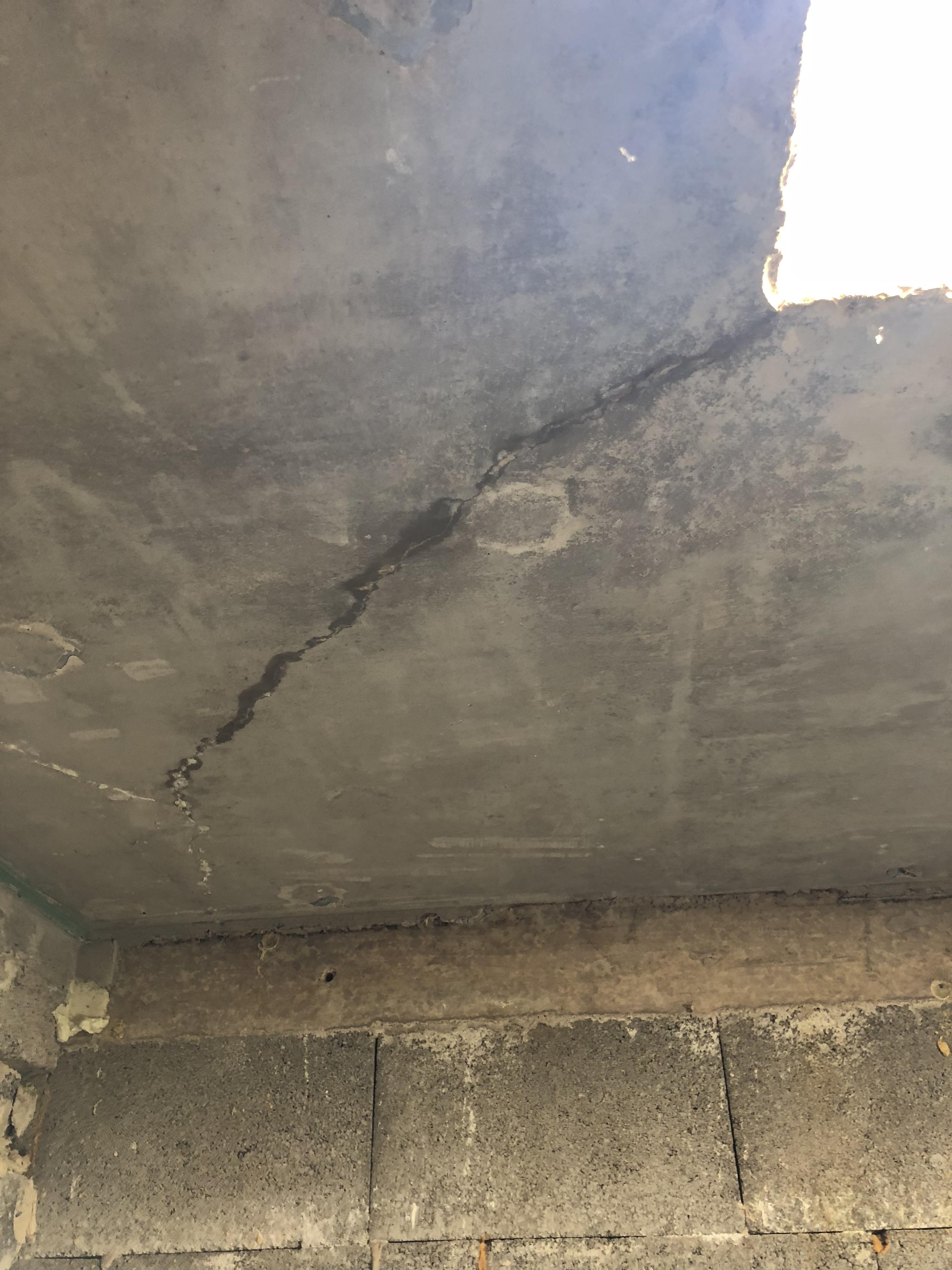

2 hours ago, pocster said:

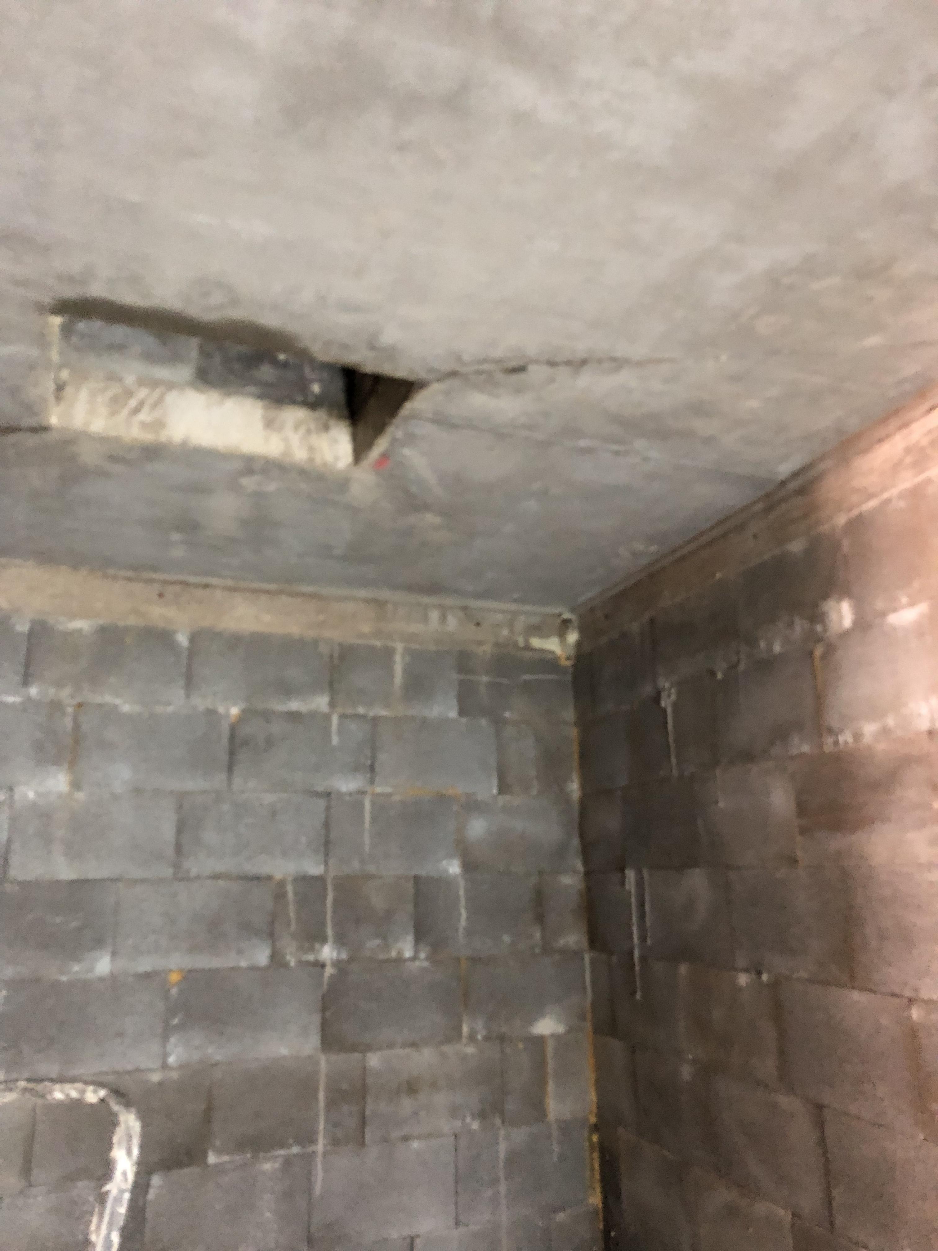

It’s strange
looking at that concrete block to the right - it’s damp . But no water from above . Like it’s soaked ‘through’ it rather than over it . Of course it’s part of the upstand and has the rubber going over it . So not sure ...
Timber and rubber above bone dry ...
Water leaks like this can be a pig to trace where the water is getting in as it can sometimes track along horizontally for quite a distance until it finds a weak spot where it then enters the building.
While the rooflight is off I'd do a water flood test to try and establish if the water is coming in from the sides of the upstands or not.
Get a hosepipe and gently soak the area around the upstand whilst making sure the level of the water doesn't rise up past the top of the rubber.
If you get new water entering the building then you will know its not the seal between the rooflight and the upstand.

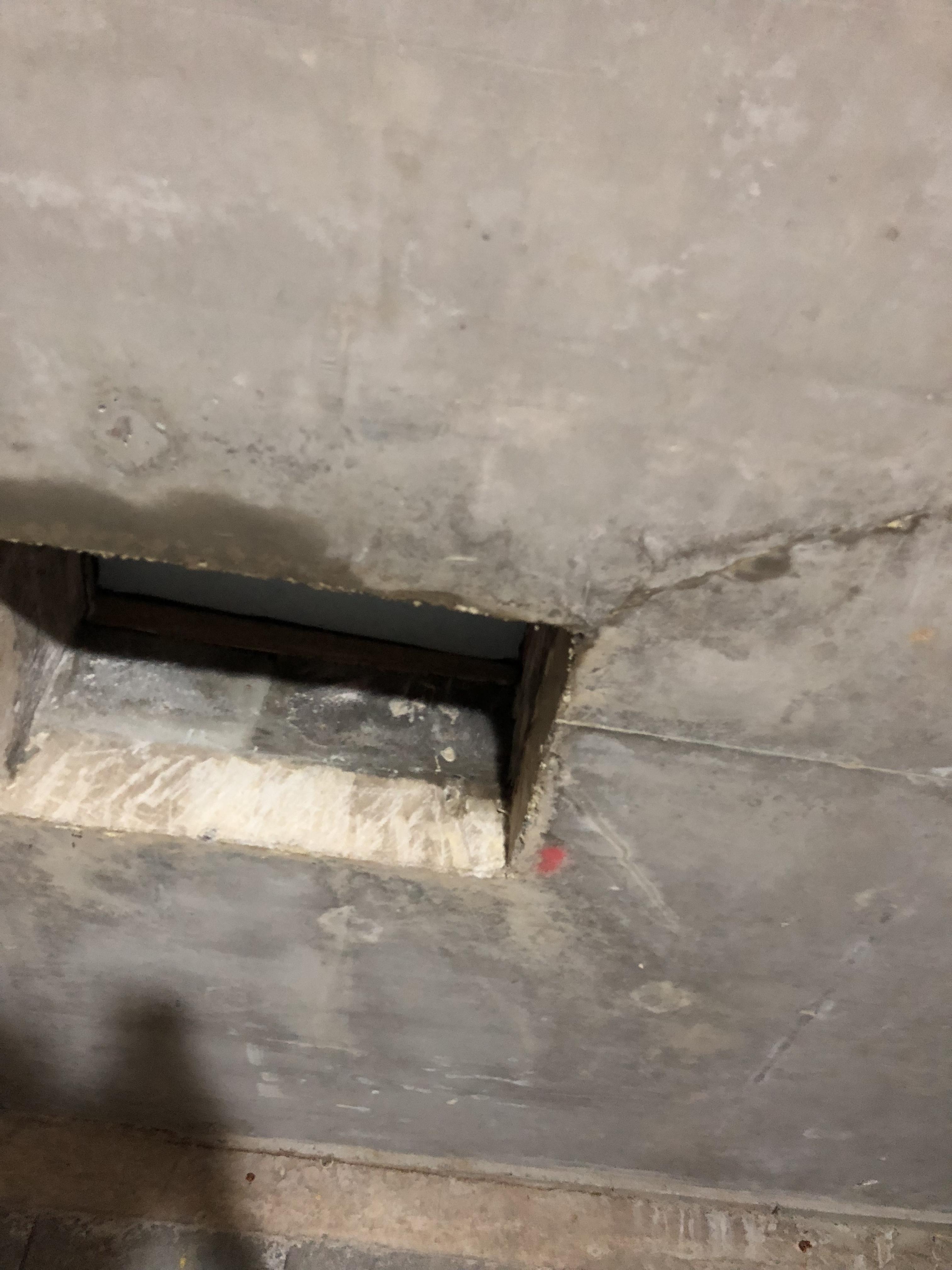

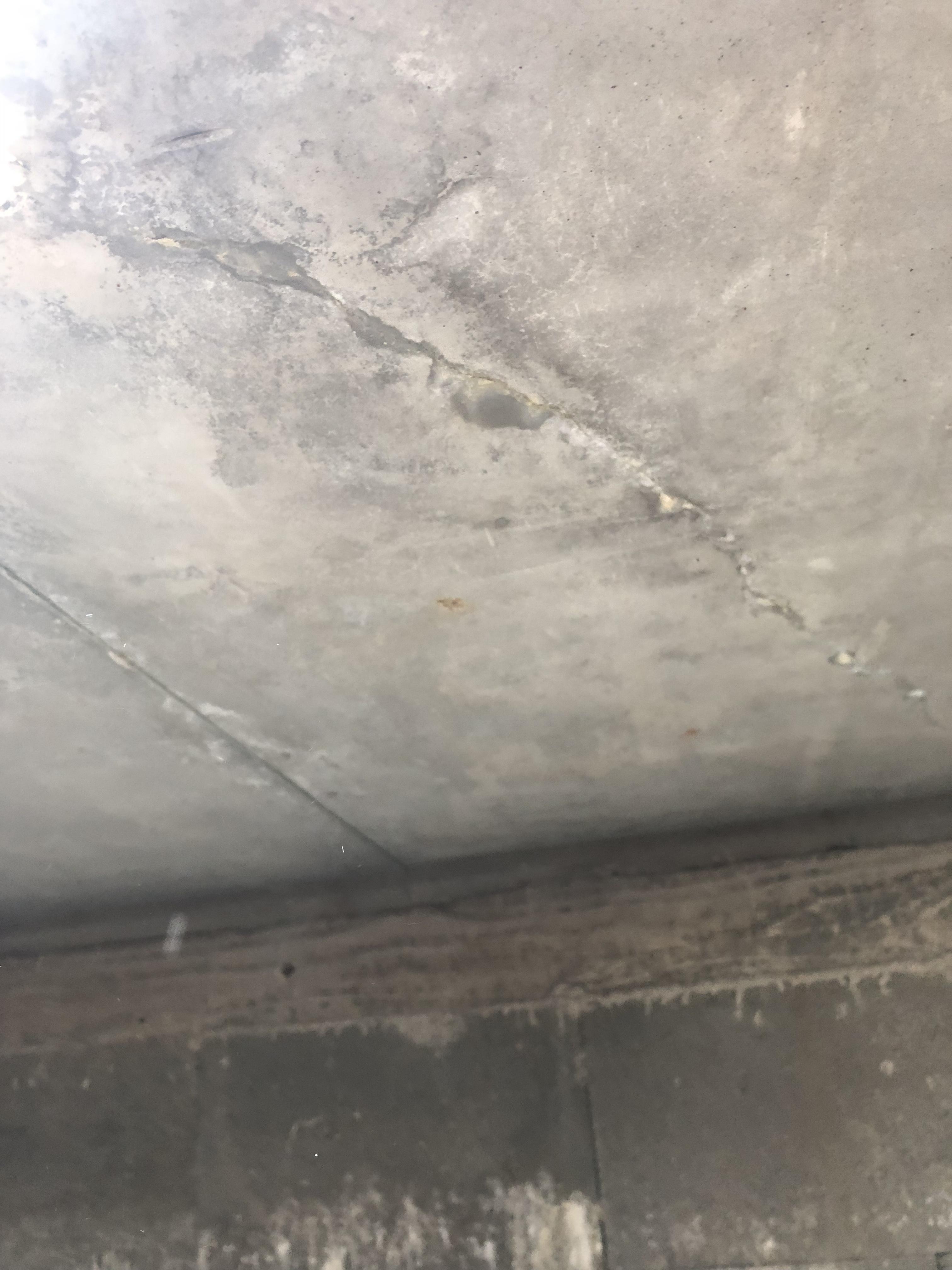

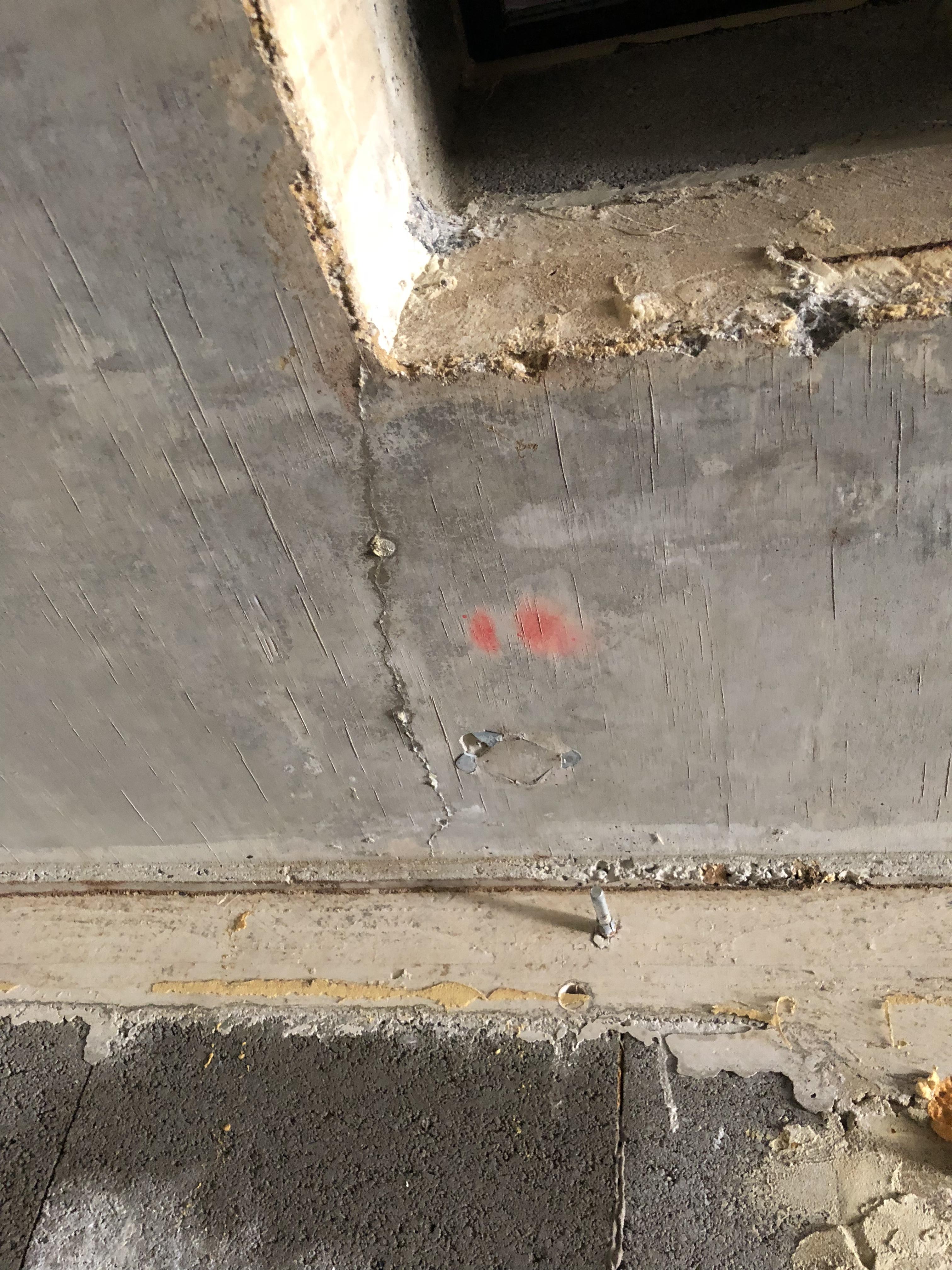

Tried flooding around it . Nothing obvious . Though the block work is still damp so hard to tell .
What I have noticed on this window and others are track lines at the corners . Like a hairline crack in the concrete . Presumably somewhere water gets under the rubber and finds these corners .
Tanking looks like my best solution

57 minutes ago, Declan52 said:
Could the up stand not be fully sealed onto the roof. As in that bit is basically just sitting on top not really attached to the roof. Water will then track along the join till it comes out the other side.
The rubber roofing did go up over the upstands . I tested this with no issues .
I will use this window as my test . So tank the ceiling and upstand . Refit frame with tons of ct1 between it and upstand . Refit glass with silicone again - then leave and wait for rain ( shouldn’t be long ) . If it stays dry for a month will re do all the units ?

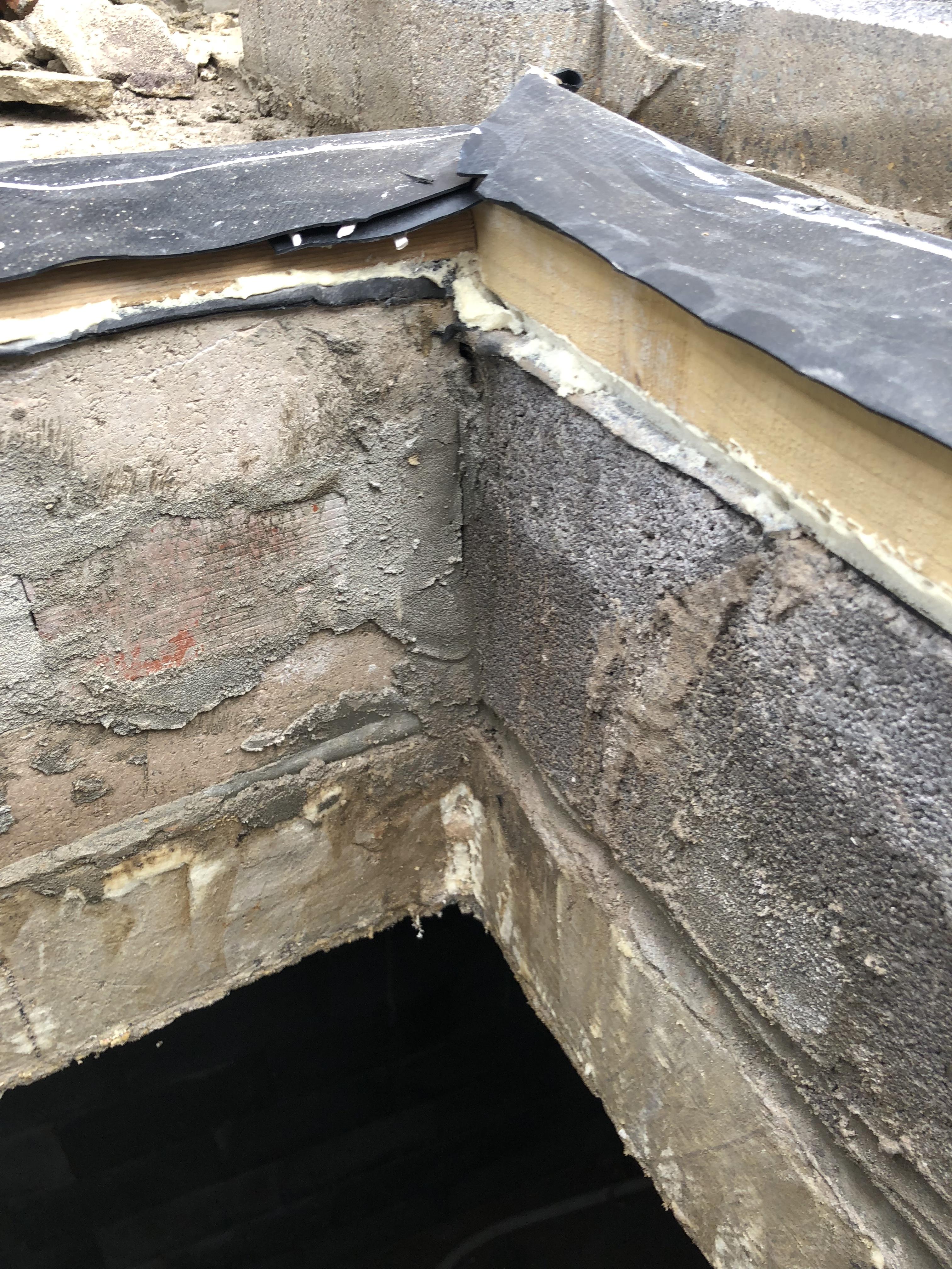

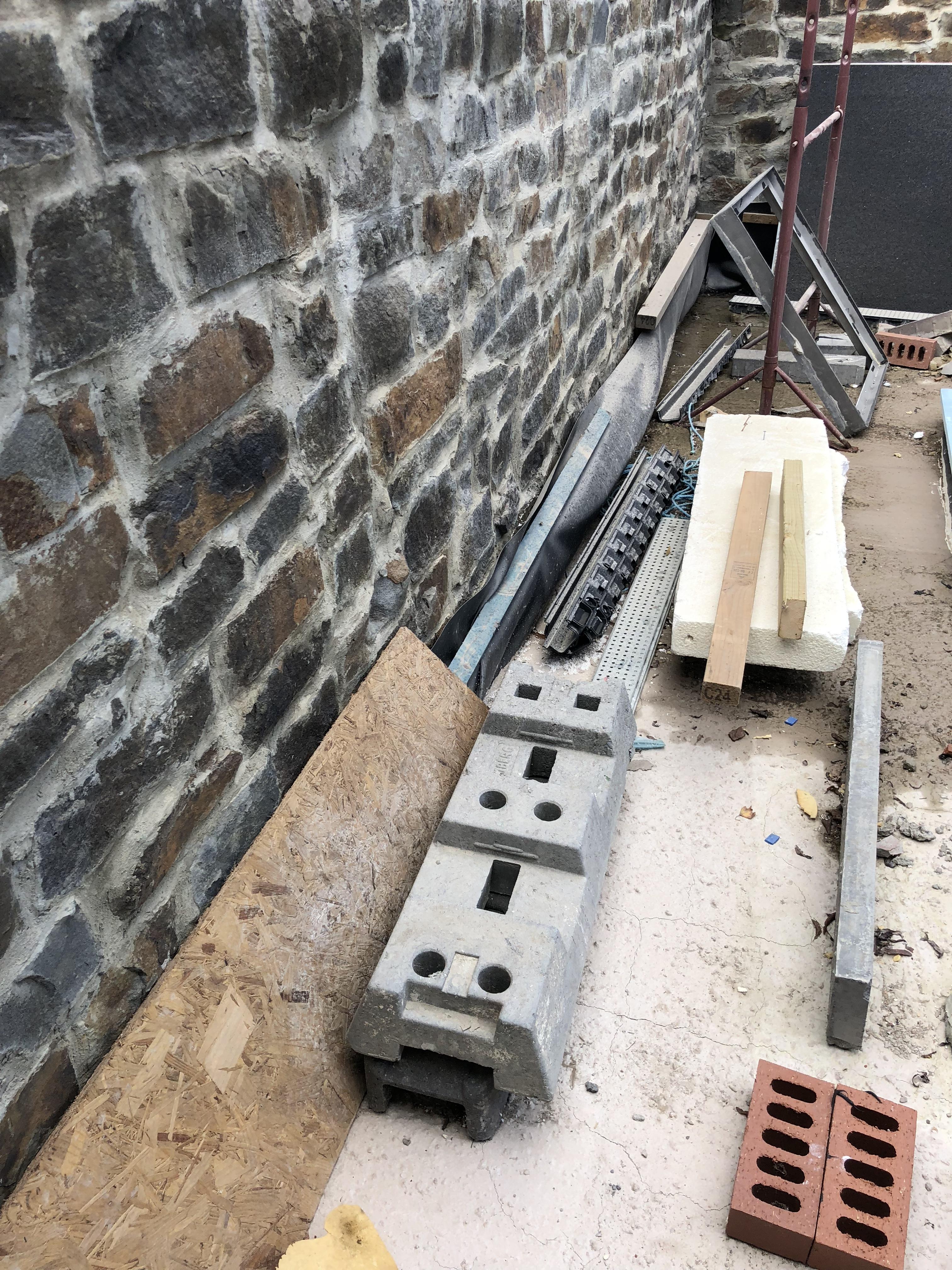

Another possible water entry point is of course my rubber at the edges . Going to flash this ( mentioned in another thread ) - but can’t do that until paving down . Rain hits stone wall and currently would run straight under rubber .....
So perhaps I’m overly concerned with so many ‘holes’ in the build . Mind you would sleep easier if there was no damp .....

Tanking would be a last resort for me.  Have you also confirmed that CT1 is suitable for bedding the roof lights as the last one I saw fitted used 2 beads of structural silicon on opposing edges with a zigzag infil between the lines - from memory it was 2 tubes per roof light and they were 600 square.
I don’t think you have enough on if you could pull that frame up and I’m not sure CT1 is the correct sealant as your EPDM goes over the upstand and not just up the sides.

You are probably right ; should use the silicone sealant for securing frame to upstand . None the less that doesn’t seem to be the water ingress issue ?
I think your getting to the root of the problem with this statement. Get those windows in really well, get that flashing on and hopefully your there.

4 hours ago, pocster said:
I'll be paranoid and will tank it anyway
Sorry, but i’ve got serious doubts that tanking the inside of the building will do anything at all. The answer is to find out how the water is penetrating past the external membrane and fix it at that location.
  • Like 2
Link to comment
Share on other sites
Tanking the inside would only delay the water problem if it’s not fixed at it’s starting point. It will just take longer to become an obvious problem but when it does the fix will be MUCH more work, much more disruption and expense...... and will send you mad !

Nope
block paving doesn’t touch membrane on up stands . I haunged concrete at base of membrane around upstands deliberately to avoid this . Also I even put another ‘rim’ of membrane around each upstand ( that’s why some look so rough - it’s my extra rim you see )

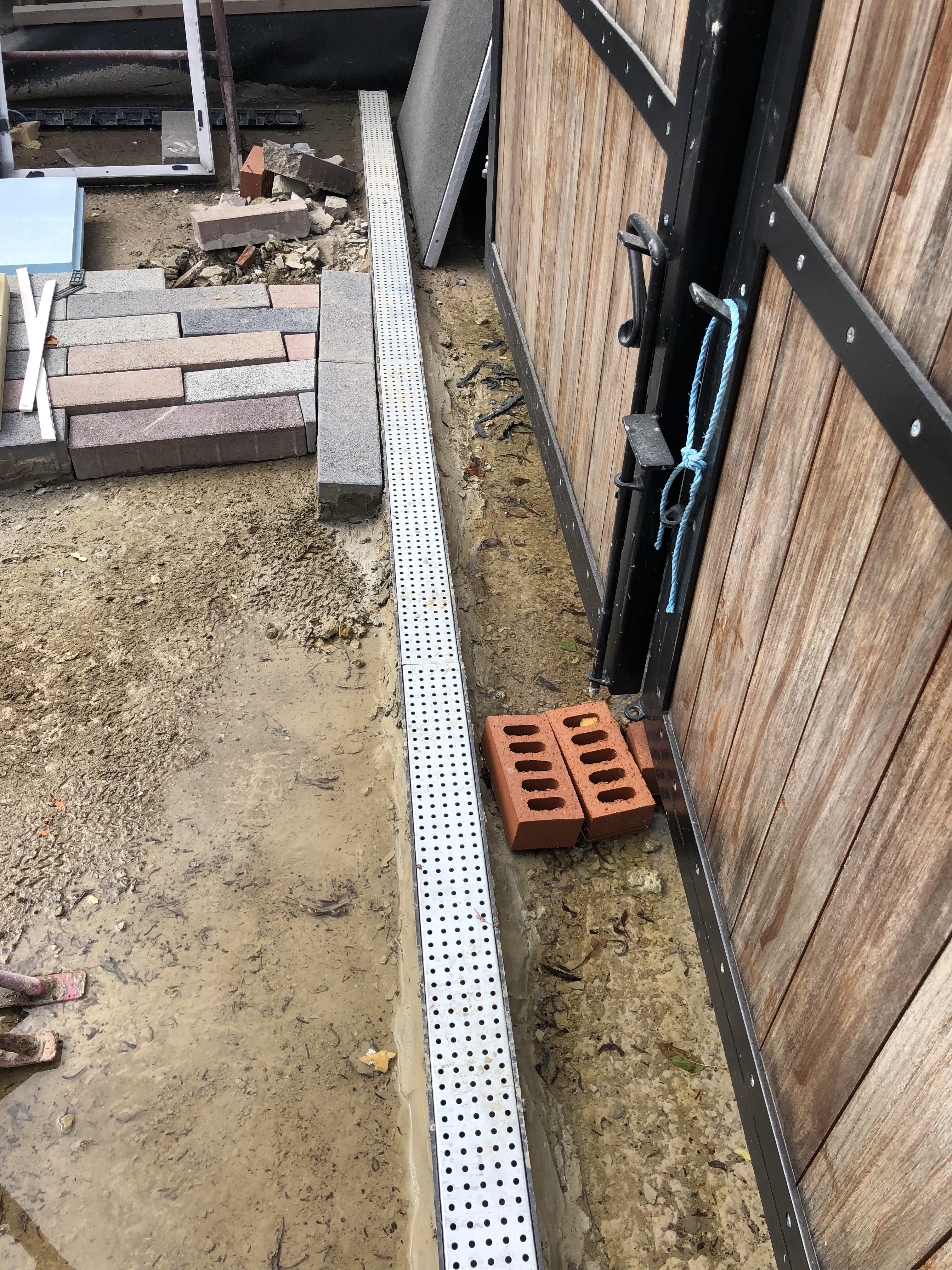

Could you maybe drape a full length tarp along the wall(s) where the upstand is, just before heavy rain perhaps tucked up under the gutter to negate water running down the walls and behind the flashing etc?
Link to comment
Yeah I did think of this
its a bit awkward but not impossible..... ?
Link to comment

Could you cut into the wall and form a lead soaker similar to what you would have on a roof. Then at the walls edge put a concrete channel in to collect this water plus any from the paving area and have to run to wherever your closet drain is. If you haven't the height to fit a channel then make your own from some semi dry concrete and a length of 110mm pipe.
https://www.raygrahams.com/products/133182-concrete-dished-water-channel-36-x-10-x-5.aspx
  • Like 1
Link to comment
Do I need too ?
My flashing at the wall will cover the rubber . I’ll ct1 it aswell - make sure it’s tight ... water should run over pavers into a drain I have at front of plot
in essense my flAshing is cut into the wall so I guess is the same as a lead soaker
Edited by pocster
Link to comment
8 minutes ago, pocster said:
Do I need too ?
The slot in the wall where your flashing goes, does it slope up?
